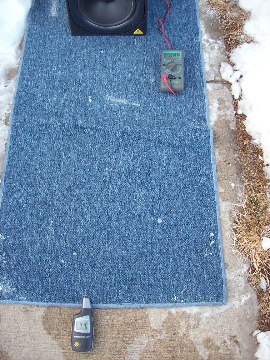

That was at the end of my sidewalk... about 20' from the house, nothing in front for about a half mile. You can see the toyota off to one side, that's about it.
The pic a few posts back (#331) was 28v10m, I don't see much difference to what I did today.
excuse the 'non-scientific' measurement that was obviously rushed.... it was cold, and snowy, but at least no wind.

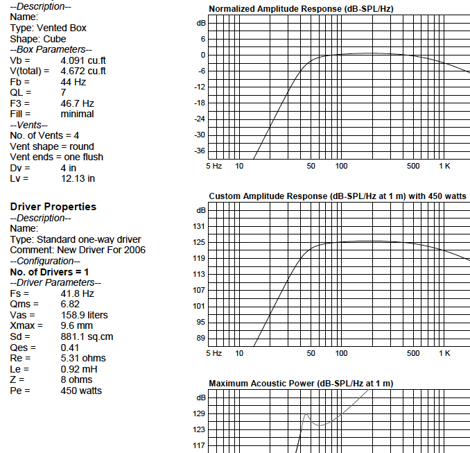

I hope you will mount a 3015LF in a standard box, or better yet the one like below (well under one sheet :^) ), and do a comparison to the tapped horn.

Here's a behringer 2031p... with well published specs. It's 89db 1w1m 4ohm. So... 2v should get something close to 89db.
well I'm within 2db of their published spec... on the cheap-o spl meter using the EXACT same setup as I did with the ss15.

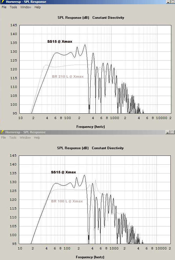

It's probably of little use to continue this discussion until you or somebody else can take direct comparative measurements, that would also include actual observation of Xmax @ high power to see what is really happening inside a tapped horn, and then there is still the difference in the way these boxes would actually sound. If I were you I'd stay out of the cold.
I just put a "box of similar size" into Hornresp as a BR, and compared it to the tapped horn, a more appropriately sized box would be around 100 L_net (2nd SPL graph).
For what it's worth:

you show me the horn resp of your ported cab vs the ss15....
I don’t have Hornresponse, but I already posted the Kappalite 3015LF Med Vented PA Subwoofer Cabinet by Jerry McNutt, Eminence speaker LLC in post #343.
Jerry has published plans for most of the Eminence speakers, I have found them to work fine, and agree well to real world results.
His 4.091 Vb 44Hz Fb box has 125 dB + output, as does the second Hornresponse ported box Tb46 posted in #351, which also includes a sim of your SS15.
On paper, the ported boxes and the SS15 are within 3 dB in the sub range.
By interpolating your test results and possible 2 dB spl difference that your test of the Behringer 89 dB spl cabinet you read as 91 dB, looks like the actual SS15 build may be almost exactly the same in the 45-120 Hz range as a front loaded box.
I agree with Tb46 that we won’t know how the real box performs in terms of actual SPL until someone takes direct comparative measurements.
