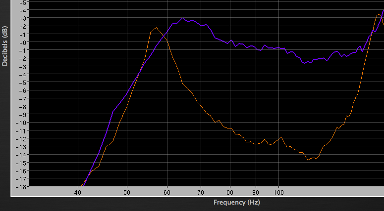

In the chart below, the same small tapped horn (15” x15” x26.5”) with a 10” speaker are compared, the blue trace is using an Eminence Kappa Pro 10”, a +/- 3 dB response from 53 to 160 Hz.
The orange trace is wimpy magnet 10” speaker from an abandoned Fisher stereo cabinet .
Using a dB meter and pink noise band limited to around 160 Hz, the Fisher speaker would read within 1 dB of the Kappa Pro, even though it is 10 dB down (half as loud) for most of the sub range !
Measuring can be fun, interpreting the results even more so.
Having studied the squiggly lines since around 1977, it becomes easier to interpret results, but without knowing precise details of the test procedure and equipment used, results can be very ambiguous.

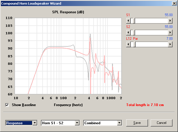

...or you design it with an expanding vent. This should boost the passband response a bit, if done right.
I've included an example below. This is an 8" design I'm looking at, where an expanding vent is used to counteract that inductance rolloff and flatten the passband. A dB or so is added, and even more can be added if I'm willing to go with a larger box size.
Quote:
Originally Posted by jbell
A 220liter reflex with a 3015lf doesn't tune well to do an A/B vs the SS15. You either tune it lower than SS15, or you make the box smaller.
Regardless of the contribution of the vent, any ported or sealed alignment (excluding bandpass ) of a given speaker will be within a dB or so in the region from 120-200 Hz.
The question of actual sensitivity of a specific tapped horn compared to ported cabinet will remain until an A/B test using the same speaker is performed.

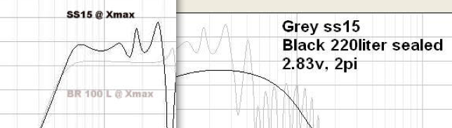

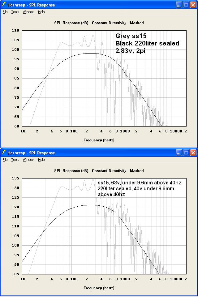

Since you don't have hornresp up and running on your mac yet.
Here is an A/B with the SS15 vs sealed at 2.83 volt, and also at max input power 9.6mm xmax 40hz on up. (40v sealed, 63v ss15)
(since you said earlier you didn't care ported or sealed....)

Art:
Appears your and Oliver’s sims show a dB or so difference in midband sensitivity between ported or sealed, so the difference between the SS15 should be 3 or 4 dB between it and a ported or sealed cabinet in the 45-120 Hz passband. A sealed cabinet of course will run out of Xmax before exceeding Pmax, reducing it’s maximum output.
If you measure that same 3 to 4 dB difference in the real world, you will verify that your cabinet performs as well “as built” as the sims predict.
Or you may find, as Tom Danley has, that they don’t always do what they should.

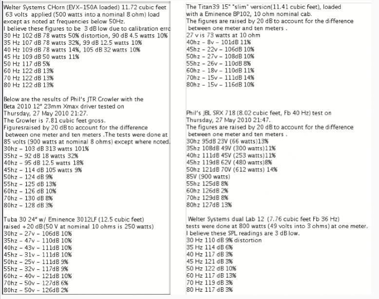

Until it gets a bit warmer, here's some measurements to chew on....
ProSpeakers Forum - Fitzmaurice Titan 48 - Wayne Parham, October 21, 2007 at 14:31:26
In particular look at what happens at 40hz from 100 watts to 800 watts.... only 3db. Even though this is a 35hz 1/4 wave FLH horn using the same 3015lf driver, the designer will tell you it's operating in 'direct radiator mode' at that frequency. Hmm... direct radiator.... like a sealed or ported cabinet.
If a particular design is only 3db more efficient at 2.83 volts.... guess what, it's like the difference between 28v and 80v in this particular case.... so 3db is nothing to sneeze at.
From the measurements from ported, front loaded, rear loaded, tapped, etc.. that I have built in the past... It should look like the ported cabinet brought a knife to a gun fight.
The reason is that I don't care what a sub can do in the 'midbass or midrange' area. If I need more 160hz, I'll eq it in. A sub cabinet must provide the most output at the hardest to reproduce frequency -- that's 40hz-70hz. That's what I care about. If it can't do those frequencies, then it won't work in the real world. You mention 3db difference ported or sealed to ss15... at 60hz it's 10db.... If the above example shows you anything about what happens real world with real power, and only gaining 3db going from 28v to 80v.... then that 10db difference the sim shows you at 60hz makes it pretty obvious why I like the ss15.

PSW Sound Reinforcement Forums: LAB Lounge => JBL SRX718 - Basic Distortion Measurements
As you said August 2008:
“If 40hz is your low frequency that you need for your PA, that efficiency at that freq sets the overall response you can achieve, as it's the hardest to reproduce and most power intensive frequency in the PA power band. (which we obviously know) A sub that's 13db more efficient at 100hz vs 40hz, helps little. If I need more 100hz out of a sub, I'll eq it in. However, If I need more 40hz... there's only one way to get that, big power and big excursion, and that limits the overall spl you can get out of your cabinet.”
Several years before that I had abandoned my Chorn design for Lab 12” in ported cabinets, like you I was willing to sacrifice the upper response for a gain in the lower response. The Chorn behaves like BFM’s and Jeff Permian's offerings.
I have found in an outdoor side by side test on adjacent stages that four ported 2 x Lab12” had 2 dB more output at 40 Hz than eight Meyers 650P 2x18 cabinets, using a small fraction of the power, space and weight.
The Lab 2x12” work so well and allow a flat to 32 Hz response, it appears to me even with the SS15 I’d be leaving a behind a little LF.
I am about to pull the trigger on a pair of B&C BC-18SW115 , the speaker used in the DSL TH-118.
In the same size cabinet as a TH-115, and very possibly the same path length (phase plots overlay) it goes way deeper, is more sensitive, and due to the larger, higher Xmax driver, has a lot more output.
I have a little bit more volume to play with than the TH-118, my cabinet will be 22.5 depth x 26.5 width x 45” height.
I’ll be sharing my results and hoping for some design help.

ahh, but it doesn't... as olivers posts on ported vs ss15 show. I could just set the port tuning to 20hz... then what?
You tell me the ports, and I'll do the plate on the front of the ss15.

The Lab 2x12” work so well and allow a flat to 32 Hz response, it appears to me even with the SS15 I’d be leaving a behind a little LF..
The lab2x12 posted on soundforums.net...
Yes the ss15 is leaving a bit of 40hz behind in single cabinets. I always tell anyone building, run pairs or quads. It's flat to 40 in quads, and pretty respectable in pairs. If there were anything I could change in this design, it'd be to get it flat to 40 in pairs.
