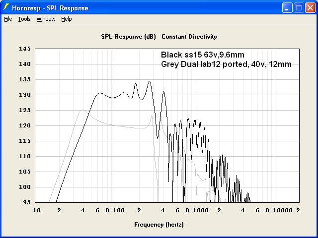

Hey art, I know you are still working on getting hornresp up and running, so I did a quick compare of your dual lab12 posted on soundforums.net vs the ss15. Dual lab runs out of xmax in 40v(50-60hz), ss15 at 63v(40hz).
Yea, the dual lab smokes the ss15 below 40hz, ss15 smokes the dual lab 50hz on up. With that whole 'iron law' thing, you can have any 2, loud, low, small.

I've got to take a closer look at that design. The HornResp prediction for output does not match the Bassbox prediction. OTOH, HornResp does not include the effect of losses in its model, so that may account for the "hump" at the lower end of the FR prediction for the Lab12x2.
Another thing to consider here is that, to provide the same SPL output level in its passband, how much input power is required for each design?
not sure what you are asking? xmax limited within the passband, is xmax limited. The graph I did was xmax limited.
As to the hump, art measured the exact same hump, however he only measured a 3db drop instead of 5db drop in the 80-100hz range vs 40hz. My 'assumption' is that some measured distortion could account for a db or two add in that range, so the 3db drop is very realistic. (hornresp would obviously not account for distortion) At least it's nothing I'd get too worked up over.
Let's put it another way: to produce 120dB in its passband, how much input voltage do you have to provide to each system, and what input power does this represent?
well since the response curves are vastly different, you'd have to just take an arbitrary frequency and ask at what PE does each cabinet produce X amount of output.
sounds muddy to me, not sure what that proves. However hornresp lets you play with those numbers to your hearts content.
The dual 12 does dub and d&b well (aka below 40hz, although can't quite get to 28hz) the ss15 does 40hz on up well. Both boxes designed for totally different tasks -- and each accomplishes it's task. Comparing the two is difficult at best.

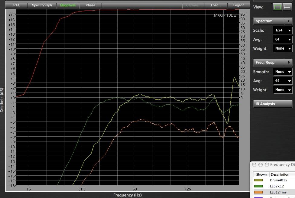

This is why I won't test a ported cabinet for art, until he provides the porting information. The 3015lf will have a similar hump in response in a 220 liter cabinet... A plate on the ss15 to make it a ported cabinet eliminates all other variables except the port, and for that, art must be comfortable in his choice.

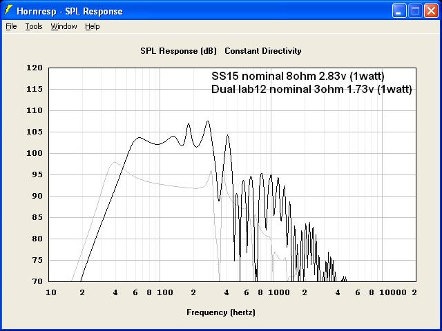

The best thing I could think of to show power differences is either xmax/pe limited or 1watt. Here's a chart of 1 watt.
I've got two spare lab 12 drivers and two completed ss15. I might try knocking up that dual lab box and have a listen.
Hmm... if that simulation graph is close to what's actually achieved, it shows that the SS15 would put a proper spanking on the LAB12x2 for most music. It will cost less and require a lot less power for the same output level. I know which one I'd choose 🙂.

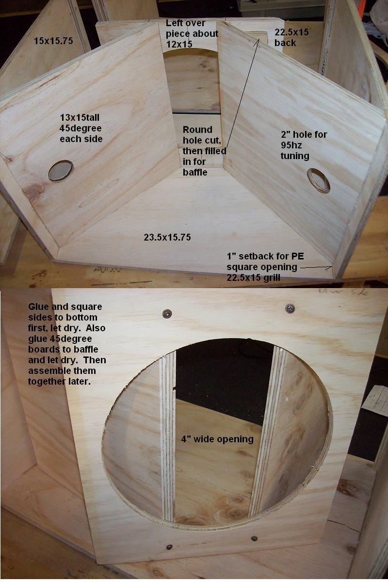

OK Jim, I think I understand the structure for the beta-12 box. Where did you mount the selenium with that big waveguide?
thanks!
Adam
thanks!
Adam
thanks!
Adam
bolt it directly to the metal grill, works great.
