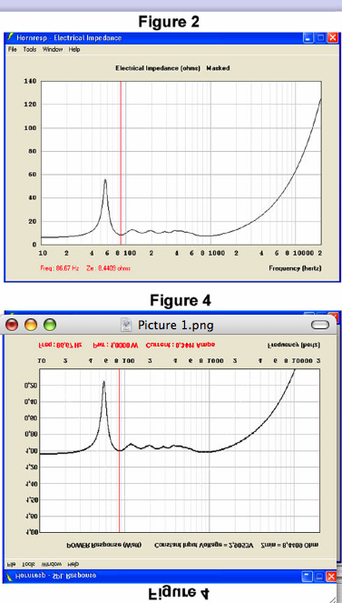

Make for Zmin a separate box in the "Input Parameters" page (see figure 1). This way the user is responsible for manually searching for the Zmin in the "Electrical Impedance" chart.
After the Zmin is filled in the box the corresponding Watts appear in the "P" box beneath it. By changing the Voltage in "Eg" the power will automatically change (based on Zmin). When you change the power in the "P" box, the Voltage in "Eg" will change with it. If Zmin is not used there is also no value in "P".
This way the user can have full control over Power and Voltage.
In figure 4, I made a suggestion for a new screen page that shows the "POWER response" with all valuable information. If Zmin is not used this page is not available.
What do you think?
Hi Djim,
Just curious - what power is shown in the Figure 4 Power Response chart, and how is it calculated? Thanks.

Hi David,
Figure 4 is like my other examples screens just an example and haven't paid much attention to its accuracy. But figere 4 is based on a Voltage constant of 2.9V (figure 1) at an power of 1 Watt based on the lowest impedance of 8.4409 Ohm in the bandpass at 88.67Hz.
Hi Art,
A model should be theoretically correct and doesn't 'see' reality. In other words in reality the impedance peak would be much lower and wouldn't end in a perfect pointy peak. Even for friends, in theory it would be difficult to burn out the VC at that specific point since it would go way beyond its Xmax much sooner 😉

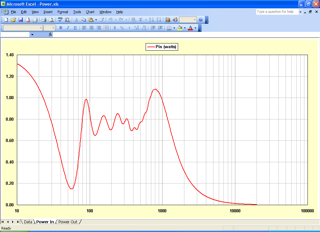

Thanks for clarifying that the Power Response chart shown in Figure 4 is for illustrative purposes only, and that the results are not meant to be an accurate representation of what actually happens in practice.
Just for the record - using your Figure 1 input parameter values, the predicted electrical input power will be as shown in attachment 1, and the predicted acoustical output power will be as shown in attachment 2.
The information used to generate the two attachments was taken from Hornresp exported chart data.

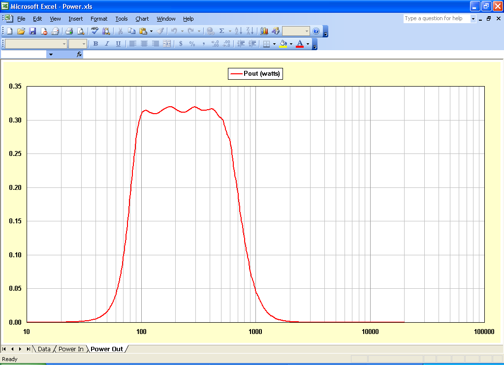

Out of curiosity, since all the data is already there in the export file why haven't you put it in a chart within HornResp before?
Looks great!
Hi Djim,

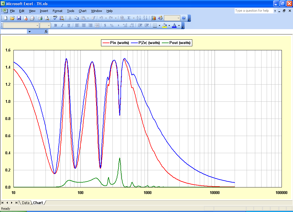

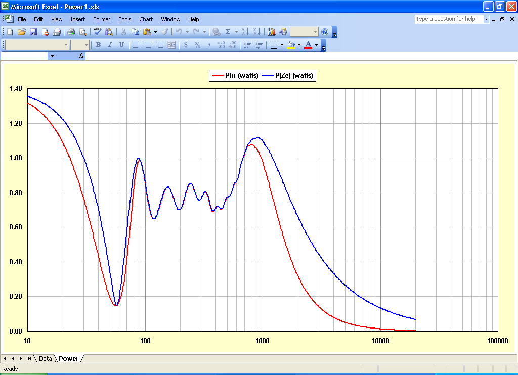

While the variation of electrical input power with frequency for a constant input voltage is certainly of some interest, I didn't think that it was really necessary to provide the information in a chart in Hornresp. Power values can be readily checked at particular frequencies if required using the Sample tool with the SPL response chart, or by scanning the exported chart data.
Incidentally, it is interesting to note the difference between the power calculated by Hornresp - which takes into account the resistive and reactive components of the complex impedance Ze (red trace), and the power calculated using simply the magnitude of Ze as given in the Hornresp electrical impedance chart (blue trace).

Hi David,
Ooohhh I like these charts very much! The last chart raises the question if the complex calculation method is always similar to the Zmin calculation within the 1/4WL and full WL?
An example of how these charts can be used 🙂
Instead of looking to the SPL Response for setting out the bandpass, you can also use the Power chart for a more balanced power bandpass, or to show where the dynamic compression points can be found. Lots of extra information...
I use the 1 Watt horizontal as reference line in both examples (this could also be your max AES power or the power based on Xmax for instance).
Hi Djim,
Attached are the power curves for the William Cowan 60 hertz tapped horn with Eg = 2.83 volts.
Kind regards,
David

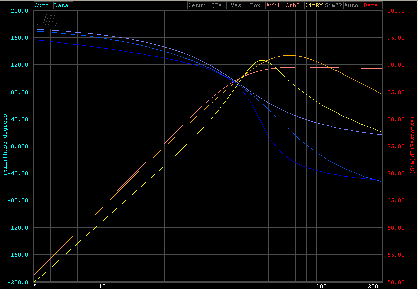

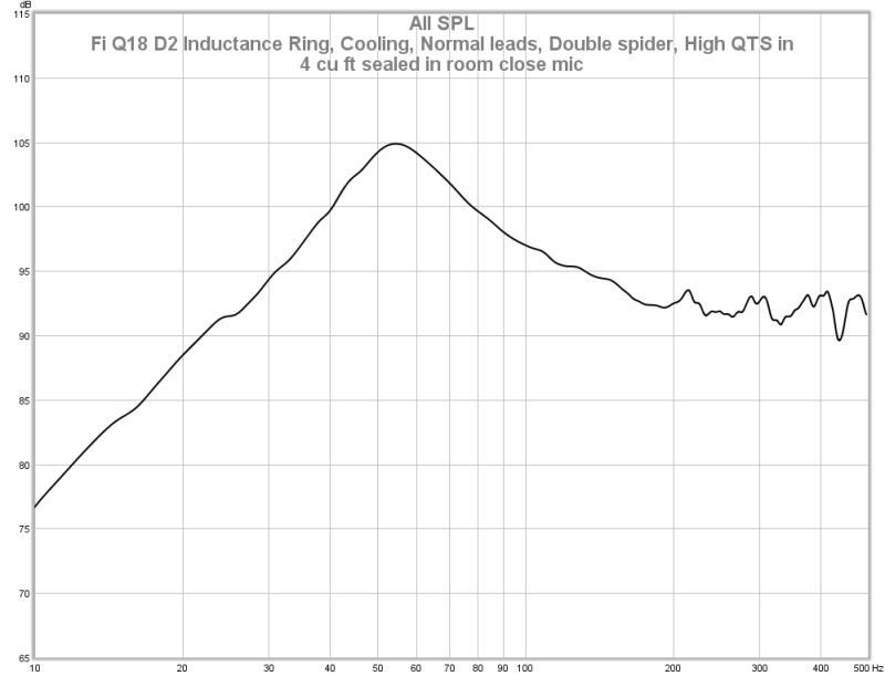

David,
Have you given any thought towards allowing the ability for complex inductance effects to be included into HR modeling? Many of the modern high power bass drivers on the market cannot be accurately simulated with parameters not including inductance or even using a simple inductance model when that information is actually given.
For example see the attachment. This is a simulation of a driver in a sealed enclosure using the measured specification without LE (Red response curve), using the simple LE model (Orange response curve), which is what capability HR currently has and finally using complex inductance (Yellow response curve).
I have also attached a real measurement of the driver in question in the enclosure to show how closely the complex model matches and how progressively more inaccurate the simpler models are without this information. Note this is not an outlier driver either, this type of response and sensitivity variation due to inductance is very common with large bass drivers. Some are much worse than this.
