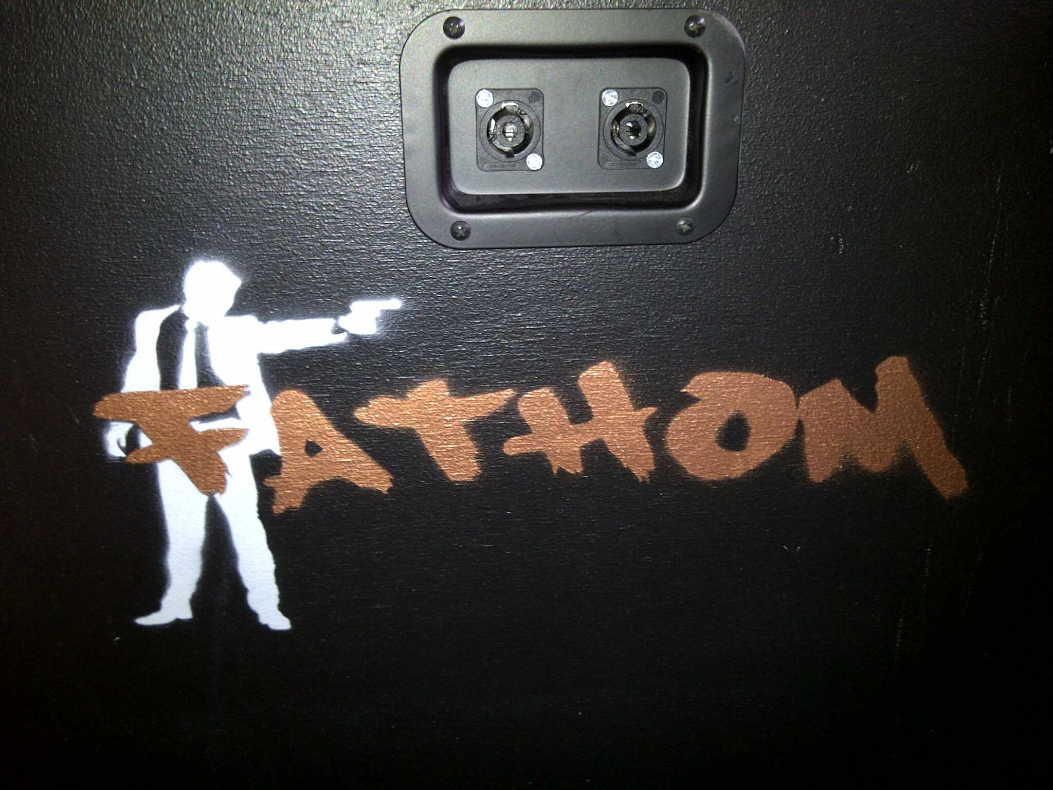

Speakons are the way to go
A) jacks can short an amp if pulled out / pushed in when powered on
b) jacks can easily be pulled out, speakons lock into position
c) speakons are air tight, so no whistling / loss of pressure through the back of your cabinet
d) speakons have tiny little "+" and "-" signs to show which is which
e) aside from some older style bass and electric guitar cabinets, jacks are only found on the cheapest pro audio cabinets - just take a look at the rear views of cabinets in various price ranges.
Regards, Ben

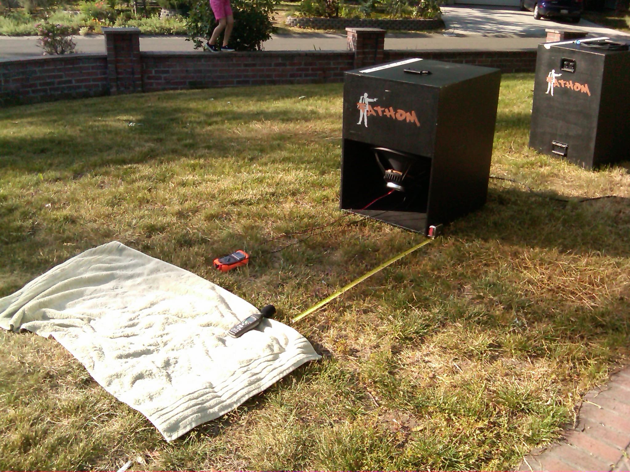

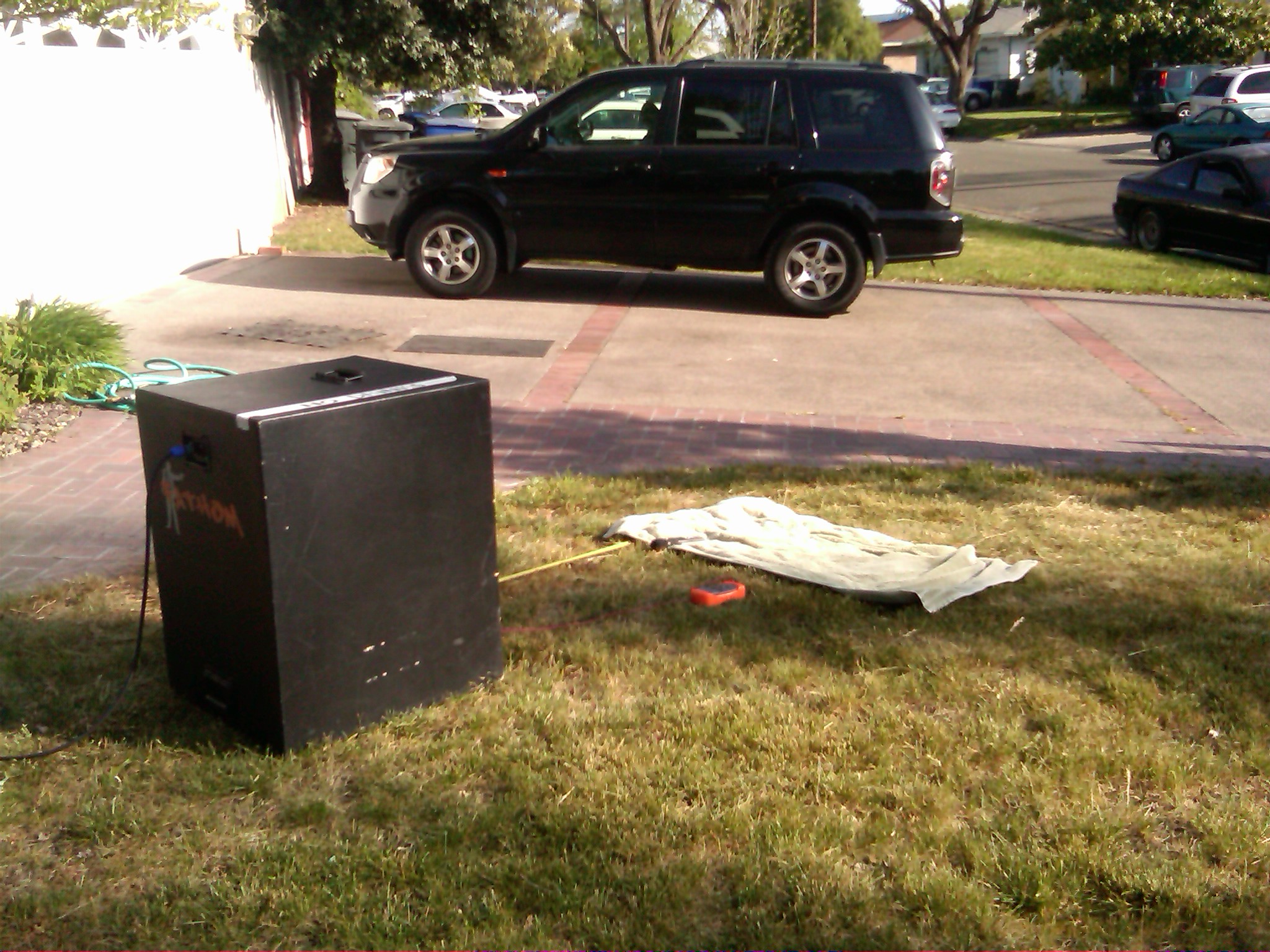

Built these last year - did some testing today:
Enclosure: SS15
Construction: 1/2" Aurauco
Designer: jbell
Driver: Eminence 3015LF
Amp: QSC PLX3402
Volt-Ohm Meter: Blue-Point MT574
SPL Meter: American Recorder Technologies SPL-8810
*Settings:
-Weighting: C
-Time weighting: Fast
-Sound level: Hi = 60-130dB
Conditions: ground plane, outdoors, over grass
The following measurements were done at 1W/1M (3.3 feet or 3'4"). The driver tested is published as 8 ohms from the manufacturer. Amplifier voltage of 2.83v was measured at the driver's terminals.
*Please remember, C-weighting has NOT been accounted for/factored in and the appropriate amount of dB need to be added to these measurements to compensate. I only have an image of the graph/curve without exact numbers to calculate with.
30Hz: 81.1
35Hz: 85.8
40Hz: 90.7
45Hz: 94.2
50Hz: 98.6
55Hz: 101.4
60Hz: 101.7
65Hz: 102.7
70Hz: 103.2
75Hz: 102.1
80Hz: 101.8
I do not have 85Hz, 95Hz or 105-120Hz and found 90Hz & 100Hz on my computer later in the evening.
But, I tested some tones with a bit of power (just at clip) to factor in power compression. Had the SPL meter on peak hold. Amp is rated at 700W/ch @ 8 ohms. Here's what we measured at 1 meter (the same conditions stated at the top):
121.9dB @ 50Hz
123.5dB @ 55Hz
124.7dB @ 70Hz
I played a single track for program material and turned it up again for the same reasons above.
122.1dB w/(1) SS15
124.5dB w/(2) SS15 wired parallel on one channel (~550W/cab), standing side by side
This is how we normally run the pair while another pair is driven on the other channel.
All tests were with the cabs standing up.

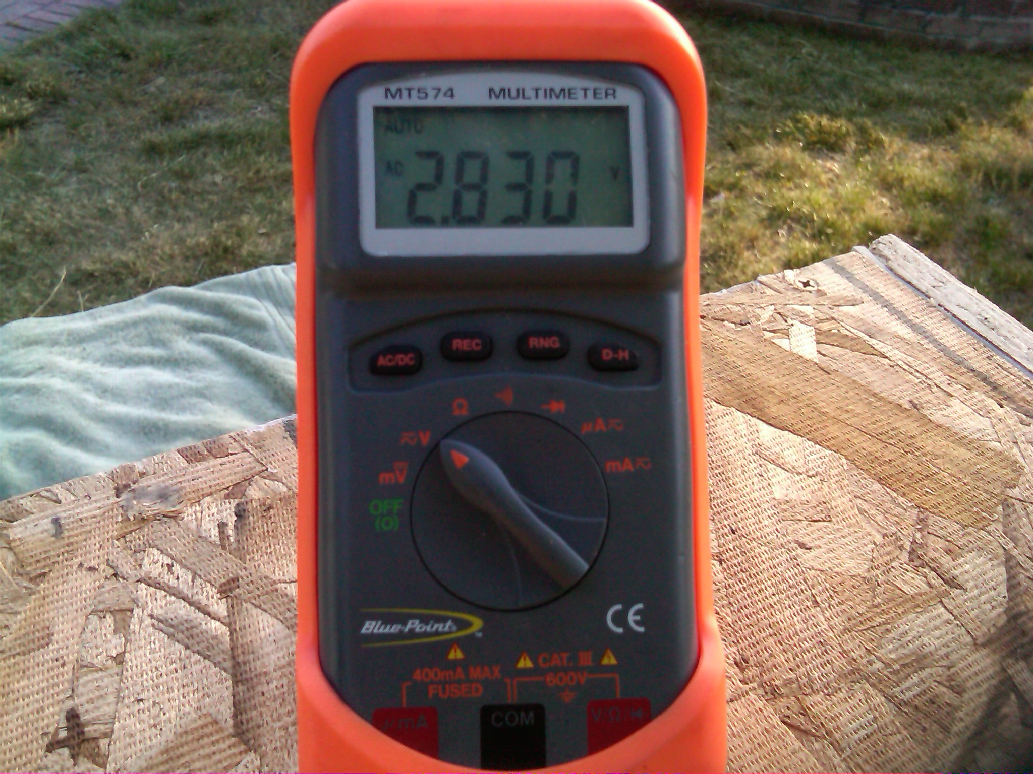

Below I've attached a photo of the drive voltage used, measurement conditions (mic not centered during photo and 2nd SS15 was not there during tests) and couple post-build photos.
Cheers!

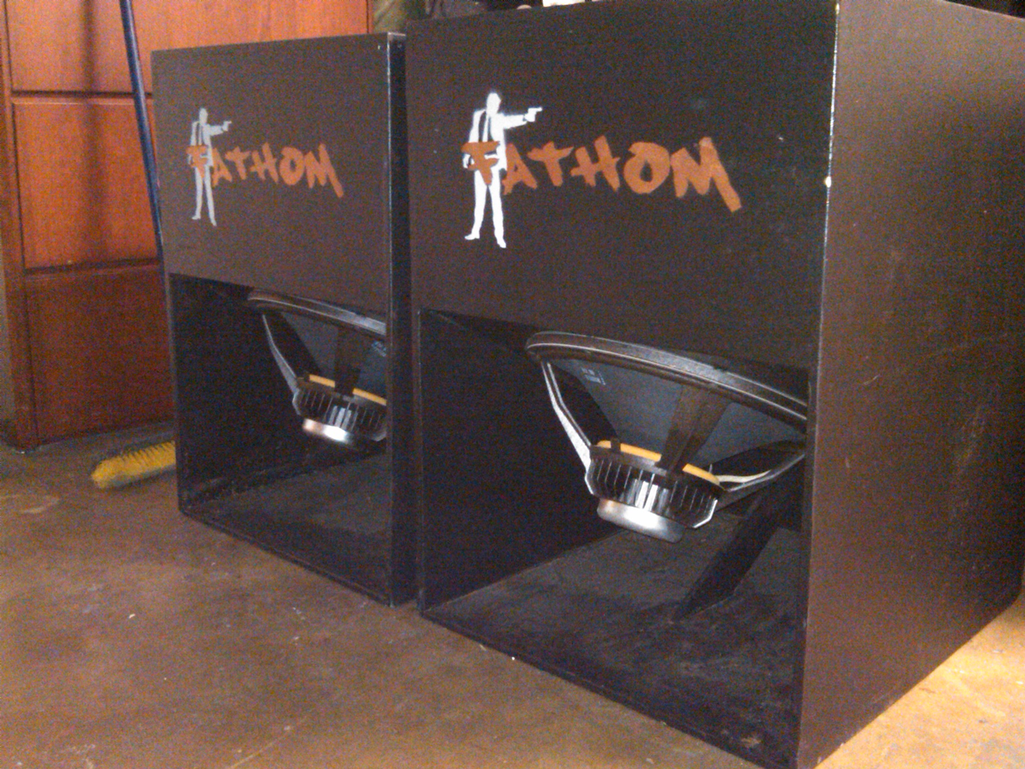

Hi!
Your measurements are quite within I found here; excellent SPL at 1W/1M; but at the limit severe power compression, I think due to the cone control which is absent when real power comes in, even with good 18Sound drivers.
So contacted Jbell in respect of restricting the throat a la furybox (letter box).
He suggested a round restriction which I made attaching it inside (two"C" form glued together), to equal the pressure to all the cone.
Actually the cone control is far better and despite no measurement after it, with the B&C 15CL76 it appatently goes a bit lower...
Pictures of it were published in this tread before.

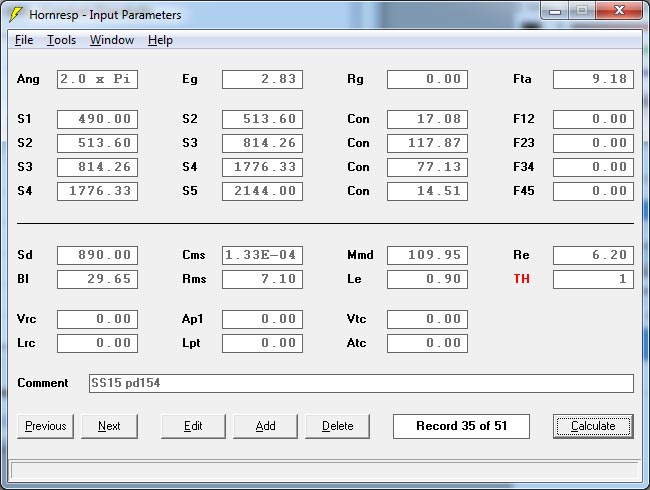

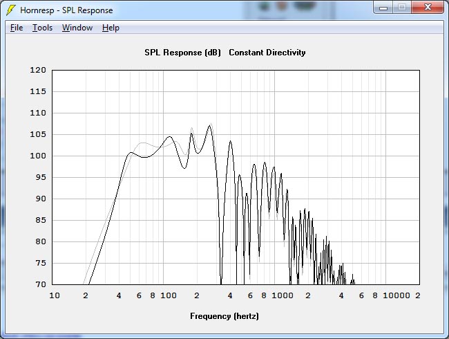

Hi Sjpaul,
According to Hornresp, the PD154 will work, but they are a bit peakier with more below 55hz and less from there to 90 compared to the 3015lf.
Attached are some hornresp files to get you playing - the plot shows the pd driver in black vs the 3015lf in grey (both at 2.83v), but keep in mind the re of the pd is 6.2 ohms vs 5.3 for the 3015, so the power used for the pd would be less for that graph. To get the same power input, enter 3.06v for the pd which is 2.83x(sqrt(6.2/5.3)).
Have a play with hornresp and see how you go.

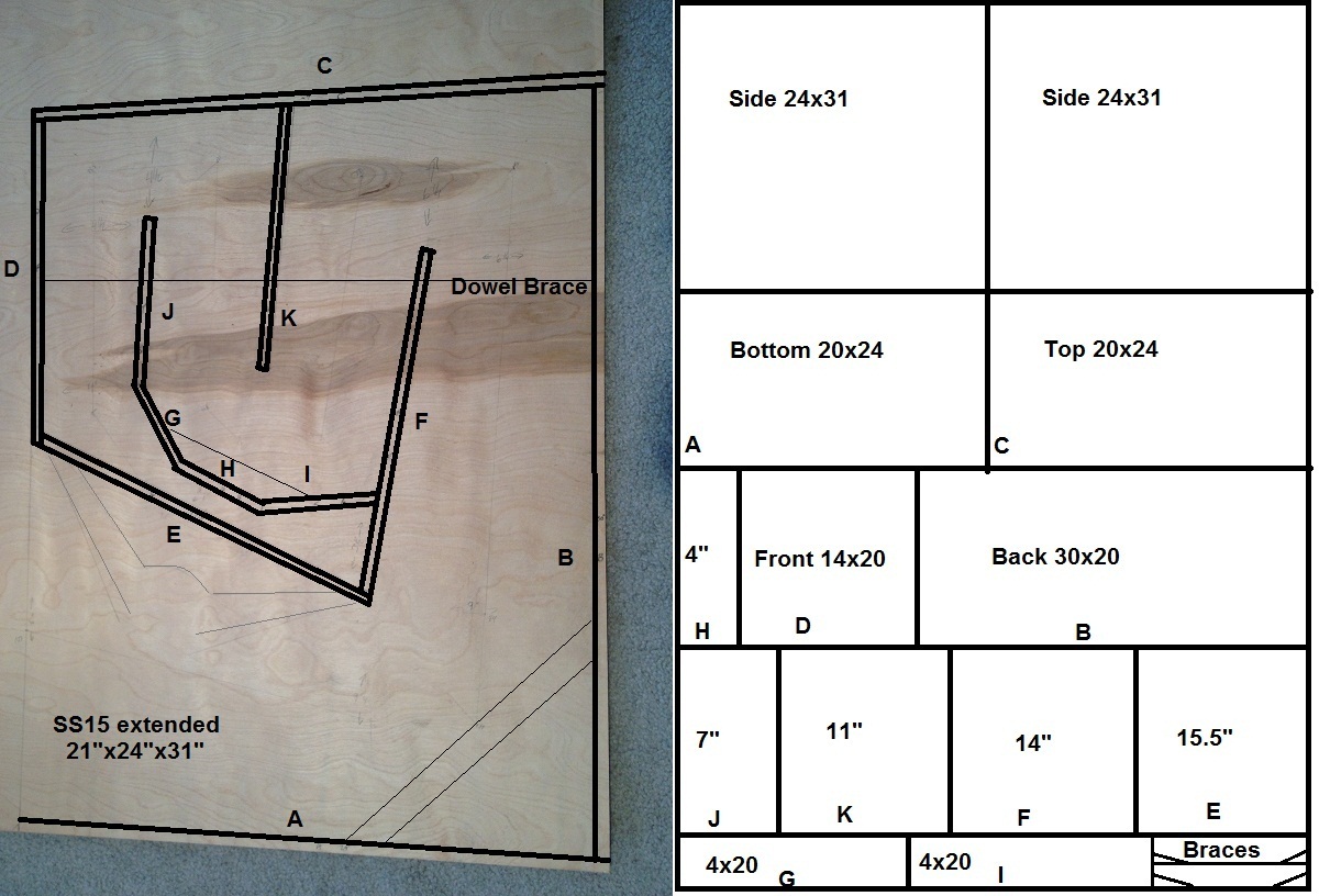

Ok, so my friend DJIM gently got me to act on this.... I haven't touched the ss15 design in months -- it just works so well.
The only downside for me, is that it is not a 'flat to 40' box. And I'm big on flat to 40.
So, a bit of 'S2 cone correction' instead of a compression plate.
1" taller and 1" narrower...
and the SS15 can now hit with authority an honest to goodness 40hz.
This is still on paper and hornresp only, and it'll be a week or so before I can build/test... But I do have assembled 'original' SS15 cabinets, and I can do an A-->B comparison.
It "should" eliminate the one glaring weakness I see in the ss15. And it still does it from a single sheet, but this time you really do have nothing but sawdust left over... You even have to use the driver disk cut out from the baffle board as bracing.
