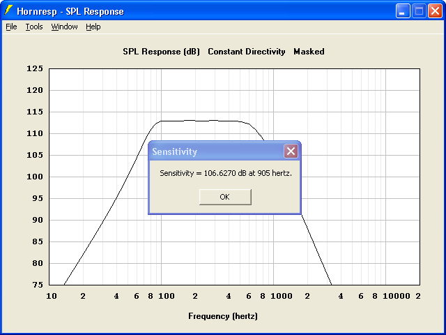

As mentioned in an earlier post, the Maximum SPL tool can generate an SPL plot based on 1Watt/1m.
I thought however, that what you wanted was a single sensitivity figure - calculated at the frequency of the lowest impedance within a specified passband, similar to the attached screenprint.
Assuming that was the case, I was trying to understand why the sensitivity figure was required at the frequency of lowest impedance, rather than at say, the highest impedance within the passband.
Incidentally, the attached screenprint shows the result for the default Hornresp record with resonances masked. Does this value seem right to you?

Hi David,
Sorry David if my explanation became somewhat fussy, but it’s just the SPL plot but with a fixed 1w/1m readout.
About the question if the value seems right, is difficult to say without any info of the driver model you are using ;-)
I made an example of how it could look like to prevent miscommunication.

In that case, as far as predicting sensitivity is concerned, I still don't understand why you just can't use the Maximum SPL tool with Pmax = 1 and Xmax = 99. Voltage Eg is automatically adjusted by Hornresp to maintain a constant 1 watt input, even though the load impedance changes with frequency.
As previously stated, the screenprint shows the result for the default Hornresp record with resonances masked. All the information required is given in the input parameter values for record 1.
