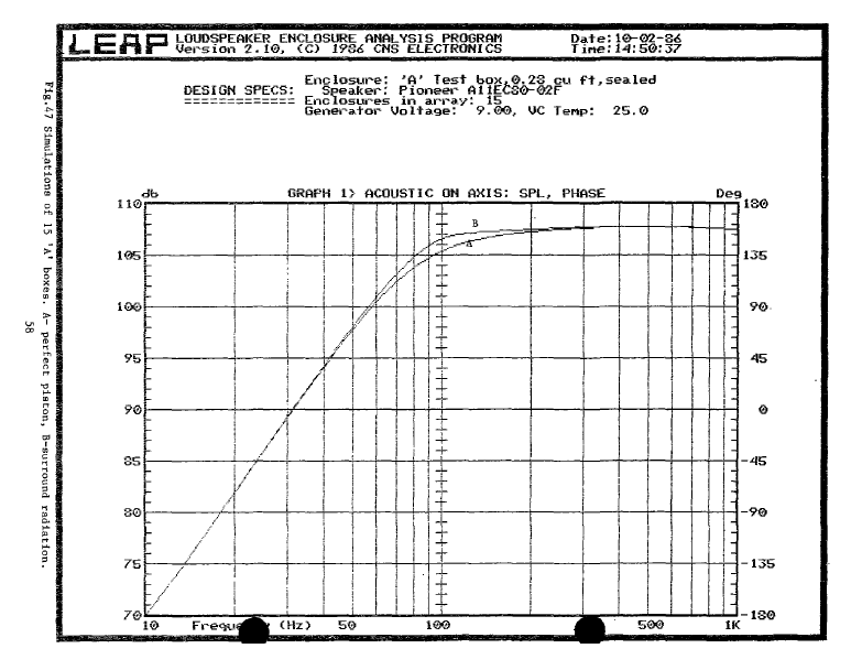

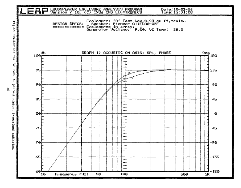

I have just been looking at an AES paper which contains graphs showing the SPL of one speaker compared to fifteen speakers connected in parallel, driven by the same voltage. The charts are predictions, but are very close to actual measured values which are also given in the paper. The results are quite different to those generated using any of the three Hornresp models currently under consideration, and don’t comply with the coherent signal summing rules discussed earlier.
The first chart attached shows the SPL for one speaker. The second chart shows the SPL for fifteen speakers. The difference between the two at higher frequencies is 13 dB, much less than the summing rules would suggest should be the case.
Until I can find a more robust model to better predict the performance of multiple speakers, I think that it is probably safer to leave Hornresp as it currently is 🙂.

Hi Art,
Thanks for your comments.
I am not sure that getting more sleep is going to help much at this stage... 🙂.
Kind regards,
David
One to 16 speakers should be +15, I read about a 12 dB difference in the 1986 Leap version 2.10 simulation, which would be sort of consistent with an incoherent summation and one less(15 instead of 16) speaker.
I have no problem with you leaving Hornresp as it is, it’s “close enough for rock & roll” 😀.
I will continue to point out to the newbies that are counting on a low corner reduction in multiple TH that they will be disappointed 😉.
Perhaps one day someone will actually measure 1, 2, 4 and 8 SH15 cabinets and we can see how they actually perform compared to the simulations people take for granted.
Hi Art,
Just to clarify - how did you arrive at +15 dB for 16 speakers connected in parallel?
Based on the SPL summation information provided earlier, my understanding was:
Coherent summation:
1 to 2 = +6 dB
2 to 4 = +6 dB
4 to 8 = +6 dB
8 to 16 = + 6dB
1 to 16 = +24 dB
Incoherent summation:
1 to 2 = +3 dB
2 to 4 = +3 dB
4 to 8 = +3 dB
8 to 16 = +3 dB
1 to 16 = +12 dB
Are you perhaps assuming that the test signals being summed in this case would be partially coherent only?
Using the original Hornresp model for 15 speakers in parallel, the difference is predicted to be +23.60 dB at low frequencies and +11.77 dB at high frequencies. Interestingly, this is consistent with the speaker outputs being coherent at low frequencies, but becoming progressively less coherent at higher frequencies due to directivity interference effects.
1 to 15 coherent = 20 * Log10(15) = +23.52 dB
1 to 15 incoherent = 10 * Log10(15) = +11.76 dB
Incidentally - if any one is interested, the AES paper I referred to earlier is titled "Complete Analysis of Single and Multiple Loudspeaker Enclosures". The author is Chris N. Strahm.
