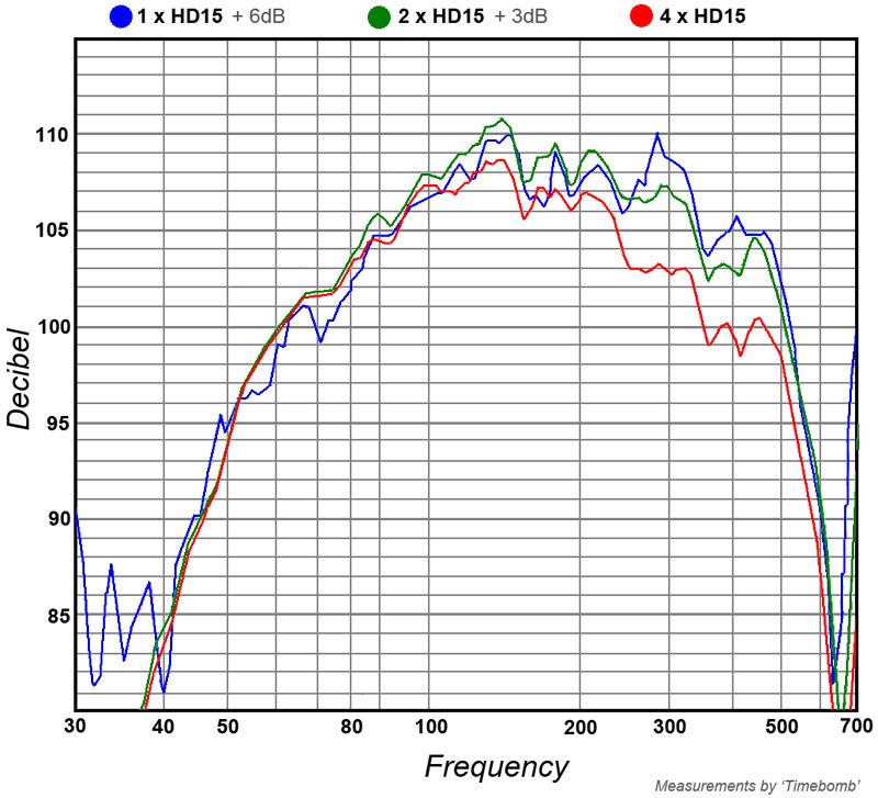

I have also finished the measurements of the HD15's. To prevent confusion these measurements are based on Watt constant instead of Voltage constant. Therefore the steps are +3dB for dual setting and +6dB for single setting.
Hi Djim,
Not sure if I understand how to interpret the measurements correctly.
Just to clarify, are these results saying that for constant input power:
With 2 speakers connected in parallel compared to a single speaker, the gain at low frequencies is +3 dB and the gain at high frequencies is approximately +1.5 dB?
With 4 speakers connected in parallel compared to a single speaker, the gain at low frequencies is +6 dB and the gain at high frequencies is approximately +3 dB?
If so, does this then mean for constant input voltage:
With 2 speakers connected in parallel compared to a single speaker, the gain at low frequencies is +6 dB and the gain at high frequencies is approximately +3 dB?
With 4 speakers connected in parallel compared to a single speaker, the gain at low frequencies is +12 dB and the gain at high frequencies is approximately +6 dB?
If so, then the measured results would appear to be consistent with the predictions of the existing Hornresp multiple speakers model.
Kind regards,
David
Djm's plots seem to show good correlation for the +3dB for each doubling of driver @ the same power input over the frequency range 42Hz to 130Hz.
Above 130Hz the gain is clearly less than +3dB as the two comparisons show.
The dual driver shows fair good correlation to beyond 250Hz, then I'm not sure how to interpret what is shown.
The quad driver is clearly showing less than +3dBbeyond 130Hz and gets worse as the frequency moves towards 450Hz. Then I can't extract a sensible trend due to the rapid roll-offs.
This supports my original contention that the +3dB efficiency gain is only available over a restricted frequency range.
If one used full range driver/s and repeated DJM's experiment, I think that restricted frequency range to stand out even more clearly.
i.e. we need to see performance upto >3kHz to SEE clearly the missing 3dB efficiency gain. The beaming of a group of HF drivers will be so severe that they become un "hifi" at high frequency.

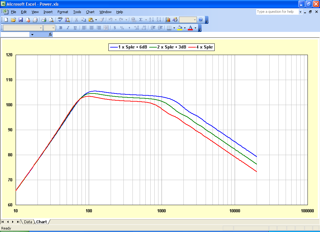

Hi Djim,
Hi Djim,
After catching up on a bit of sleep, I think I have managed to answer my own questions 🙂.
Please disregard the comments I made - some of the gains I assumed, were incorrect.
Attached for comparison purposes are a copy of your latest test results, together with the equivalent results predicted by Hornresp using the existing multiple speakers model.
The blue trace was generated by considering a single speaker with Pmax = 4W and Xmax = 99. This means that the total constant input power to the array is 1 x 4W = 4W and that the results are not displacement limited at any frequency. A fixed 6 dB was then manually added to normalise the results, similar to yours.
The green trace was generated by considering two speakers in parallel with Pmax = 2W and Xmax = 99. This means that the total constant input power to the array is 2 x 2W = 4W and that the results are not displacement limited at any frequency. A fixed 3 dB was then manually added to normalise the results, similar to yours.
The red trace was generated by considering four speakers in parallel with Pmax = 1W and Xmax = 99. This means that the total constant input power to the array is 4 x 1W = 4W and that the results are not displacement limited at any frequency.
The speaker used in the Hornresp simulations is not the HD15.
Kind regards,
David
