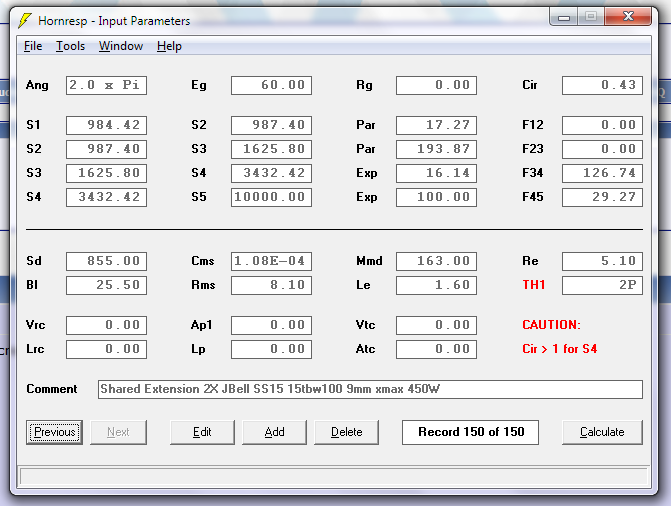

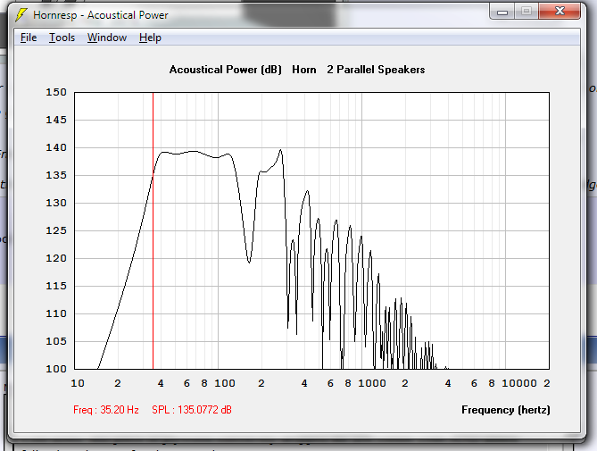

For giggles I decided to sim up a shared horn extension using a pair of this classic design and quite shocked how well it worked. The image is 2 pairs or 4 cabs total. With all of the builds folks made here I'd think this would really encourage someone to try it out. Cliff notes: this piece of plywood effectively drops the low corner 10Hz AND adds 3db.
Even better, HR file also attached. Still learning, so I would appreciate criticism. The premise of this approach can be found in Art's Extender/Waveguide thread. Essentially, you are doubling segment size/combining L2 and L3/adding the extension as final segment/changing TH to TH1/using 2 drivers.
  • ExtendedSS15.txt
    ExtendedSS15.txt
