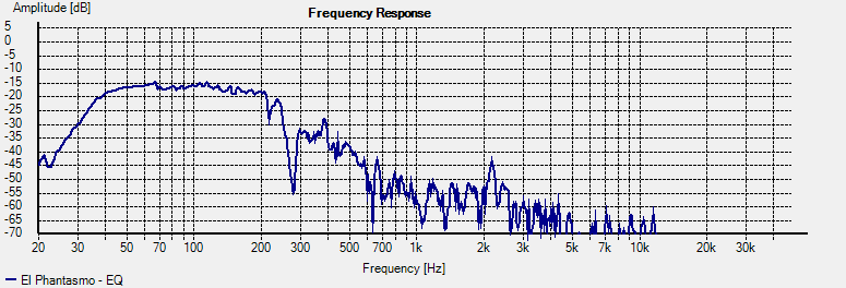

I'll see if I can eventually drag my equipment out to some open space to do response measurements. I finally got a decent measurement mic with my driverack px.

If you use HolmImpulse (free) to do the FR measurements, it will also provide distortion measurements as well.
