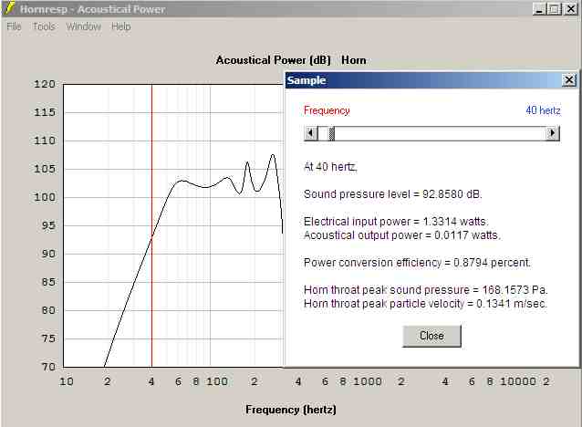

Okay, pretty much the only 15 I've found that works well in the 190 litre cab is the Kappalite 3015LF, giving massive 98.5dB sensitivity. I've had simulations of up to a flat 99.5dB sensitivity but only from a reduced Mmd version of the B&C 18TBX100.Hey, the check is in the mail Mr. Lewis. Also, I just noticed your post #2018:
http://www.diyaudio.com/forums/subwoofers/170771-single-sheet-th-challenge-202.html#post3853580
Why don't you whip up a variation of that for the Dayton Pro PA385-S 15" subwoofer. Put a design out there and let people pick it apart.
I have a 130L bass reflex cab simulation that the design works well in, but of course it will be less sensitive. The limitation of bass reflex is only being able to increase the sensitivity at the tuning frequency.
I have a more sensitive rear loaded/tapped bandpass horn (or scoop) simulation that it works well with. I haven't worked out how to fold it up yet. Bass reflex boxes are easy to build what you modelled! I originally used the 3015lf, then x the numbers by 13/19 (ratio of good bass reflex cab sizes).
This was only a hornresp graph, but I got similar and consistent results with many woofers, and I found I got a more Simplexx - like drooping curve if I made the cab too small. You probably gain a bit higher voltage limit on the Simplexx, but I don't know much about them or have the plans.And your Timplexx15 in post #2052 looks good - I like you word play with the name. Thanks
Interestingly, 9 HL10 woofers sim well in the cab if you could fit them in or could be bothered to spend the money. There seems to be a 'driver equivalence' dependent on Fs and QTS. Where 1 x 3015LF ~ 2 x 3012LF ~ 4 x BP102 (I think judging from BFM cabs) ~ 9 x HL10 where response in the same cab is concerned.
The Timplexx 15 and DJ's Dream are the exact same cab (post 2018). I have a 'Timplexx 12' (unpopular on the BFM build thread!) that runs 3dB less sensitive (like the JBL curve only going to 40Hz). I can confirm solid output to the 38Hz HP on just 15 Volts when corner loaded in my flat (detached of course!). I can see my ball lamp shades move, can't wait to try 40 Volts! It also models well with the Faital Pro 15HP1060 giving 80 Volts!
