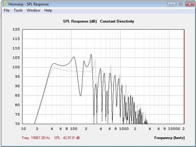

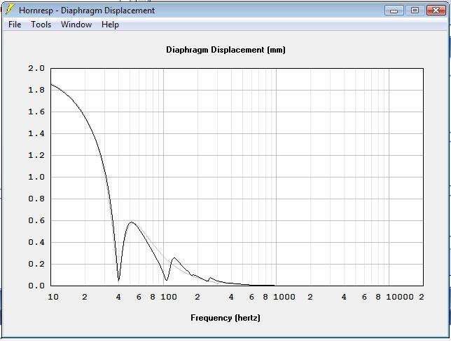

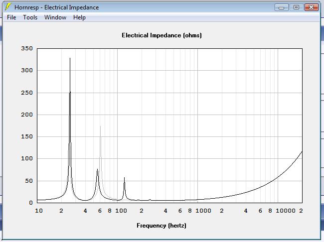

Okay, here it is: Here are 3 simulations
2.83V 1m, Impedance, and 2.83V diaphragm displacement for both a 360L tapped horn and the 190L 'DJ's Dream (TM)' 41.5Hz vented box.
They tapped horn runs a slightly lower average impedance, is 2-3dB more sensitive and has the same peak displacement.

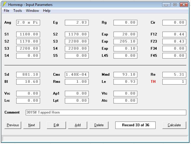

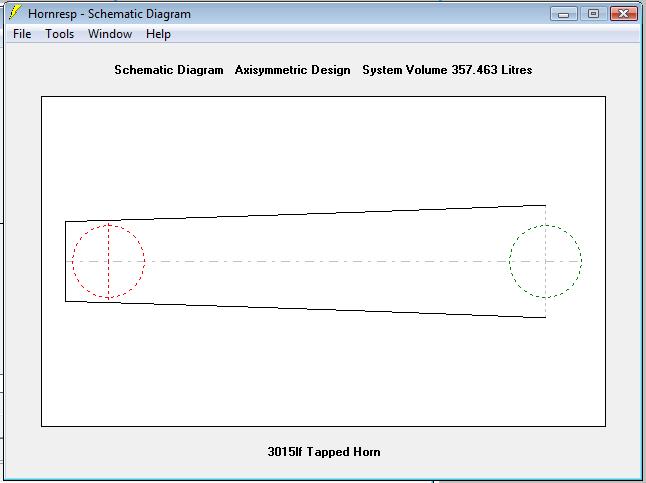

This is the first of my experimental procedures to design a tapped horn using the following algorithm I have conceived but have by no means mathematically proved:
1. Choose the response you want your tapped horn to do: eg flat to 40Hz
2. Choose the driver you want to use and design a vented box for said driver to make sure it is suitable for the above application. Note down the size (litres or cu ft) of the vented box that does what you want.
3. Pick the net volume of the tapped horn. It must be larger than the vented box.
4. The size ratio of the tapped horn and vented box forms the mouth area to throat area ratio of the horn.
5. The length of the horn will be about a quarter wave of the tuning frequency but has been known to get slightly longer (or shorter with a 1:1 I discovered) depending on the flare and expansion rate. If in doubt, check the displacement minima of the tapped horn and vented box line up. The 'compare captured' feature is useful here.
6. Experiment with different flare rates, scaling the throat and mouth parameters to get the total volume to the requirement. Experiment with driver positions within the horn. I found as close to either end as possible works well.
The box I simulated used a 2:1 ratio and an exponential flare. I've tried using 3:1 and more size ups with a 3015LF and also an HL10 which I presumed (being suitable for a 22L vented box at 40Hz) was farther from the efficiency limit and non linearity than a 3015LF, where you need even bigger boxes for that last 1dB. It ended up with the tuning and upper bass rising, and a smiling EQ shape, so mixed results for higher scale up ratios.

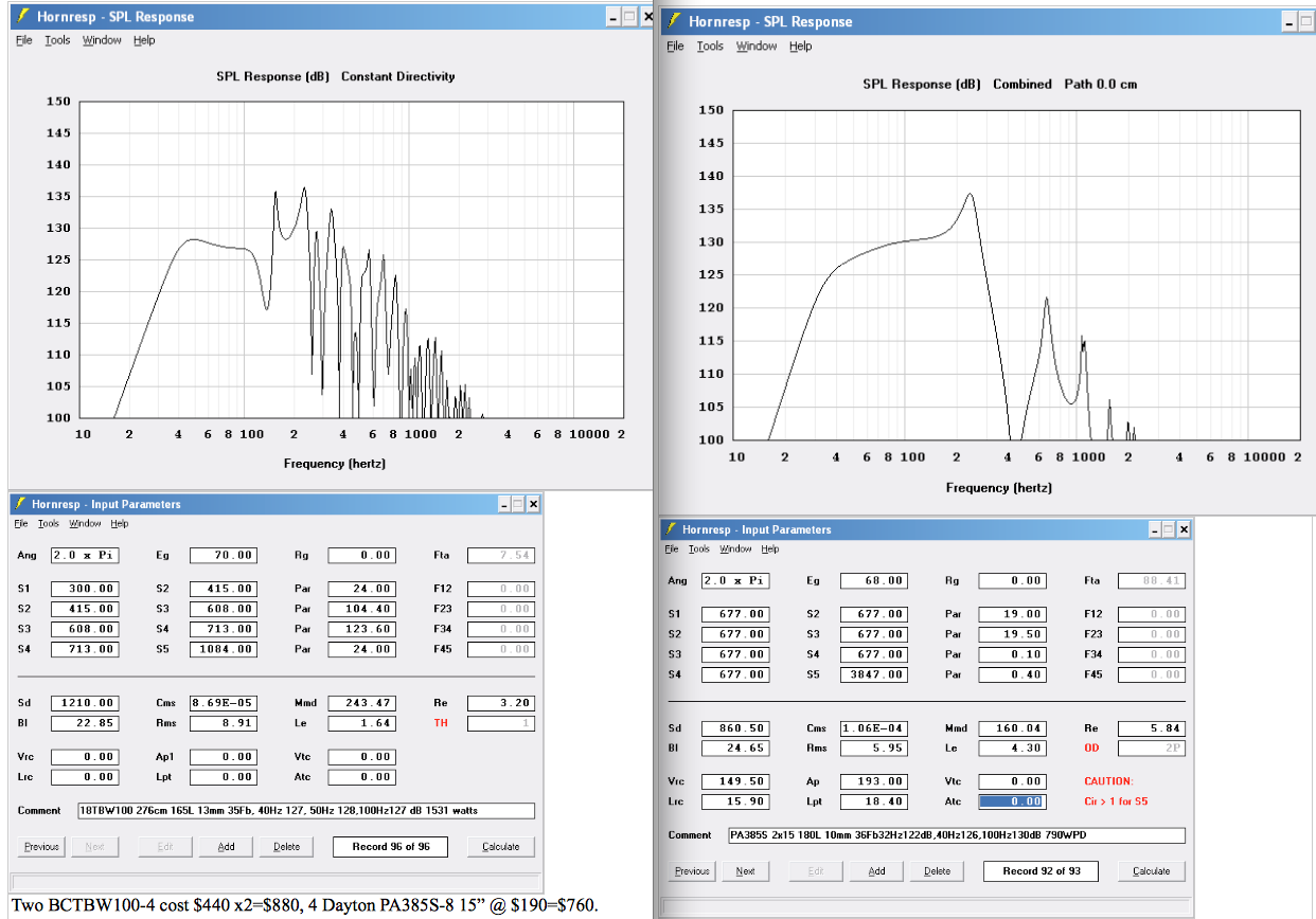

I dropped on of these Dayton PA385-S drivers into a Gallien-Kruegar bass guitar cabinet to do a preliminary test of it. The ported cab was about 3.5 or 4 cubic feet interior, ported a little higher that I would prefer, but the PA385-S proved to be a monster!!!! I put about 700 watts RMS into it and it wasn't farting out. Everything in my basement was shaking like crazy. My old lady thought it was the end of the world. Satan's is here!!!!!! Ahhhhhh!!!! HAHAHAHA!!!!!
Hey Gramps,Before you get started though, the T/S specs JWMPRO's used in his HR calculations are incorrect. They are the T/S specs that Parts-Express first published when the Dayton Pro PA385-S was first announced, but they were changed before it was actually released.
Heck, If you can do a good design, maybe I will just build your design and save myself any more pain of trying to come up with the ultimate fold myself.

The PA385-S unfortunately is an 8 ohm driver, which won't get as much power from my amp as a four ohm woofer like the BC 18TBW100.
The TH is on the left, cabinet volume was reduced by the volume of wood used by the horn.

The TH wouldnt be for personal use, and the person using them has (honda civic) size restraints for their subs, and only requires response to 40/45hz, making the original JWMpros cab kind of perfect for them. givin my wholesale account with PE, anything branded dayton is CHEAP (way lower than even the sale price you snagged them at).
It looks like with the new specs, increasing s2 helps bring back the low end resp (driver no longer requires 4:1 CR for "flat" response), however, doing this also increases driver excursion considerably (high compression ratio helps keep excursion down), thus decreasing max spl, while also resulting in a larger box. I was initially worried about the high CR requirements anyways, so I guess this isnt too bad (although it means I really will be doing a complete refold....)
I believe I can afford to add at least 2 inches to the internal width (bringing it to 19") as I've found thats generally the sweet spot for the back seat of a civic.
and art, the 385 has almost twice the cone weight of the 3015lf, almost the same as the 15tbw100 (within 5grams)... you think its still too low?
My mistake (was looking at the 18TBW100 🙄), the PA385S-8 is 172.5 grams mms compared to 181 for the BC15TBW100, way more than the 93.4 of the 3015LF.and art, the 385 has almost twice the cone weight of the 3015lf, almost the same as the 15tbw100 (within 5grams)... you think its still too low?
Considering the lesser Xmax, it should be as stiff as the BC15TBW100.
