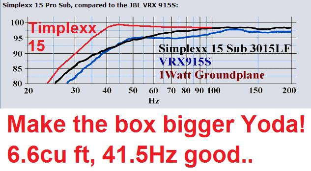

The reason I got the boot is cause of posting a build thread on the umm. Simplexx 12 Sub? I was looking for a temporary reflex box to house a 3012 lf subwoofer and posted a build thread. Got a warning for starting a build thread on a non bfm design. Fair enough.
In Bill's defence I did try to bend the rules by posting the pics up on my Omnitop 12 build while I ws waiting for parts. Maybe I should have built another Autotuba and run them as a pair in the corner.. whether or not it warrants account deletion when it could have been moved to Everything else is debatable. After all, no one cared when I fulfilled requests to see this giant horn I built when I was 19, though that was before I knew much about horns so I just drew a random horn layout and used 2 for 1 jbl gto 1264 drivers in it. Bits of it probably leaked or rattled but I could still shak conservatory windows at 15 volts per woofer on 20Hz! I suspect one could do better in a 4' by 2' by 4' box though.
On the facebook group it seems someone got scared I was gonna recommend some unsuitable expensive drivers for a cab. It was a Kappa 12 woofer they had for free in an Omnitop. Okay the Q was 0.01 below the minimum and the Xmax was only 3mm (so I suppose for very loud outdoor use it's not the best) but the midrange risibg response was there. Some panicky cab builder thought it would burst into flames or something ;-) Harley

In my opinion BFM has some very good designs, but others could do with a little work. E.g. I struggle to find an advantage to his Tuba 24 over a Kappalite 3015lf reflex box of the same size, or an SS15. (V-Plated with 2 HL10A in each cab they might be able to hang but then they couldn't win on driver prices). Sure it looks good compared to some random 95dB sensitive Yamaha that rolls off at 60Hz, but if you're not getting at least 98dB sensitivity flat to 40Hz out of a cab that size (easily done with a 6.6cu ft reflex tuned to 40Hz), then it's only good for bragging about what you can do with a 10 inch driver.

I also wonder why the Simplexx subs seemed to roll off earlier than potentially possible, as in the attachment. Is it to make use of other drivers with lower box size requirements? Is there some destructive wavering of the cone that can happen at high power that Bill knows about but I don't? (Is it to make the Tuba 24 look better?)

Why don't you whip up a variation of that for the Dayton Pro PA385-S 15" subwoofer. Put a design out there and let people pick it apart. I had a forum topic here a while back about designing a tapped horns. It was humiliating sometimes, but the amount of information I gained was completely amazing. This is very different than the BFM forum, where you can't criticize a design. Here critiques are encouraged. There is always someone that is willing to help you understand something that you are having a problem with.
