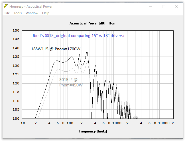

Hi Y'all,
Post #2122: "...the SS15 is not a 40hz subwoofer..."
Correct, it wasn't meant to be.
Post #2123: "...sensitivity is what we CANNOT lack here..."
Well, it's always a trade-off. If you have enough power, and don't mind loosing a little SPL in the very low end, you can put a B&C 18SW115 into the SS15. 🙂
And, you could redesign the throat area, and end up w/ a little bit more compression for the 18SW115, and a bit more duct length (not enough to matter). The 3015 does not take kindly to additional throat compression, but the 18SW115 is so robust, it can take it even at much higher power.
Don't forget the HP (high pass / low cut) filter.
While the peak output in dance music is about 55hz, you must be able to put out 40hz with authority.
While my systems are flat to 30hz, I pay a size penalty (24H x 36W x 30D) for the one or two songs a night that go below 40hz.
Two cabinets stacked are 107dB/2.83V/1M and a 4Ω minimum load (around 30hz).

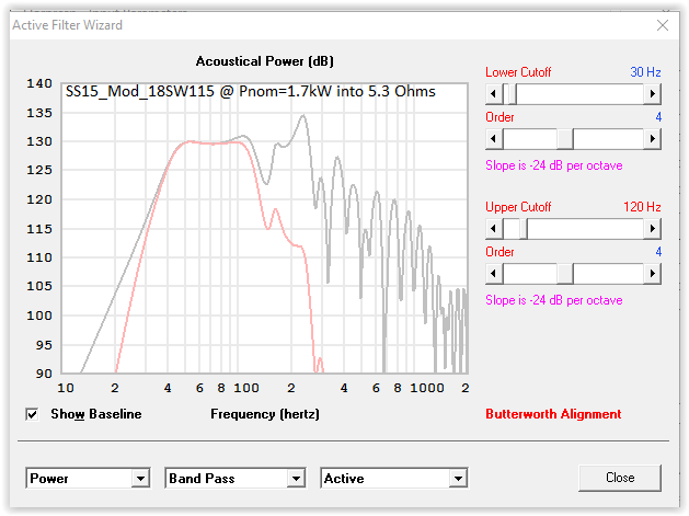

Hi again,
Just for the fun of it, here is the SPL from the Hornresp Wizard using "throat compensation", and the B&C 18SW115. It can be safely assumed, that this driver will take program peaks around 3kW instead of the Pnom=1.7kW. Not so sure if the 1/2" plywood will take it. 🙂
