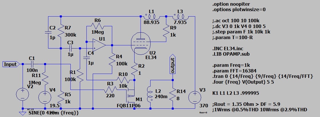

I would like to propose this variation I was simulating yesterday evening.
The feedback squashes the distortion when it becomes very high as pentodes easily do.
Then I've applied 23% UL (it will simplify the PSU as well), obtaining the following:
Rout is 1.35 Ohm that gives a DF of 2.9
0.5% THD at 1 Wrms and 2.9%THD at 10 Wrms
but mainly... it can be easily driven by a DAC without any driver stage.
On top of that, with this feedback configuration, it partially increases the bias current flowing thorugh the tube when the anode is going up, so in fact increasing the available swing on top. I can indeed increase the voltage of the working point and get more power because I increase the power dissipation where it is usually lower.
...so... what am I doing wrong?

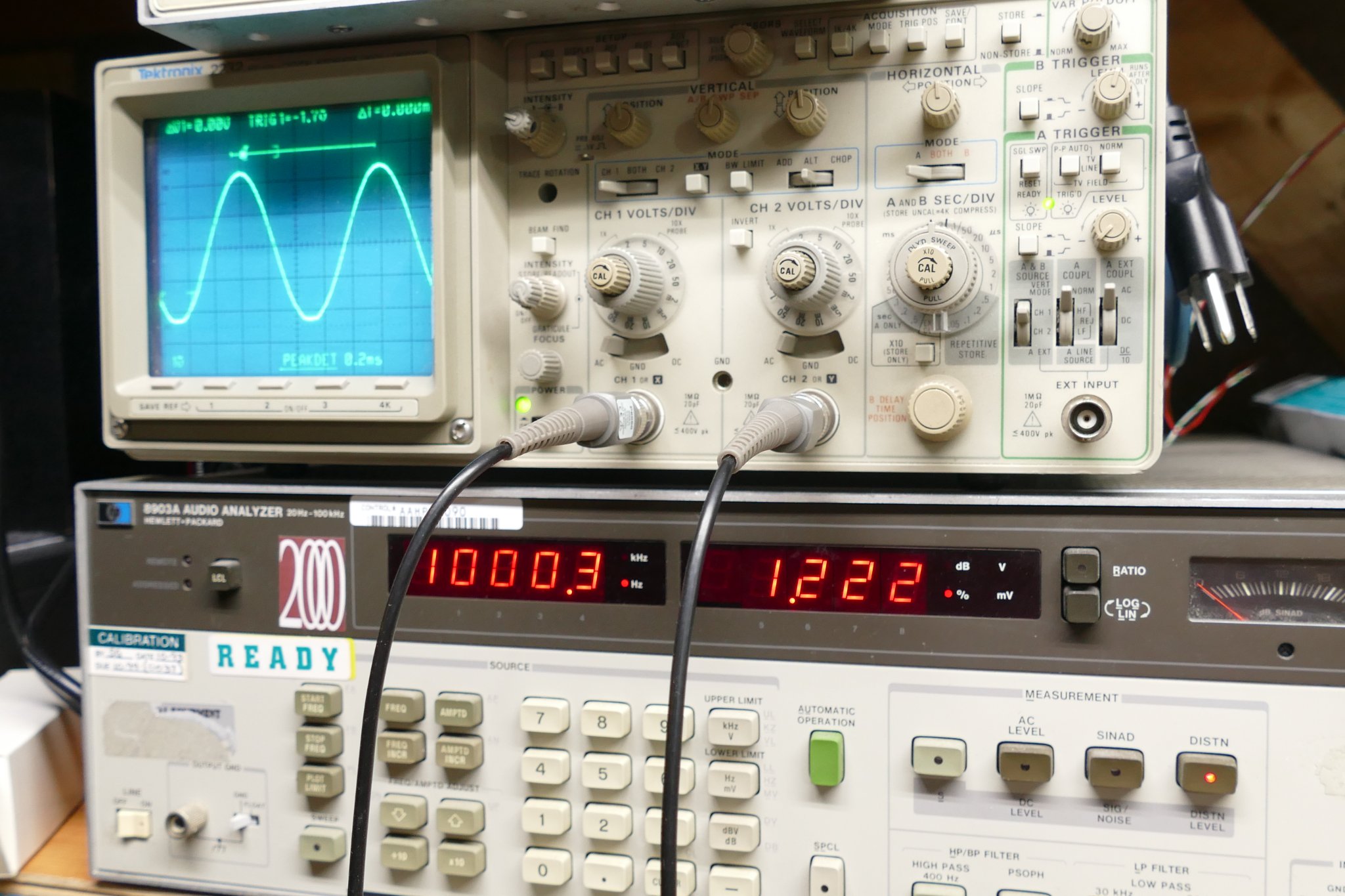

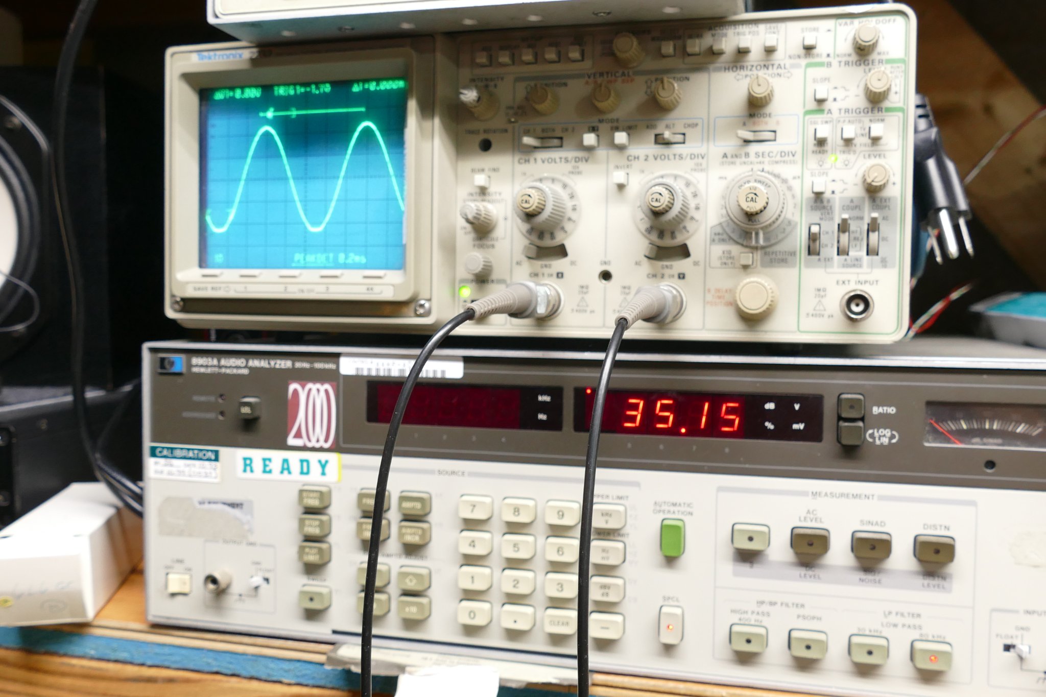

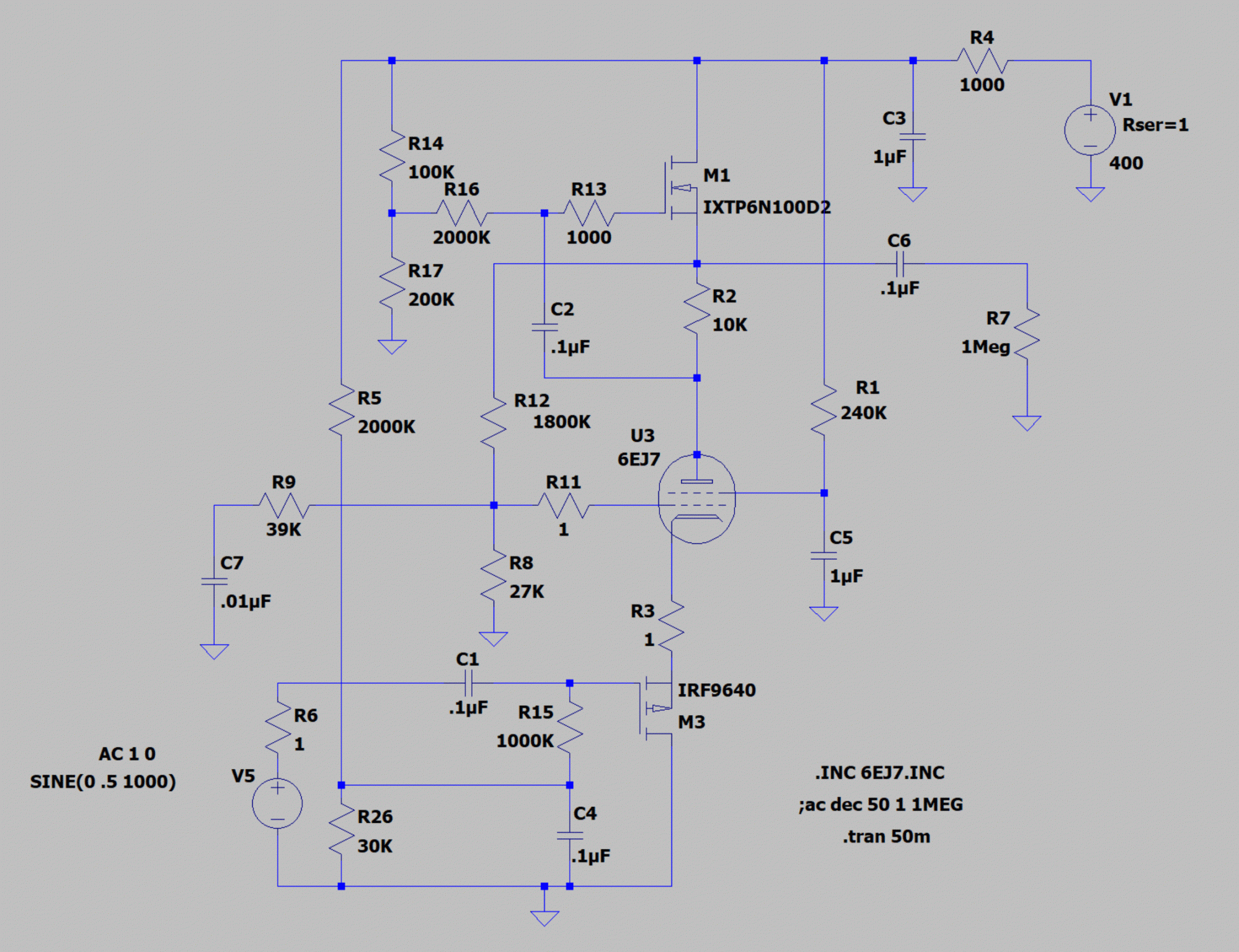

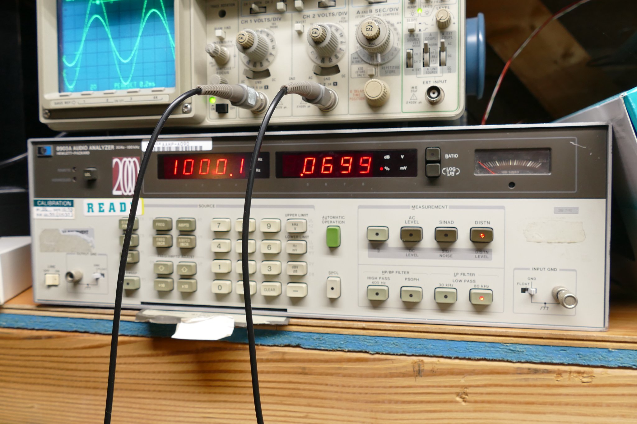

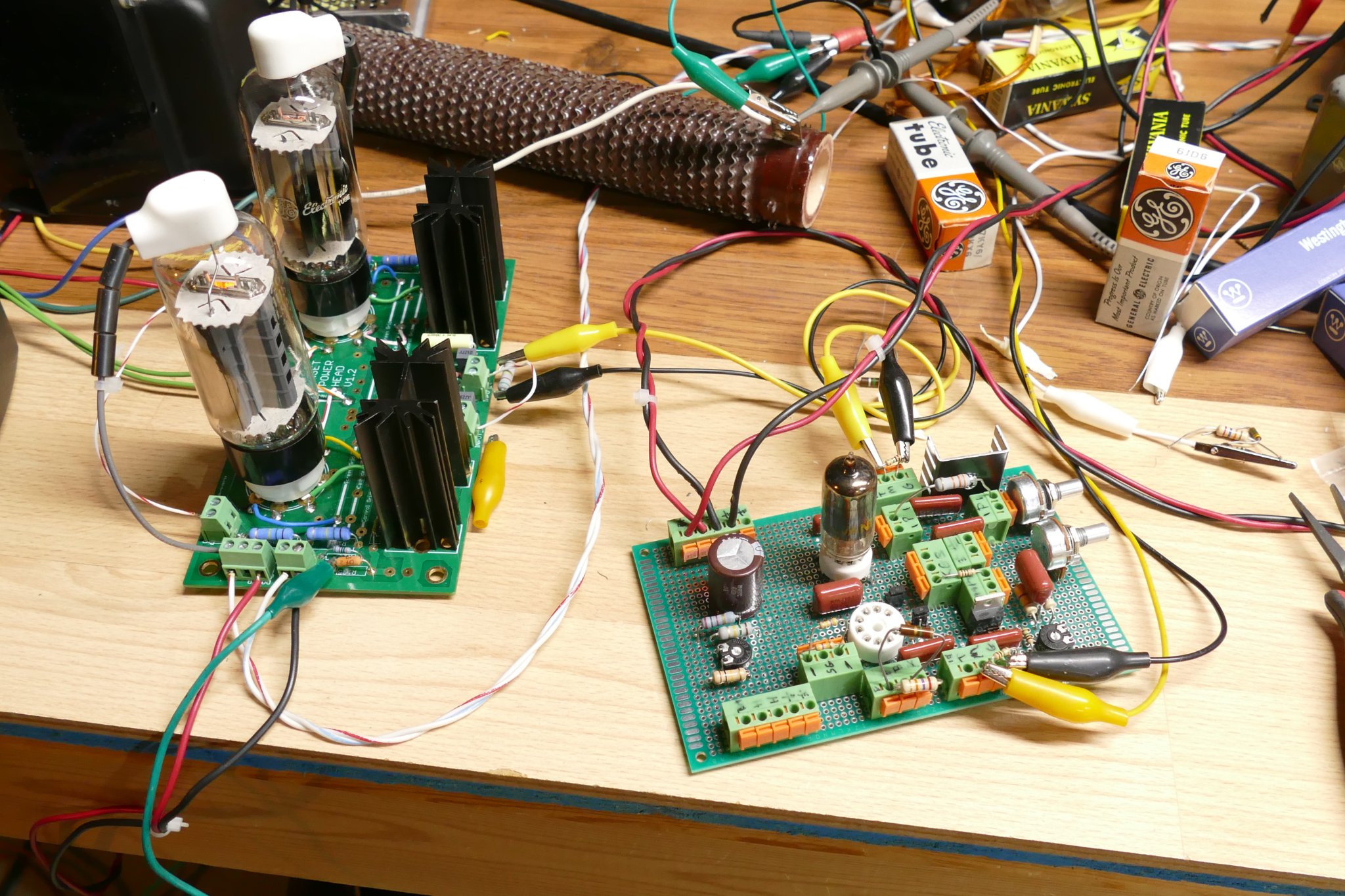

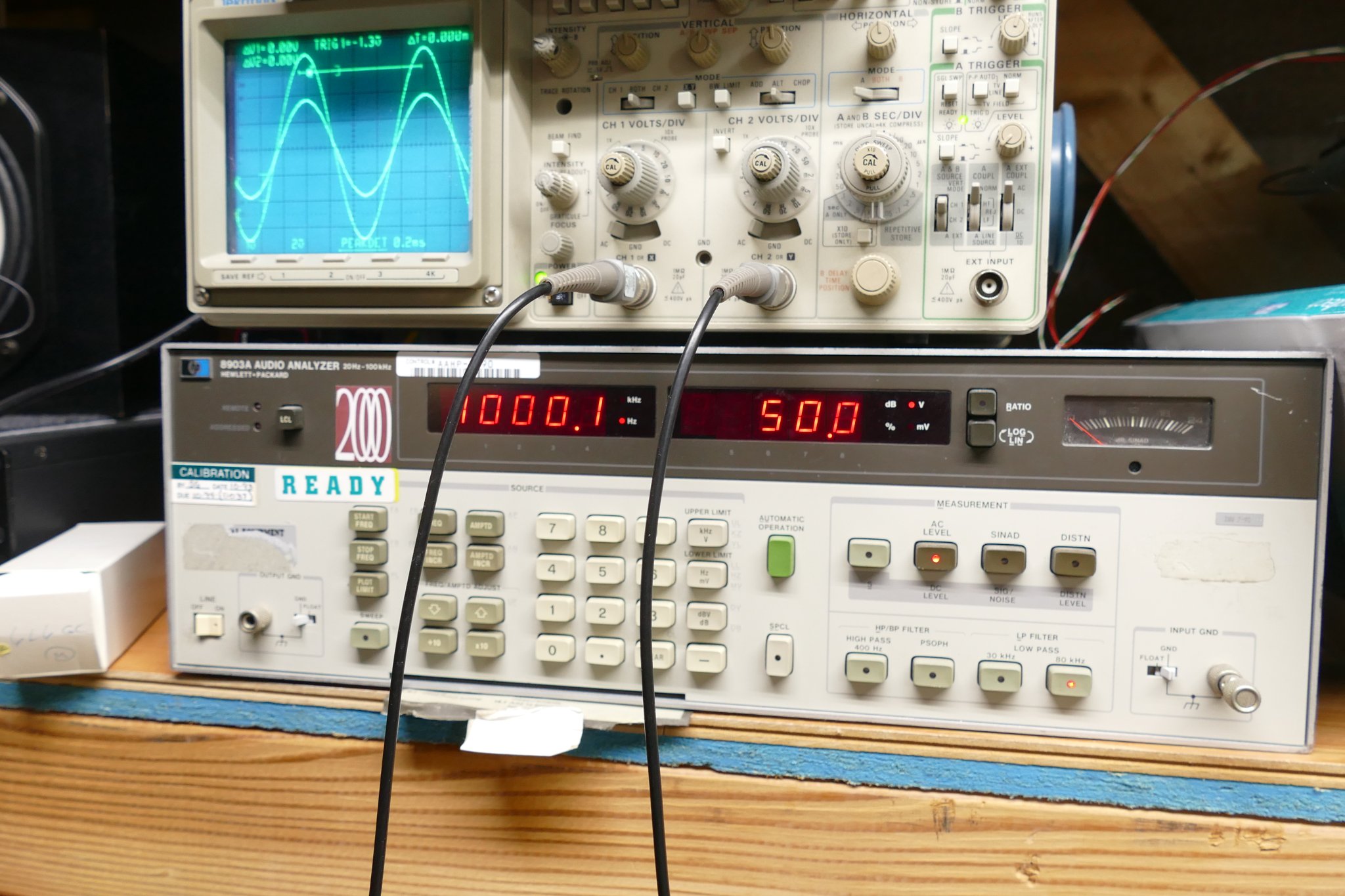

Some experiments intended for guitar amp signal mangling have accidentally led to a unique driver circuit that makes lots of drive voltage with very low THD. I decided to apply the UNSET concept and the SATURATOR ("Gyrator" loaded pentode) used in some of my guitar amp designs to the same circuit. Some tweaking can get lots of gain, really low distortion, or a balance of both. A little $1 tube is seen here making 50 volts RMS of drive at a gain of 50 with 0.07% THD, which is not much more than the residual THD in the oscillator. Feed that into an UNSET output board with both 26HU5's wired in parallel through a crappy old Hammond 1628SEA wired for 2500 ohms and you get 35 watts at 1.22% THD in SE. I may try to splice that back into the UNSET PC board someday. I have enclosed the asc file for those who like to simulate. Some component values have been tweaked since the simulation was done. The tube for these measurements in use is one of the many 7 pin tubes that I tried. Most work well, as do the 9 pin flavors like the 6EJ7, 6KT6, 7KY6 and a few others.

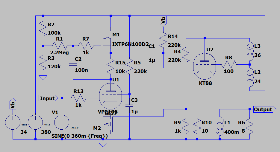

Hi, I used some GU50, KT88 and 6550 on a 3k and EL34 on 5k Ra.
I've preferred 20% feedback for the first three and the standard 10% shown in the schematic for the EL34.
Every stage with local feedback only. I still need to test the Corr.Diff. feedback directly driving the cathode of the driver.

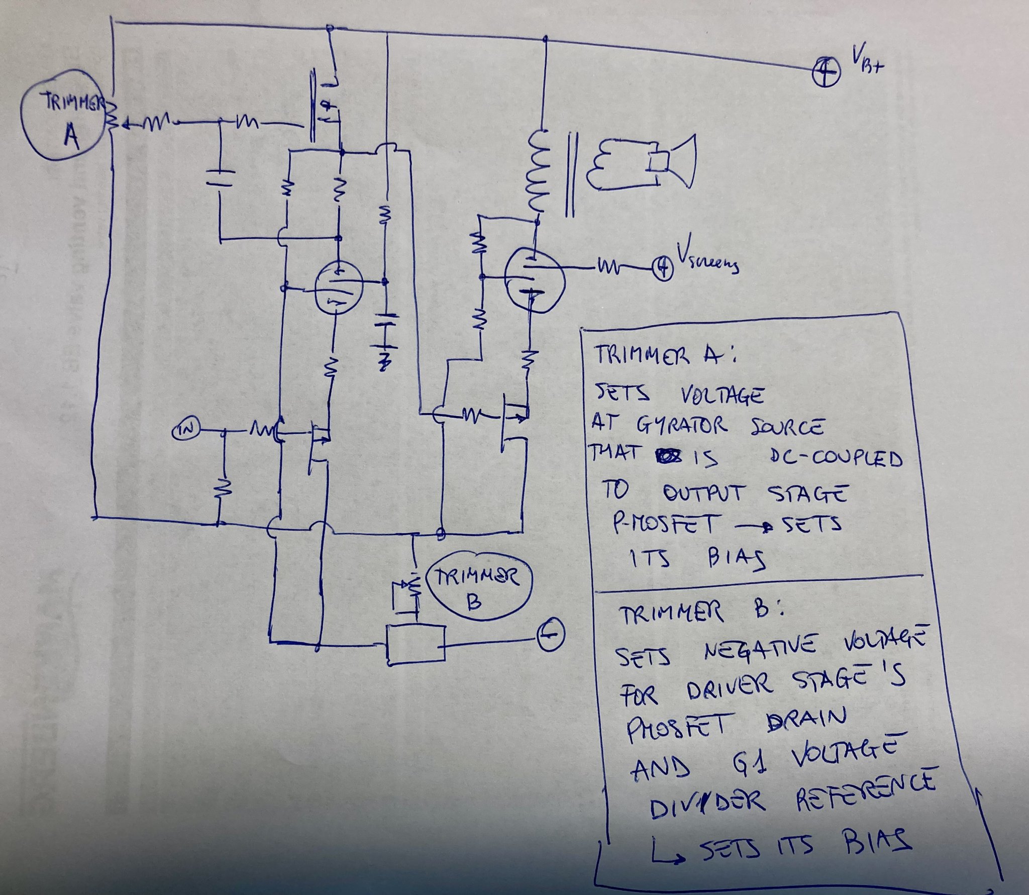

What would you use as a SS FETSET driver capable of eating 5-10mA?
I would like to try a fully dc-coupled amp:
  1. DRIVER:
    1. the gate of the pmosfet source-follower grounded;
    2. the drain of the pmosfet source-follower connected to a regulable negative voltage (that sets the bias of the stage);
    3. the gyrator you have shown here as a load for the nmosfet used as driver;
    4. the source of the nmosfet of the gyrator dc connected to the gate of the pmosfet source follower of the output stage;
    5. the Vdc of the gyrator used to bias the output stage.
  2. OUTPUT STAGE:
    1. UNSET standard configuration.
What do you think about it?
Can you suggest a nmosfet to be used as a FETSET driver?
I would like it to swing 200Vpp (to have margin on the needs of the output stage, without exceeding SOA of the pmosfet source follower of the output stage).
The idea to use a nmosfet is because it can go down to few volts above its negative reference, that will be few volts below zero, so it should swing close to zero volt, fully driving the output stage to its A1 limits.
I'm not sure I get the correct picture of your driver stage from the description; a schematic would be helpful.
Can you suggest a nmosfet to be used as a FETSET driver.

The circuit seen in post #244 should work with most fets, depletion or enhancement as the gate voltage comes from a voltage divider. The source voltage will vary by a few volts with the fet change, but that will not affect the circuit much.
The circuit shown in post #1 must use a depletion mode fet for M1, the CCS plate load for the 12GN7. Here the bias voltage is developed across the source resistor in a manner similar to cathode bias on a vacuum tube. For this to work the gate must be more negative than the source in normal operation. This requires a depletion mode fet. Here both Digikey and Mouser have the IRF830 and the IXTP08N100D2 priced at $2.44 for the IRF830 and $3.05 for the IXTP08N100D2. Unfortunately neither vendor had the IXTP08N100D2 in stock.
Just a sketch to explain the point:
  1. the bias of the driver is set by the negative voltage (set by trimmer B) of the drain of the pmosfet and g1's voltage divider, while the gate of the pmosfet is grounded, so dc coupled to the input;
  2. the bias of the output stage is set by the voltage of the source of the gyrator mosfet on the driver (set by trimmer A)
The driver must be able to swing to 0 Volts to push the output stage to the limits of class A1.
Here I sketched a pentode, but a n-mosfet on the driver would help to swing closer to 0 Volts.

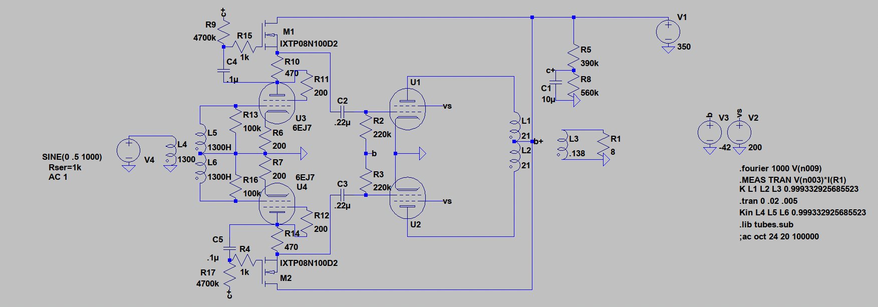

I have attached my rendition of your recipe with 6GE5s as outputs, and 6BN11/6EJ7 as the drivers, any comments? the input trans is 10k: 10k+10k and output load is 6k6 if i did not remember wrongly
