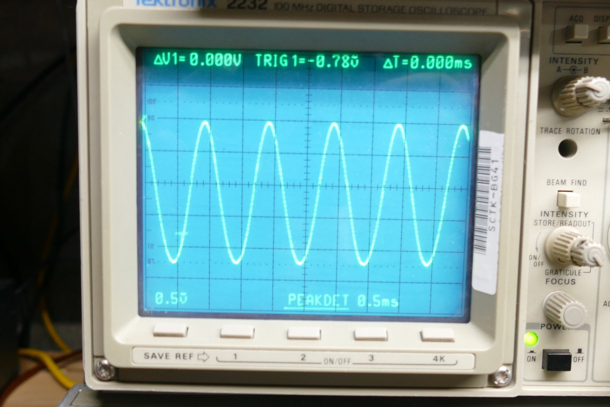

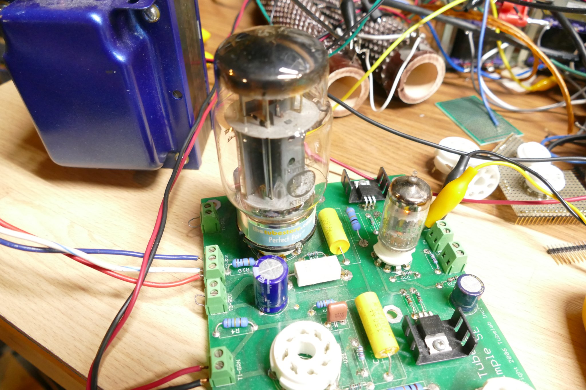

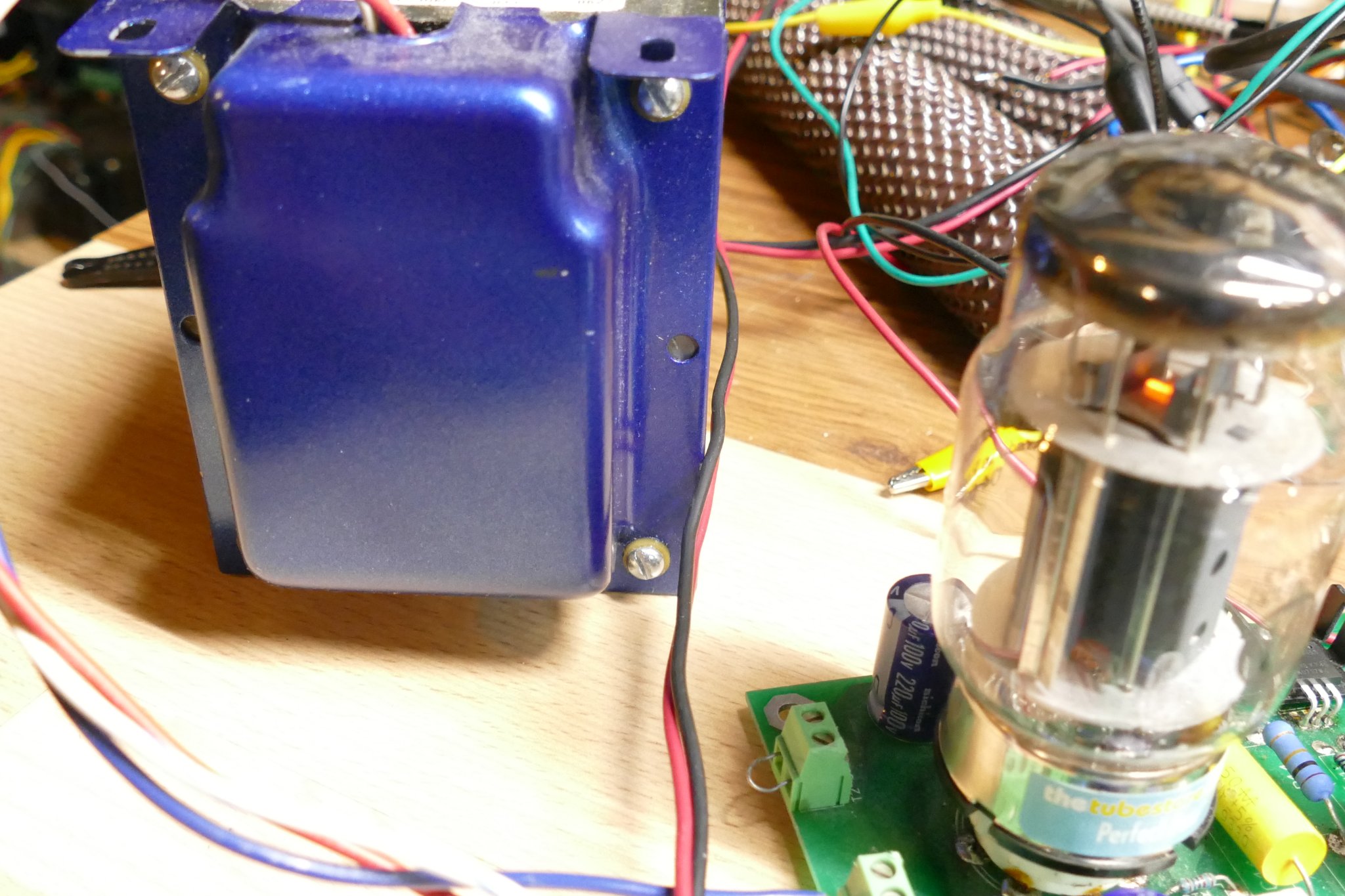

I grabbed Tubelab Simple Single Ended (SSE) board number 1 which was populated in 2006 and used for experiments ever since. Some of these have ended badly with more than one exploded cathode bypass cap due to runaway tubes being pushed far beyond their limits, I hooked the board up to a variable bench power supply that goes to 600+ volts at up to 1.7 amps. I grabbed a 2006 vintage Edcor OPT off the same shelf. Yes, all of the early vintage Edcors were painted "pimp my ride" blue before dialing it back to their current color. I plugged in a Electro Harmonix KT88 from the same shelf, probably 10+ years old, but in good condition, hooked up an audio generator set the power supply to 500 volts and hit the switch. I did not connect up the cathode feedback, so this experiment was done with zero feedback whatsoever. The circuit is a CCS loaded 12AT7 cap coupled to the grid of the KT88 with the screen connected to the UL tap and the plate to the plate tap on the OPT. The cathode has a 560 ohm (measures 561 ohms) resistor and a 220 uF cap to ground.

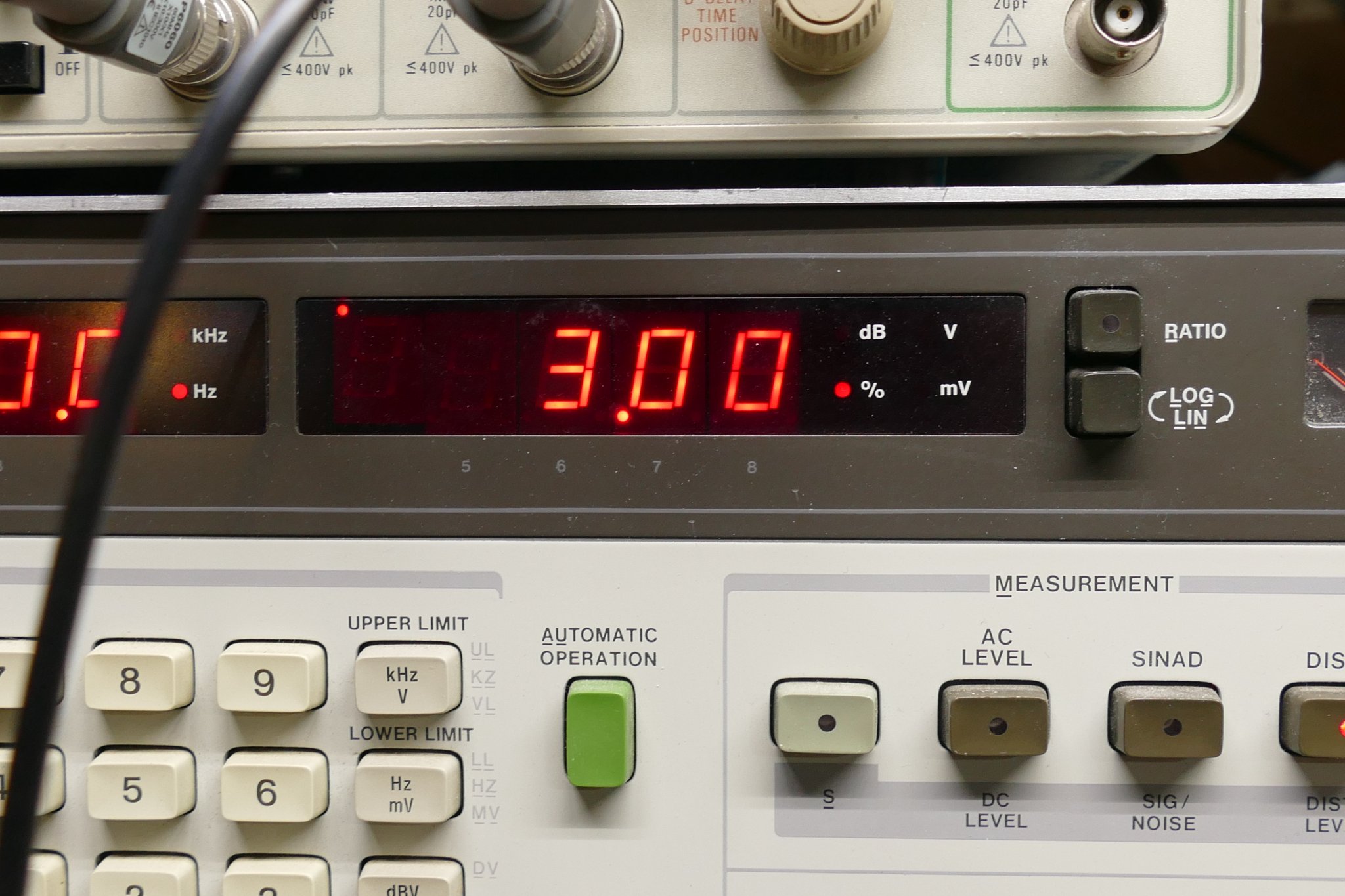

I cranked up the signal generator until the 8903A audio analyzer read about 3% THD, then entered the "Watts into 8 ohms" key sequence. The display read 14.88 watts. THD at 5 watts is 1.2%
The cathode voltage was measured at 49.6 volts for 88 mA of tube current. Total board current is 112 mA with 504 volts applied. Both halves of the 12AT7 are operating at about 10 mA though one is driving nothing in this experiment. Plate voltage measures 497 volts due to OPT DCR. This puts 447.4 volts across the tube at 88 mA, which is 39.4 watts. The output power is 14.88 watts for a total output tube efficiency of 37.7% (includes screen current). Of course the tube will still be burning up almost 40 watts when the volume is turned down, so the efficiency drops as the power output is reduced and becomes zero at idle.
I connected up the cathode feedback. This moves the ground end of the cathode bypass cap to the speaker terminal. It also moves the "power at 3% THD" up to almost 16 watts, and THD at 5 watts to 0.86%.
When a similar amp was my daily listener amp, I used the cathode feedback and a KT88 for loud or bass heavy music, but preferred a triode wired EL34 with no feedback for "female singer and a guitar" music.
