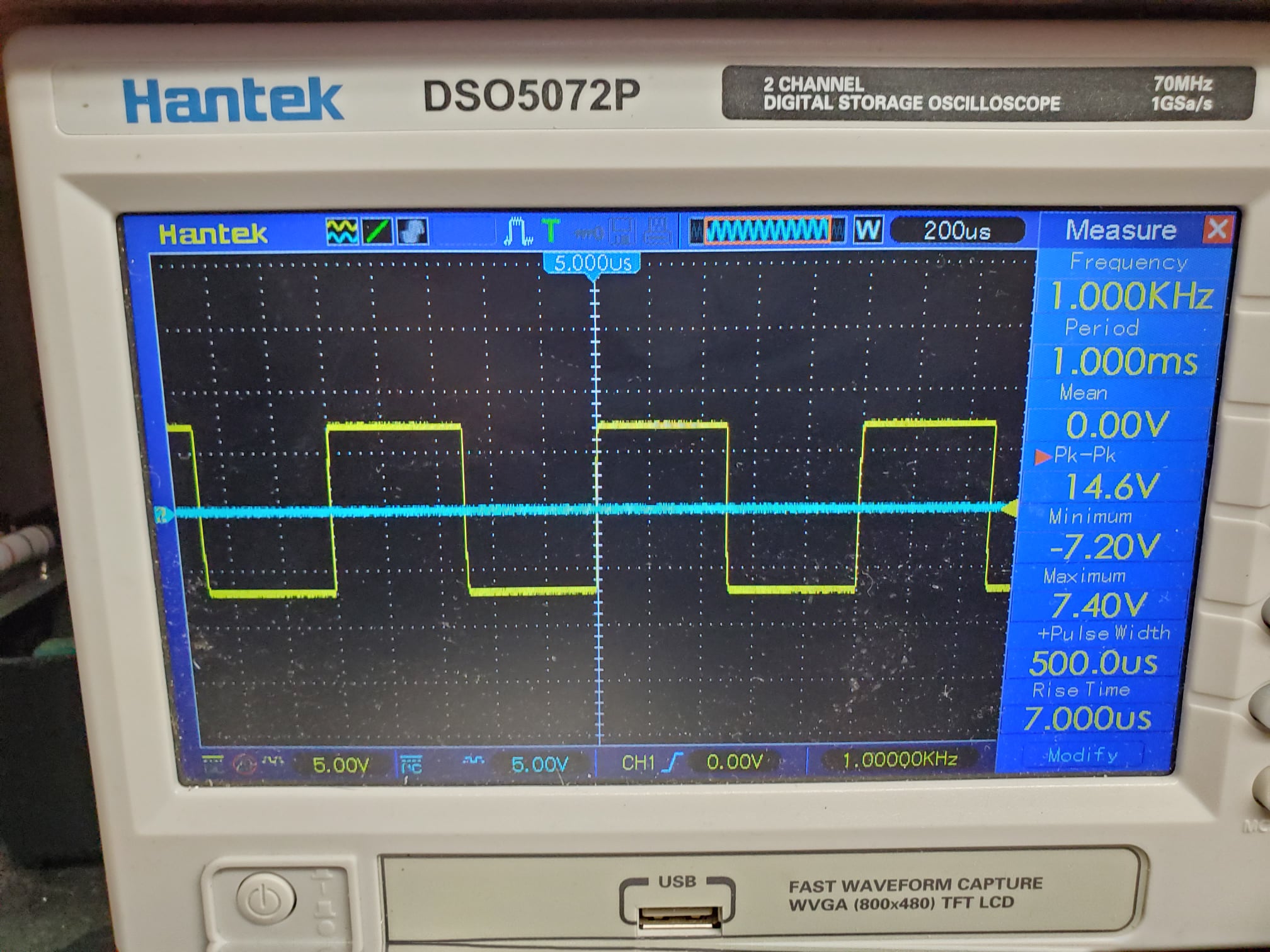

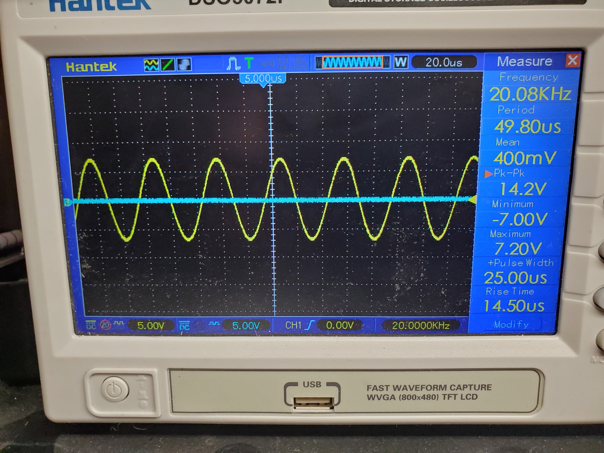

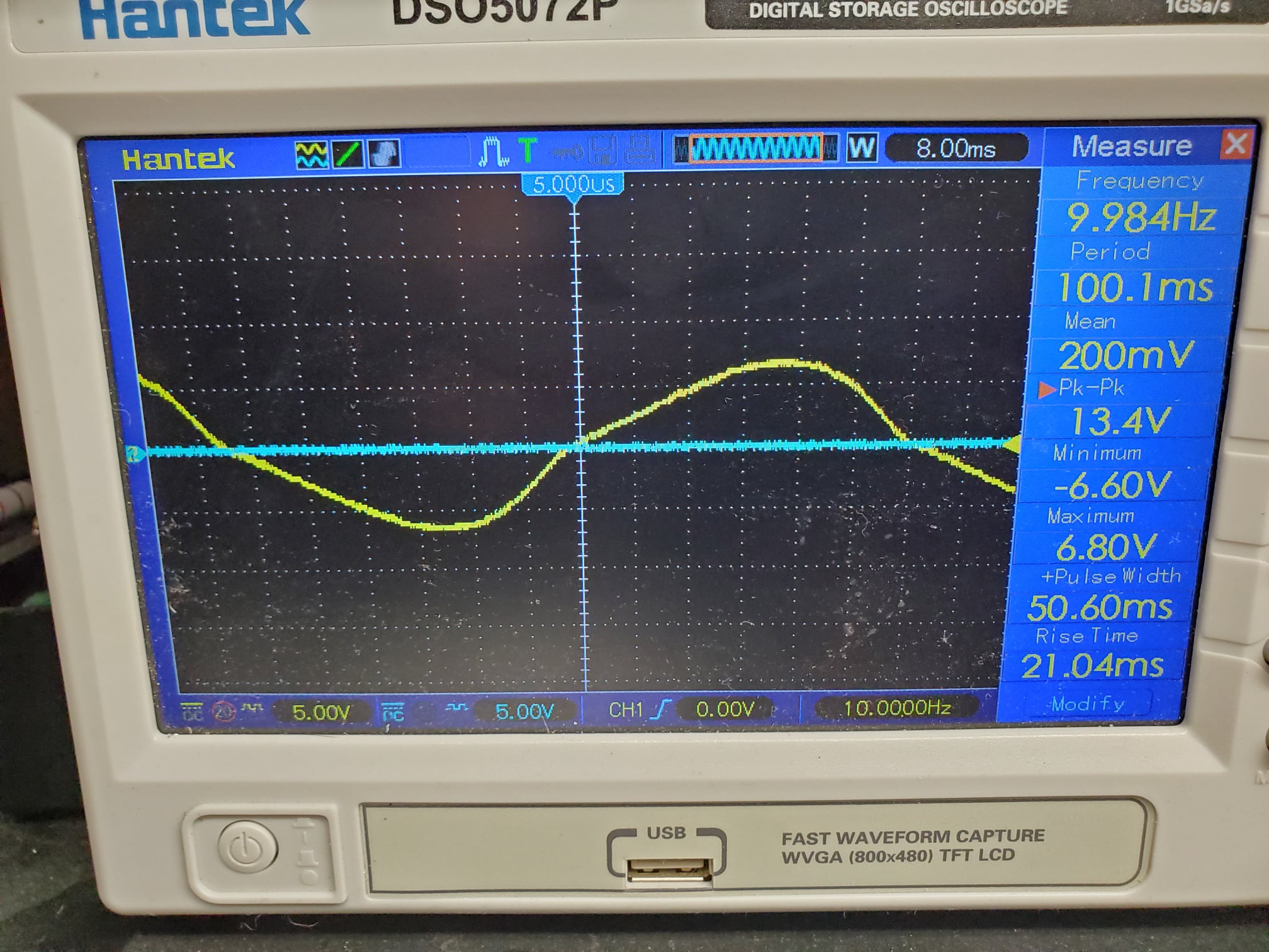

For the last several years my only working guitar amp has been the little 4 tube ultra low buck amp I designed for the Hundred Buck Amp Challenge over 10 years ago. Total parts cost, under $50 in 2011. I built that amp to show that a good sounding 4 watt tube guitar amp can be made for low $$$. Several years later I ripped it apart and started tweaking parts. At one time I had 6 or 7 pots wired into it along with a bunch of caps and DIP switches. I spent about a month optimizing it, then made a new PCB and still use the amp today.
I learned to play guitar in the early 60's. Living a bicycle ride away from the Atlantic Ocean meant that the radio always played surf music, so that's what I played. Surf music requires reverb, and a reverb tank is bigger than my whole amp, so it's time for a new one. This will be a "start from square one" approach so for now anything will be considered and the sounds i get will control which direction I go toward. Most of the FX will be included, and tubes, transistors, and IC chips are all allowed, and likely some of all three will be included.

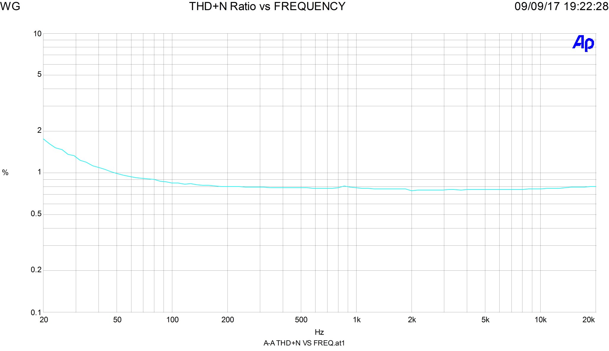

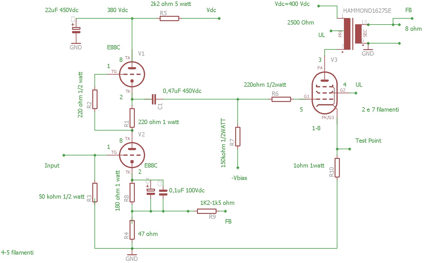

This is the amp s.e. proposed on Audioreview magazine

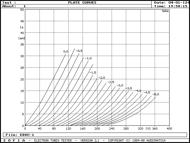

It is easy to build the E88C, single triode is a beautiful tube with good gain na not so difficult to find. An alternative is 6FQ7/6CG7, very good, double tri
The Ot is HAmmond 1627se , good price for a reasonable quality.
The FB is 6dB.
This is a THD vs freq at 1 watt very good shape
The freq. response at 10 watt, some proble at high frequency but the OT has some limitation, of course
The FB is 6dB.

I like it in some application as this one.I’m not a big fan of SRPP
The E88C is a good tube bu it is a single triode.

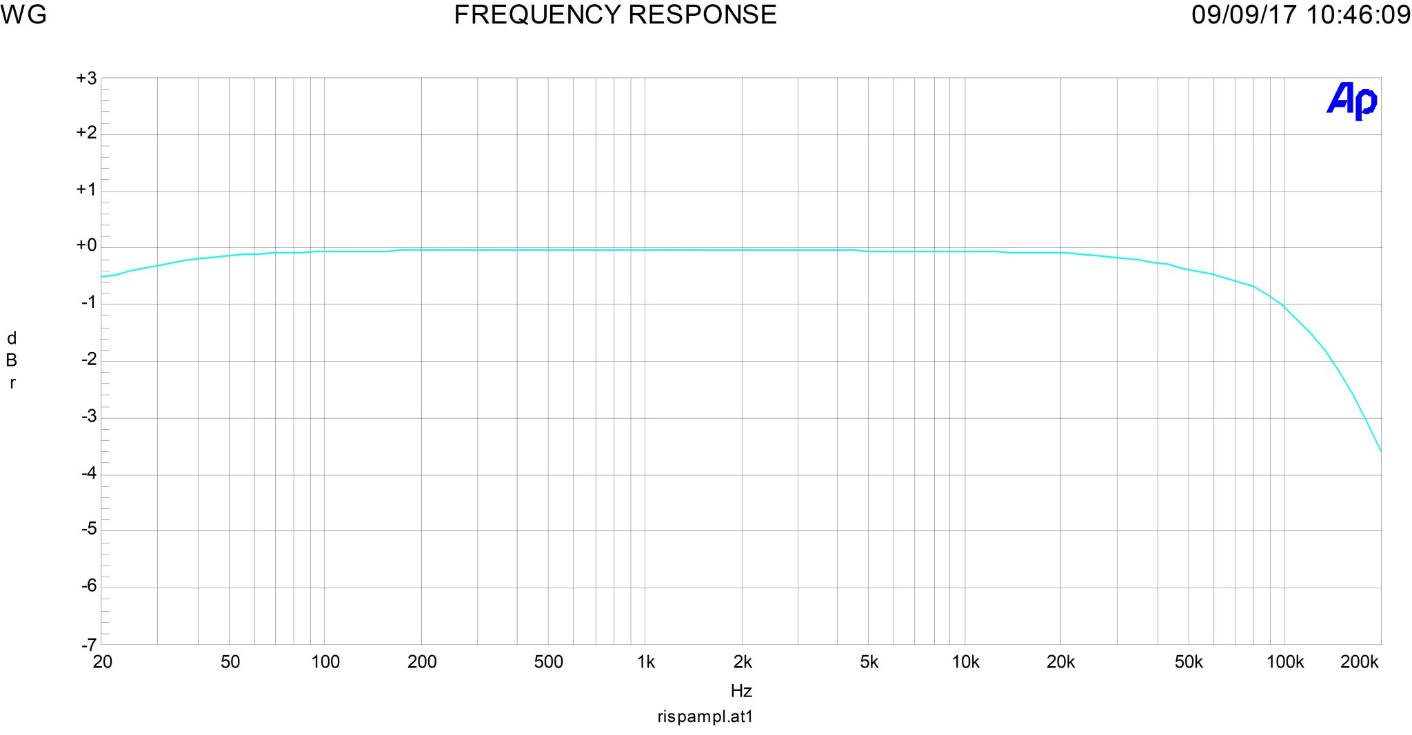

These are the curves from my Sofia

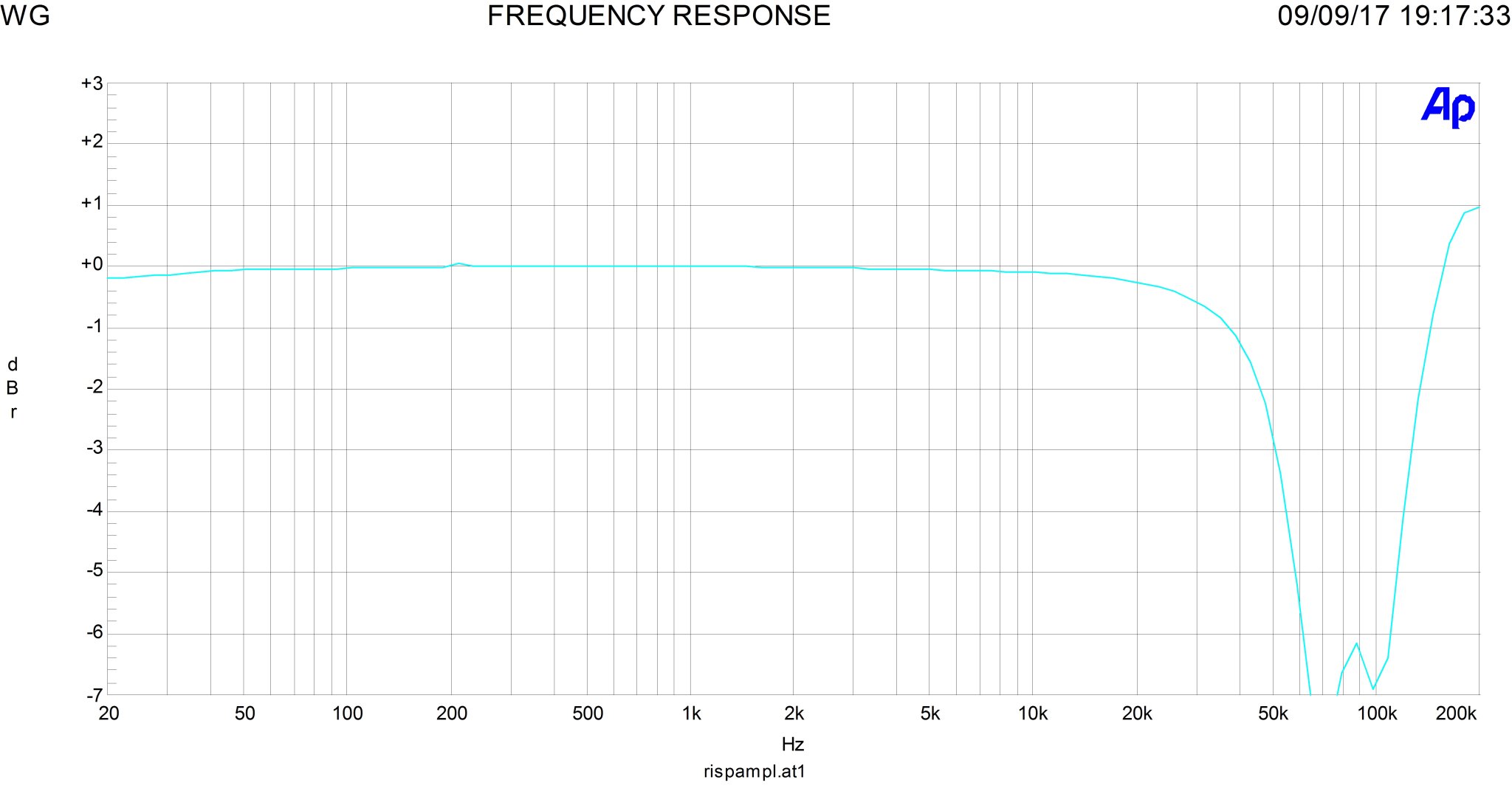

This is the freq. response of input stage
450 mV Vin, 20 Vout 0,6% of THD; -1dB at 100 kHz is enough
About grid stopper of course is possible to use, in this case I haven't met any problem.
About 0,8% THD I consider it a good value mainly because it is almost costant for a wide range of frequency that is very important; the FB is only 6 dB
And, at the end, the Hammond iron is a reasonable stuff considering the price even the value of inductance and parasitic is not so good.

I have by mistake a lot of these E88c tubes. Is the powertube a 6L6? Is it sensible to built this circuit with a OPT without a UL connection?
The power tube is KT150 but other as 6L6 can be fine checking the specs about Pa and current.I have by mistake a lot of these E88c tubes. Is the powertube a 6L6
I think that a 6L6GC ( the strongestof this family) with 350 Vdc with 70 mA can be a good start point
Of course you can use other OT with 6L6 in triode connection so the Z of trafo can be around 2k5-3k5 kohm. It is a very good solution for me.

I rejected this idea for future designs. It is nice that smaller cheaper transformers can be used, but since CCS is modulated, the result is like in the middle between SE and PP. Fair SE sounds more pristine clean, soundwise. You may see attached pictures: full power 12W from 20 Hz to 20 KHz, no ringing, Edcor transformers. I am currently using it with Klipsch Chorus speakers to listen to Tidal Hi-Fi.
Feedback by current though is great, especially when I can deal it in from negative to positive to demonstrate that Damping Factor is a marketing hoax since output impedance of the amp does not damp resonances alone, it works in series with DCR of the speaker itself, so if to compensate it partly we can get a real electrical damping.

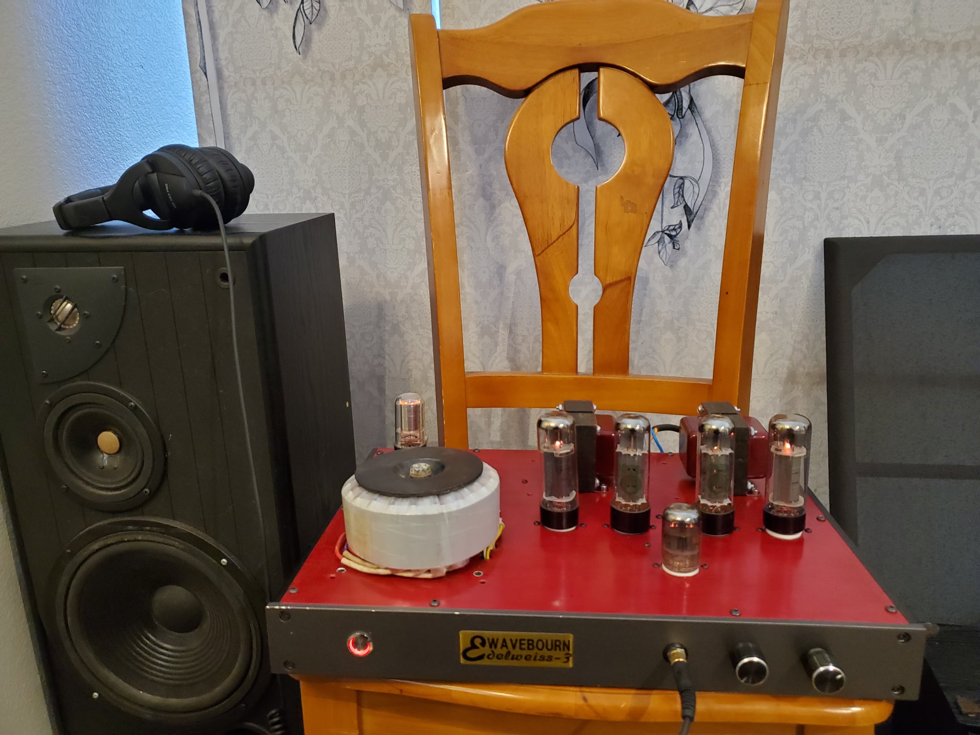

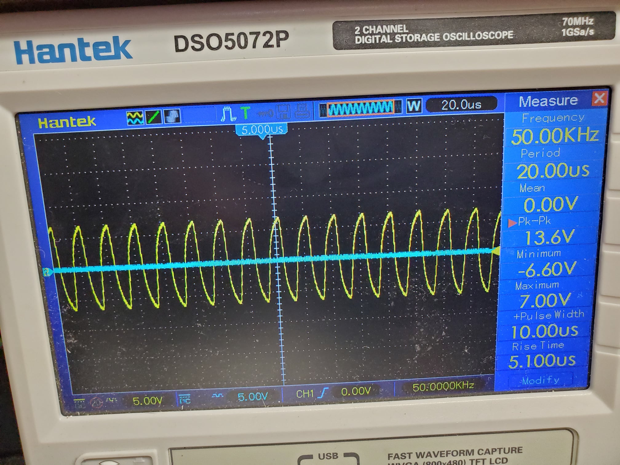

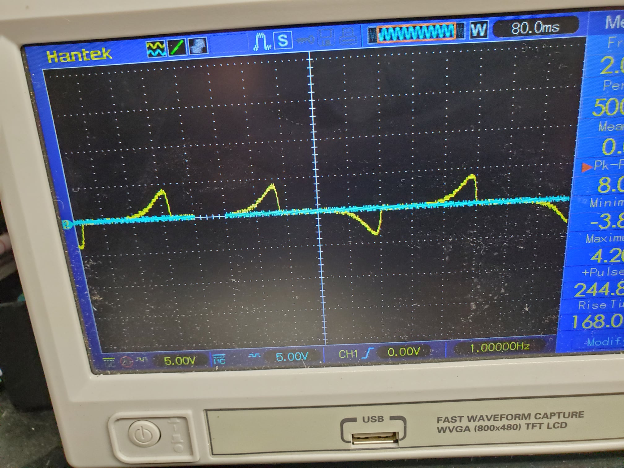

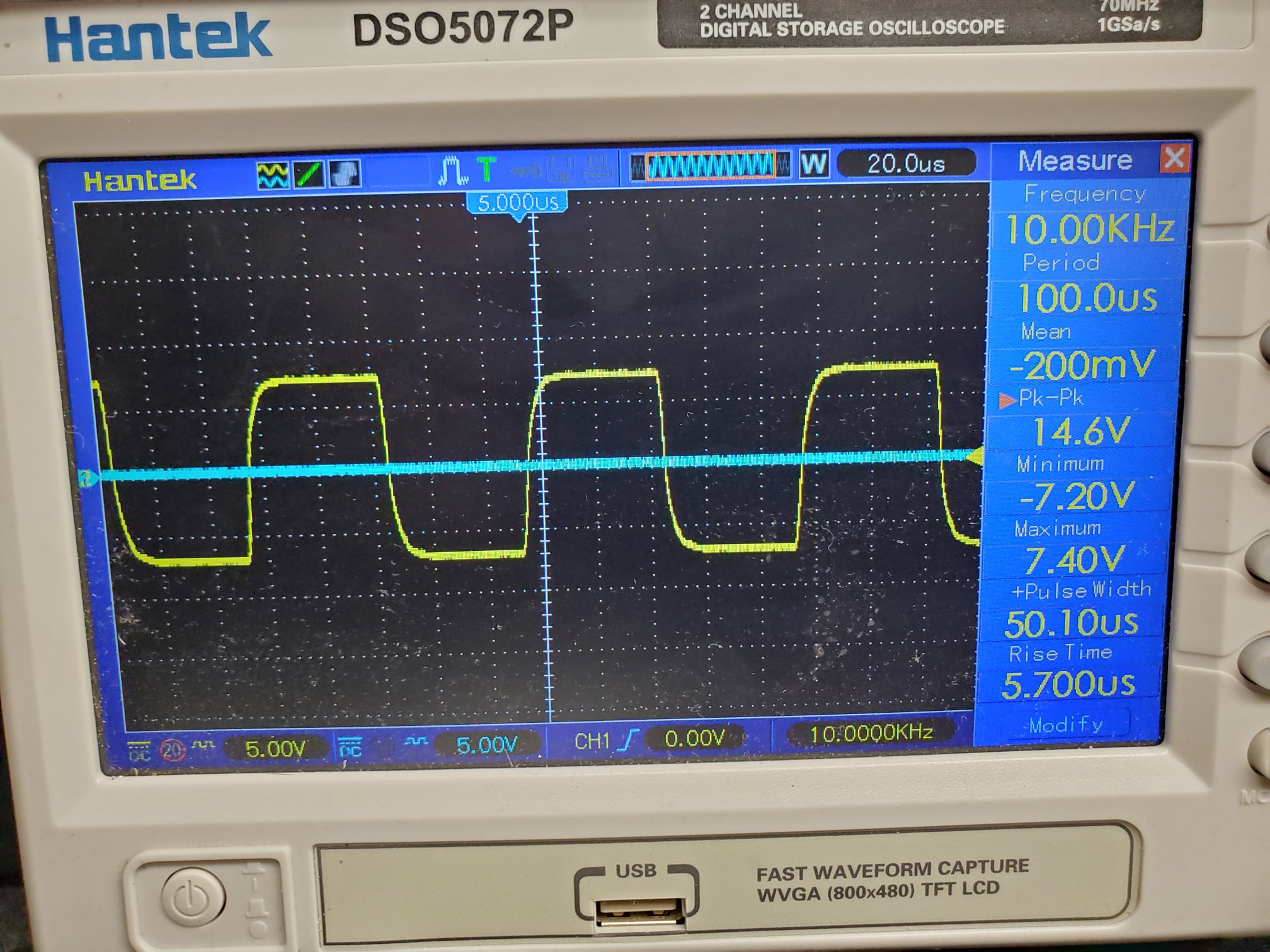

Thank you for answering! It is indeed reasonable that even if at high impedance, the “pull” will partilly act cancelling harmonics.since CCS is modulated, the result is like in the middle between SE and PP. Fair SE sounds more pristine clean, soundwise.
Thanks again, so you suggest to go into negative output impedance to properly dampen speaker resonances.Feedback by current though is great, especially when I can deal it in from negative to positive. it works in series with DCR of the speaker itself, so if to compensate it partly we can get a real electrical damping.
Yes, the pulling current modifies natural harmonic profile that resembles dependence of harmonic on loudness in nature, so it sounds less natural, even if distortions are very low according to measurements.
In my amps output impedance can be adjusted by a single knob from minus 3.8 to plus 3.8 Ohm. I did not make it wider because over-compensation of DCR causes oscillation of woofers. I got lucky and found plenty of low ohm double pots for that, before that I used rotary switches with low ohm resistors.
Sure, negative impedance is the way to compensate DCR doing real damping. The difference between DCR+0.5 Ohm (DF=10) versus DCR+0.005 Ohm (DF=500) makes the difference only for marketing specs about "Better DF" 😉

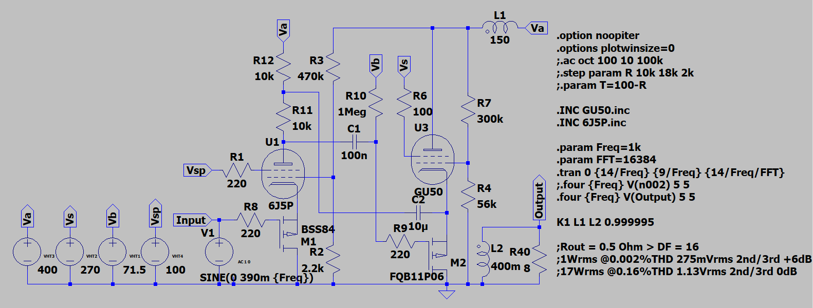

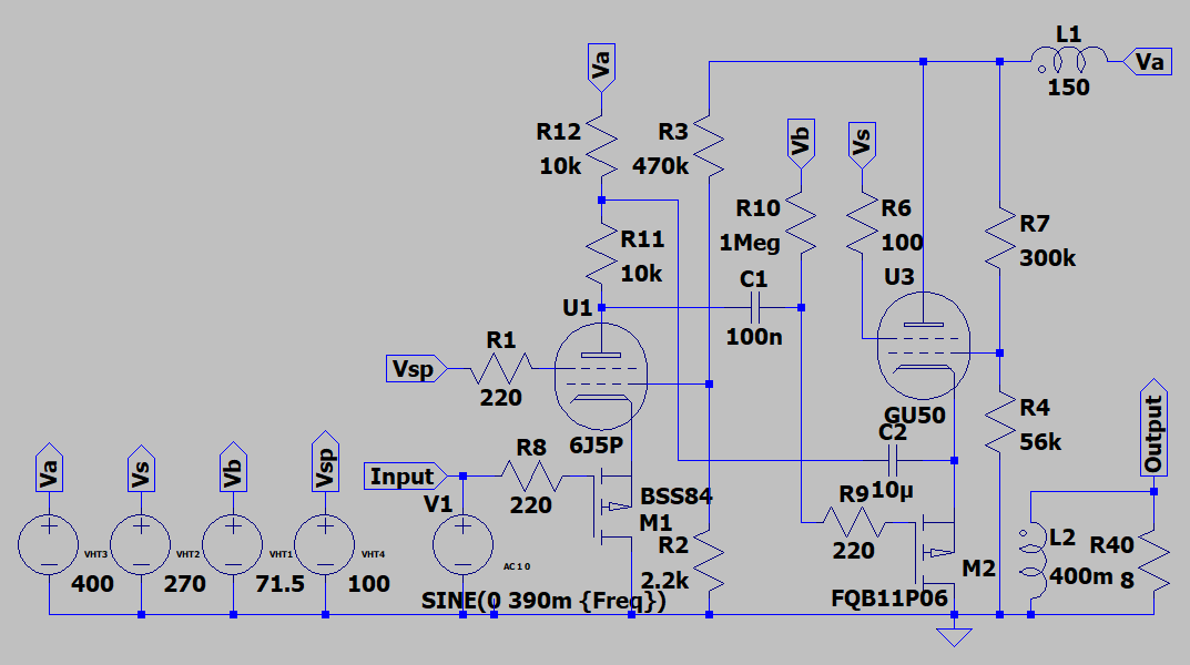

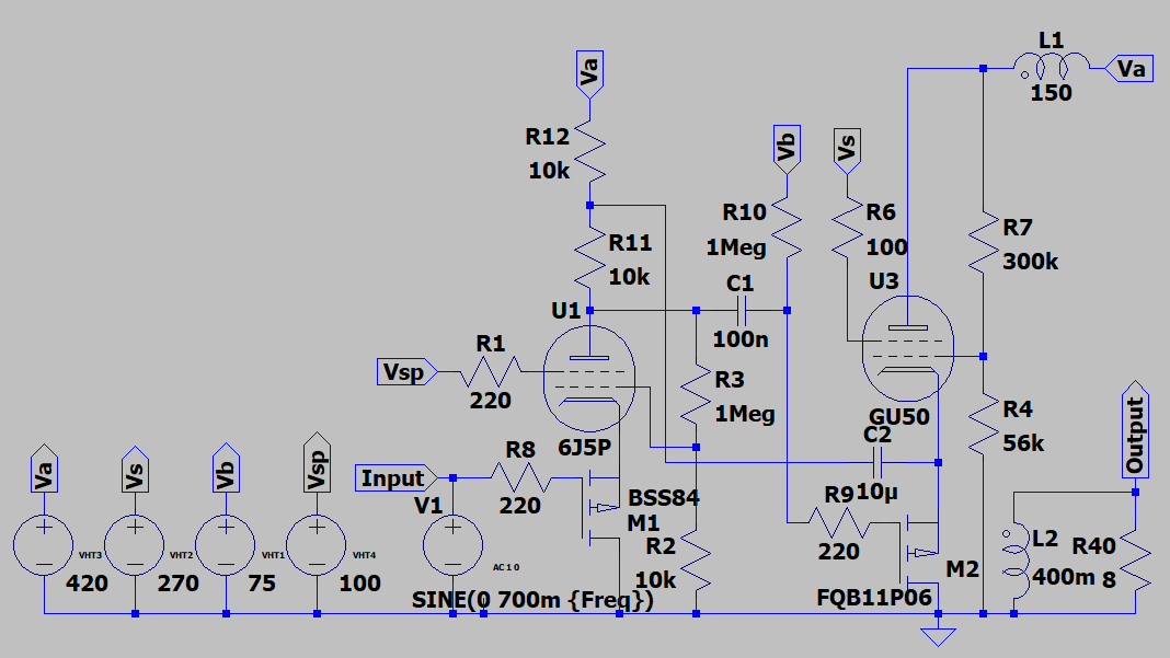

@Tubelab_com @SpreadSpectrum and others
These are the two circuits:
one will have local feedback only having triode-like curves on the driver (local feedback only, anode to g1, on each stage)
the other with pentode curves on the driver (feedback from output tube anode to output tube g1 and driver g1).
How would you switch between the two feedbacks?
I think it's better to disconnect the voltage divider anode-g1-gnd on the driver when the feedback on the driver g1 is taken from the output tube, and that it is better to bring the already scaled-down signal from output tube anode to the switch, to avoid unwanted interactions.
Thank you
Roberto
Thank you
Roberto
