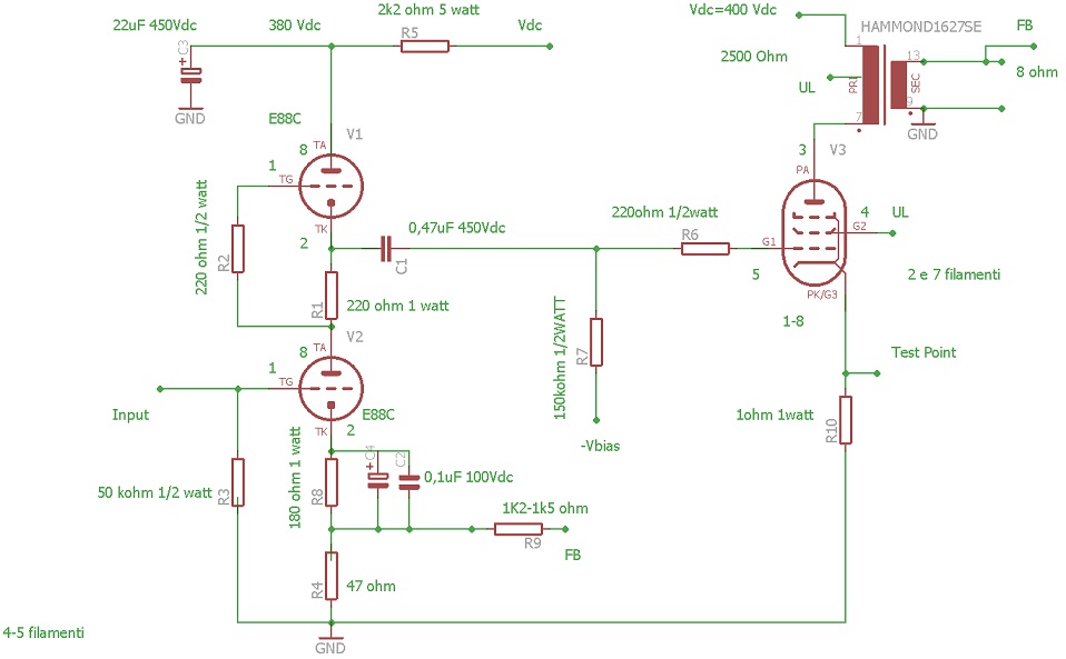

Here a little circuit built and tested live on desk because I write an article on AUdioreview in Italy around three types of OT trafo (Hammond, the Sowter and Fiat proto) involving also the 300B.
I used for Hammond ( UL connection) the KT150 working at around 400 vdc in UL, so it is same as 88. The max power is 10 watt with 2% of THD . In reality I teste it at around 500 volt where I got some more power but the purpose was another.
6 dB of FB, fixed bias.
The driver is a srpp of E88C, very good triode for me.

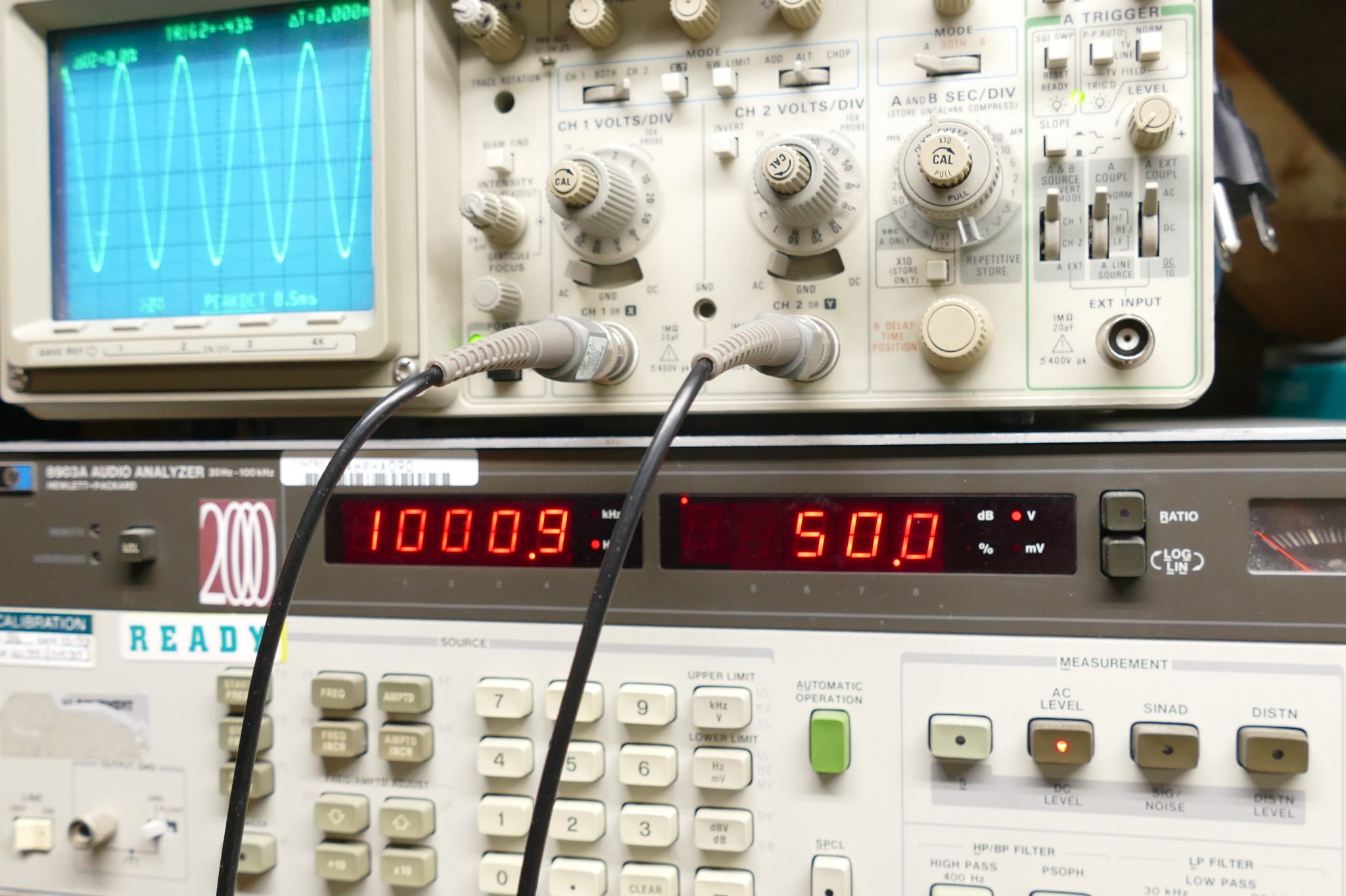

the THD at 450 mV in, 20 Vout is 0,6% THD; 44 times the gain, 33 dB around

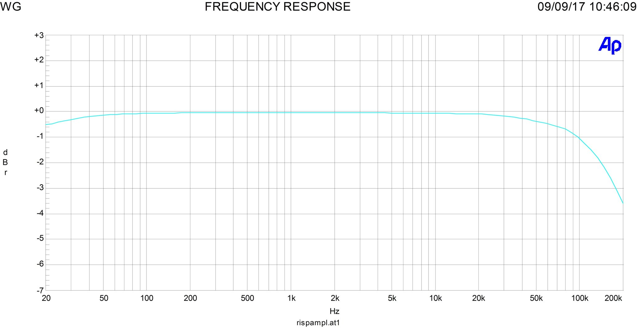

This is the freq. response of driver
wide enough., 100 kHz at -1dB

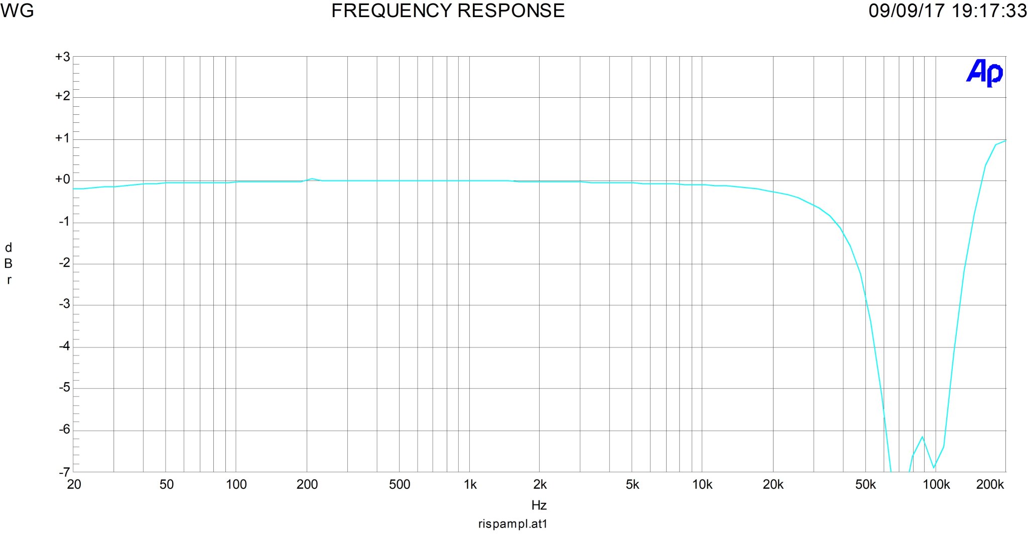

Here the freq. response at 10 wrms-8 ohm
20 Hz at -0,4 dB is fine
- 3dB at 50 khz is enough.
there is an issue at 70 Khz to 200 kHz, the quality is not high; same picture, less or more, I got testing offline the trafo.

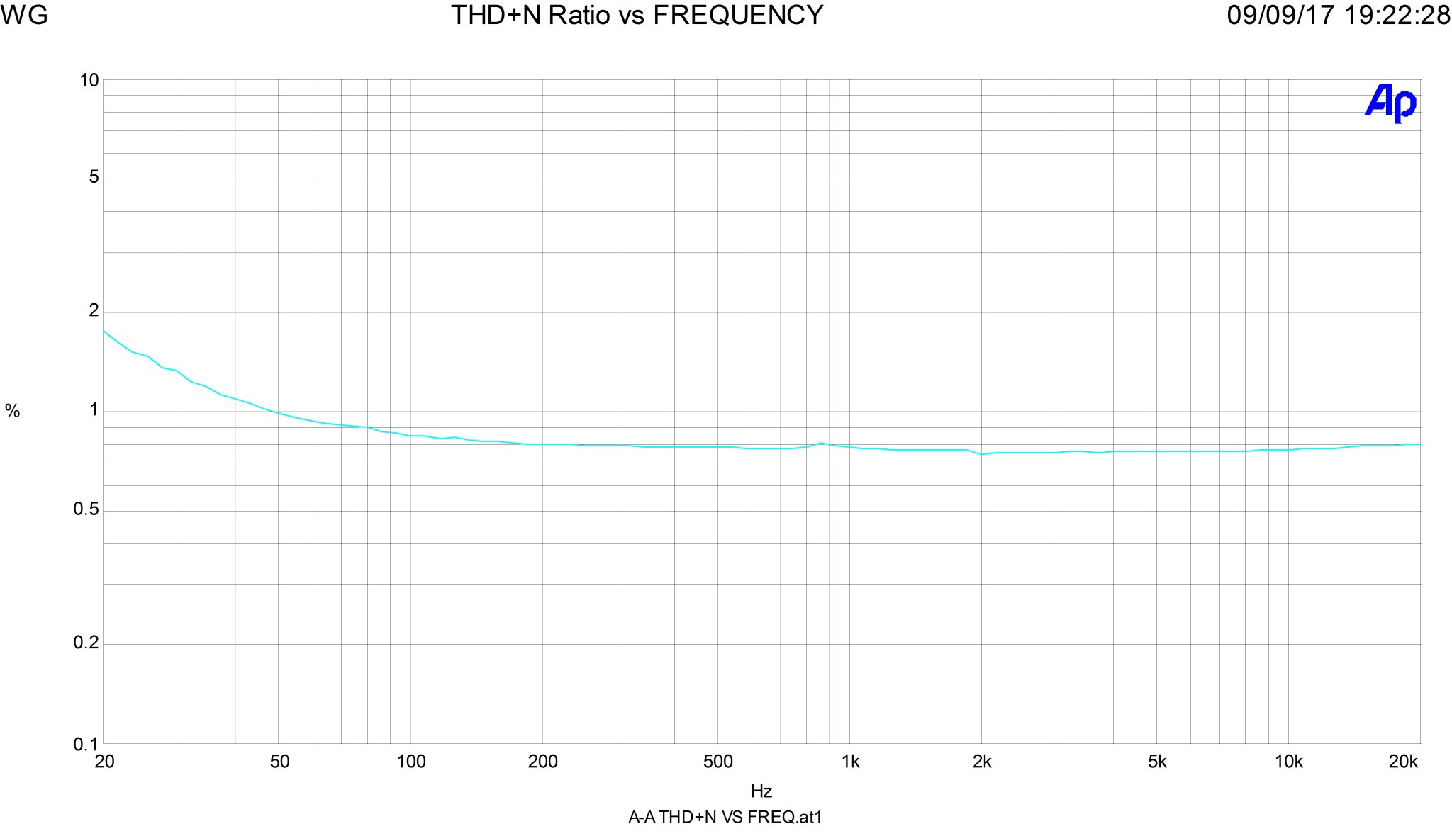

Here the THD vs Freq plot at 1 watt.
As you see the performances are much better than your number at same power and the the andament of the curve is almost perfect because the is linear a wide range of frequencies and this make a difference in terms of listening.
At 20 Hz the value is 1.7 % that is the half of your value. Same for 20 kHz.
I have to find the plot for 10 watt, maybe is in another pc; the plots are from 2017.

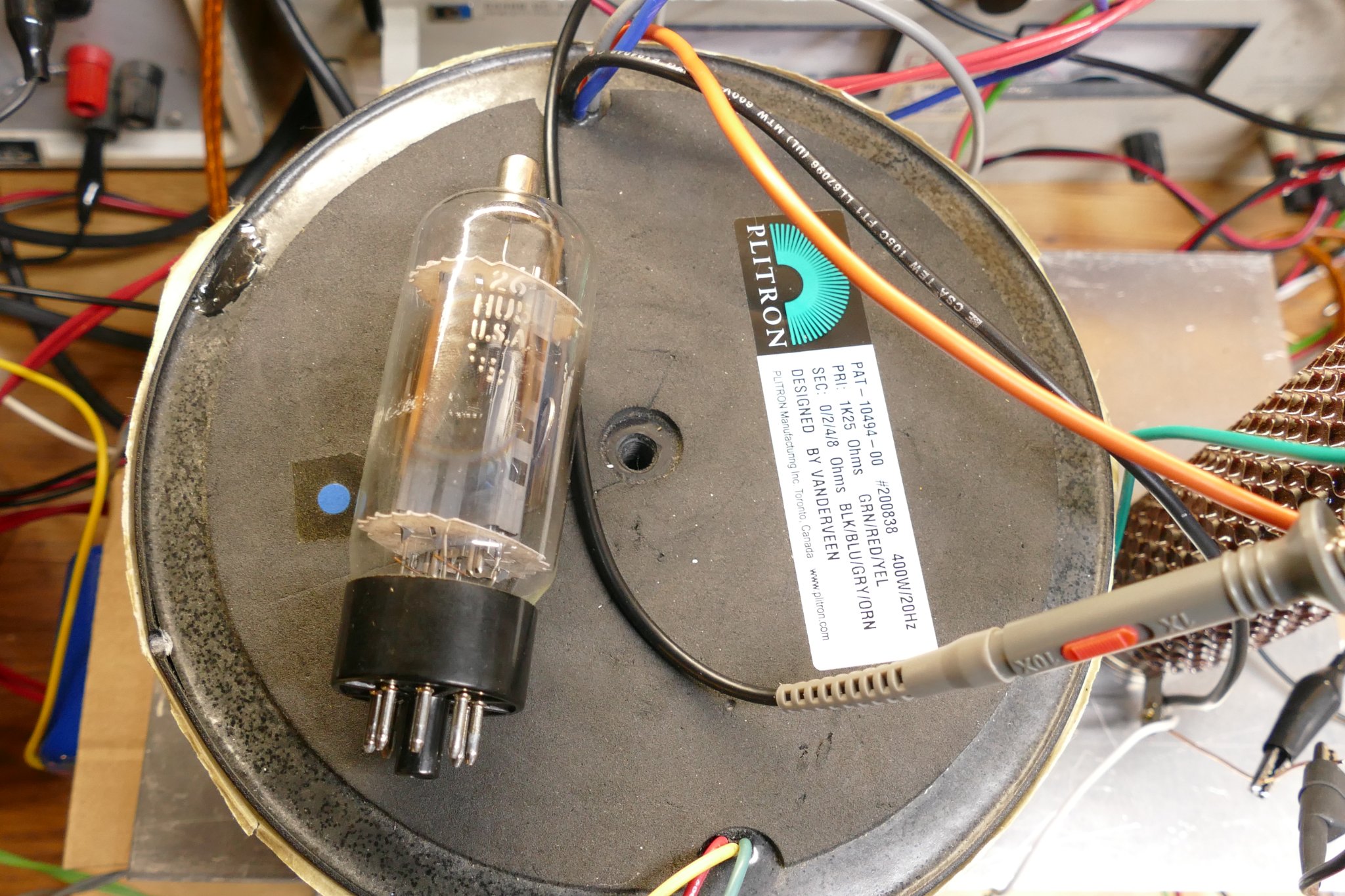

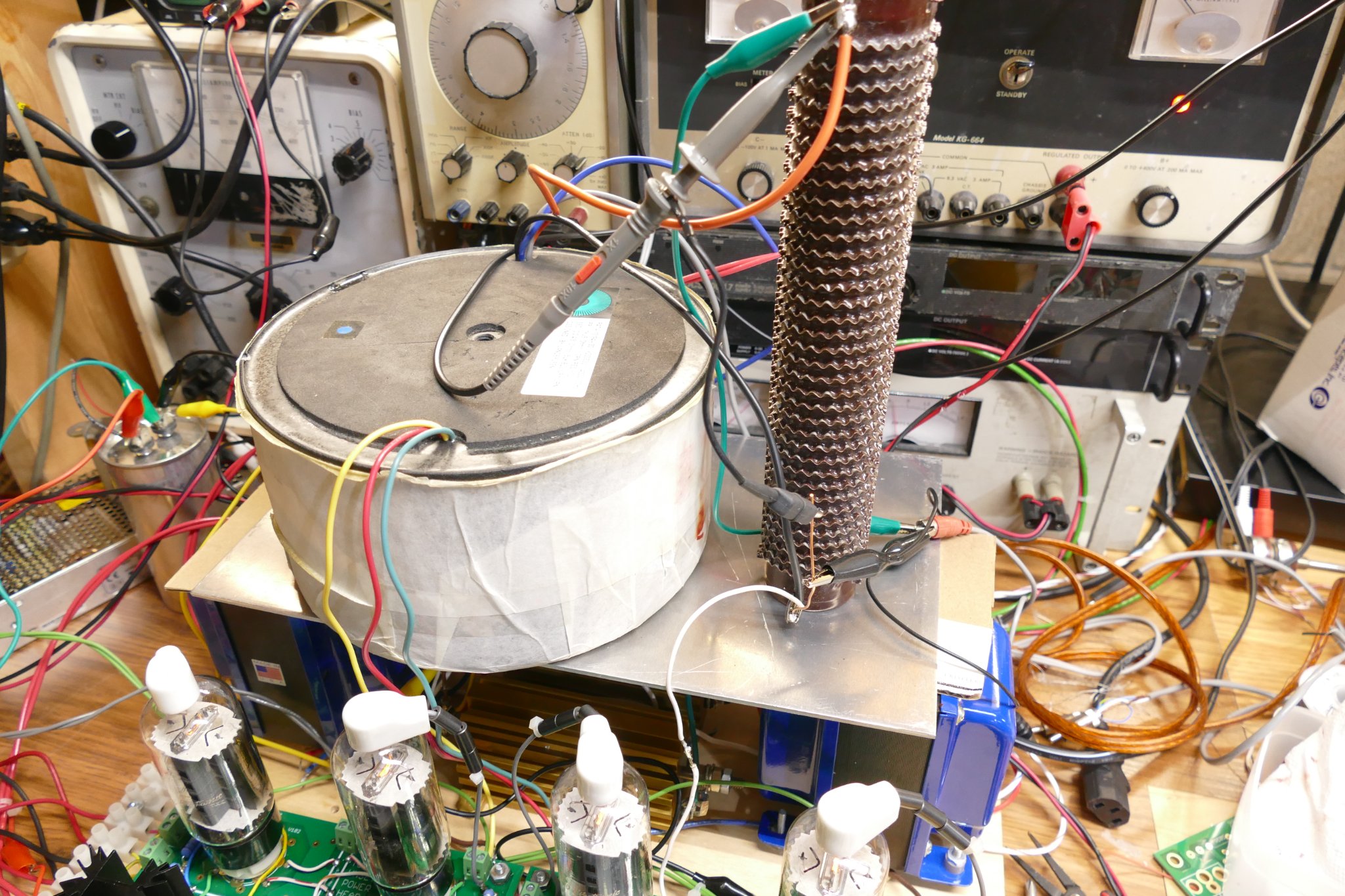

I wired the Toroidy TTG-KT88PSE into the SSE board. This OPT is designed for a parallel pair of KT88's in SE. I only ran one KT88 so I connected the 8 ohm load to the 4 ohm tap to reflect a 3000 ohm load to the KT88. Running this combo on 500+ volts would not be a good idea since excessive tube current would be needed to get a decent match. I played with the cathode resistor value and the B+ voltage to get symmetrical clipping at 16 watts of output, testing at 1 KHz. I wound up with a parallel combination of resistors totalling 375 ohms in the cathode circuit. The plate voltage was 442 volts and the cathode voltage was 40.2 volts. This equals 107 mA through the tube burning 43 watts in plate and screen. This is a bit hotter than where I was with the 500 volt setup, and produced a bit more power as the 3% THD point was 16.34 watts compared to the 14.88 watts I had on 500 volts. I did not try any feedback, as I didn't have much test time. The test data was much better. I forgot to do 15KHz. I should have tried a parallel pair of KT88's since that's what these OPT's were designed for but I have a blown cathode resistor and likely bad cap in the board and ran out of time. I may try it at a later date, but I need to make some comparative tests with a new amp design that should do much better.
Frequency THD @ 1W THD @ 10 W THD @ 15 W
20 Hz 1.24% 13.09% 22.3%
30 Hz 1.16% 4.72% 11.2%
60 Hz 0.751% 2.41% 3.68%
100 Hz 0.60% 2.02% 2.81
1 KHz 0.52% 1.71% 2.36%
5 KHz 0.524% 1.69% 2.22%
10 KHz 0.527% 1.62% 2.08
20 KHz 0.747% 1.36% 1.96%

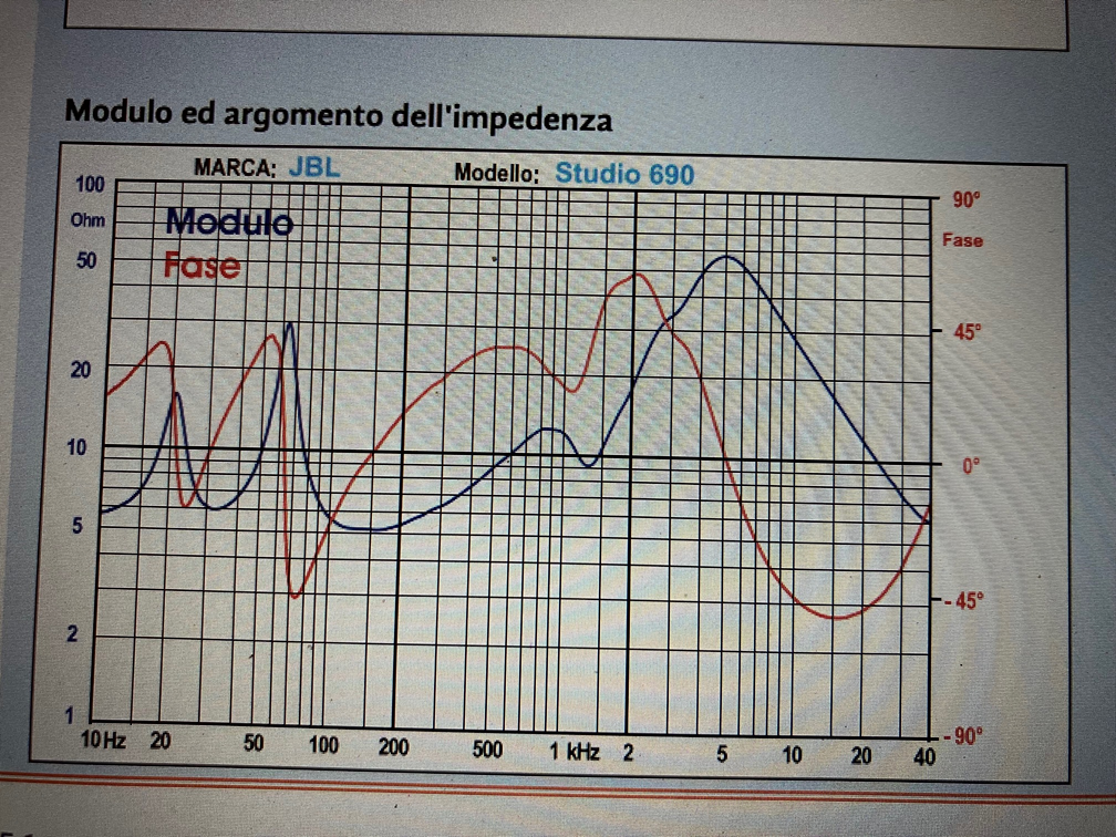

I agree but we have to consider that in a real load, p.e. a bass reflex high efficency, in the low mid region (whre the music energy is great) there are two peaks around 30 to 100 Hz and in some case the andament of modulus has great rilevance
Thsi is an example (just to speak) form Audioreview magazine.
90dB of efficency
take the curve blu ( modulus) at around 70 Hz, there is a peak . From 40 to 70 the modulus increasing ( so no problem at all) but after goes down quickly (from 30 to 5 ohm in 30 Hz range), what do you think will happen is you circuit doesn't have a low distortion vs freq. at different power? And, of course, the quality of OT must be fine.
Same approach on high frequency but less problem in this case
Then, you wrote that in some circut as proposed the gain at open loop is great so it is possible to put around 30 of FB.
But if you look at the phase (red line) you have a great variation also in a narrow range of frequency and in some cases, with peaks, I don't know what happen.
My approach is alway get the best results at open loop the apply (in case) some FB; 6 dB is nothing.

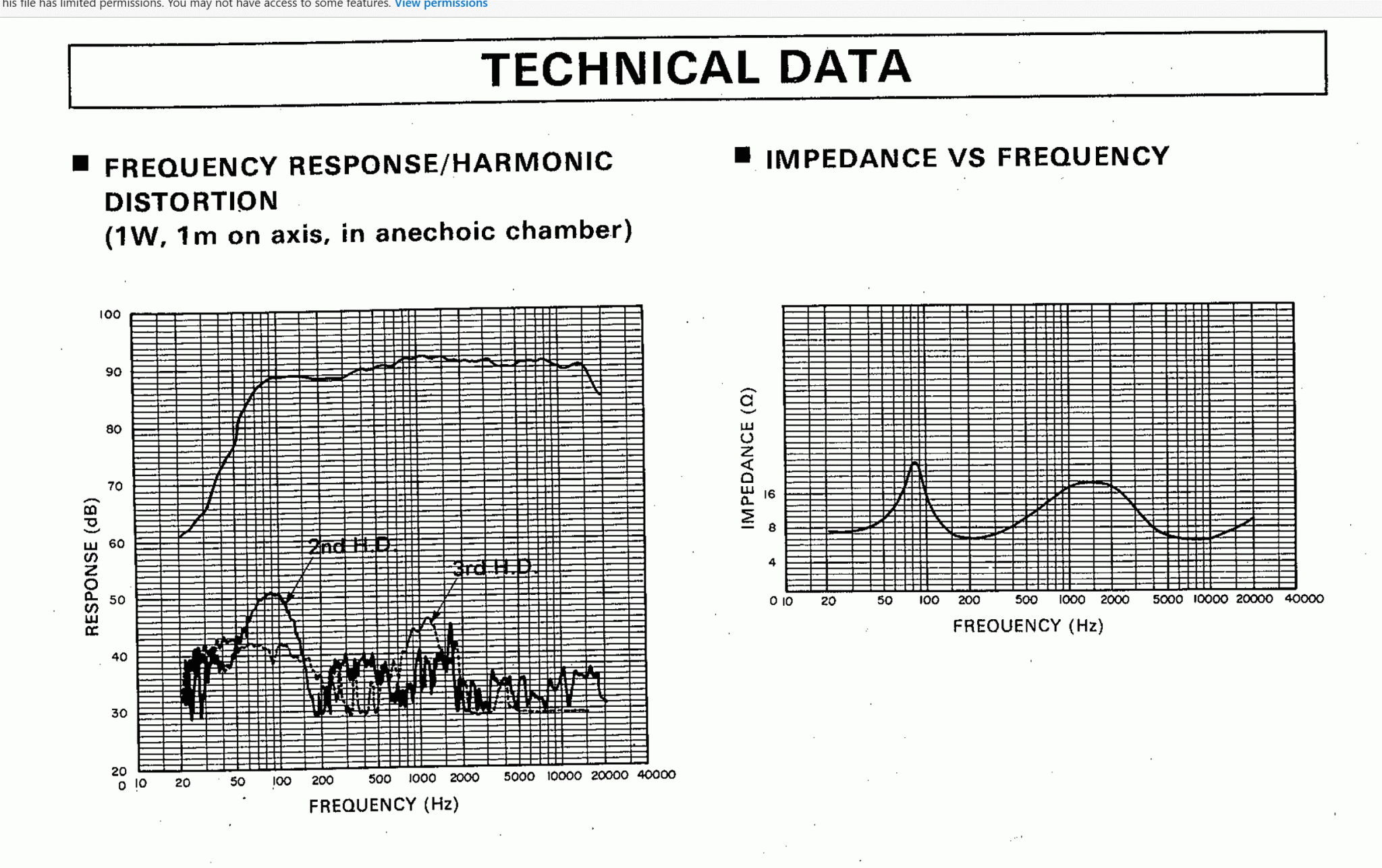

My personal SSE amp was used as the monitors on my PC which was used for audio recording and music generation via a DAW, Ableton Live or FL Studio. I also tinker with various software music synthesizers and software guitar amp modelers. I bought a pair of Yanaha NS-10M Studio monitors in 1989 and switched to digital recording in the early 90's when the 16 bit Media Vision Pro Audio Spectrum sound card came out. The PAS16 has been replaced with a 48 KHz, 24 bit Focusrite interface, and the SSE was replaced with an UNSET tube amp of my own design last year, but the NS10M's still remain, along with whatever DIY cabinets I happen to be tinkering with at the time.
The NS10M's have limited output below 75 Hz, so the large distortion at 20 Hz does not matter in MY setup. The low frequencies are handled by a powered subwoofer. Everyone's setup is different, but many who use moderately powered SE amps don't have response to 20 Hz either.

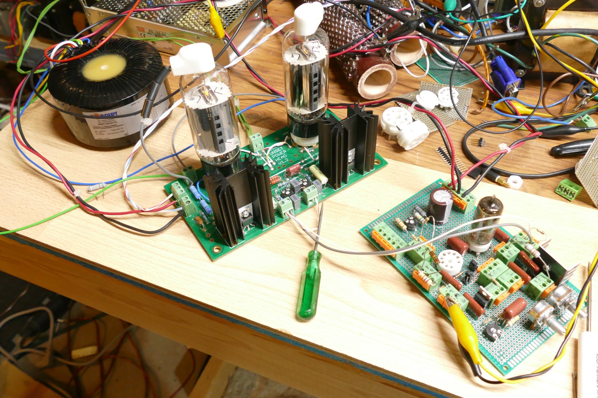

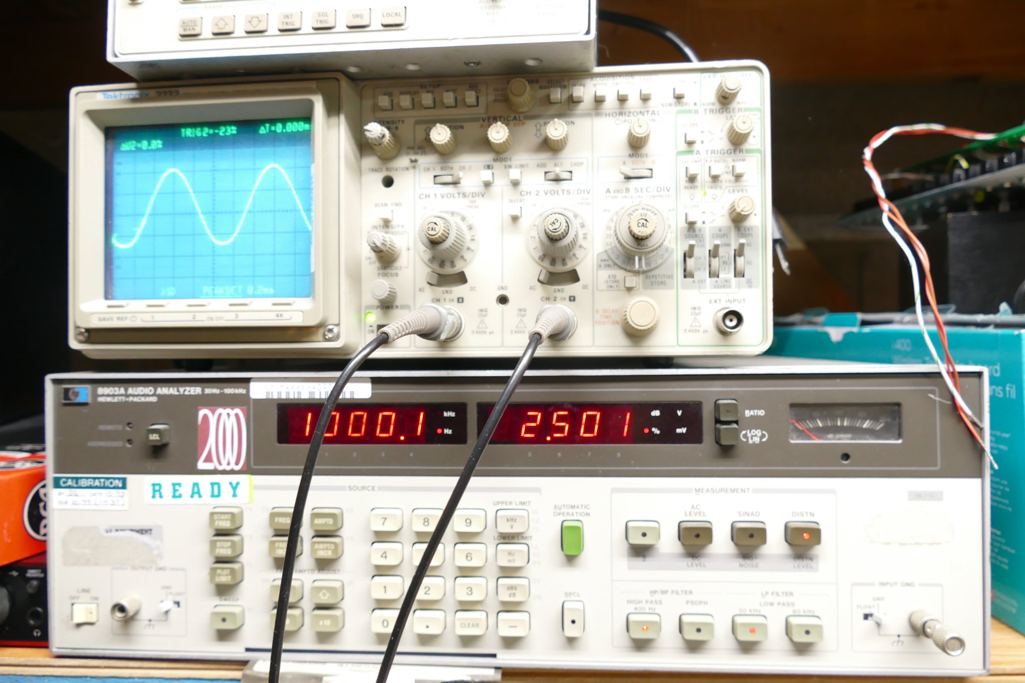

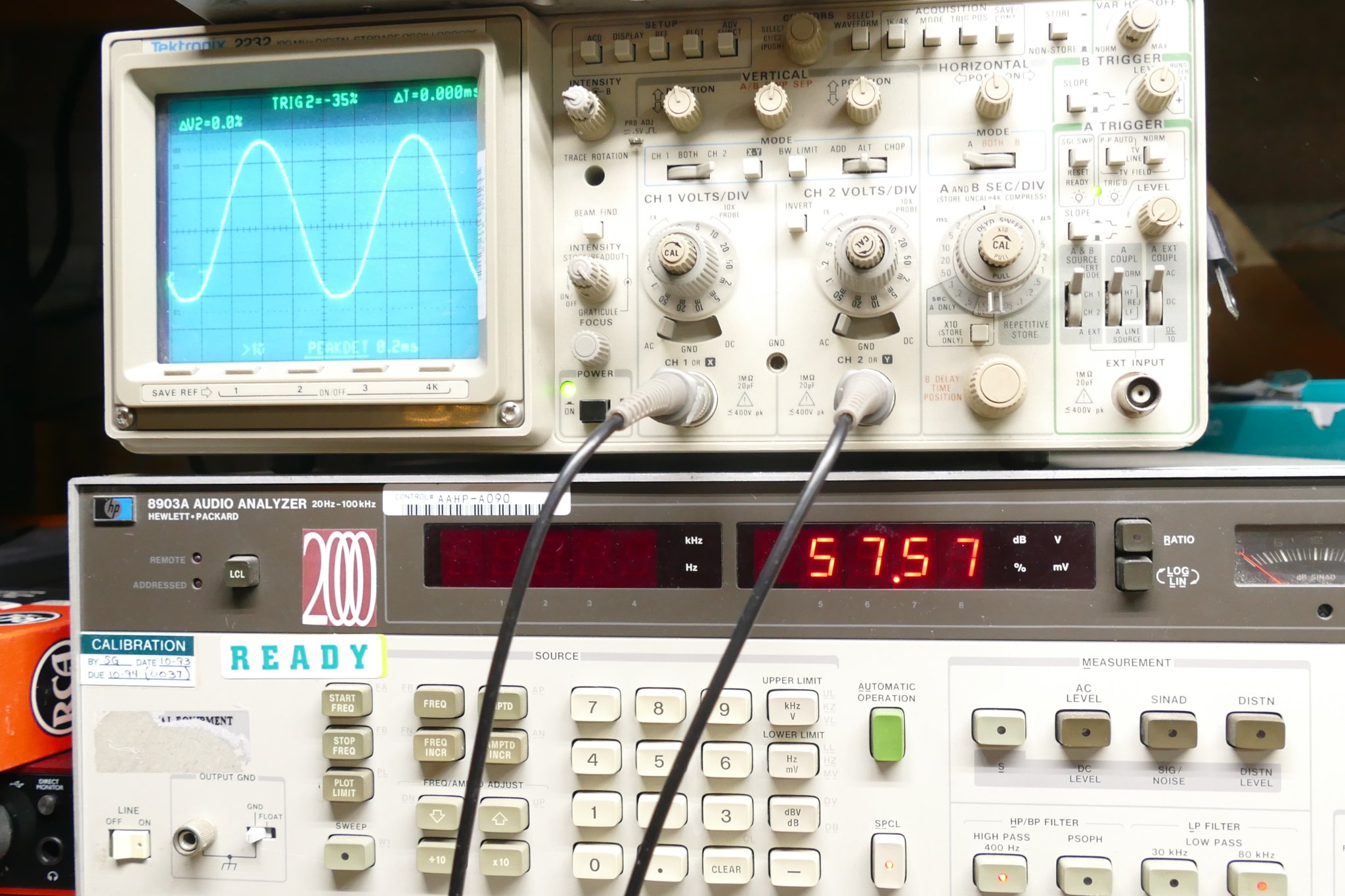

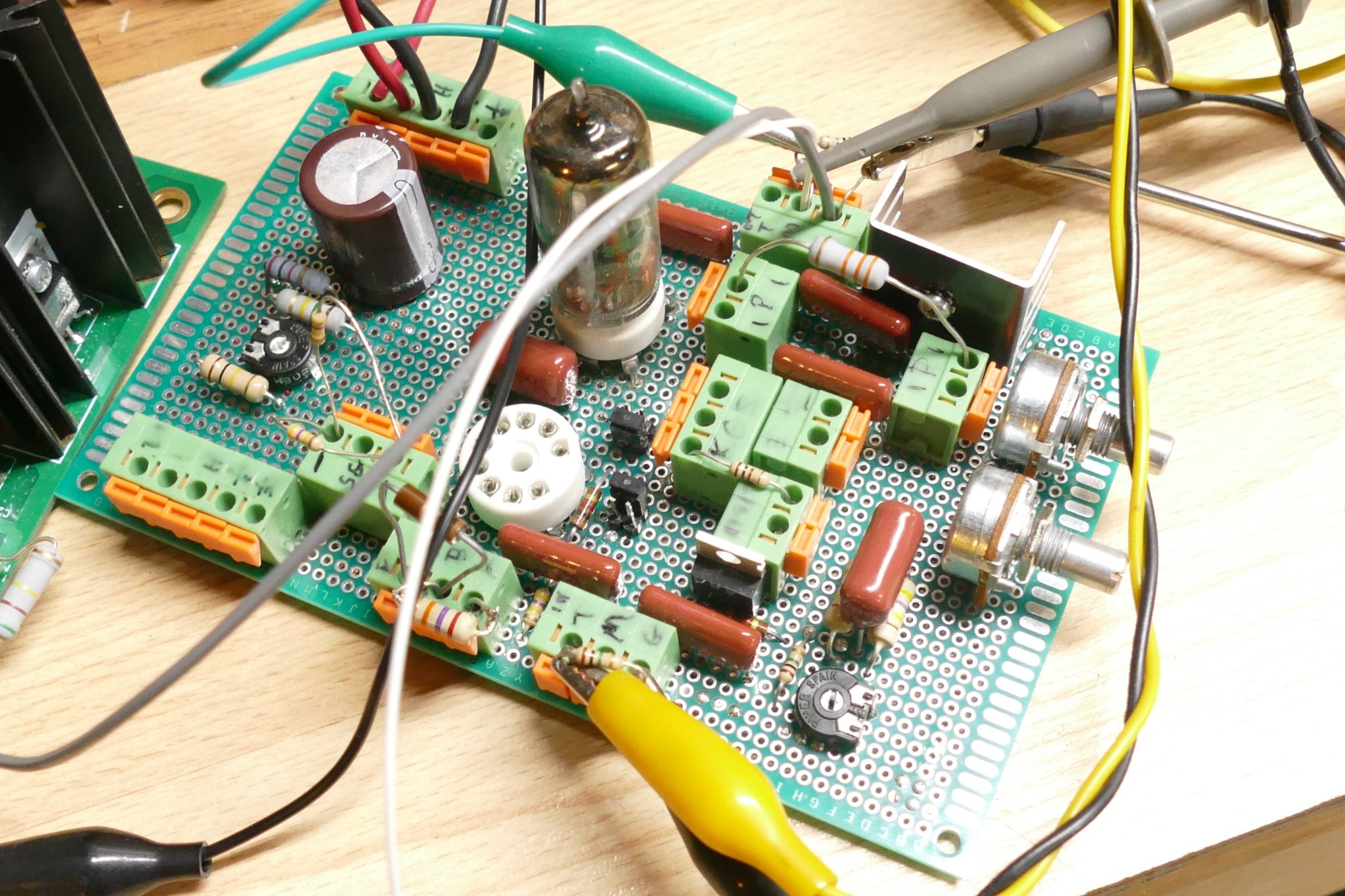

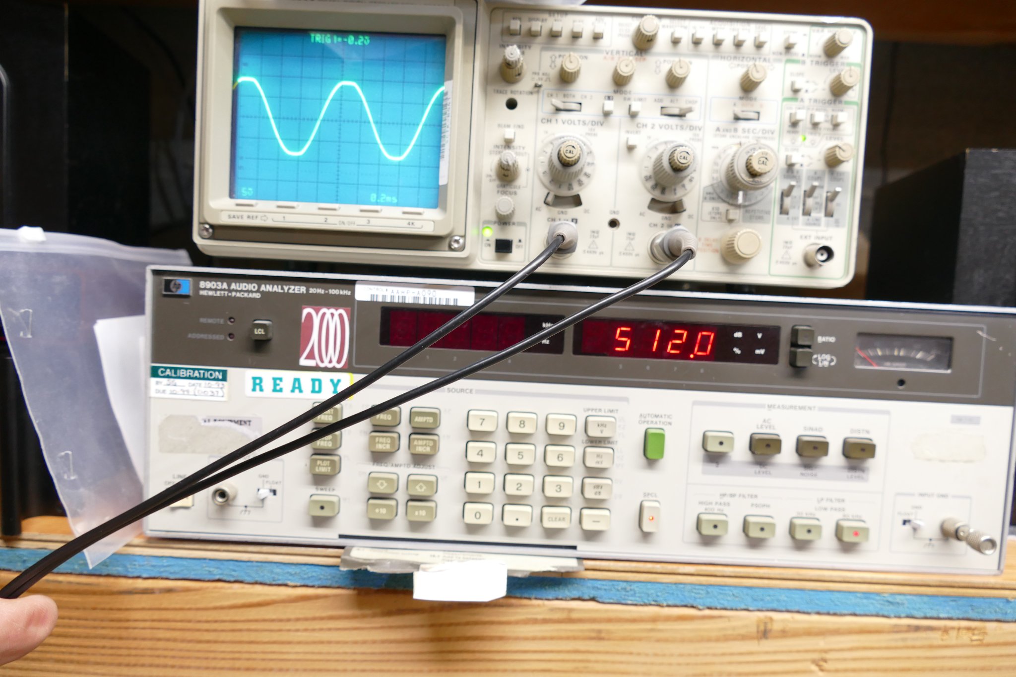

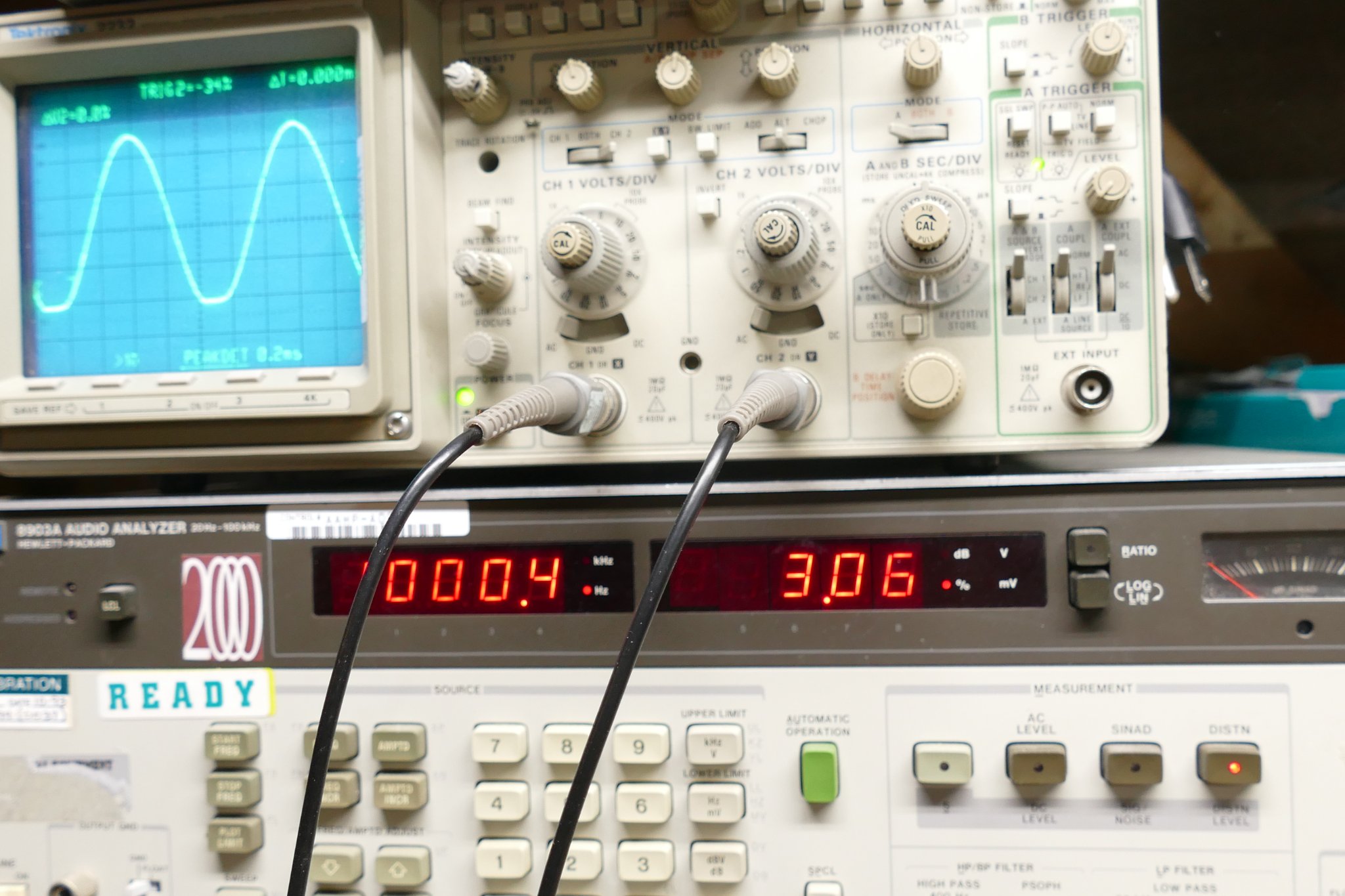

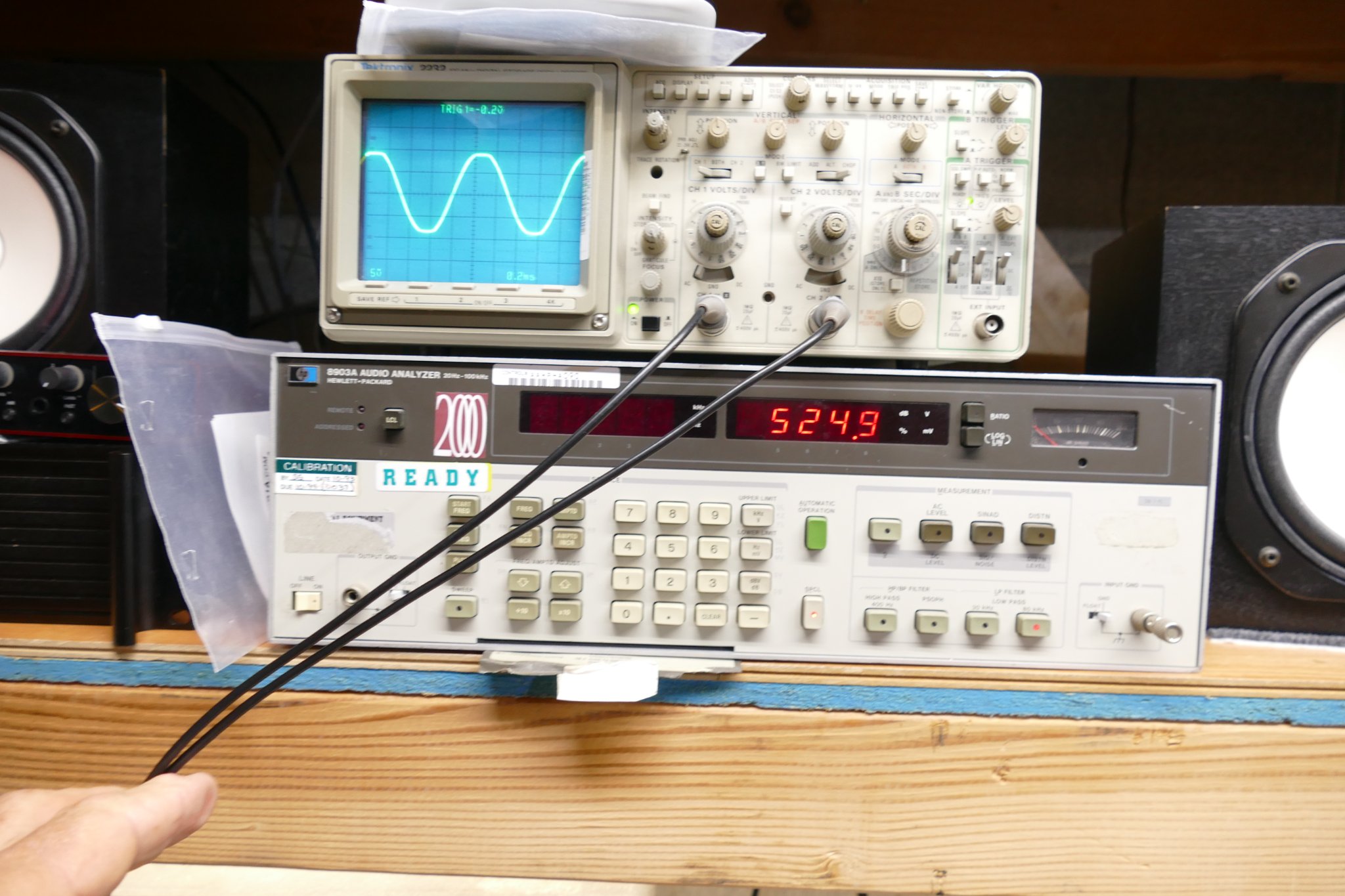

Today's experiment used a circuit similar to post #251 except for the feedback connection. I use the P ch mosfet on the cathode as the signal input and apply local negative feedback to G1 with a simple two resistor voltage divider from plate to ground. The gyrator load on the pentode gives a big bunch of gain due to a very light AC load on the plate. This gain is dialed back with plate to grid feedback to the desired value. I bit of tweaking can reveal plenty of gain with nearly zero distortion.
Step one was to dig out my breadboard and fire it up. Before the "test it from DC to light" requests are asked, I designed this for use in a guitar amp with a gain pot so that the gain could be varied from about 10 V/V to about 1000 V/V. I also used small value coupling caps to roll off the low end since a guitar only goes down to 82.4 Hz. The gain at 20 Hz is negative. Unfortunately changing the caps would not be easy on this breadboard. There will however be another iteration in the future. Why? The driver stage can put out 50 volts RMS at under 0.1% THD. The residual THD on the audio generator is 0.04%.

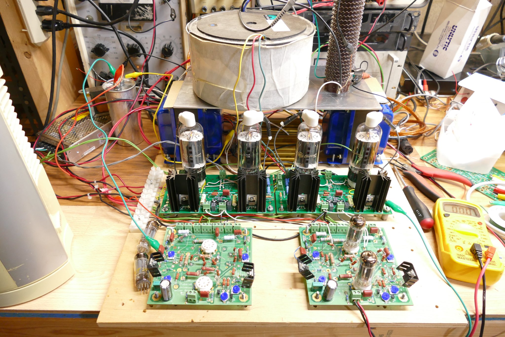

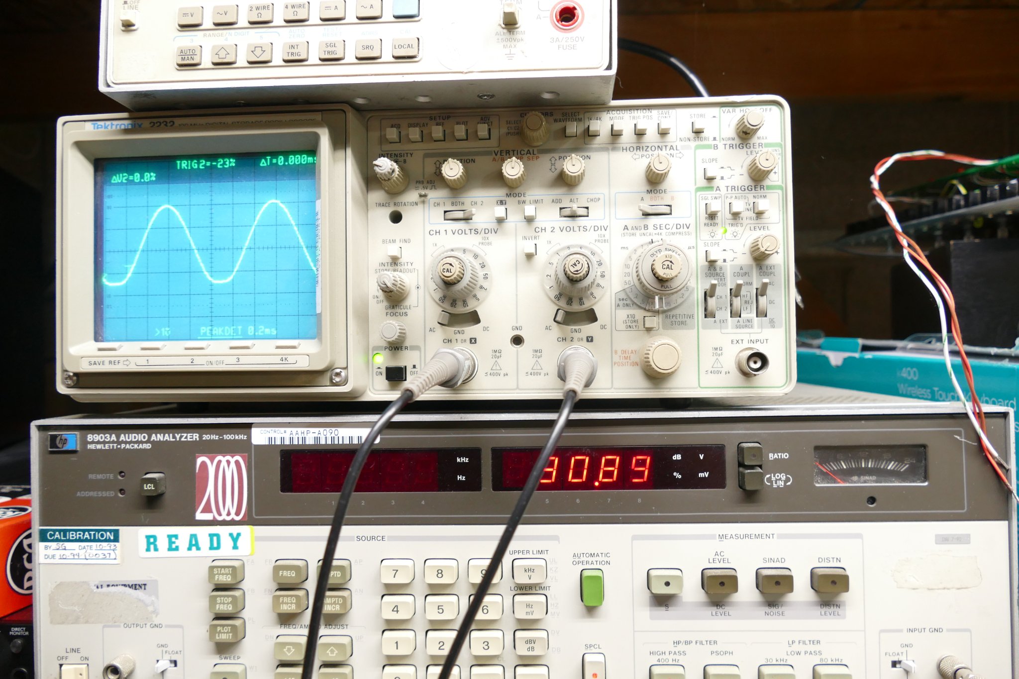

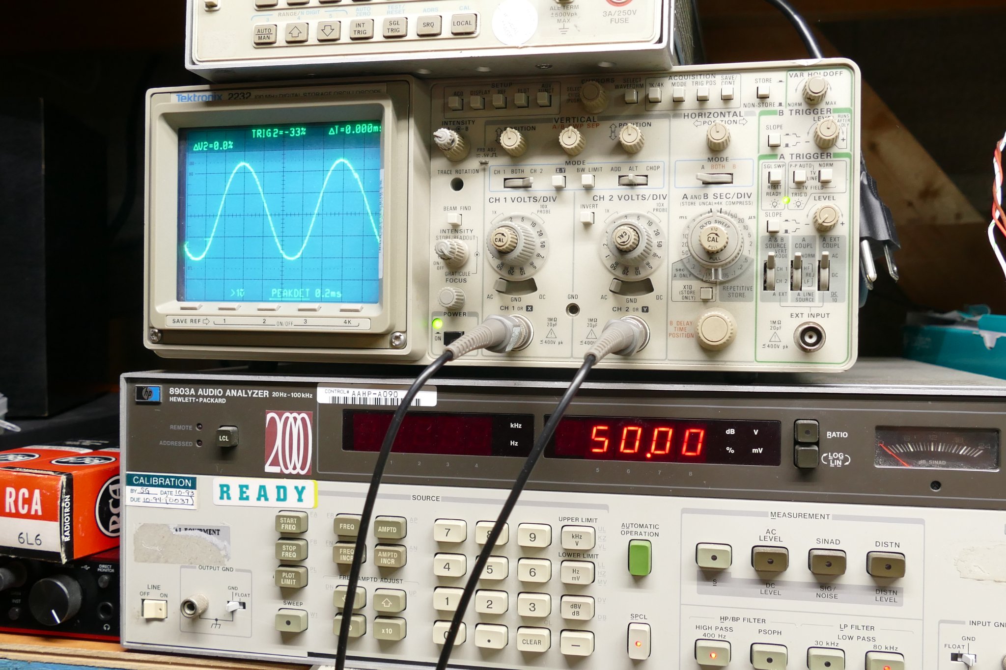

Step two of the experiment gets the output of this driver fed into an UNSET OUTPUT BOARD with both channels wired in parallel. A pair of fat TV sweep tubes were installed, feeding the same Toroidy OPT that I used yesterday with the KT88's. and the phasers were set on STUN (3000 ohm load 460 volts of B+). I turned up the drive until I saw the power pass 30 watts. THD was 2.5%. Dialing it back to 20 watts yields a THD of 0.7% with 0.68% at 10 watts. The totally sloppy unshielded clip lead ratsnest wiring scheme is responsible for some 60 Hz hum that produces a distortion floor of 0.6%.
Step three, phasers on KILL (change to 1500 ohm load, crank B+ to 480 volts. It's gonna go or its gonna blow.......It goes! To the tune of 57 watts at 3.06% THD with a bit of clipping on the bottom of the sine wave. Dialing back the drive to get 50 watts out yields 1.8% THD.
The 380 volt supply only fed the OPT. The plate current at 50 watts was 303 mA for 115 watts of DC input. Thus yielded 50 watts of audio power for about 43 % plate efficiency. This burns 32.5 watts per tube which is in spec. That's not the problem. The amp will have to eat all 115 watts at idle or low volume which would make the tubes quite unhappy. Want a real 50 watt SE amp? You would need three or four output tubes in parallel. If I was going to use 4 tubes, I would make a push pull amp that does 400 to 500 watts with the same tubes in the same configuration.

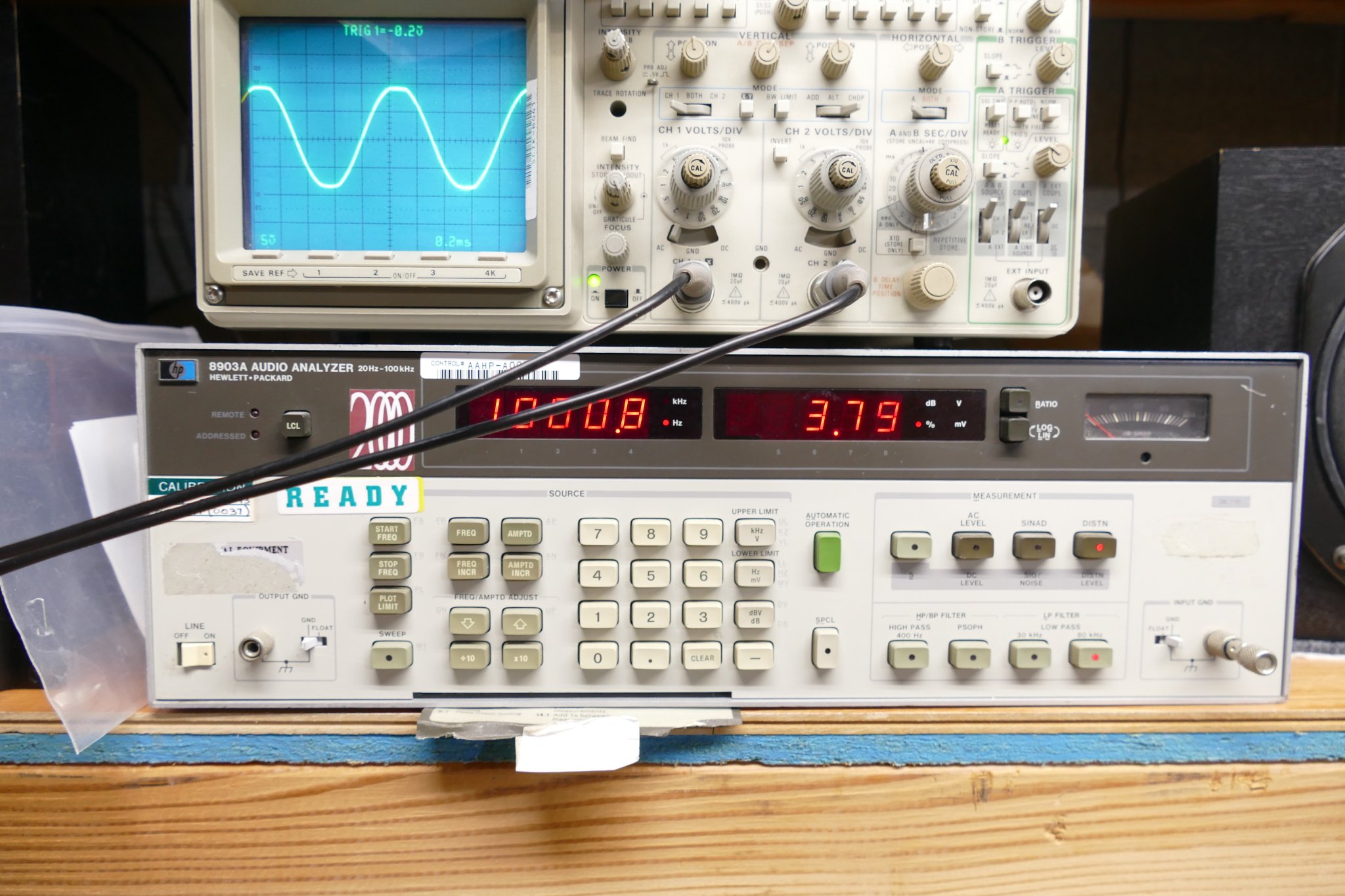

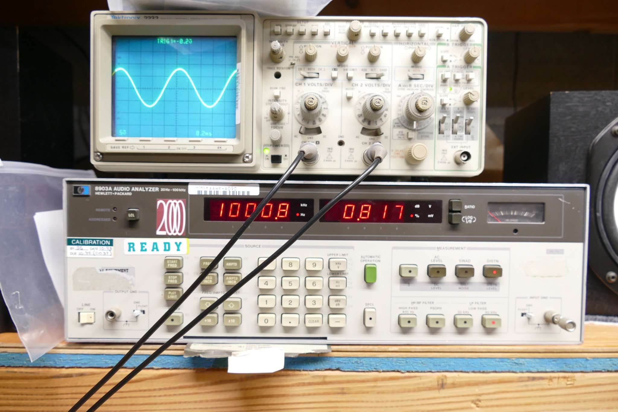

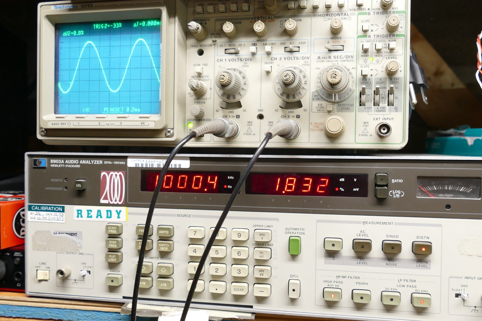

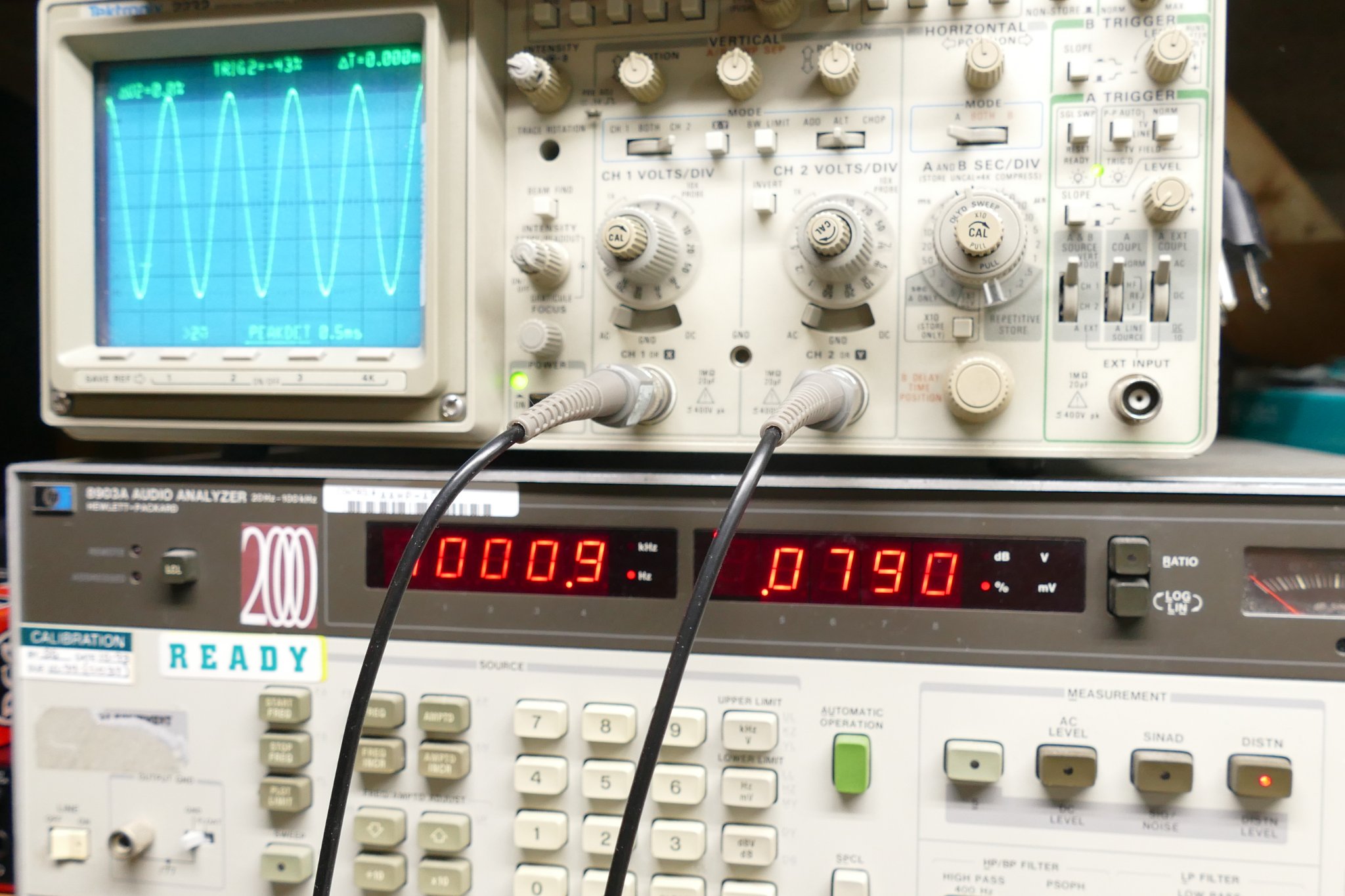

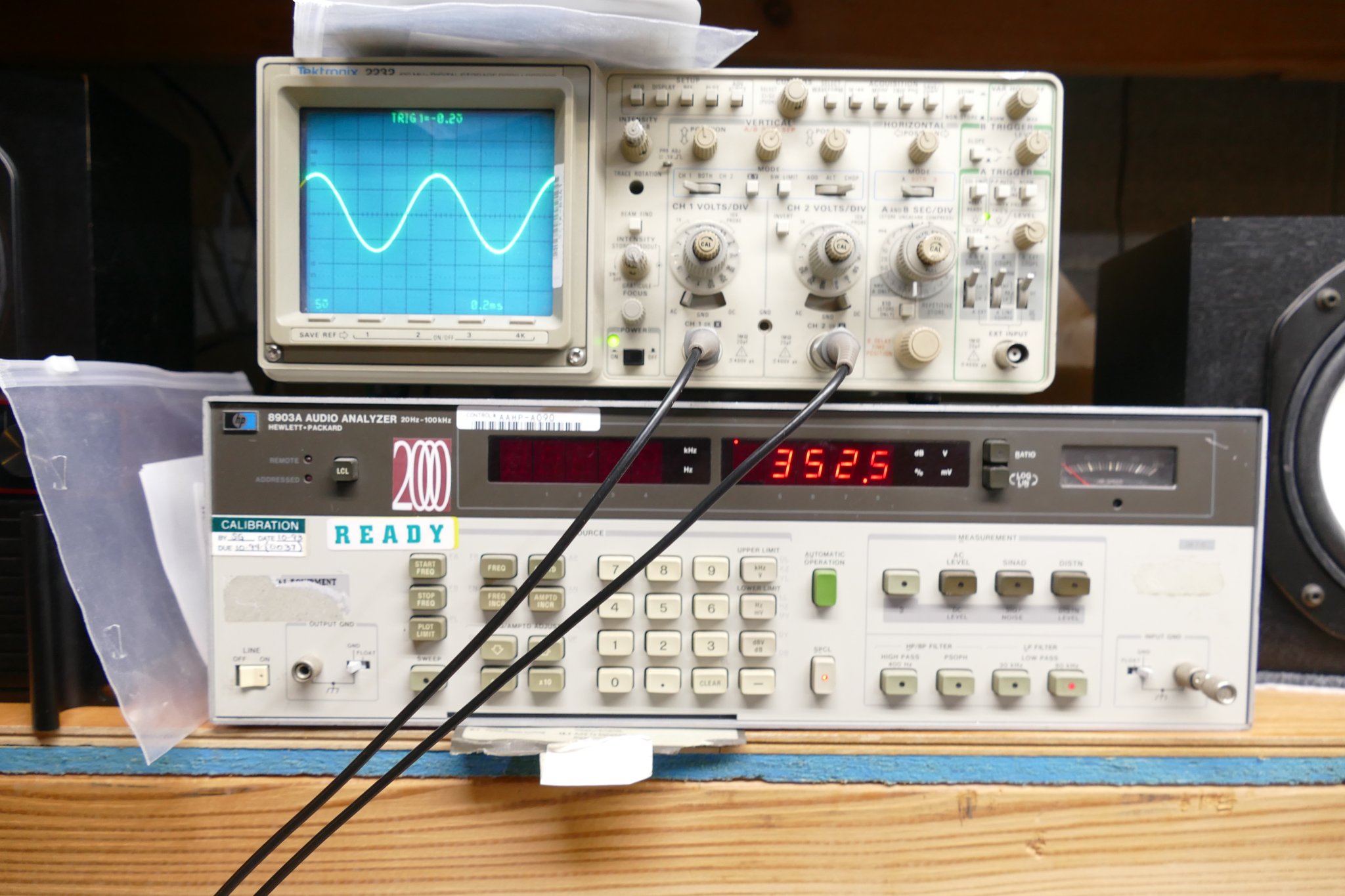

That test experiment already happened, and the UNSET output boards were driven directly from the plates of the 6CG7 LTP in one of my Universal Driver Boards. Here one driver board is driving two UNSET boards each board has its two channels wired in parallel. The Vanderveen OPT is rated for "400 watts @ 20 Hz." It will easily do 500 watts but DC balance must be maintained. The point of minimum distortion is not at exactly matching currents, but at a few mA offset.What about the phase inverter? Driving the cathode with a source follower, you can’t use the LTP configuration. Would you use the UNSET for the output stage only?
THD is 0.817% @ 350 watts and 3.79% @ 512 watts. Clipping becomes evident at 525 watts.
The UD board uses one LTP DC coupled to a second LTP to provide ample gain and matched signals of opposing phase. Any of the typical twin triode tubes can be used, but here both tubes are 6CG7's. The board also contains a pair of mosfet followers on the output for driving complex loads, but they were bypassed for this test. Each UNSET Output Board has a P-fet in the cathode of each tube. Since they run as followers the only load the driver sees is the Crss of two paralleled fets. The FQP9P25's used are 27 pF each.
This is a class AB amp with idle currents well into the safe zone for the output tubes. Maximum dissipation ratings would be exceeded if the amp would be operated continuously at about 2/3 of full power output, and maximum screen grid dissipation would be exceeded if the amp were to be run above 500 watts continuously. Four output tubes per channel would not be an issue in a normal listening environment, if there is such a thing with a 500 WPC amp, but 6 tubes should be used if someone was trying to shake a whole apartment complex with Smoke on the Water at 11 on the Richter Scale.........I used transistors and a pair of bass guitar cabinets each containing 4 X 12 inch speakers to silence the Disco Queen in 1975.
