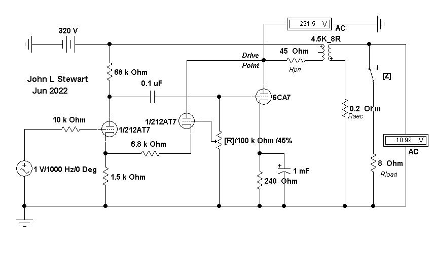

An interesting circuit, But it is not Schade FB since the NFB path is thru U2 to the Kathode of U1, not the Plate of U1.
The NFB path is attenuated by ~1/mu of U2.
Further, the OPT winding resistance are not included in the NFB, DF of 228 is unlikely.
Perhaps a DF of 2.28, that is possible. 🙂
The feedback path thru C1, U4 to U2's grid is positive Fdbk. increasing U1 gain. So no wonder the output Z is so low, with so much gain available in the U3 plate to U2 plate and on around U1, N Fdbk loop. Distortion might be higher than usual. Not sure what happens to the 1/mu effect of U2 on N Fdbk with the positive Fdbk on it's grid. Interesting circuit. Do you have any distortion figure?
From the U2 perspective, seems that the pos. Fdbk at the grid is making the cathode follow it, so that the neg. Fdbk on the plate (going the other way) appears to have a greater amplitude. Perverted analysis maybe. Curious what the simulation thinks. What is the final gain?
Zintolo's simulation would be more accurate if the OPT wdg DC resistances where included.
I don;t see them anywhere.

The OPT has 150H primary inductance, 3500 Ohm Ra, 40%UL, and the DC resistance of both primary and secondary are in the simulation: 45 Ohm for the primary and 0.2 Ohm for the secondary.
Playing with the feedback pot U4 it is possible to achieve even negative Zout, but in reality I think this would cause instability.
@smoking-amp:
isn't it another way to have only distortion as current feedback on the cathode of V1, comparing the signal at the infeed and output of U3 through U2?
I say so because it has a similar behaviour of gain vs Zout as the other circuits I tried with similar approach.
The gain in current configuration is 13.73 (or 22.76 dB as you prefer to express it).
This is the 1 Wrms simulation with 8 Ohm load and 290 mVp (205 mVrms) as input signal:
and this is with same input voltage and 12 Ohm load, to check Zout:
I think the circuit can be highly improved CCS loading the driver or applying local feedback on driver and/or output stage.

Thanks for the explanation @jhstewart9 , am I correct saying that the positive current feedback injected into U1's cathode contains only the distortion of the output tube?OPT Winding Resistance cancelled by negative resistance at the output tube drive point. 🙂 👍
During lunch break I've done some simulations, and it seems that the resistor loaded driver stage gives best performance.I think the circuit can be highly improved CCS loading the driver or applying local feedback on driver and/or output stage.
By CCS loading the drive there's a small THD advantage, but all harmonics become similar, whilst with 68k the THD is slightly higher, but 2H is more than 40dB below, then there are almost another 40 dB between 2H and 3H, and all others falls nicely.
Yes, it looks just like Hawksford's Error Correction thing. Feeding the error ALL the way back to where it sums with the input to form a positive Fdbk loop.
This scheme is then capable of over-correcting the error by going past the null error point on the pot. What I don't see is where it is sampling output current to create a negative resistance, to get the extreme damping factor. Maybe over doing the Error Correction past null setting on the pot gives the same effect by feeding back extra signal drive to then effectively compensate for OT resistive loss. So it is assuming load current is proportional to load V. My guess would be that when the pot adjustment reaches extreme damping factor, the tube error may becoming overcompensated, causing a rise in (inverted) distortion again.
I think that U2 is looking at a voltage on its plate, a voltage on its grid, and gives a voltage on its cathode, then it's the resistor(s) on U2's cathode that transforms the voltage into current.What I don't see is where it is sampling output current to create a negative resistance, to get the extreme damping factor.
It is like that indeed: minimum THD isn't where DF is highest. The sequence is:My guess would be that when the pot adjustment reaches extreme damping factor, the tube error is overcompensated, causing a rise in (inverted) distortion again.
Minimum THD > highest DF > negative DF.
Optimization of #82:
To get the minimum THD and max Damping factor to coincide better.
Lift bottom of R5 and C2 above ground connection by 10 Ohms. Then take a 100K pot, U5, from top of 10 Ohm resistor to U1 cathode. Adjust U4 for minimum THD.
Adjust U5 for almost max damping. (just want to cancel OT primary resistance in order to remove OT magnetizing distortion)

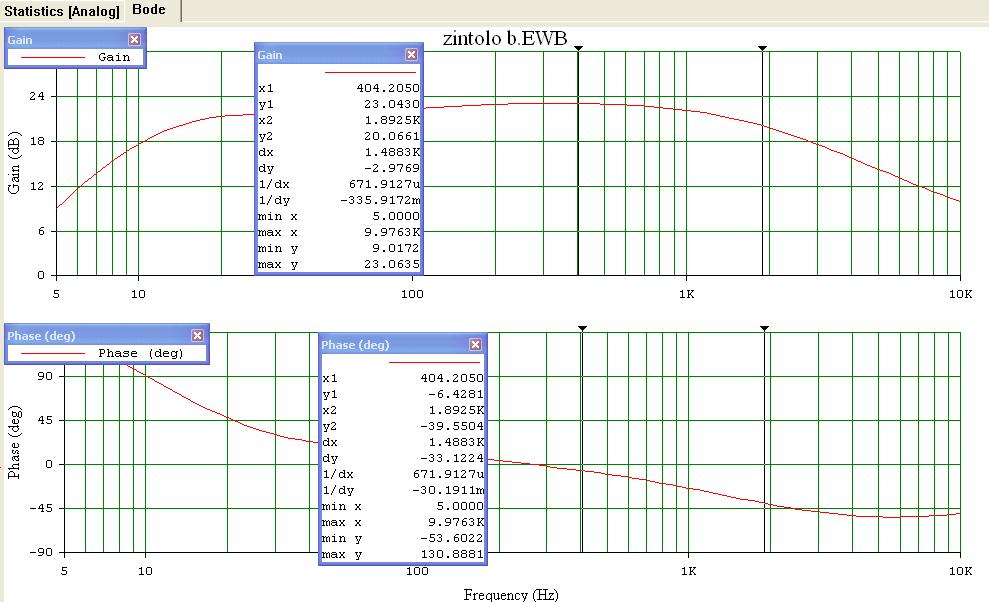

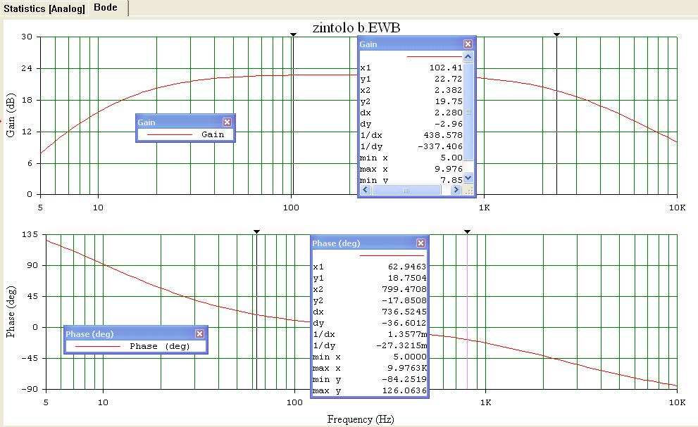

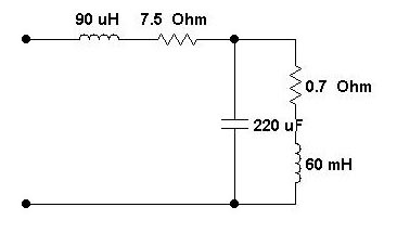

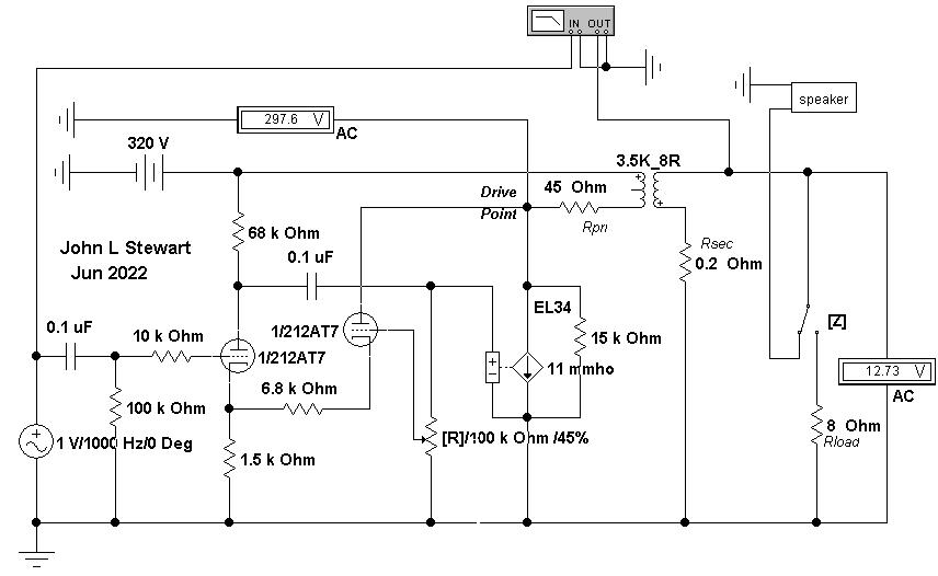

Here is the subject amp filled out. The freq response looks like a problem, something I didn't expect.
Running two tests, one with an 8R load, the other with a loudspeaker simulator.
I've used a sub-circuit for the loudspeaker to keep the schematic from getting cluttered.
That is a problem. Maybe the internal Plate to grid capacitance of V2 is loading down the grid? (ie, preventing the positive Fdbk from working on the grid at HF)
I used the data sheet C's for the tube models. The parasitic C's for the EL34 will have to grafted on manually.That is a problem. Maybe the internal Plate to grid capacitance of V2 is loading down the grid? (ie, preventing the positive Fdbk from working on the grid at HF)
That will further restrict the HF. I put the OPT leakage reactance to 0.5 mH but no luck. The inductance is 150H.
Tomorrow I'll sim the OPT model alone, driven from a brute force source, check it's bare bones response.
