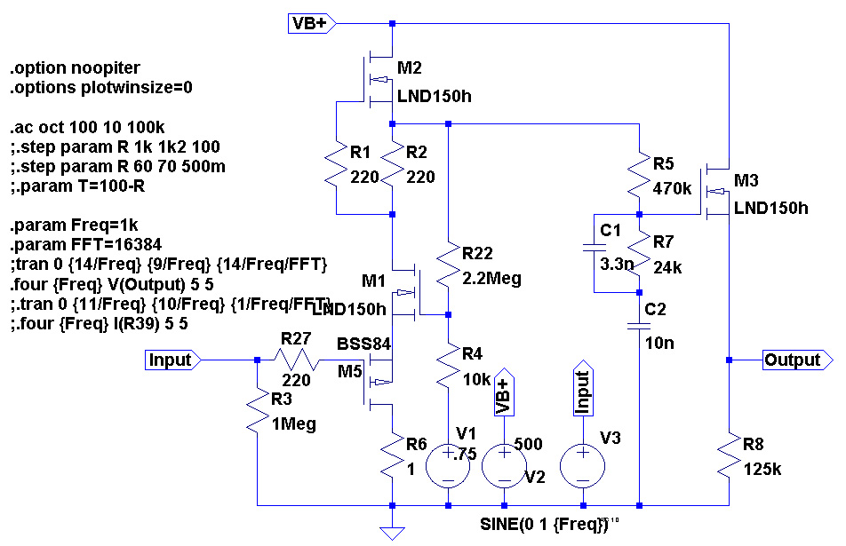

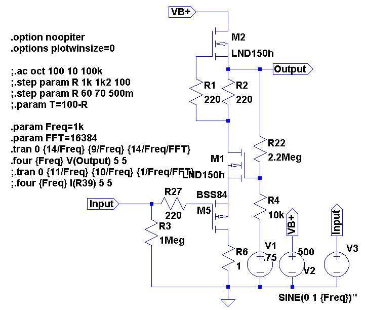

This is a variation of the same concept applied to depletion n-mosfets as a driver stage: drive the drain of the n-mosfet through a p-mosfet and give feedback to the n-mosfet's gate, loaded by a CCS.
1.7 Vrms at its input give an output of 161 Vrms with a THD of 0.019953%:
By increasing the local feedback, THD can be reduced to ppm and subppm values at the expense of the gain.
Cute, but tith the substantial positive bias available through the FB pair, you can use regular old N-fets too... 🙂 For a little one, also good to 450V, try the DN3545N3...and even as I type it again I wish there were an N5...LOL

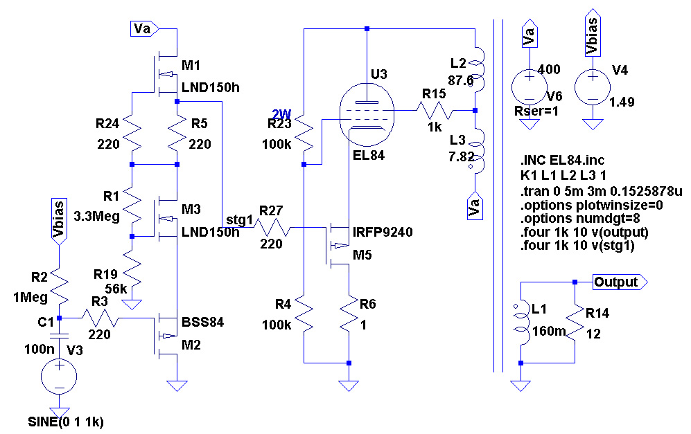

Thanks for your feedback Bandersnatch, isn't M2, the top LND150, already a CCS in the previous schematic?
This is the hybrid mosfet-EL84 amp (very far from being optimized):
Has a DF of 19 and gives 1 Wrms with 750 mVrms at its input with the following simulated distortion figure:
7 Wrms with 2 Vrms at its input with the following simulated distortion figure:

I've optimized the driver, with 700 mVrms at its input, output (not loaded) swings 150 Vrms with 0,02% THD:
Of course, if some 2nd harmonic is needed, it can be loaded by a resistor instead of a CCS.

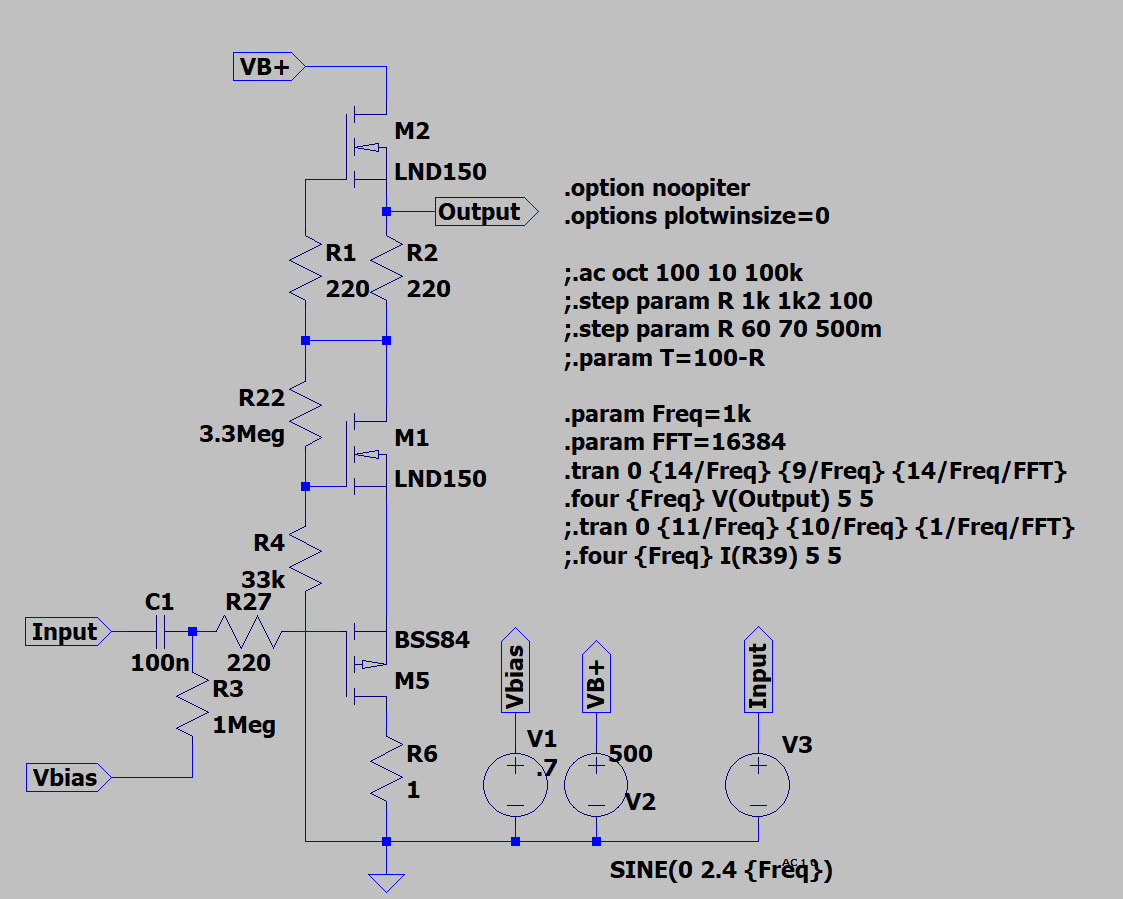

It's similar to my Corona amp input stage except has all of the feedback local to itself (and this one is all sand).
I love the series differential stage with active load. Two high-impedance inputs, and low Zout from the CCS source. What's not to love?
I have been tinkering with something similar. Just take out the top LND150 and install a tube.

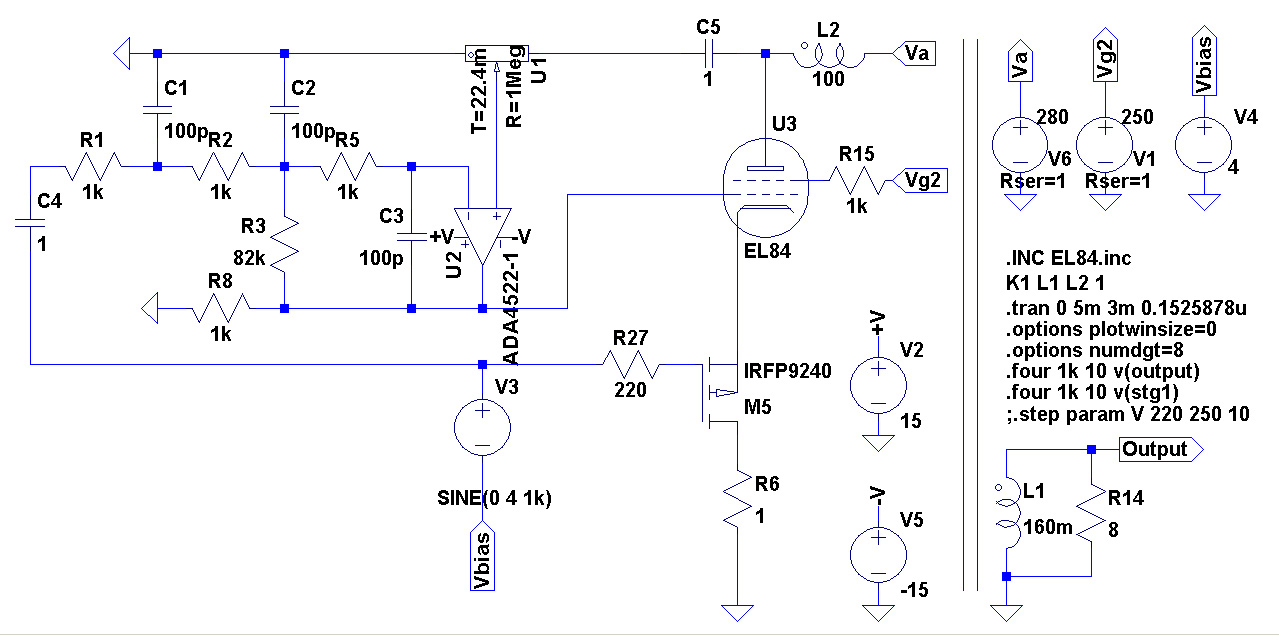

I post here a variation of the concept of the local feedback on pentodes.
It is very basic, very far from being optimized and just proposed as a concept to be developed.
The pentode is biased and driven by the cathode as per George's circuit, but g1 is fed only by the distortion of the output tube instead of the full signal scaled down.
The result is that the gain is unchanged compared to the pentode mode (I get 360Vpp at its anode with 8Vpp on its input), DF is 18 and a very badly implemented circuits gives 0,3% THD at 3 Wrms.

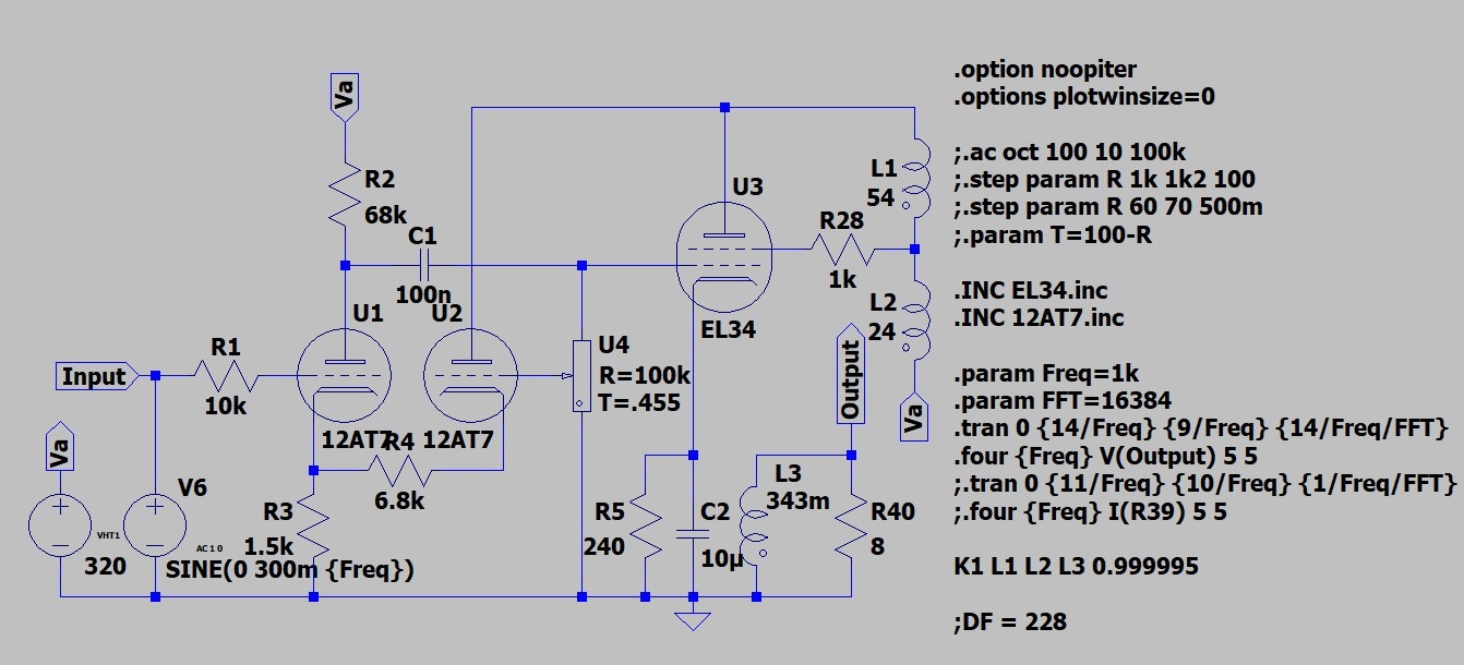

I've found this schematic on Pinterest for a variation of the "Shade" and I tried to simulate it.
It gives around 8 Wrms with a Zout of 0.035 Ohm (that's a DF of 228).
C2 was 1000 uF, I've used 10u to speed up the simulation.
Has anyone tried something similar?
