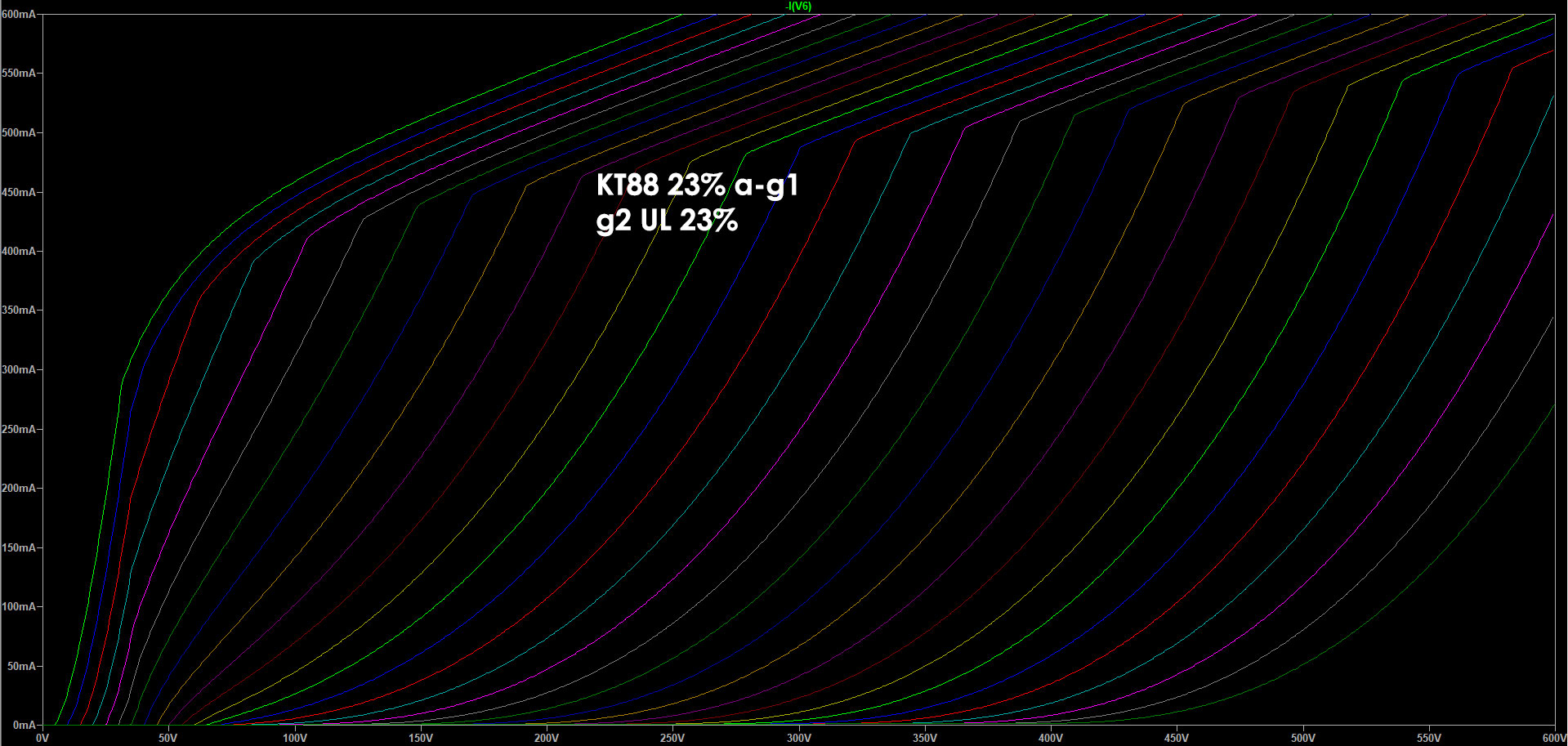

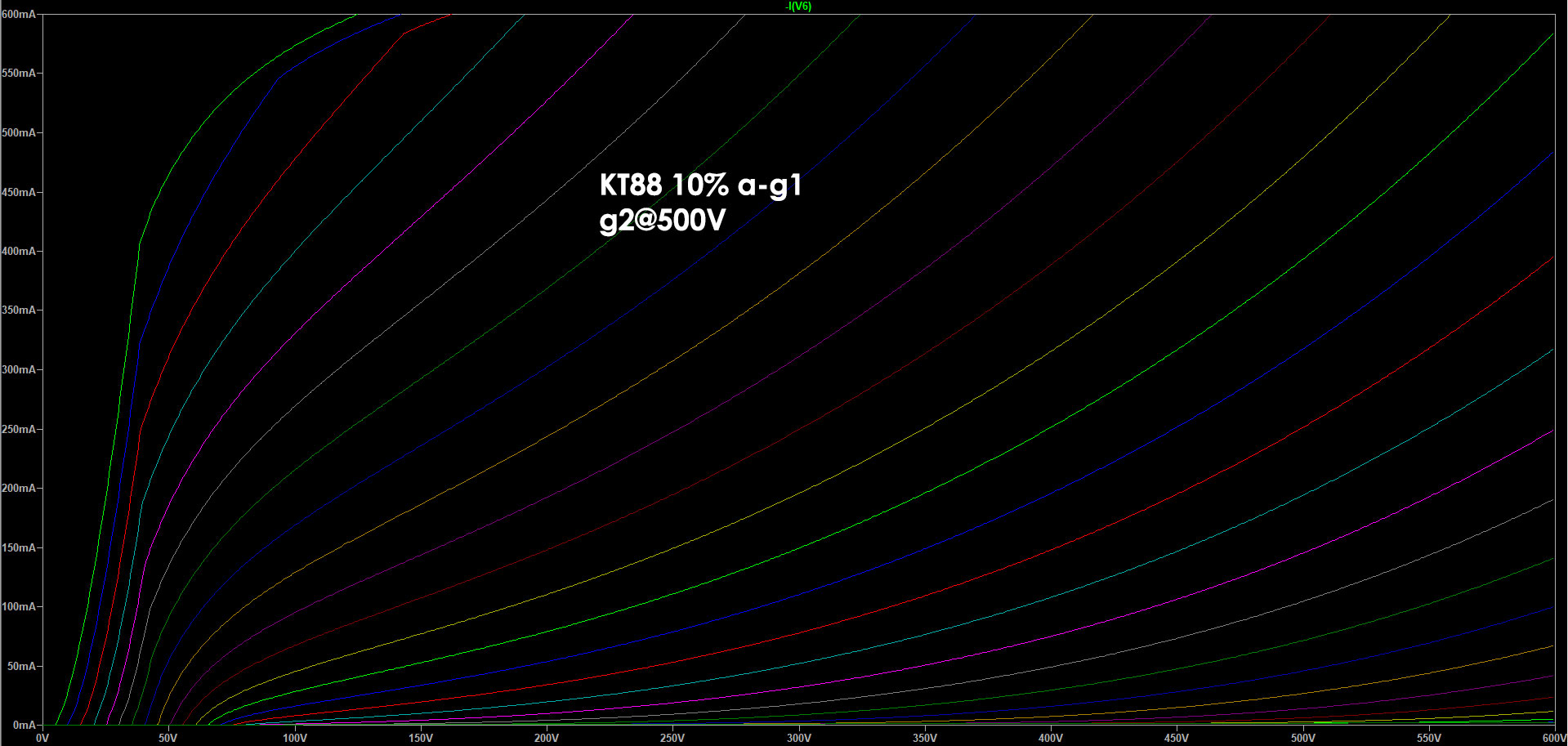

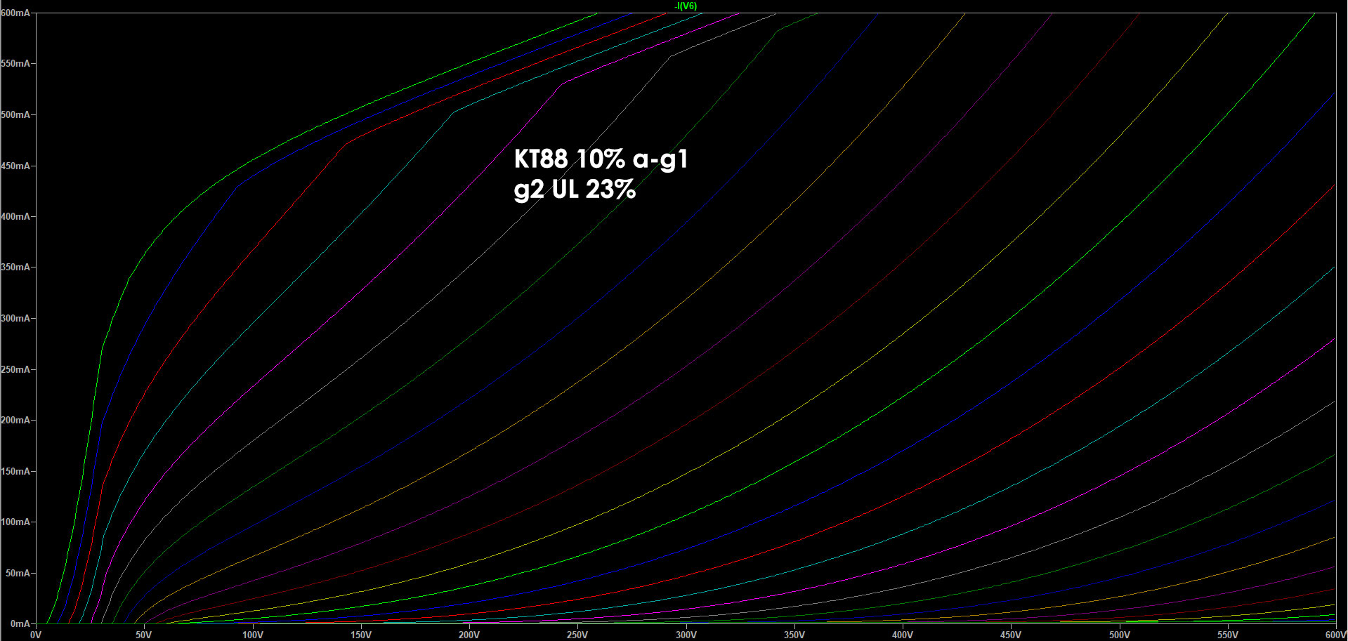

I have a pair of 4k Raa 23%UL PP output transformers, so I can set it to 23% a-g1 feedback to get an almost constant g2-k voltage or 10% a-g1 feedback and so have a 13% UL.
In the meanwhile I can post the curves simulated in LTSpice and we can discuss on it.
zintolo,
I love those curves you posted.
I especially like the first one, because it shows curves that are:
Convex
Straight
Concave
Results will vary according to the portion of those curves that are used.
A nice resistive loadline can be picked to make it all linear . . .
And then a problem appears, many loudspeakers present an elliptical load.
Now, the elliptical load gets us in all three areas, convex, concave, and straight curves.
Forget about worrying about damping factor, that is the least of the problems.
Because of the elliptical load, I am not using that set of curves without negative feedback to do some rudimentary 'fixing' of the 'load problem'.

Thanks for your intervention 6A3sUMMER,
those curves have been posted exactly to discuss about them so your post is very welcome. I will add the curves I suggested at the beginning of this thread to compare them. One point you just suggested me is to post 23% a-g1 curves without UL, so same triode-like curves with a wider area of parallel curves around the loadline to help keeping linearity with ellipsoid loadlines.
