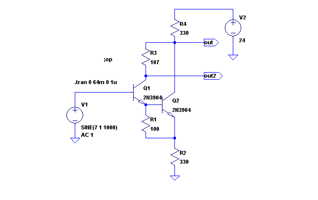

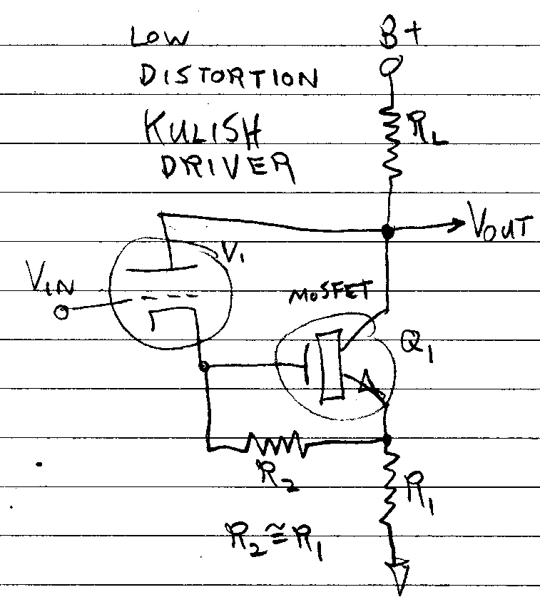

The voltage drop across the output device base to emitter or gate to source effectively subtracts out of the signal input, causing a distortion. The voltage drop across the power device input gets turned into a current by the resistor across it, and then gets added back into the output by the input device collector or plate.
With the bottom resistor below the output device set to near the same resistance, this current is similar to what would have been demanded if the device did not have the Vdrop. So the output device's finite gm effects can be tuned out.
With a triode for the input device, the plate provides Voltage N Fdbk as well, turning the whole combo into a power triode (with fairly limited current variation thru the input triode). So you just need to find an input tube with good triode characteristics.

I posted my simulation in that thread so that others can play with it. If Zintolo and others want to simulate stuff for years or twist the design into something new, that's their choice, and I have no problem with that. Simulations however, are rather boring to listen to, and at some point it would be good to actually build something.
The schematic of the final board is in post #236. As stated in that thread, the parallel mosfets are not real, only a single mosfet is used in the board at a time. The fets can be placed on the top or bottom of the board, so two are shown on the board layout schematic, along with a lot of holes.
Their isn't any resistor discontinuity with the Kulish circuit, that resistor would normally be there for a pull-down anyway, it's just boot-strapped in the Kulish design. (for the bipolar transistor case, 0.6V across it just looks like a CCS) Input to the circuit is still high Z.
The Kulish driver, with a tube input, does require sufficient voltage across the input triode to function, unless a floating supply is provided for it.
With a floating supply included for the input triode, the Mosfet can operate with minimal voltages across it. Maybe allowing the OT to be left out.
