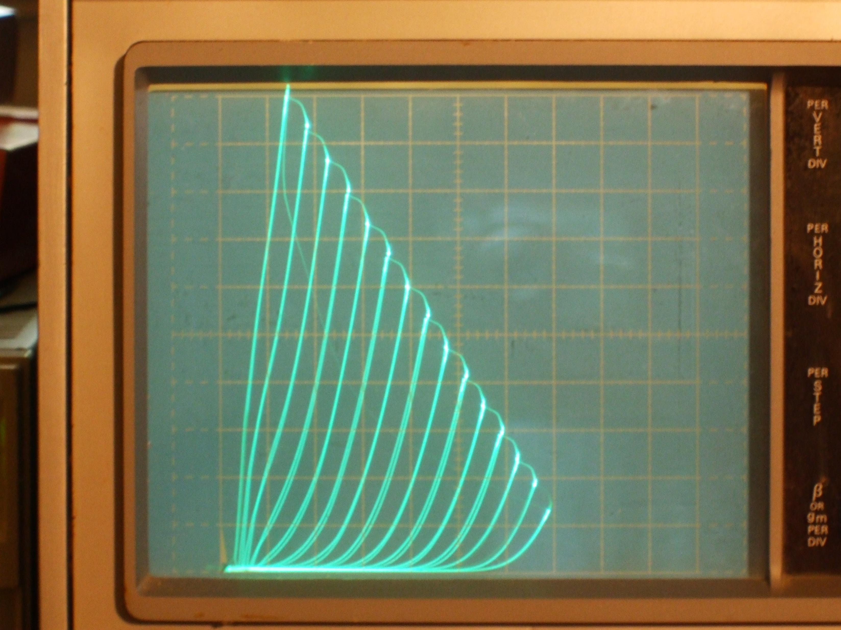

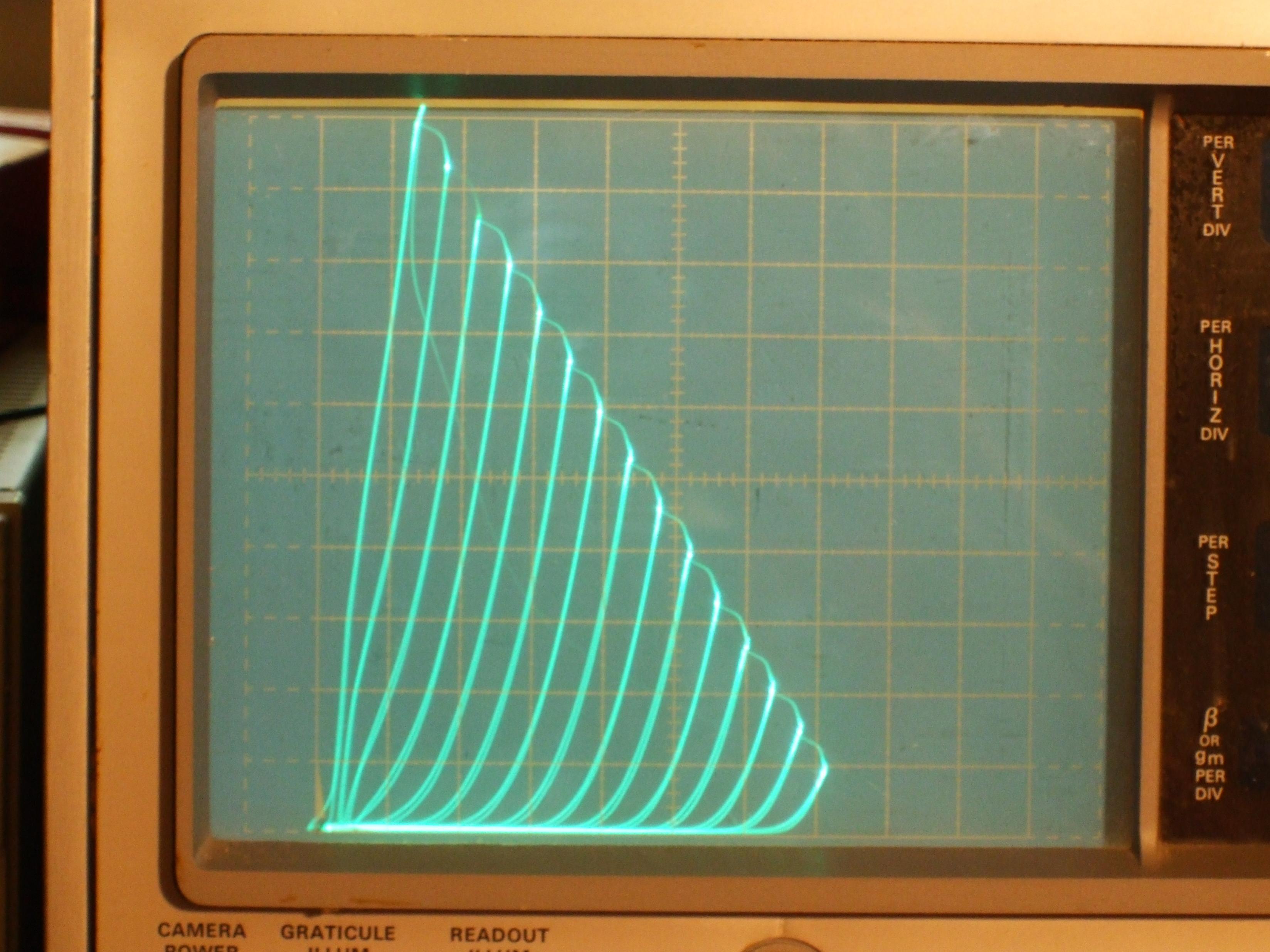

I did some curve tracing for a 31LZ6 Sweep tube using UnSET. Both pics are 50 mA/div Vert, 50V/div Horiz. and 100V supply for grid 2. 31LZ6 doesn't have as sharp of pentode knees as the 6HJ5, not sure that makes any difference here.
1st pic has the Vg2 supply grounded, so Vg2 to K is varying with Cathode drive V. Using 4V steps.
2nd pic has the Vg2 supply floated on the cathode, so Vg2 to K is constant, using 5V steps here. (no assisting Vg2 drive this way)
I was going to do a normal shunt "Schade" curve trace too, but the tracer crapped out. When I get it fixed I'll do that. I also wanted to do an internal triode trace for the 31LZ6, but that will have to wait too. Previous 31LZ6 triode tracing looked typical for a Sweep tube in triode mode, with some Mu variation (roll-over in curves)
I see the same variation in the bottom of the Unset curves bends at low current here as in the simulations by Spreadpectrum. Looks like one wants to keep Vg2 to K more close to constant for better triode emulation.
There could be some advantage in having some Vg2 drive though, since it seems to remove the roll-over effect, but fully grounded Vg2 may be putting too much correction in, causing the curve bending at the low current ends to actually tighten up a little at the HV side.
