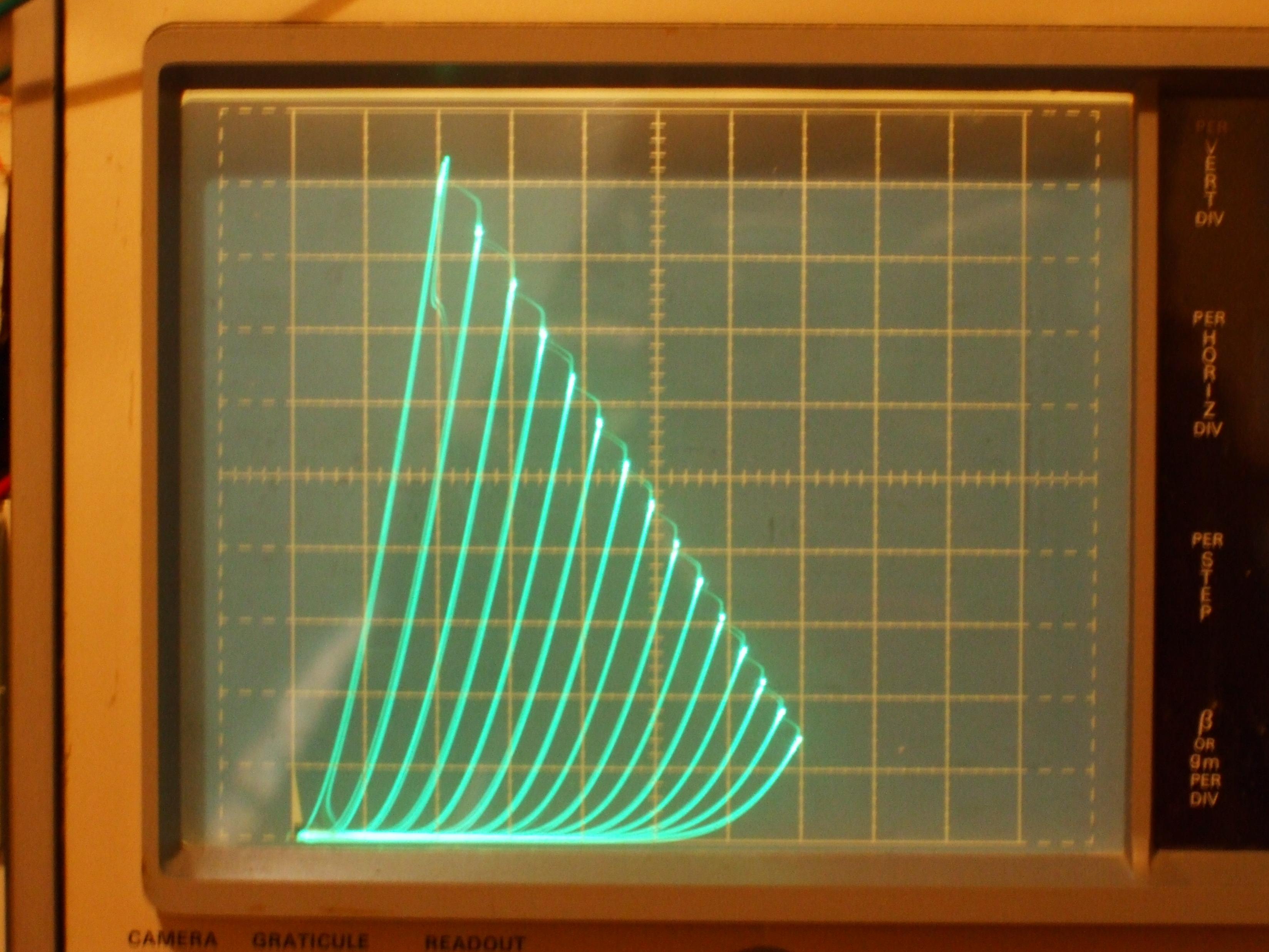

Using the "new series Schade" or "UnSET/CED" scheme allows TV Sweep tubes to be used in a triode like fashion without exceeding the grid 2 voltage specs. One can also select the Mu factor by the R ratio. This mode also provides better triode curves than are possible using the usual internal triode configuration, often challenging DHT triodes. A 6HJ5 Unset curve set below, left, followed by the usual 6HJ5 internal triode curves.

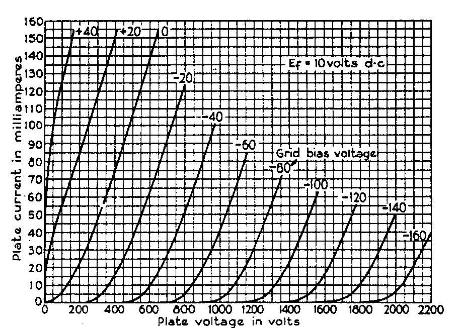

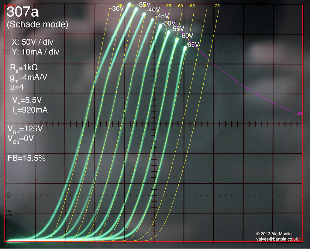

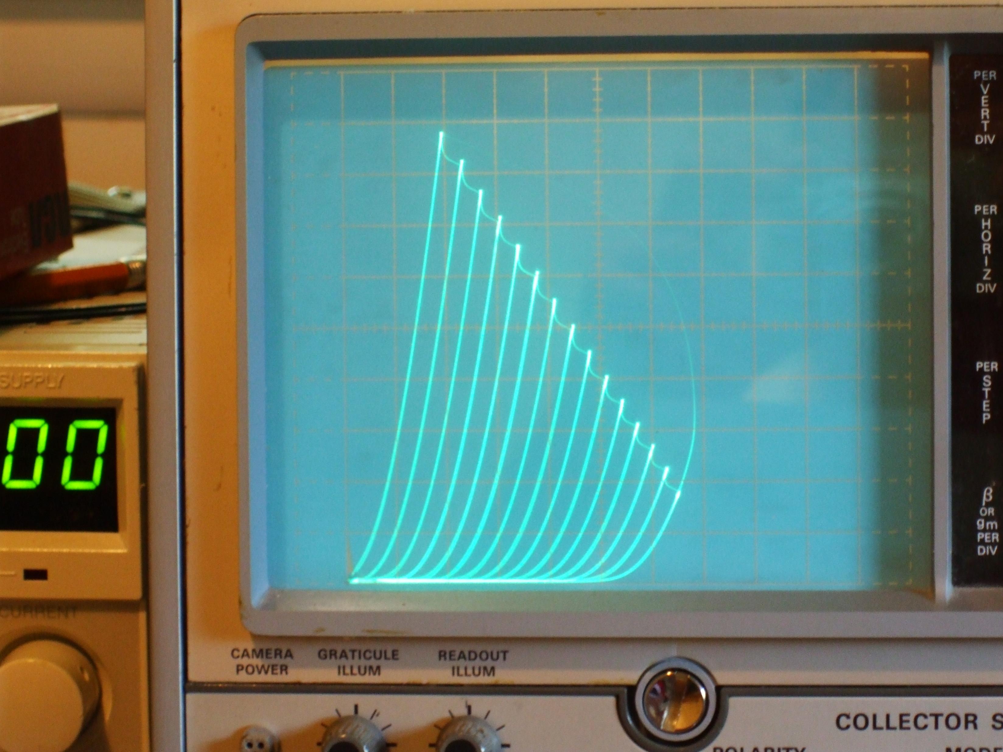

Comparing an older curve trace of "shunt Schade" with the "new" series Schade curves makes clear how much better the results are.
1) typical shunt Schade from Bartola's website (copyrighted): 307a with schade feedback (Part II) – Bartola(R) Valves
933747d1616174377-single-output-tube-lundahl-ll9202-50ma-bartola_307a-schade-png
2) "new" series Schade
933748d1616174377-single-output-tube-lundahl-ll9202-50ma-6hj5_50_50_unset-jpg
3) old style curves of 211 DHT tube
933754d1616174907-single-output-tube-lundahl-ll9202-50ma-211_datasheet-curves-jpg

Looking at the shunt "Schade" curves from Bartola's site (Zintolo's post #34 above) (ignoring the topmost bend over variations due to saturation), the triode curves get slightly closer together going upwards. Opposite to normal triode curves which get further apart at higher current. Looking at the bottom ends, they appear to have reverse "roll-over" of normal triode curves too. (the bendy part at bottom has a sharper bend on the higher voltage curves, opposite to normal triodes, as shown by the yellow model simulated curves or the 211 curves at the bottom. )
While the UnSET curves have a near uniform spacing of constant Mu.
One can leave some natural "roll-over" effect in the curves by using a higher Mu factor in the UnSET R divider I believe.
So, basically, I see the Mu variation along a load line is opposite for "shunt" Schade versus normal triodes or UnSET. Although Unset can be adjusted for almost no Mu variation using a low Mu factor R divider.
I have a few issues with the curve comparison.
1. We're comparing a late production beam tube to a very old directly-heated pentode. The beam tube has 2.5x the transconductance.
2. Ale Moglia is running the pentode at a low screen voltage for the curves he is drawing so he is running over the Vg=0 line. We don't know where that line is, so we don't know where it is starting to affect things and steal current from the feedback network.
3. I don't think the feedback network impedances are comparable. The 6HJ5 curves appear to be getting right down to I=0 at even high voltages. I'm not sure how that is possible given that the feedback network is going to draw current there. Was it excluded somehow? The 307A curves show a clear lifting away from I=0 at higher voltages which will make it look like there is more curve laydown than there actually is.
4. The 307a has very soft knees which is going to cause a lot of compression in the curves as Ia rises and Va falls. Feedback will reduce this compression but as you can see it is still there. Series feedback would have the same issue, although the CED topology might gain some advantage because of the inherent screen drive, but that is another effect altogether and not due to the series feedback itself. 6HJ5 curves have some of the sharpest knees I have ever seen so won't suffer from any compression until right at saturation.
5. I'm not sure what the feedback fraction is on the 6HJ5 curves.
I don't think there is adequate control of variables to draw any general conclusions about curve shape differences in the two types of feedback from these two examples.
Do we have any examples of the same tube operating in both modes, with the same feedback fraction? It would also be nice to have series feedback curves with Vg2-k held constant so we can separate out the screen drive effects.
This would probably be a great job for a simulator. Maybe this will be what drives me to build some circuits in LTSpice. I have no idea how to get it to draw curves but I've seen it done so there must be a way.
