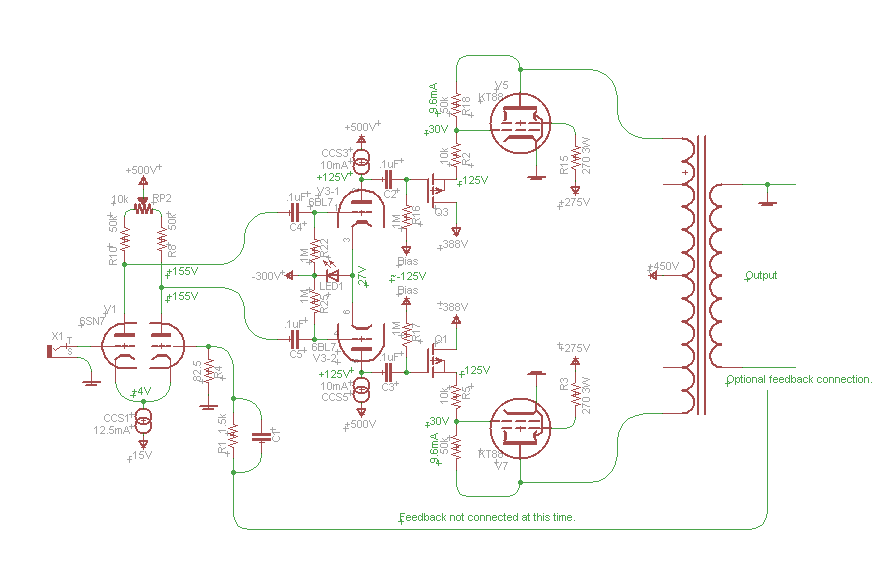

You don't have to use a separate grid bias resistor to make it work if you use a p-channel follower to drive the feedback network. See attached for an example in an amp I built several years ago.
I believe smoking-amp is saying that even if you do it the way I did it, it is fundamentally inferior to series feedback for the same amount of feedback.

Here I put the concept to the extremes with 40% plus 40%UL just because I wanted to push (on LTSpice only by now) the power (the higher the nfb the higher the available power) and the DF with that high-gain and low-THD driver (it can swing very clean 400 Vpp on sims).
As for the dissipated power (there are around 35Wpc on the pmosfets in this scheme) I'm thinking to use a heatsing as top of the amp (wook on sides), lasercut, and fix the pmosfet to it in order to better dissipate the power. For powertubes I'd cut only the diameter of the socket and then mill a bigger diameter for the tube glass.

Here I put the concept to the extremes with 40% plus 40%UL just because I wanted to push (on LTSpice only by now) the power (the higher the nfb the higher the available power) .....As for the dissipated power (there are around 35Wpc on the pmosfets in this scheme)
The available power output also goes up with increased feedback because you are shifting more of the total work to the mosfet. Your total dissipation limit increases as long as you stay within the limits of the mosfet.....
Unknown until about 10 years ago, mosfets also have a secondary breakdown limit that is not well defined, or even stated in some data sheets. Most mosfets available today are designed for switch mode operation. Long term operation in the linear region can result in random failures. ON Semi / Fairchild does not show this at all in their SOA graphs in the data sheet.
I have had small mosfets short which leaves the tube with a grounded cathode and a positive voltage on the grid. It will not live long, and in a high powered amp can even explode!
I have not yet blown a Fairchild FQPF9P25 mosfet, but I keep them under 10 watts and 75 degrees C. The chassis plate itself will not be a sufficient heat sink for two mosfets each dissipating 35 watts. If you experiment with this operation put a fast blow fuse of 1/2 to 1 amp in the cathode lead of the tube. It may save the tube and OPT. Do not try to fuse the plate with a 250 volt AC fuse, it may explode on DC.

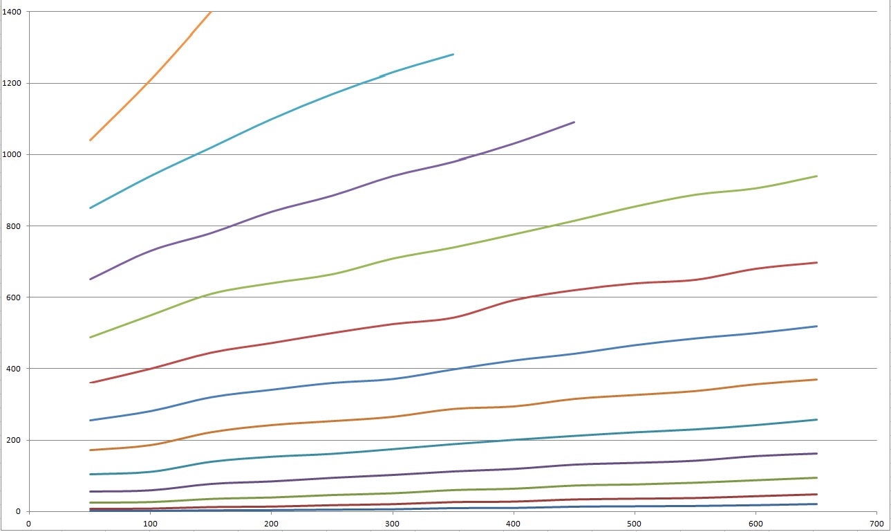

In my case I had a tube arc due to faulty arithmetic. A 6HJ5 will not live at 350 watts of dissipation even for a nanosecond. A 36LW6 however lived at 600+ watts for long enough for me to manually trace its curves into the Chernobyl zone.
The power supply I have is an old 60Hz "switcher," basically a triac style light dimmer feeding a big iron transformer / bridge / CLC filter controlled by a very slow feedback loop with about a 1 second reaction time. The output filter has a combined 1000 uF of capacitance and it goes to 650 volts. When "stuff" happens, tubes and plastic semiconductors explode, PCB traces and small parts vanish, and one of my OPT's became a magnet.
I would venture to guess that a mechanical circuit breaker would not fare well, but I have never tried it. I'm also guessing that a full on tube arc would destroy a fuse, but a minor meltdown would blow the fuse causing the cathode voltage to rise, cutting off the tube.....provided that it's not gassy.

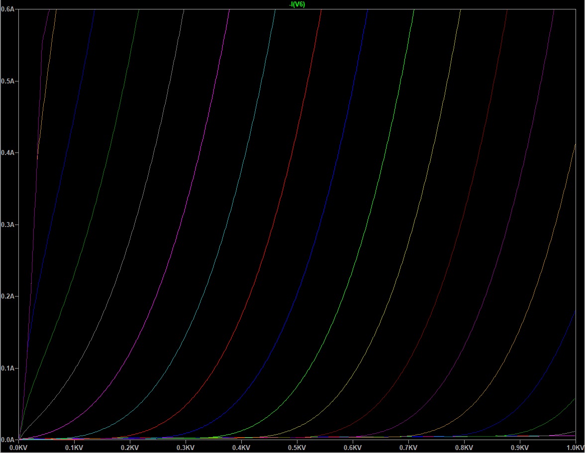

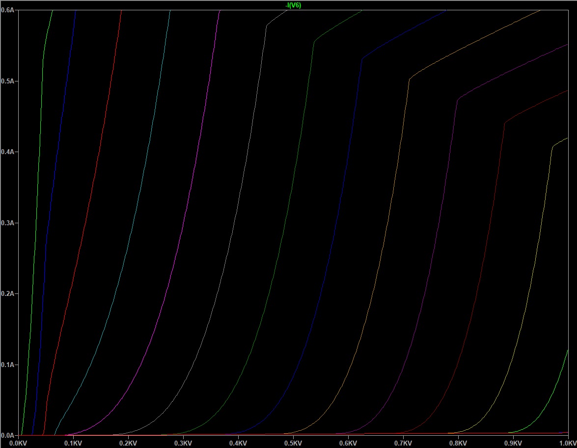

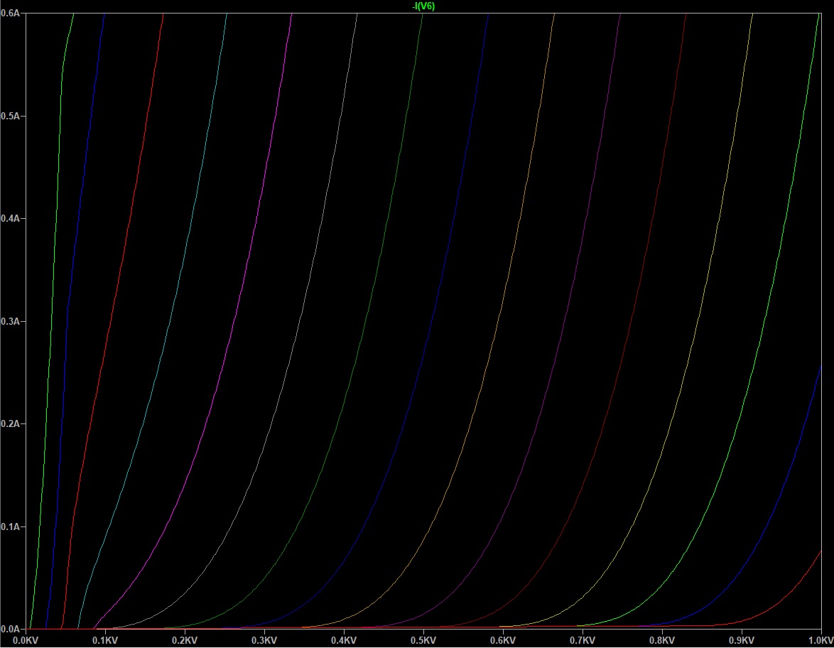

Here are the curves from LTSpice. First is Shunt feedback, second is CED with Vg2-k held constant, and last is normal CED curves.
Series feedback seems to be slightly lower rp and a little less rounding at low currents/high voltages than shunt feedback.
The surprise to me was that the screen voltage modulation in CED with a ground-referenced screen supply seems to make this even more pronounced and increase gain. I think the screen voltage modulation is responsible for more of the improvement to the curves than the series feedback is, but there does appear to be an improvement for that as well.
