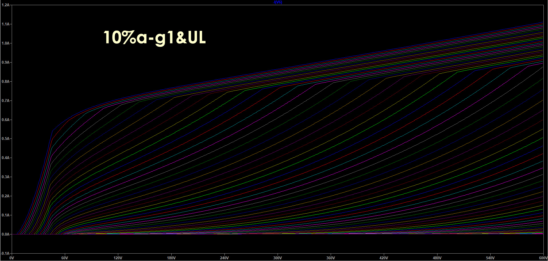

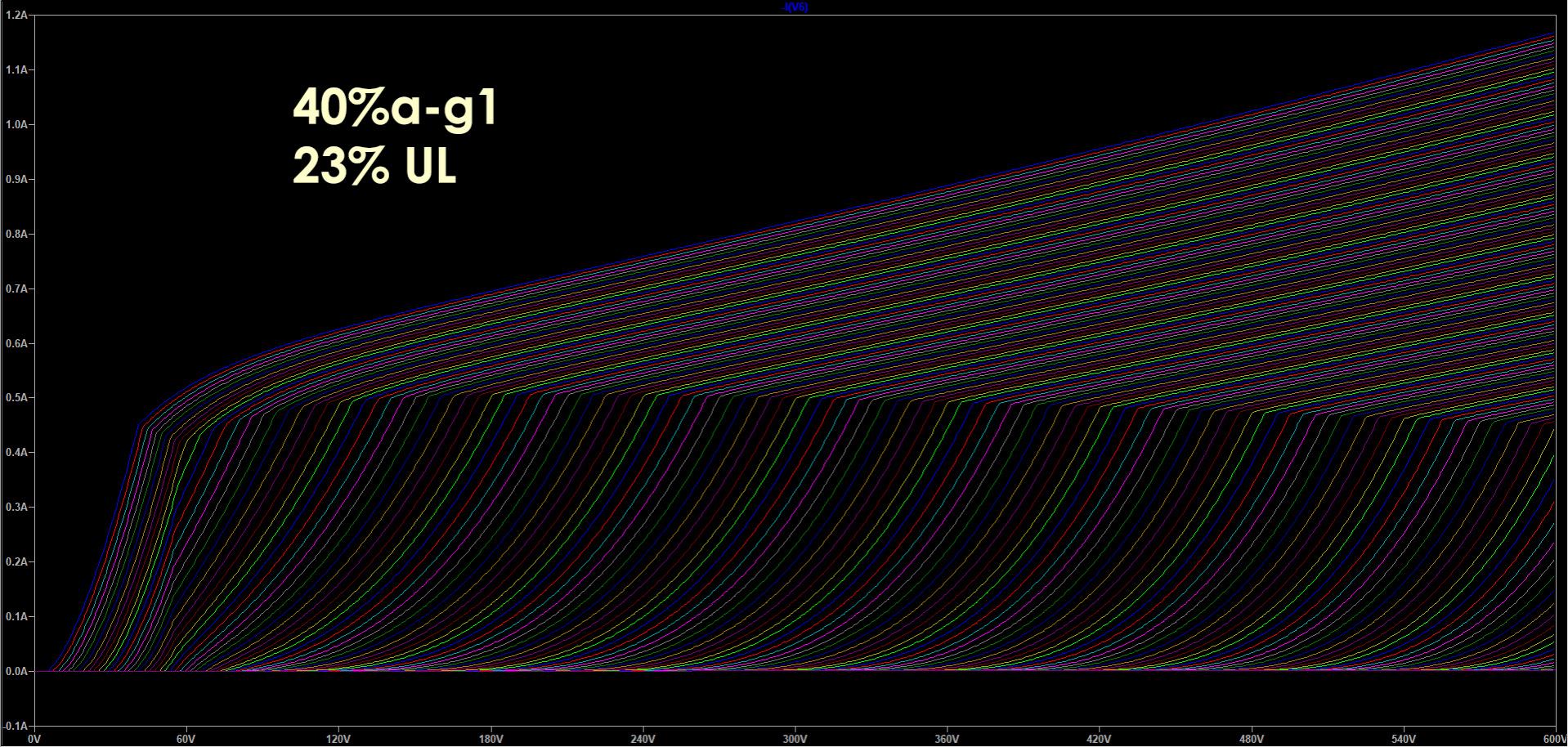

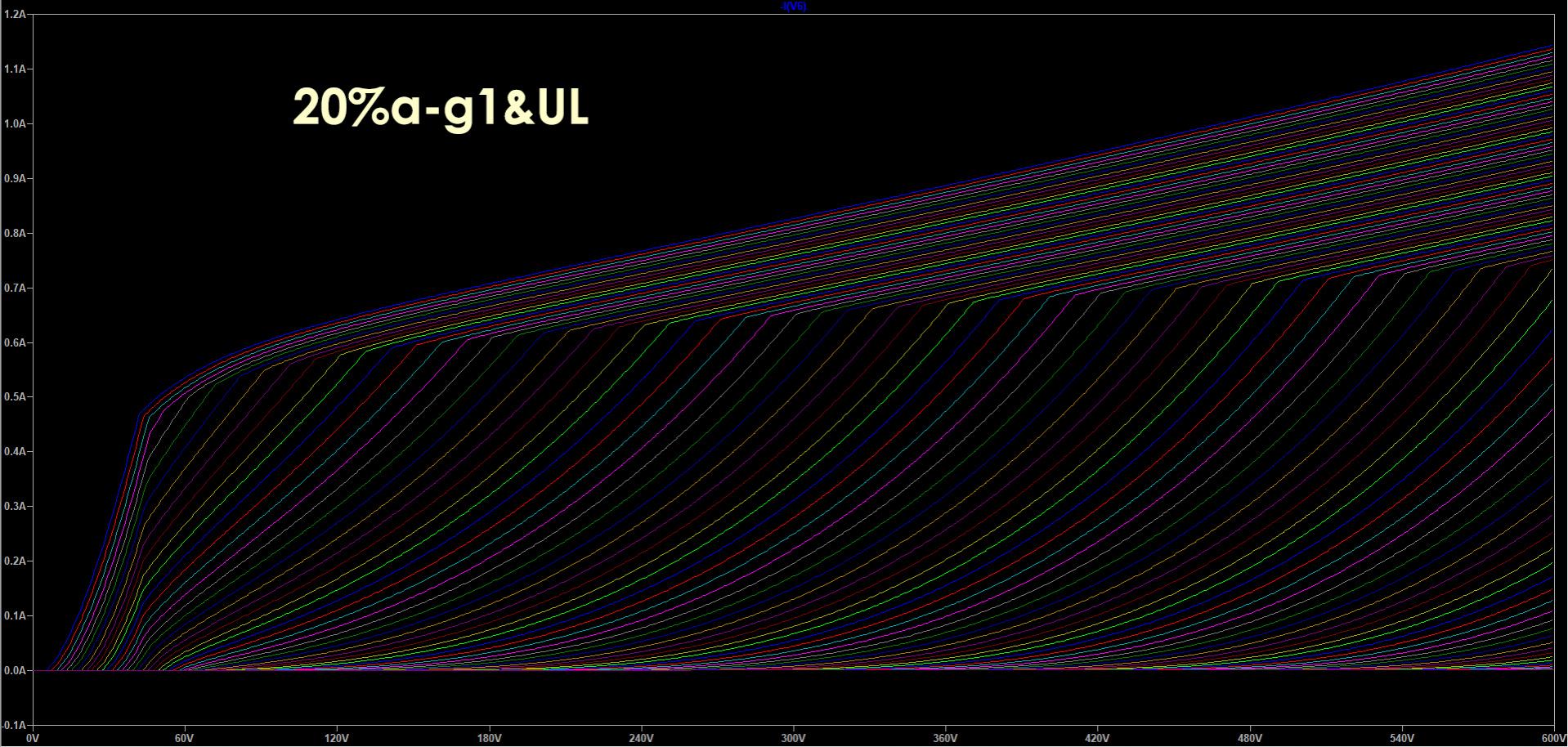

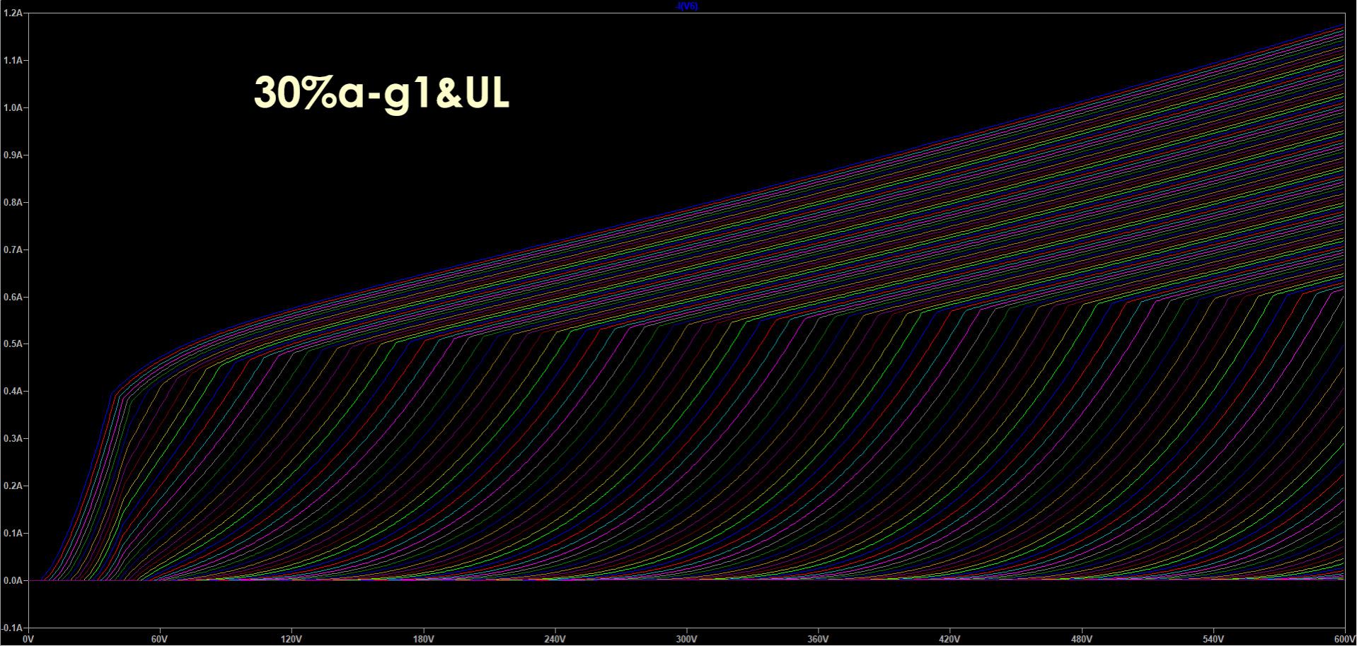

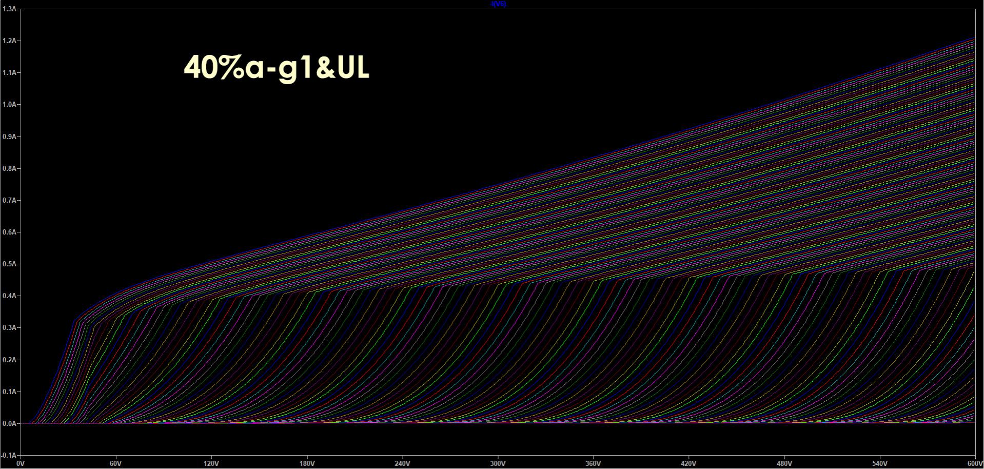

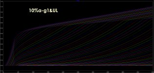

Some comparative curves for a-g1 plus UL and the related LTSpice file.

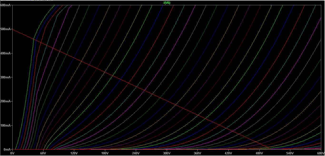

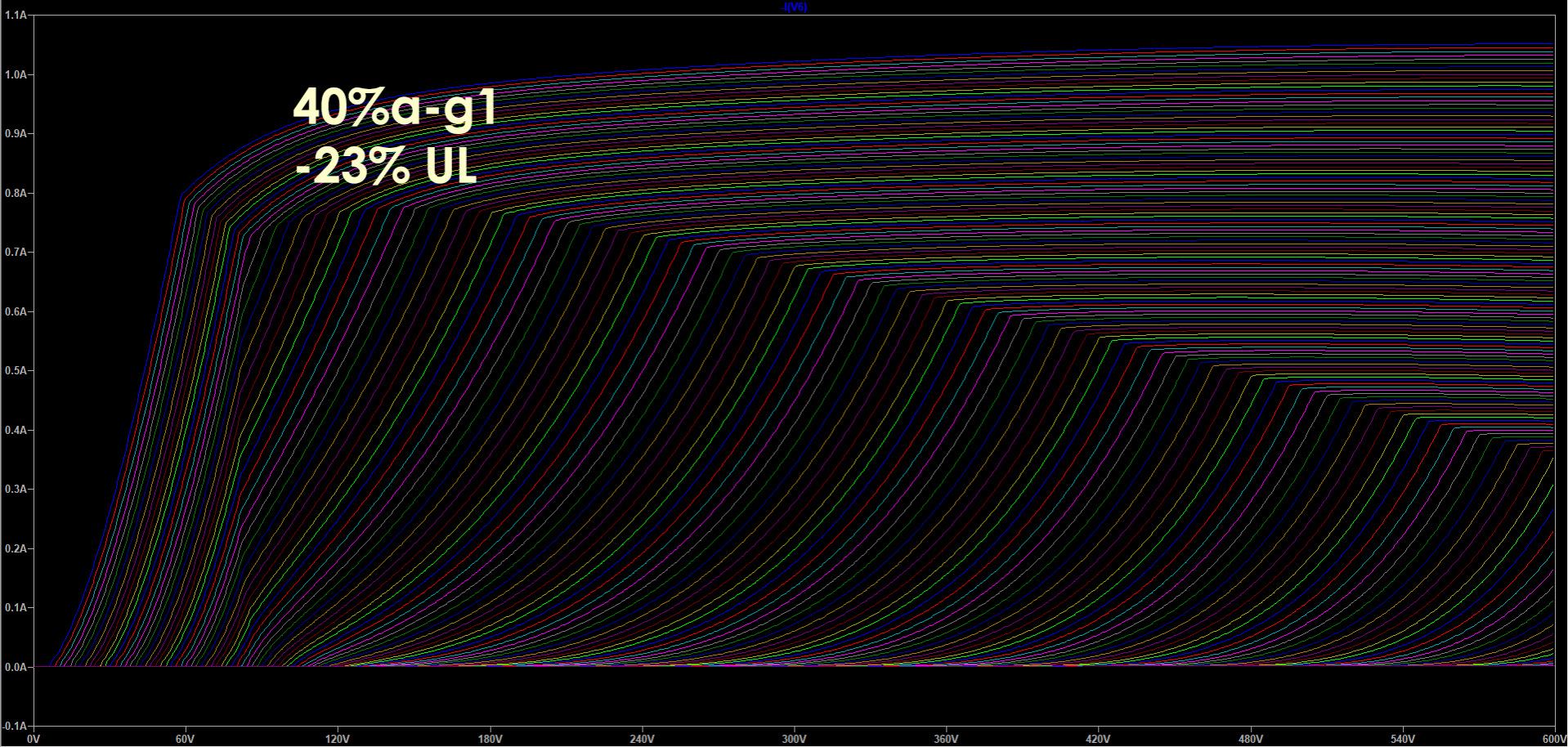

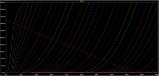

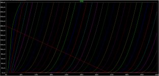

What I notice is that with 10% a-g1 feedback, curves seem more linear, whilst with higher percentages there's an area with lower gain around the knee.
Last test is just to show the prevalence of the a-g1 compared to a-g2 (UL) feedback.
Last plot is a "super-pentode" like configuration, with a-g1 feedback.
The last one being like the Mac U-C design, yes? Works towards keeping g2-k voltage constant, or at least less variable.( not sure of the magnitude of cathode voltage swing ).

I update this thread with some curves of this combined CED&UL.
All curves are with 22% a-g1 and 23% UL:
KT88 with 4k Raa loadline and 500V (more than 80Wrms)

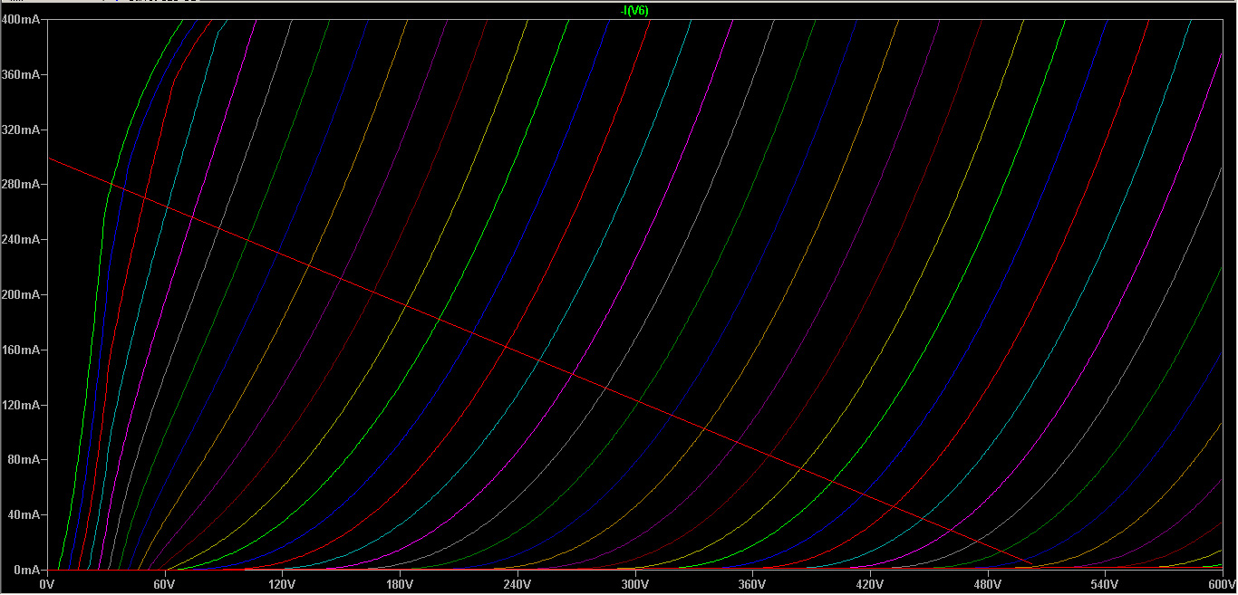

EL34 with 6.6k Raa loadline and 500V (more than 60Wrms)

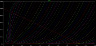

EL84 with 8k Raa loadline and 400V (more than 30Wrms)

I've not yet built it because I'm moving to a new house where I'll have more space to experiment. I confirm that a-g1 feedback is way more effective than a-g2/UL, but this was clear to anyone.
The synergic effect of UL is that we can "focus" the curves around the loadline (together with the screen resistor) by chosing the right amount of it and gain some more linearity and DF, plus (last but not least) simplifying the power supply so reducing costs and complexity.
See it on the opposite side: If you have an output transformer already on hand or you can find a cheap one, you can play with B+ voltage and a-g1 feedback to find the sweet spot for that specific tube.
The very low internal resistance of the tube in this scenario will allow a weak output transformer to increase its bandwidth and perform better. Again giving better results with lower costs.
