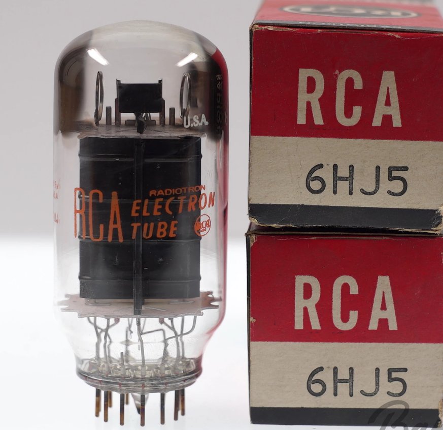

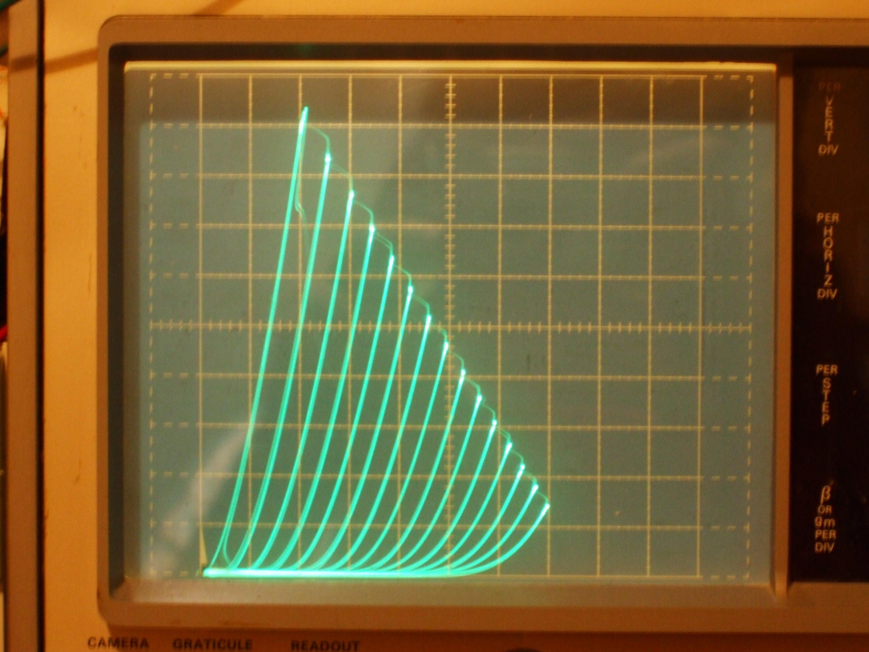

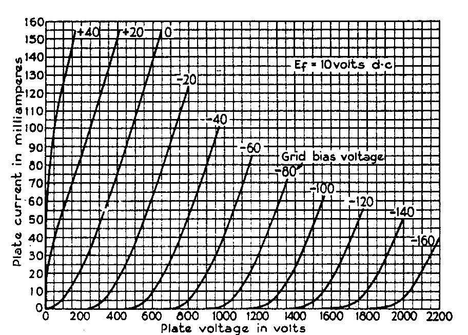

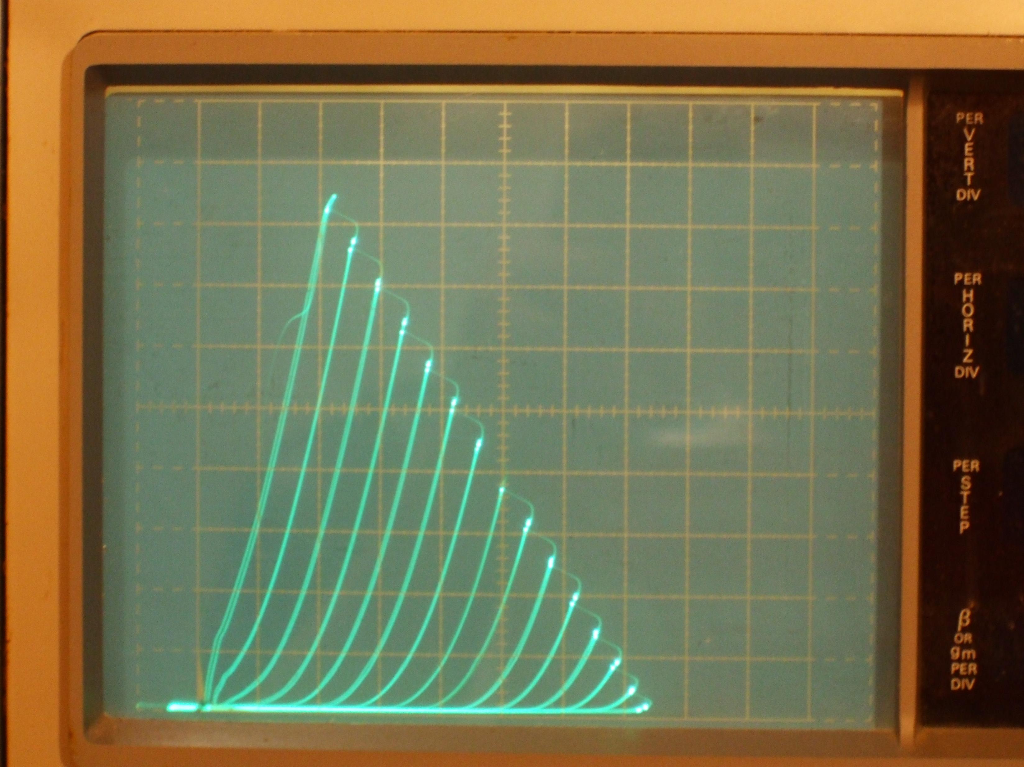

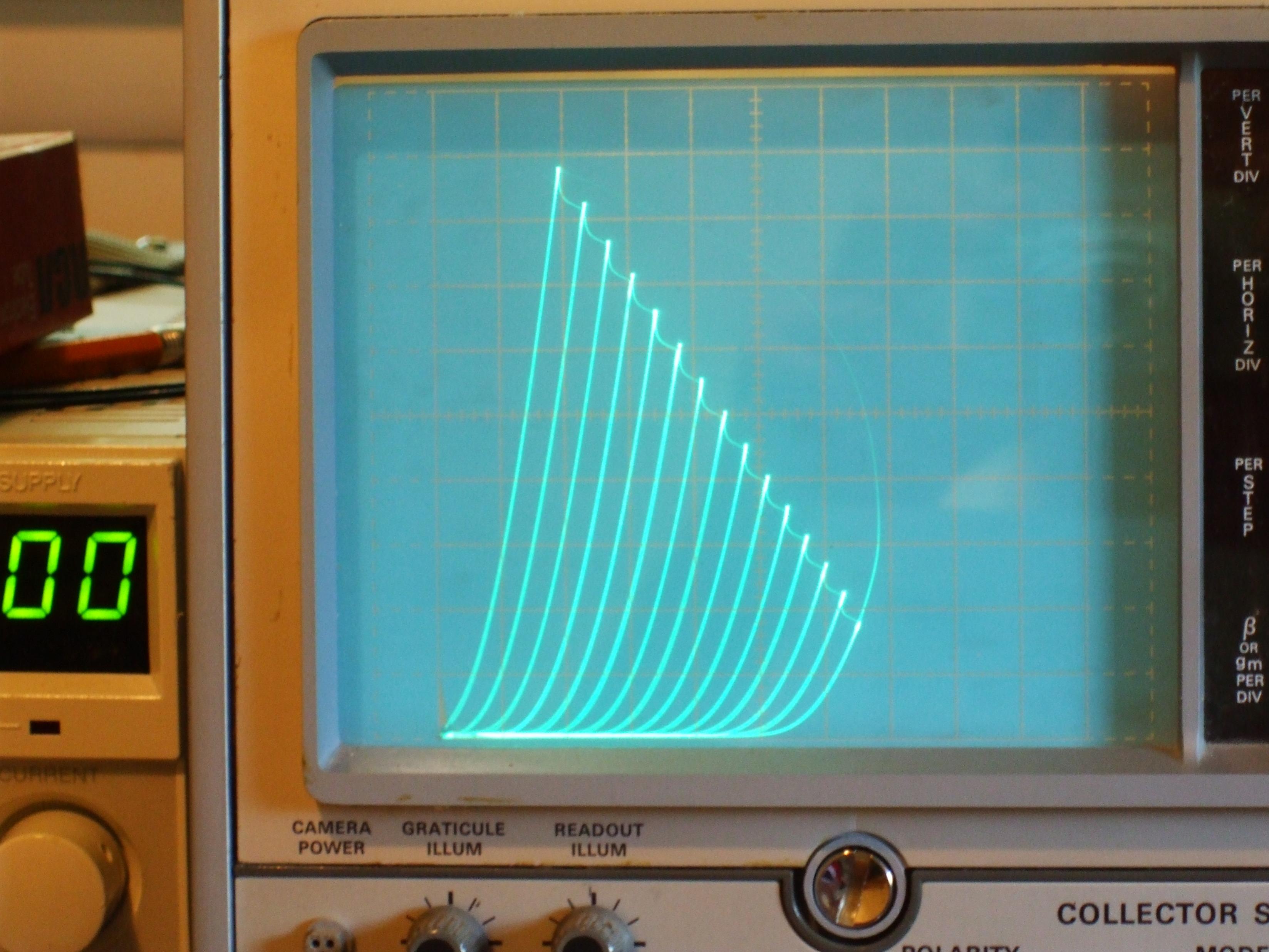

I see some $$$$ tubes being bandied about here. I assume you all are familiar with the latest "new" Series Schade (= UnSET, CED at Tubelab) technique. One can take a $10 TV Sweep tube and make it into a 211 type curve set (except using lower B+ and higher current for practical B+ supply and OT impedance).
1) 6HJ5 native internal triode curves (50mA/div Vert., 50V/div Horiz., Mu 4.2)
2) 6HJ5 UnSET triode curves ("" , "" , Mu 4 )
3) 211 triode curves
4) 6HJ5 pic
Nothing special about the 6HJ5 (24 Watt TV diss = 35 Watt audio tube, $12), most any TV Sweep or standard Audio type will do. The amount of 2nd harmonic in the curve set can be adjusted by the local Fdbk gain setting. (ie, 300B 2nd H easy to emulate)
4) 6HJ5 pic
Hi smoking-amp - I was not familiar with the UNSET / CED / crazy fdbk circuit, might be over my head but reading into it now, very impressive triode-like curves you've posted here and elsewhere. Have you listened to any of these breadboarded sweep tube output stages?
I haven't made an amplifier yet with the UnSET technique, just trying it out on the curve tracer so far. Once I get past taxes/paperwork I will be building one. Already have the parts at hand for both a SE version and a P-P version.
George (Tubelab) has been building and testing these type of amplifiers, developing a PC board too. Although I think he has been using a higher gain figure than I've been curve tracing with, which will put some 2nd H into the sound. (I'll let him work out any kinks, like mysteriously blown MosFets, before I build one. It works well on the curve tracer.)
The technique also allows for more power output than would normally be expected from a given tube, since the driver power is added to it.
