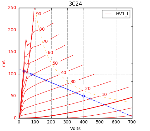

Got my hands on some functional 3C24. They run much cooler now that they're not filled with gas
Here are the curves with a 6.5K 400V 50mA load line. This would make for 7-8W. Plate resistance at the idle point measured at 9.4K.

With that rp and stage gain, I don't think even 100% local feedback would get you to your Zout target, so it looks like a two stage feedback approach will be necessary.
What is your sensitivity requirement at the input? From there you can figure how much excess gain you need in the other stage for feedback.
Any tube ideas for the other stage?
Edit: Eyeballing the curves, you should have a very 2nd-dominant spectrum from this up until clipping.

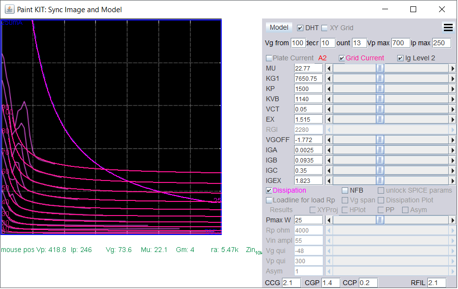

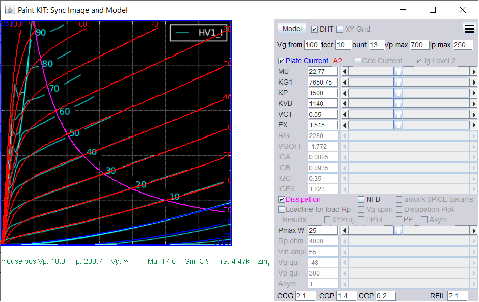

I have a functioning LTSpice model for the 3C24 now using the Dmitry Composite tool. Working in simulation, but might need to be further optimized. I prioritized matching the model within the operational area of a potential amplifier.
Here are the plate curves of the model overload on top of the curves I traced.
And grid current over the current measured on my tracer.

It looks like your 50mA operating point already gets you to 80% max dissipation of the 3C24. You could just push current and voltage up a bit and get a bit more power out. I have been trying to design to keep these tubes at 90% so that the plate stays hot enough for good gas absorption.

Your load line on the datasheet curves looks perfectly symmetrical at 50mA/400V. On the curves from the tracer it looks like at 400V, it needs just a little more standing current to make symmetrical clipping. It looks like 60mA might be too much and push the asymmetry the other way. I think 400V/50mA is already quite close to optimal. Optimal might be just 55mA or so.
