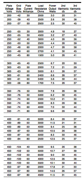

Andy, I don't think that the WE datasheet is representative for all 300B's.
450V, 50mA, 300B, about 9.5W output.
Lundahl themselves indicate to have a better transformer for a 300B, and they are right...
As I said, I compared LL1664/70 directly with LL1682/50 on a few occasions with my 300b SE and it was no contest - the LL1682 clearly sounded better, and it wasn't subtle. Speakers were Alpair 10M. The LL1682/50 would not be considered an obvious match for a 300b at 5K into 5R. You might even call it "sub optimal" but in practice it works audibly better. I'm not the only 300b user that prefers a 5K OPT, and it's a small step to go a little higher. I was using more like 320v a-k. You don't have to up as high as 450v. Depends on how much power you need. WE data attached. Distortion is low at 350v a-k and 50mA into 5K.
I was using EH 300b tubes. Could be differences between makes - I can't comment on that.

Euro21said it right at the start of the thread. Use it at 6.5K with a 300b. It will sound really nice. My daily 300b SE amp has LL1682 50mA OPTs. That's 5K into 5R so quite similar. I have a pair of LL1664/70ma which are 3K and though this might seem a better match on paper it sounds pretty average and nothing like the excellent sound I'm getting from the LL1682. Believe me, I've been there with this one. If you look at the WE data for the 300b, the lowest 3rd harmonic distortion figures are at 5K. I wouldn't hesitate. Drive it with a C3g or something like that and you're good to go.
Another good idea, thanks Andy, my speakers are 92dB/W, so do not need a large power output for my listening space, I am happily running them at 3.75W at the moment, so the higher primary Z with lower distortion and a slight power loss is no problem I think. Will think this over as well, interesting results with your 5K transformer.

2.5K has traditionally been used for good reasons. A smaller primary inductance gives lower distortion, deeper bass response and a less hard and thin sound.
There is no tradition with 300b - anything from 2.5K up to 5K is common. But we're looking at 2 factors when it comes to distortion - the gap and the primary value. For instance Lundahl quote the same inductance for LL1664 at 3K, LL1663 at 5K and LL1682 at 5K into 5R. It's 35H for the 50mA gap and 17H for the 100mA gap. My preference for LL1682/50 over LL1664/70 may be partly due to the higher primary value and partly the higher inductance. And then we have the operating point as another variable, the speaker load as another. In my case the speaker and operating point were the same. My experience with OPTs and plate chokes has been that a higher inductance gives a cleaner sound. With plate chokes, for instance, I've found on two occasions that putting 2 plate chokes in series sounded better than just one. Your ears and taste may be different from mine, of course.
