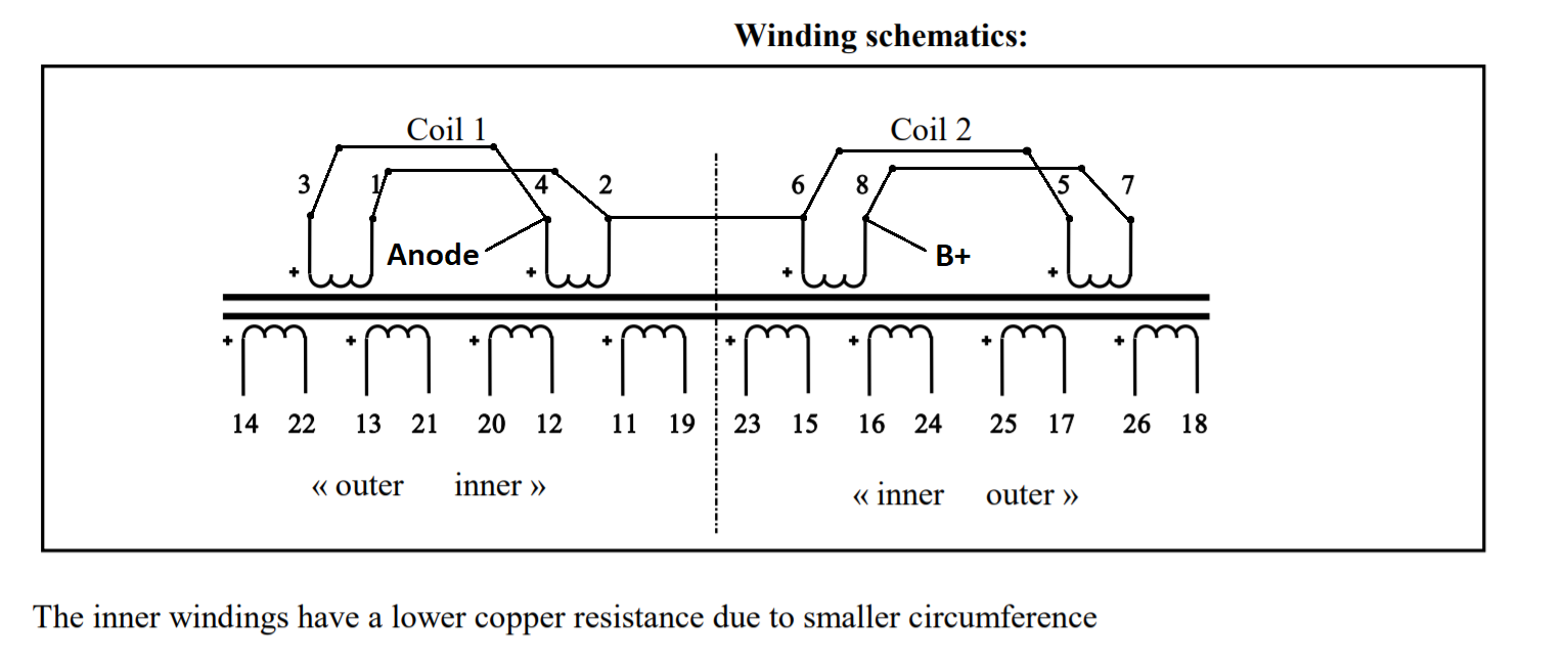

Thanks for the ideas everyone. Paralleling the primary windings is interesting, a lower primary Z at a higher current rating would open up many more possibilities. I may touch base with Lundahl / Kevin at K&K Audio and get their input.
Paralleling the primary windings is normally not recommended by Lundahl. It's likely related to their winding scheme. I would contact them directly.
I know for certain that this transformer worked really bad on the low impedance with rather poor high frequency response: 814 SE Amplifier: Custom Output Transformers – Bartola(R) Valves
Lower impedance is also not great at 0.8 dB power loss.
At 11K and 50 mA it's a good match to a 211. 100H will be good enough. I am sure there are other tubes as well.
However if the output power is less than rated, one can use more current. 50 mA is not a barrier beyond which one cannot go. The transformer is rated 25W @30Hz.
With the 211 the typical power will be 10W with 50 mA. So one can either leave as is and get 10W below 20Hz (sic!)....or can use mode current.
If one uses 60 mA then the DC induction will go from 0.9T to 1.08T. So the room left for the signal will go down to 0.52T (originally 0.7T) for the same total induction of 1.6T. This means that signal one can apply at 30Hz will be 390V RMS which means about 14W @30Hz. At 1200V plate voltage with 11K the 211 should give this kind of power.

I think Ale was using the 85mA gapped LL9202, regardless the HF response is not great on the 50mA model. Wired for 6.5K in an 801 A2 prototype using plate to driver cathode NFB, HF rolloff was abrupt at around 15-16kHz, down 2-3dB at 20kHz if memory serves. It was worse wired for 11K. They also seem to have a ~20khZ resonance seen on square wave below.
These transformers didn't cut it in that 801A design, so custom transformers from Sowter will replace them, the reason why I have them on hand. They have issues, no doubt, but subjectively they still sound quite good, so thought it was worth asking opinions on what to do with them.
The B+ for a 211 design is too hot for my household, as much as I would love to dabble in the 1kV+ transmitters. Given the HF response is best at 6.5K, that's the direction I am likely to go. Pushing the current a little bit would be desirable. If I could go 60-75mA with in a 6-8W amplifier, that would be great.
If you use it as 6.5K, for 75mA you will be causing a DC induction of 1.35T leaving just 0.25T for the signal. This might sound too little but in reality those original 575V RMS at 30Hz become 205V RMS. That's 6.5W @30Hz as you would like.

Well in that case, I would probably go with the 300b (or PX4 if you want to be fancy). The naturally low plate impedance will counterbalance the capacitance of the transformer.
If you wrap a little bit of NFB around the 300b, you will get a pretty decent damping factor and HF extension.
