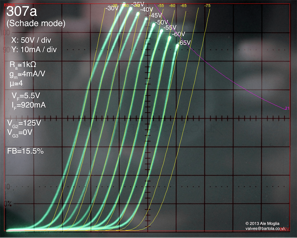

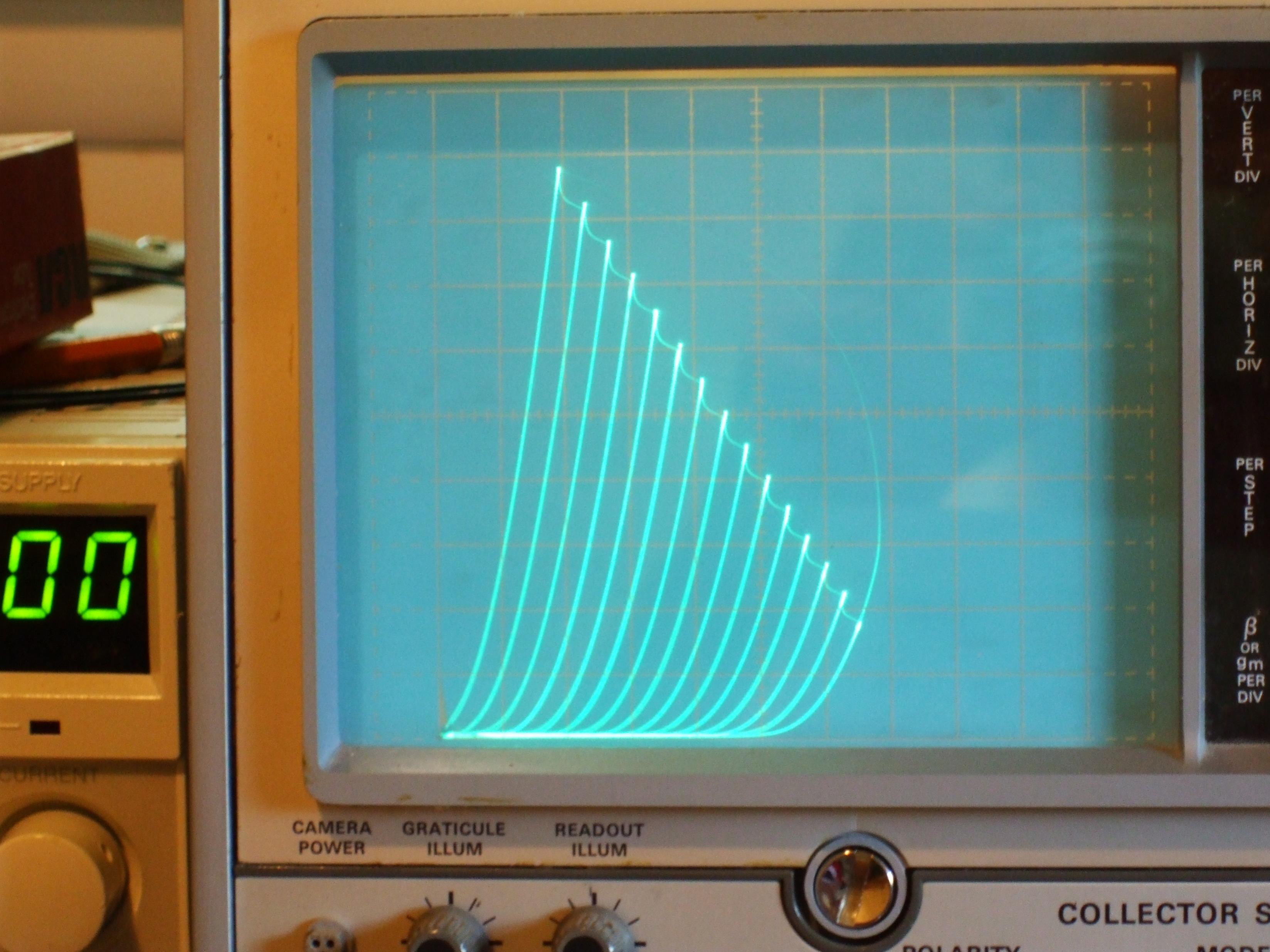

UnSET, CED ... can largely remove the "roll-over" effect in triode plate curves, where the rightmost (HV end) curves have a higher Ri than the leftmost ones (LV end). This roll-over is caused by wire proximity effects where the grid 1 wires are too close to the cathode compared to the pitch spacing between wires in the grid. This causes mis-tracking between the grid 1 non-linearity and the grid 2 or plate non-linearity. Generally occurring noticeably in later indirectly heated tubes, when gm became the figure of merit. (with N Fdbk then available to fix it)
Looking at curves for DHT triodes, one usually sees the earlier style curves with low-roll-over. Where each curve is nearly the same as the others in the set. So the effect of UnSET .... is to convert modern tubes into older type tubes, but preserves gm and current capability of later tubes.
This roll-over effect generally adds 2nd harmonic to a tube's sound, with some low level higher harmonics. There is still the distortion present from the individual curves being diode curves, and the load line cutting across them diagonally. So higher load impedances will still lower distortion.
UnSET.... accomplishes this by replacing the internal tube non-linear N Fdbk
with an external resistive local N Fdbk. Like Schade Fdbk essentially. Except the more typical "shunt Schade" scheme has a fault inherent in it. There, the Fdbk resistor is supposed to send back a current proportional to output Voltage, but that is corrupted by the input drive V on the other end of the resistor.
One would think that would not make much difference, and it wouldn't if the tube were inherently linear. But most pentode type power tubes have a roughly square law response (Vin to Iout) so they actually need a distorted input to deliver a linear output.
The "new" series Schade scheme used in UnSET.... separates the input drive V over to the cathode, instead of the grid 1. Which removes the Vin distorting influence from the Fdbk, which is now converted to a Voltage feedback at grid 1 by a resistive divider. This resistive divider sets the closed loop gain for the tube essentially, and is a parameter that can be used to influence the results.
Applying the drive V input to the cathode now (using a P channel MOSFET follower under the cathode) has a couple of additional effects. The input drive increases the effective B+ across the tube (besides the usual grid 1 to cathode drive). This increases power output capability when requested. It also increases the cathode to grid 2 voltage for a pentode, providing screen grid drive in addition to grid 1 drive. (UnSET .... also works for triodes too, so this screen drive effect only occurs for pentodes, and mainly for LV Screen tubes)
So the net effect of UnSET.... is to lower distortion to old DHT style levels, but does not pretend to remove all dist. And it increases the power output available (like around 20%) from a given tube, since the MOSFET drive power is added to the tubes power (without affecting sound I might add, the MOSFET is in follower mode). And one can now use the later tubes with higher current capability, and often cheaper tubes.
The amount of "roll-over" correction applied can be adjusted, by the setting of the gain controlling Fdbk resistor divider. Higher net gain means less internal correction Fdbk. So one can leave some 2nd H in place to emulate a 300B say.
Comparing an older curve trace of "shunt Schade" with the "new" series Schade curves makes clear how much better the results are.

1) typical shunt Schade from Bartola's website (copyrighted): 307a with schade feedback (Part II) – Bartola(R) Valves
2) "new" series Schade

Forgot to mention that the older "Shunt Schade" scheme depends on a linear V to I driver into a low impedance summing node. Tubes are not generally optimum drivers for this task.
You might also notice (requires a ruler) that the conventional "shunt Schade" scheme has some reverse roll-over in its curves. (really need a curve set over an extended plate V range to see it clearly) Caused by the inherent dist. in the R Fdbk, due to the drive V interfering, or non-linearity in the V to I driver stage.

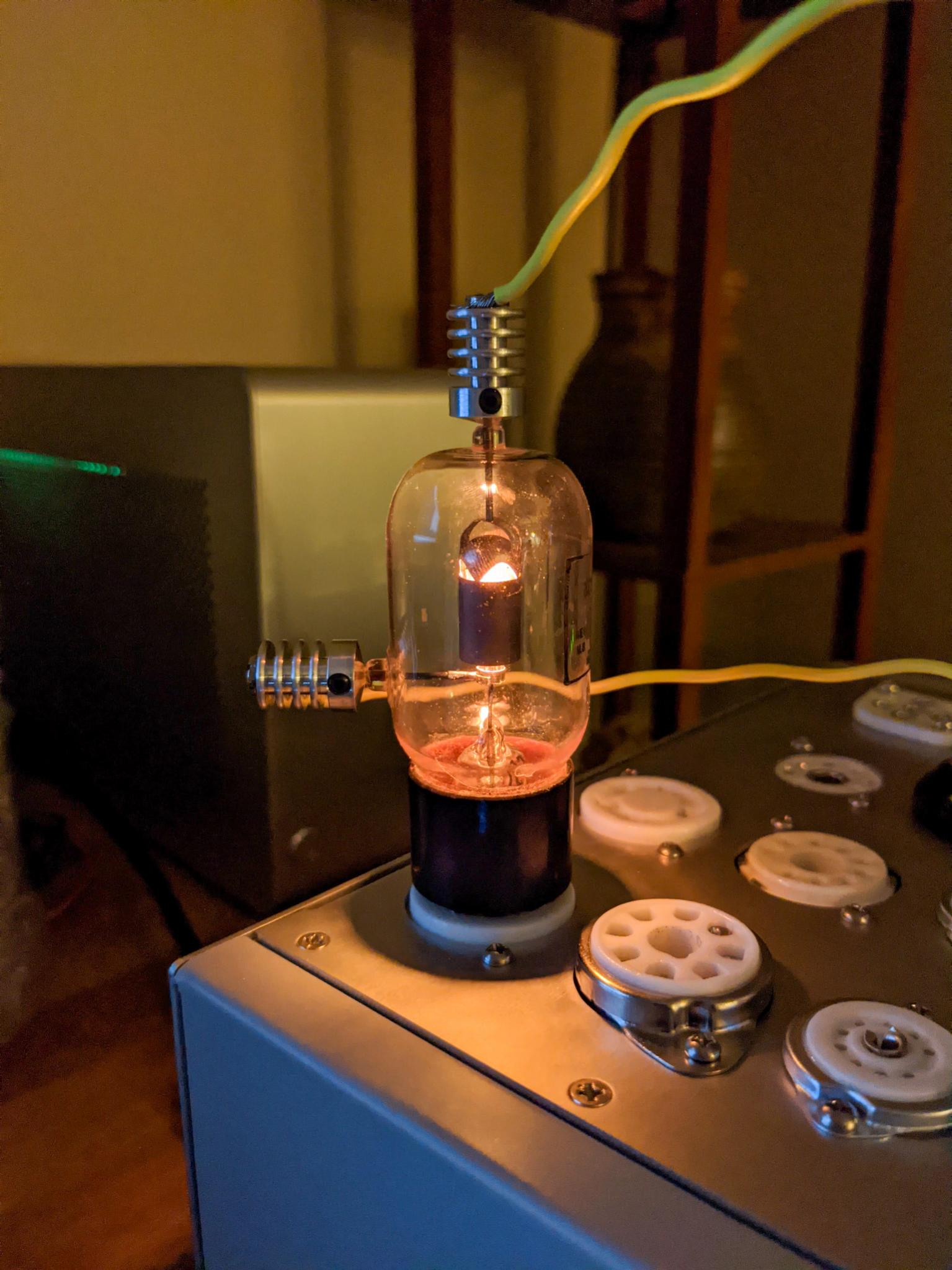

I have been given many good ideas on this thread, so I appreciate all of the feedback. I think the idea that has intrigued me most though is the 3C24 / 25T from SpreadSpectrum. This tube has been on my short list to use, I bought a small batch along with Eimac caps recently, but did not think to pair it with this transformer. The tubes themselves are still pretty cheap. I am putting together a prototyping board, so can breadboard a 3C24 amplifier when it is done.
Think I will keep the LL9202 primary wired as is at first and try a 400V 50mA bias point, only 80% of plate dissipation but these tubes get hot as hell anyway by the filaments alone! The 6.5K load will lower the amount of feedback needed, we'll see how it goes from there.

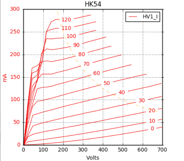

You know, I wasn't sure of the issue at first but I came to learn every single 3C24 I have is gassy and won't conduct! Bought six of them untested dirt cheap, well seems that was a mistake 🙄 it is a common problem with 3C24, but I have a legit tested pair on the way, so should be able to trace the curves next week.
Fortunately, my NOS pair of HK54 traced no problem, here are the A2 curves for them. This tracer has two separate HV supplies, so you simply connect the second HV supply to the grid for A2.
At a certain voltage threshold, they will ionize and current spikes, somewhere around 3-400V. I've come across a few threads here where people cooked the tubes to degas, but sounds like a mixed bag, thought it better to just grab a tried and tested pair.
I've had some transmitter tubes that ionized at like 50-75V. Those cleared up very quickly and returned to normal easily. The gas cloud was blue and visible well outside the plate structure.
The ones that I've had that ionize at ~400V were more stubborn. The gas glow was inside the plate and very faint, more of a purple/pink color. I cooked one for 12 hours and it seems less gassy (the ionization event is now less abrupt). The metal on the plate structure looks a bit different now, like a bit of a patina has developed, I assume from absorbing gas molecules. I assume that if the gas hasn't cleared up in 12 hours, the chance of it clearing up is pretty small.

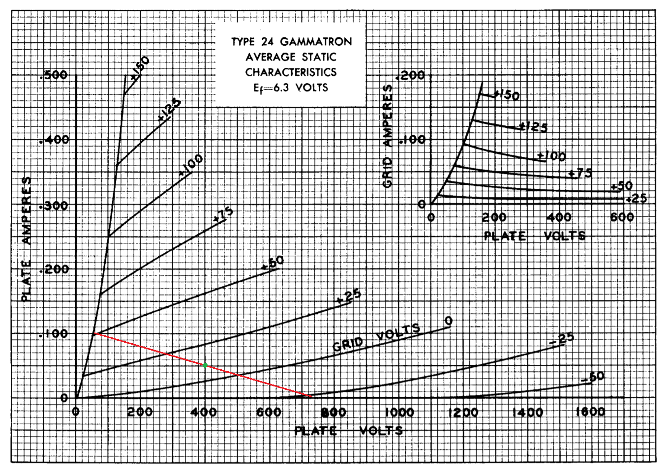

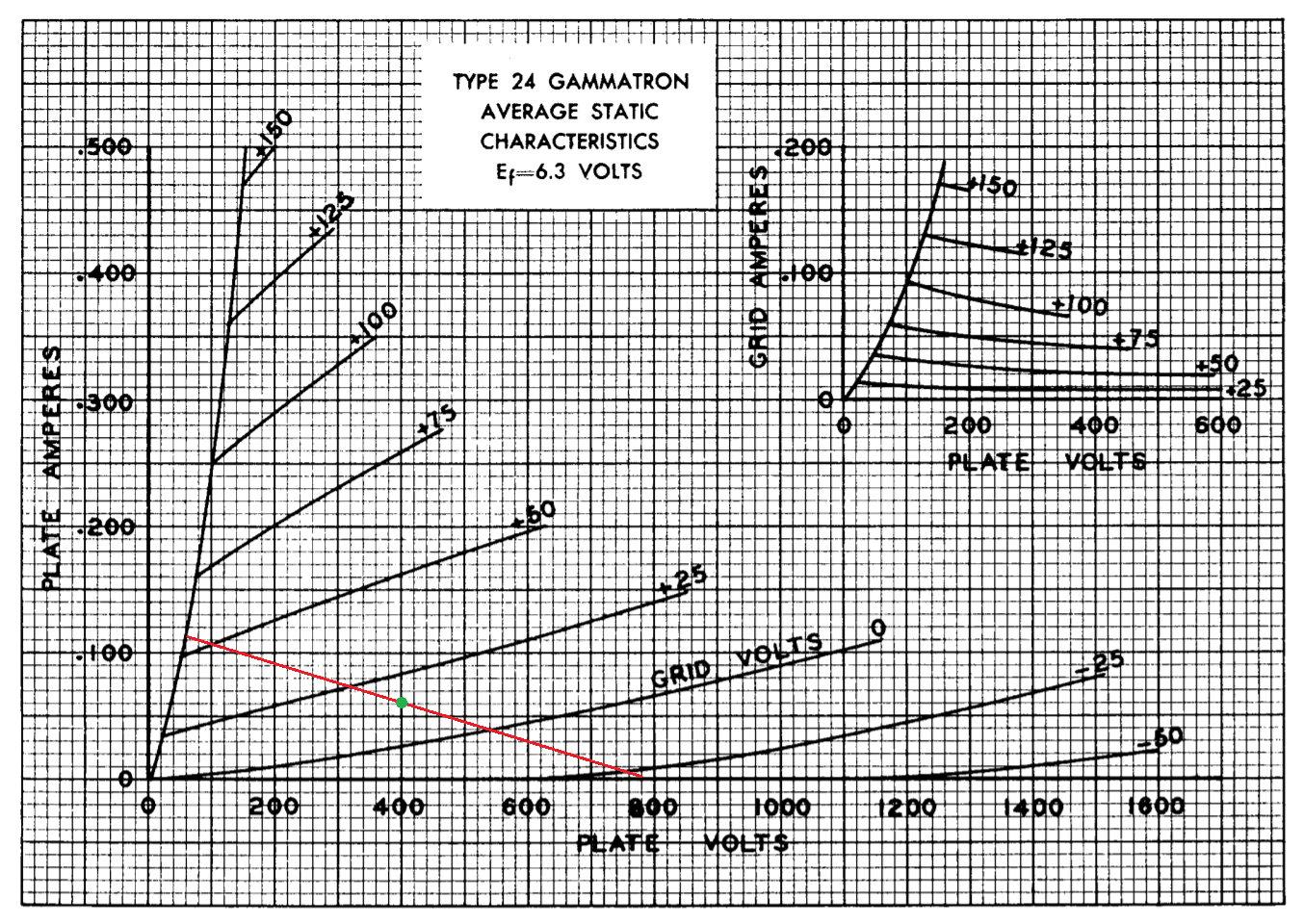

Yeah seems doable! Similar to my 801A amp, think I would use a grid-biased DC coupled cathode follower to fine-tune the 3C24 bias, maybe 6AH4. I was recently shown a 3C24 schematic with a 5K load, used plate-to-plate local feedback on a resistively loaded EF86, so it can be done.
Load line maybe like below, 400V 60mA 6.5K. Practically speaking, I would need some sort of ventilated enclosure for the 3C24. There is a plastics shop near me that does custom work, I wonder how polycarbonate would hold up.

Whoops, wrong load line above, should be 400V 50mA. Could rewire the primary for a 3.25K:8ohm 100mA 25H setup and rebias at say, 300V 75mA, but feedback needs would obviously be much greater.
