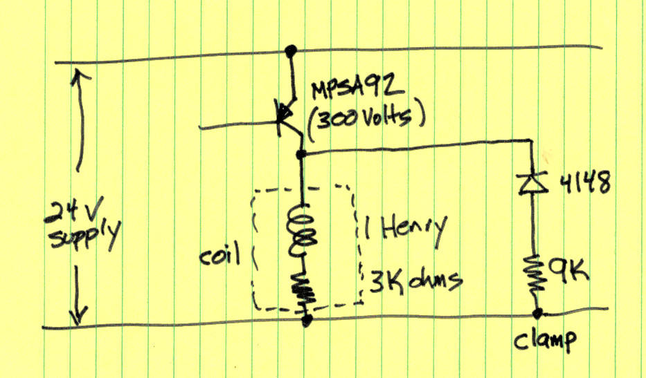

If you approximate the distributed RL nature of the real solenoid, by a lumped equivalent circuit having a single R and a single L, ...
then most of the energy in the flyback pulse is dissipated by the resistor, not by an ordinary flyback PN diode.
To get significantly sped-up turnoff, the external terminals of the solenoid must be clamped at a voltage significantly greater than the rated coil voltage, so there's significantly more voltage dropped across the clamp than across the coil resistance. For a 24V coil, something like a 75V zener and a switching transistor rated Vcemax > 120 volts. Or just a simple resistor whose resistance is 3X the coil resistance.
If you mess with it in simulation, you'll probably also see some lightly damped ringing in the series RLC circuit, at the instant when the voltage across the clamp falls below the clamp's on voltage. The "C" is contributed by the two semiconductors, and is only a small number of picofards. But that's plenty enough for SPICE.
_

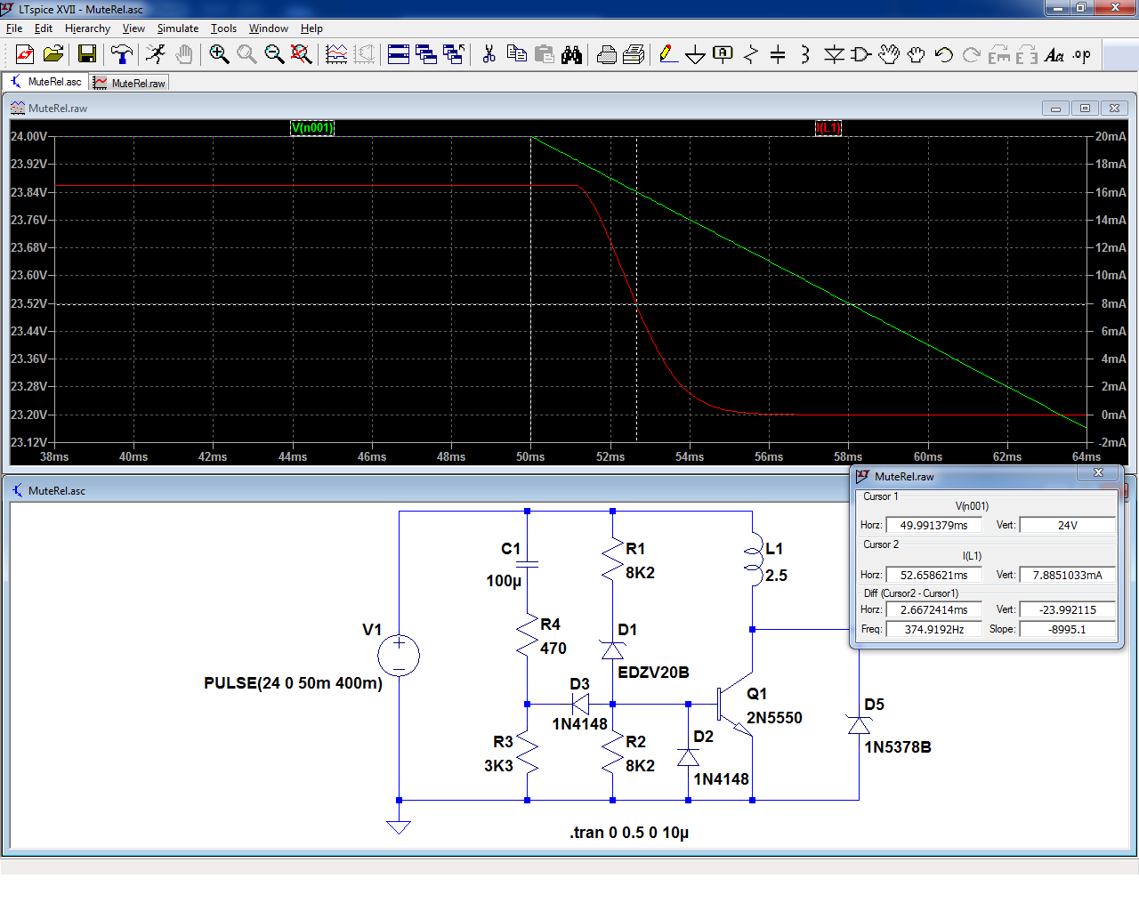

Here is an example (certainly not optimal) of fast mute relay driver suited to a DC supply (like the wall-wart intended for this project):
attachment.php
With the half-realistic values picked for the example, the current turn-off time is about 700µs.
The actual reaction time will be several times longer, due to the mechanical inertia of the moving parts of the relay.
This very basic project stub could certainly be vastly improved, by refining the values, or including hysteresis: this circuit assumes a relatively clean turn-off, without too much stuttering.
The example relay is a 1.5K, 24V electromechanical relay, but it could be replaced with a photovoltaic relay with a suitable limiting resistor

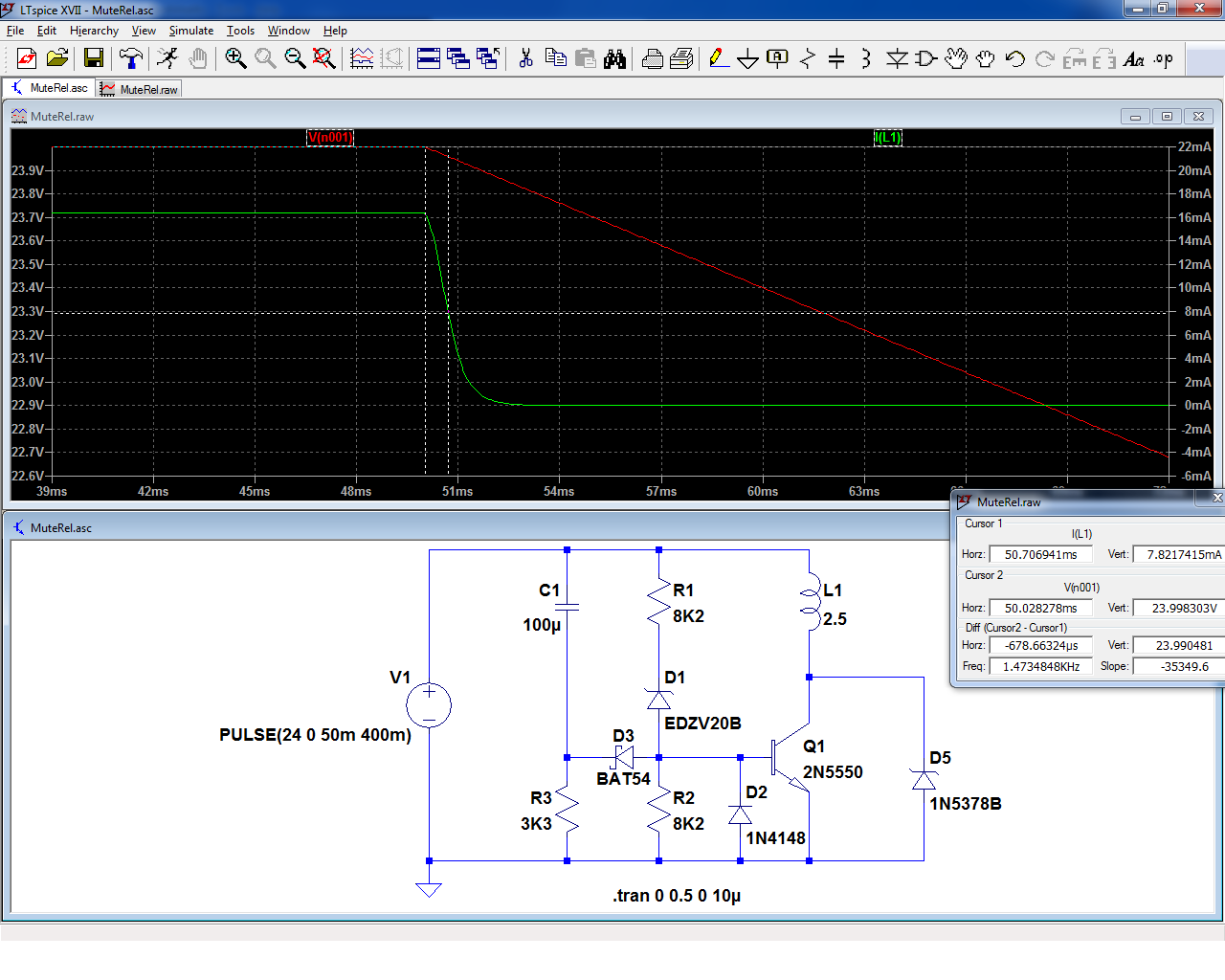

The values I used in my mute relay example were perhaps too extreme, too speed-oriented.
It should work with a good supply, but if the regulation is poor or the output unclean, it will mute when there is no reason too.
In this example, the values will result in a more placid behavior, meaning a longer reaction time, but no overreaction.
Now the time is 2.7ms, but this is with a supply fall rate of 400ms/24V, and by 2.7ms, the voltage is still at 23.84V, which is not too bad (and should be OK in practice)
With R4, it is possible to adjust the reactivity (higher value= less reactivity)

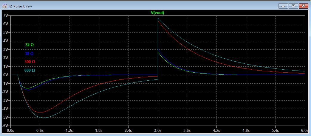

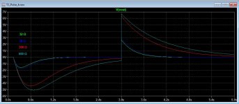

So I finally got to sit down with the amp and can confirm:
* My build has a mild turn on thump that I never really paid attention to.
* I seem to have had a habit of taking the headphones off (upon hearing the kids wake up or something), then get drawn away from the amp and hit the 'off' button on my way out of the room. Consequently I never heard the..
* Pretty decent power off kick to the eardrums. Enough for me to ensure I disconnect the headphones before I power off.
I'm using 38 Ohm headphones, so the turn on wasn't too bad but the turn off isn't pleasant now I've heard it.
I ran the 'Pulse' command into my earlier spice simulation with a .step command for the most common impedances. It follows Elvee's pretty closely, although I simulated for a 22v supply because the PSU eats a couple of the volts before it reaches the rails.
attachment.php

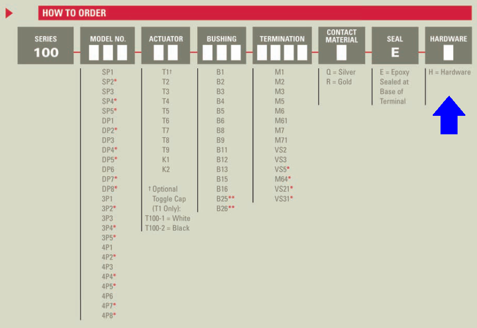

I was thinking: one option to avoid power off noises without any changes to the pcb is to use an on-off switch with an extra pair of contacts. Wire the headphone output through the extra contacts - when you switch off the power you immediately disconnect the headphones.
Perhaps you're thinking of something along the lines of this part# at Mouser? It ends with an "H" so you get lockwashers and mounting nuts in the package.
_

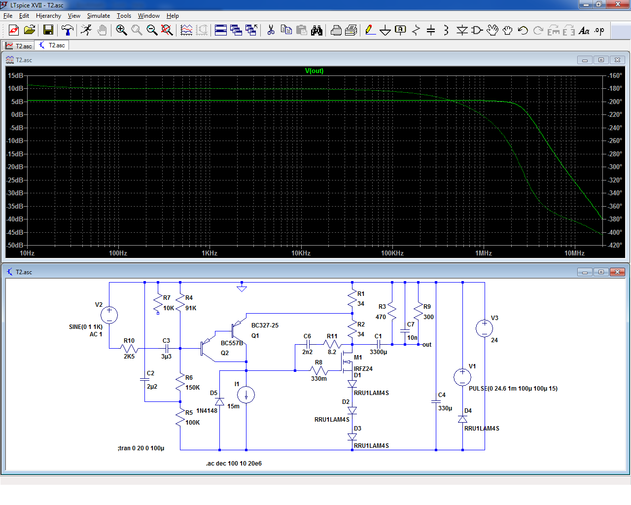

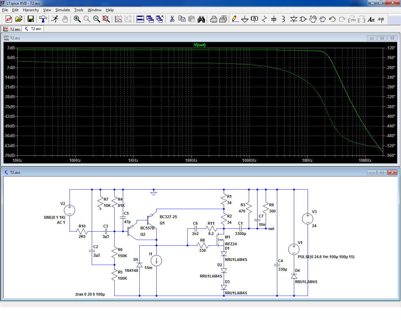

Tom has raised another, relatively minor potential issue: the behavior on capacitive loads.
Since the cure looks relatively easy, here are some possible leads to address this issue.
This is just food for thought: my sim is grossly inaccurate as I don't have the correct models, and the actual implementation will in part depend on the physical configuration, but armed with this knowledge, DIYers can improve matters.
Here is the problem identified by Tom: my sim may not be accurate, but at least it shows something.
I used an AC sim, because it is simpler and lighter than a transient + squarewave, and provides the same information in a different form, for small signal at least:
attachment.php
With a capacitive load, a hump is visible: this would translate into ringing in the time-domain.
What are the possible culprits?
One is very obvious: it is the (misnamed) gate stopper:
it adds a pole in the response, reducing the phase margin.
If it is eliminated, by making it 330m, the hump is magically polished off:
attachment.php

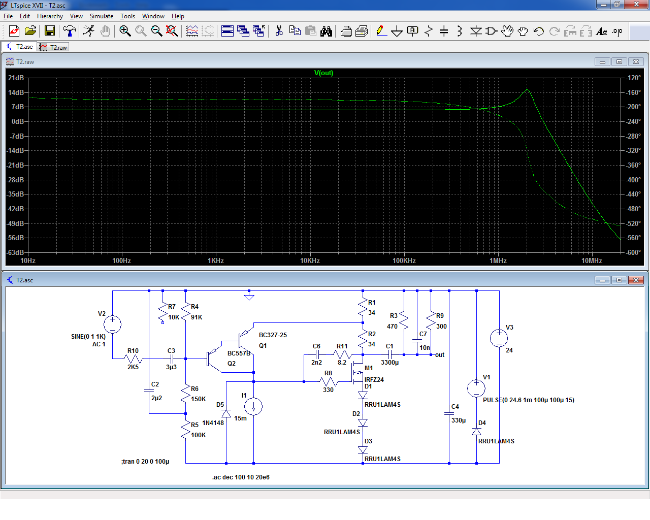

There is another, much less obvious perpetrator.
The design heavily relies on FB, because the OL gain is high, and the closed loop gain only 2.
This means that the feedback has an overwhelming influence on the behavior of the amplifier.
The feedback is through the darlington Q1-Q2, operating in common-base from a FB perspective.
To properly operate, a common base stage needs to have its base firmly held at a zero AC potential.
Here, the base has its potential held by the volume pot, symbolized by R10 (pot midway).
For low frequencies, that's perfectly OK, but at higher frequencies, the path to GND is not deterministic: it will depend on wiring, parasitics of the components, PCB, etc.
If this potential is influenced, it will generate anomalies in the closed loop response.
The solution is to ensure a good HF AC ground there, with a small cap having no influence on the LF behavior (C5):
attachment.php
The gate stopper is returned to 330 ohm, yet the hump has also disappeared.

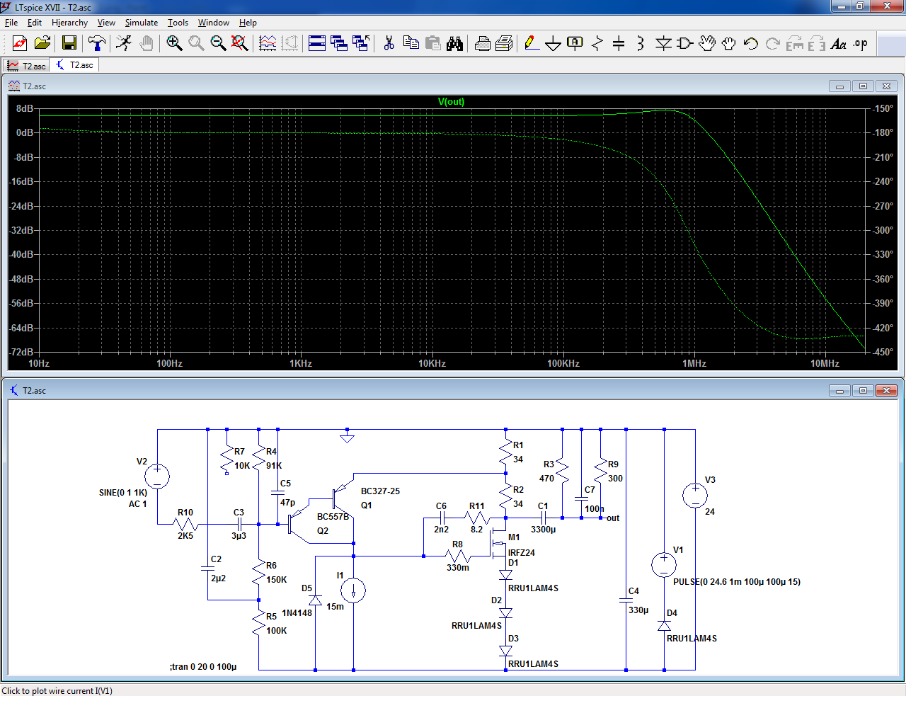

Can both be combined?
Yes, the effect is additive, here the FR with a load increased to 100nF:
attachment.php
A hump has reappeared, but it is barely noticeable.
Is it safe to dispense with the gate stopper? In principle, yes (very much depends on the layout), and if the compensation network C6 R11 is close enough, there shouldn't be problems.
Will this translate into large/signal, transient, reality?
Not litterally: as I said, the sim is crude, but it provides useful hints at what needs to be done.
Note that since the stability should be greatly increased, the compensation could be less heavy-handed, leading to better/more symetrical SR performance.
One could also consider other compensation strategies: shunt for example, as it would also contribute to SR symetry.
These are just ideas, that need to explored and tested carefully before an actual implementation becomes possible. I cannot go further without using more accurate simulation models, it would be wasted
  • T2.asc
