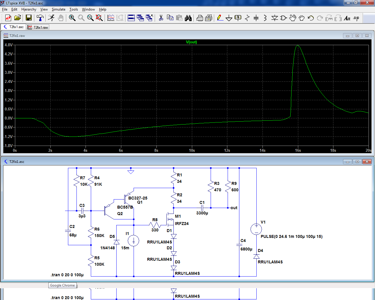

OK, this appears with high-Z load conditions, which is logical.True that.
I've attached my measurement of the T2 at turn-on and turn-off.
Increasing C73 to 22µF should help a lot, and solve this issue for 32 ohm (for 600ohm, that is less certain).
It also depends on the setting of R73.
More worrying is the turn-off thump, which looks nastier.

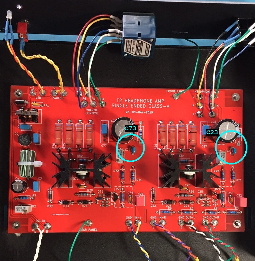

For those who want to experiment with changing the bias string bypass capacitor (C23 / C73), I have good news: there's quite a bit of empty space on the PCB in that vicinity.
A quick measurement on the PCB suggests you could just barely fit a 25 volt, 3300 microfarad (!) radial electrolytic capacitor in that zone. The Panasonic EEU-HD1E332B is 25mm long {same as the MOSFET heatsink} and 12.5mm diameter. You could mount it upside down and then bend the leads to fit into the existing drill holes.
This is not a recommendation, merely an observation: C23 and C73 have plenty of wide-open space nearby.

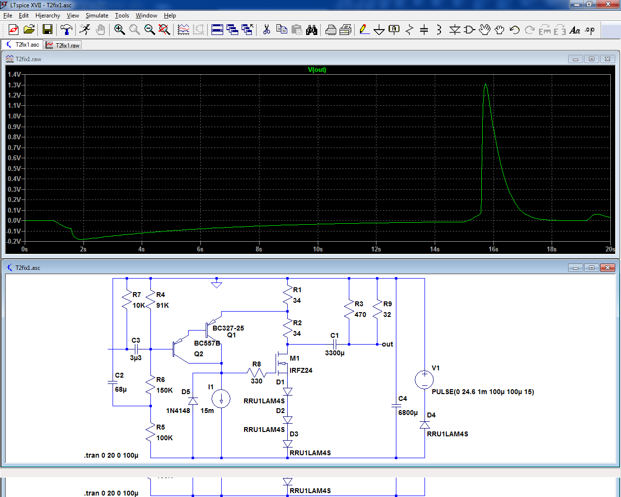

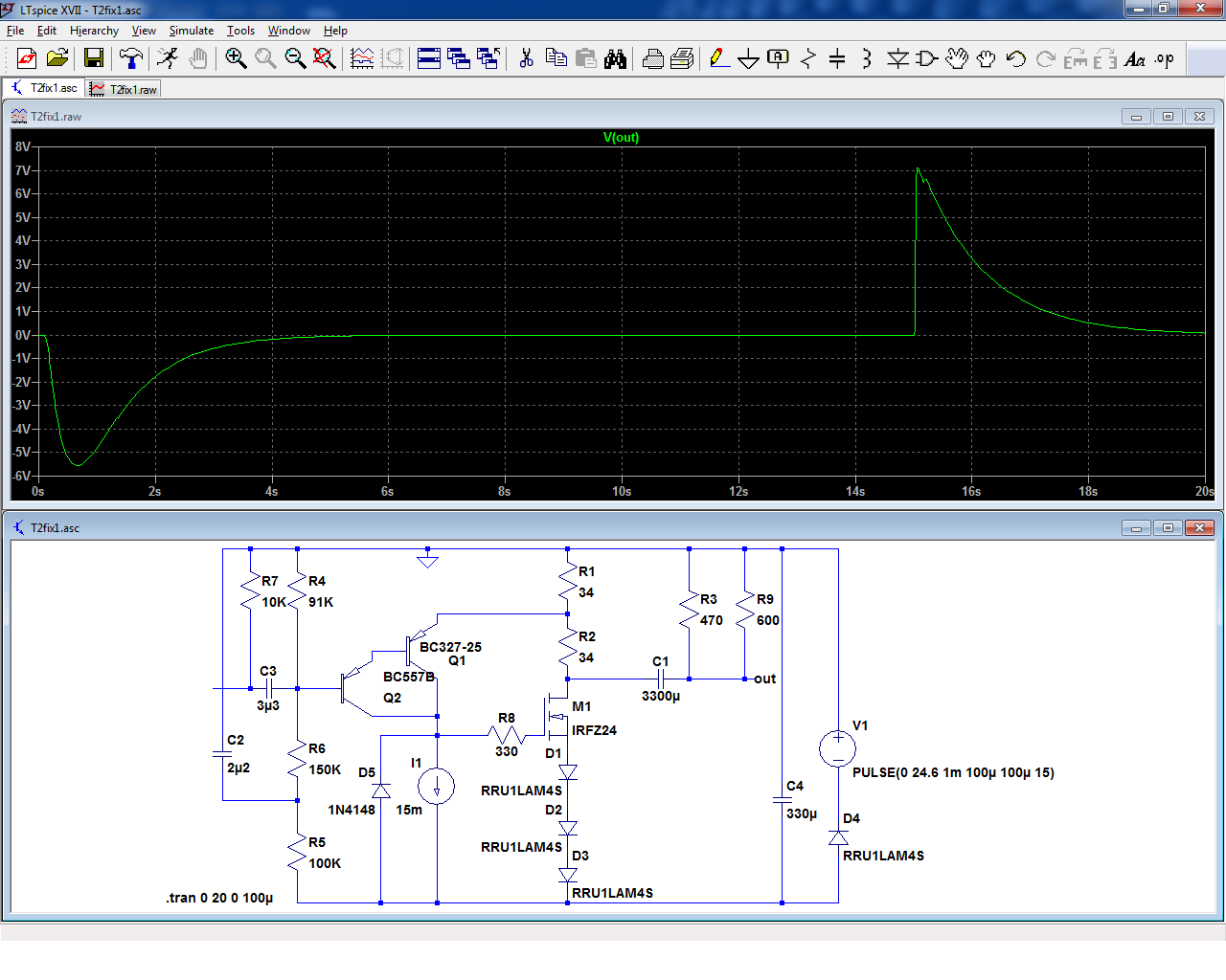

I have made a simplified simulation circuit.
The turn-on/off behavior is quite realistic:

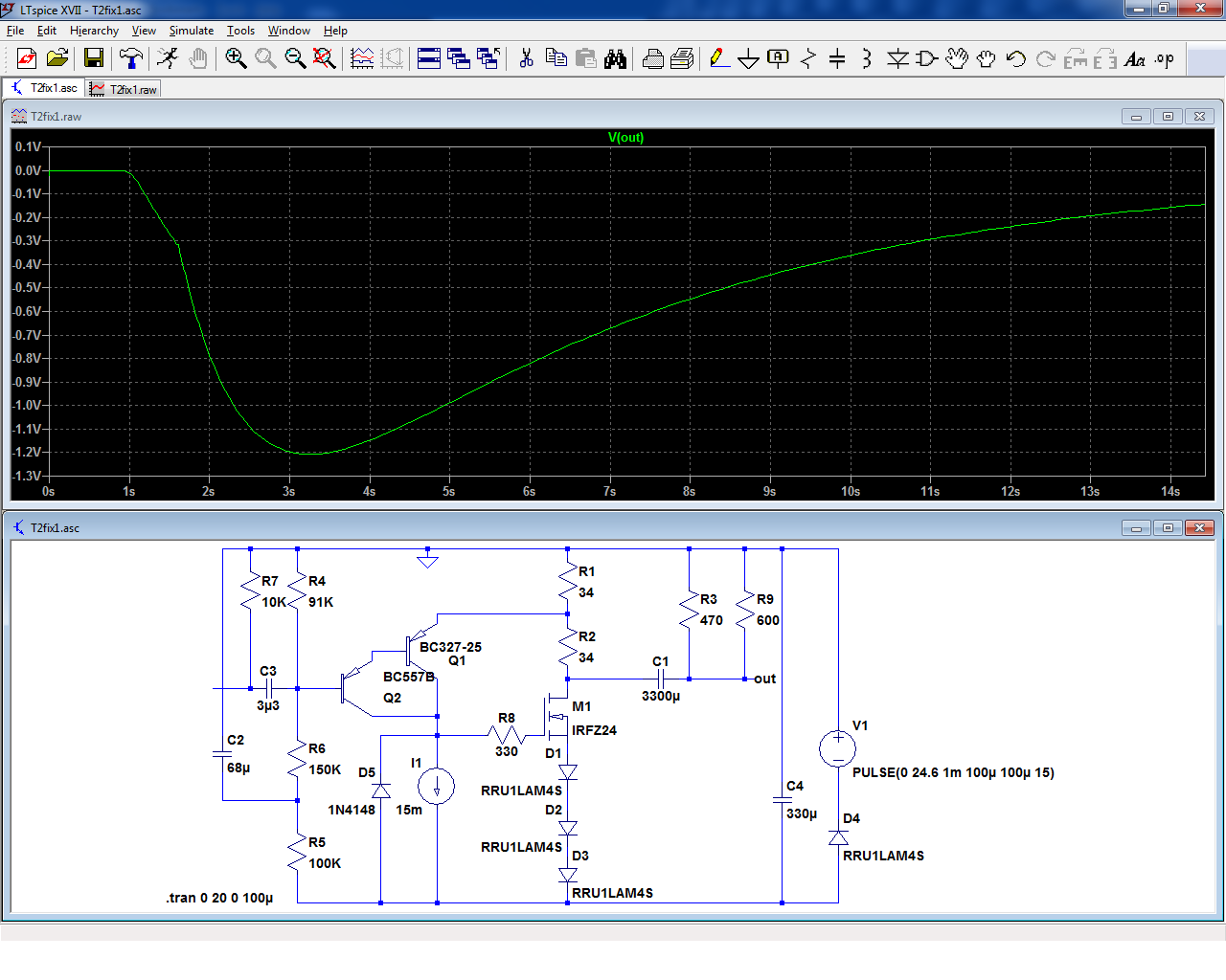

Let's concentrate on the turn-on first (the easiest).
If C2 is increased to 68µF, the thump becomes gentle, and completely subsonic:

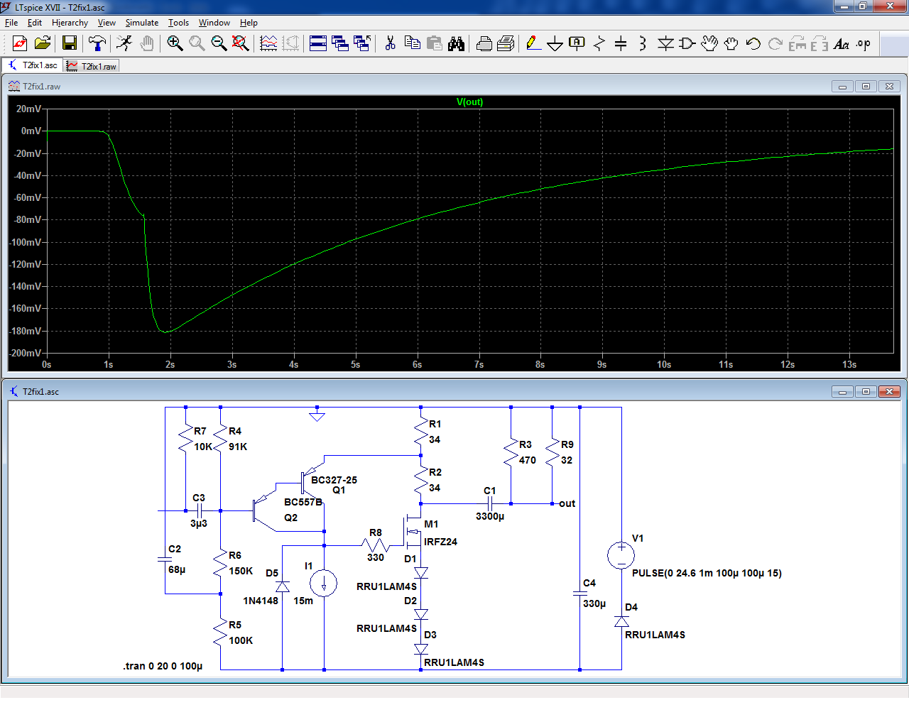

With a more common 32 ohm load, it becomes completely negligible:
The turn-off problem is more difficult.
A possible solution uses brute-force: increase the bypass cap to very large values.
With a 600ohm load, the improvement is marginal:
With 32 ohm, it becomes more acceptable:

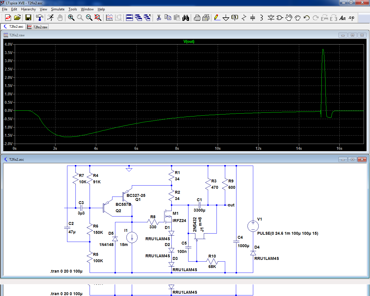

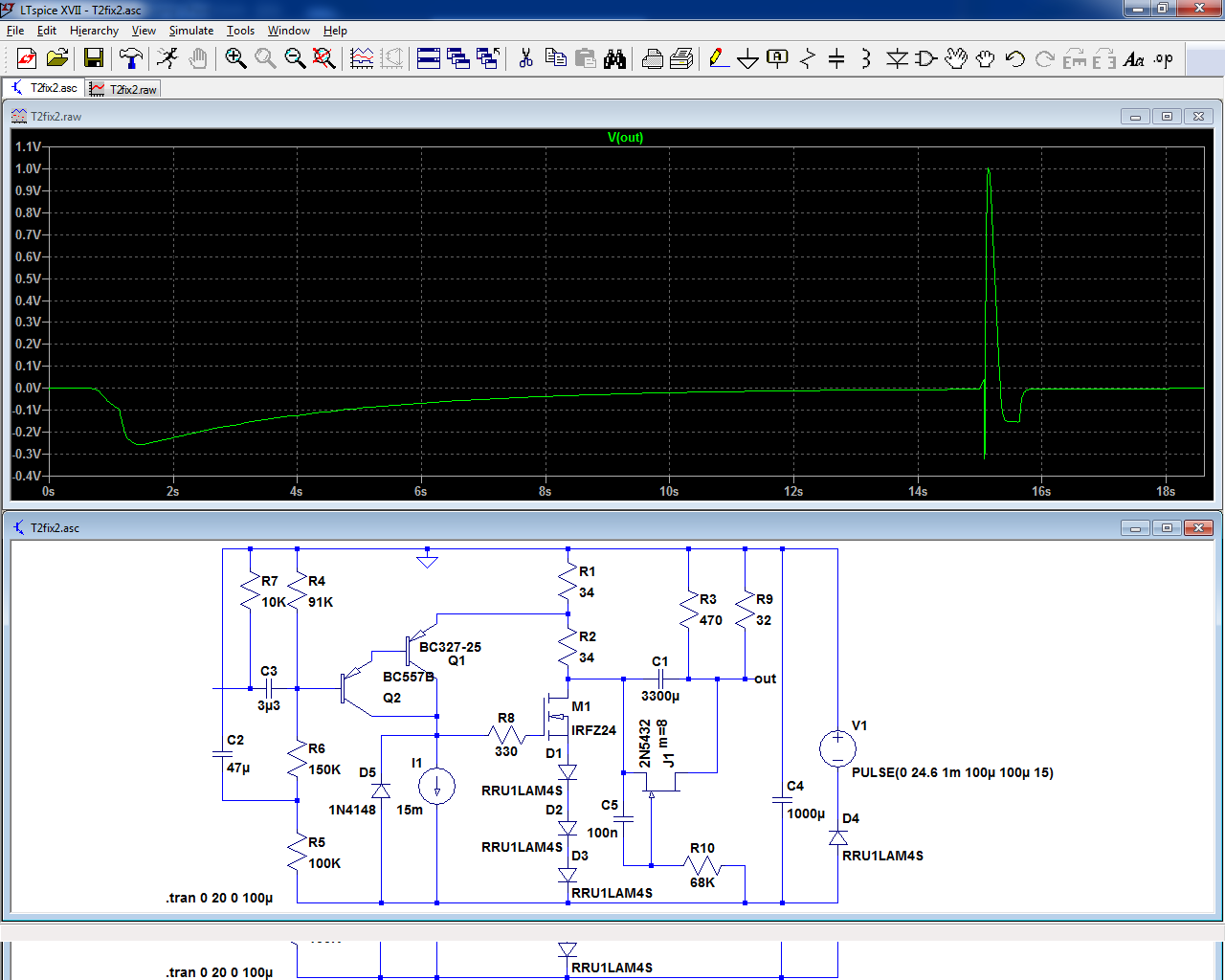

A smarter method is to use a depletion device to discharge the output cap.
I have used jFets (8 in //), for simulation purpose, but in reality a depletion MosFet should be used, with a suitable gate divider.
The RC used with the Fet is because the Vto is not ideal, but with a MOS, it should not be necessary.
With 600 ohm, a significant but relatively harmless residue remains:
With 32 ohm, it becomes acceptable:
These fixes are not perfect, and cannot match a properly driven mute relay, but they can be implemented relatively easily on an existing circuit without butchering it: they are at most additive.
Note that a mute relay should react in the millisecond following the turn-off, because the phenomenon is fast and brutal
Love it when simulation matches reality that well! Thanks for running the sim.
Very nice!
One way to do that would be to add a diode in series with the supply, before the reservoir/bypass cap. Then take the supply for the output relay on the 'outside' of the diode, i.e. from the raw supply.
You might be able to use the voltage across C2 to drive the turn-on delay for your output relay. In that case, your output relay circuit becomes a relay, a diode, a free-wheeling diode for the relay, and a MOSFET driver. Maybe with a resistive divider to control the timing.
