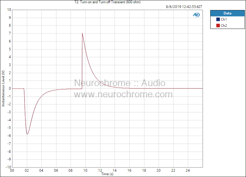

I'm guessing that's directed at me. Fair enough. Thanks. Please allow me to elaborate:
As mentioned in my review, I have two major concerns regarding the T2:
- Turn on/off thump
- Ringing (stability?) with capacitive load
These would be at the top of my list to deal with.
The turn on/off thump could be dealt with by a relay or with a MOSFET-based solution. A pair of large MOS devices with a photovoltaic driver would work. As would a well-chosen small signal relay. The amp should not be allowed to output 6-7 V peak when turned on or off as that puts the user's headphones at risk.

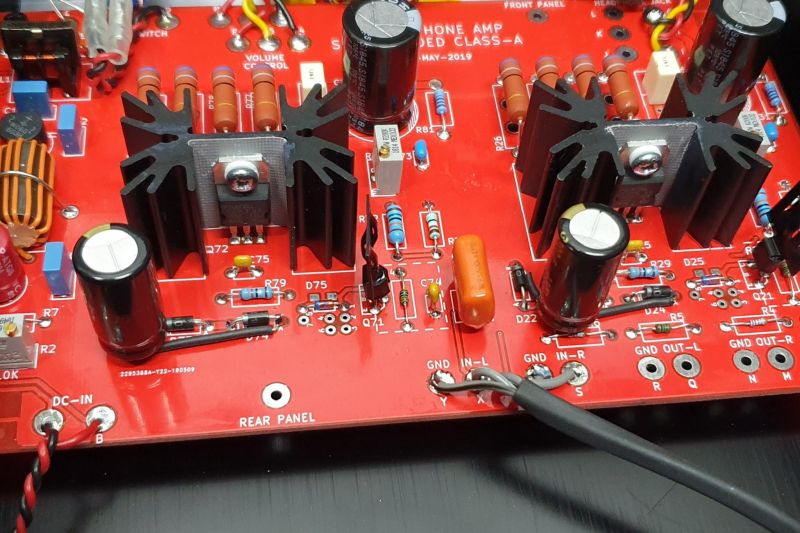

On the mechanical side of things you'll find:
- Hole missing for locking tab on power switch washer
- Grounding wires causes front and rear panels to bow
I suggest adding a hole for the locking tab on the washer for the power switch. The washer is intended to prevent rotation of the switch as it's operated. Basically, it keeps the switch aligned and prevents it from rattling loose. Anyone who's ever used those switches will know the presence of this locking tab ... as they've at one point forgotten to drill the hole for it. I know I have. 🙂
Rather than grounding the front/rear panels by a solder lug, I'd consider adding a solder pad on the front/rear panels (which are PCBs) so you can just solder a ground wire to that. Or better yet, a grounding lug could be added in the chassis somewhere so you don't have to rely on the connection to the front/rear panels for the ground connection.
Some may argue that I'm picking nits. And maybe I am. But considering that this kit will be available through the DIY Audio Store, hence, has the potential of affecting the reputation of DIY Audio, I think it's prudent to make the kit as high quality as possible. It should work as well as possible out of the box. This is my view. Others are free to disagree.

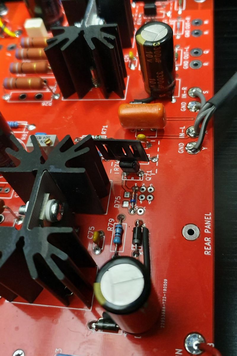

Here's my version of the T2

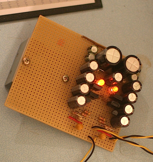

I just remembered that I built a headphone amplifier with such a current source, only my 'CFP' output was without gain. The topology was inspired by Naim. I put all the details here: Grasshopper
So it seems that I made a 'T2' kind of thing and now I'm a fully signed up member of the club 😀
I can't say if the current source helps or hinders the sound because I didn't compare with and without - unfortunately my headphones were a bad fit to my hearing so I sold them
Here's something I tried a few days ago on the T2. It is a current source...

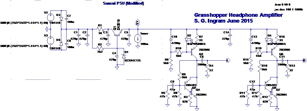

A quick inspection of the schematic doesn't show an obvious reason for the turn-on thump (I leave the turn-off aside for the moment, because the situation could be less clear).
Here is the schematic, as a basis for the reasoning:
When the power is absent, capacitors C72, 73 and 76 are discharged. (for C72 this also depends on the upstream circuit, but the end result is the same, its right armature sits at the GND potential)
At the instant the power is applied, Q71 will thus be off, and Q72 will follow, meaning no current will flow through R75-78.
Thus, no thump at this stage (in principle)
Then, C72 and 73 will begin to charge relatively slowly, making Q71 to conduct, and at some point, the conduction will be sufficient to overcome D75, causing the conduction of Q72.
As soon as Q72 conducts, the FB loop will become active, and the emitter of Q71 will follow its base, ie. slowly going more negative.
The drain of Q72 will thus go negative at a rate governed by the time constants of C73/R73 and C72/R71//72.
Since they are larger than the output time constant (with a 32 ohm load anyway), the disturbances should remain relatively minor.
If some conditions are met, namely R73 turned heavily CW, open input and high impedance HP, the thump could be present at this stage.
This could be fixed by increasing massively C73, to 22µF for example.
The startup time would still remain acceptable, and the possible thump should be gone.
This is a purely theoretical analyzis; I didn't make any sim, and I could have missed something.
Mark probably has the circuit in sim (a simplified version is quite sufficient).
Maybe he could post it, to check exactly where the problem lies, and identify possible fixes
I disagree. I think the thump source is painfully obvious in the schematic: It's the output cap. The output cap needs to charge to roughly VCC/2. This requires charge to flow into the capacitor. That charge flows through 470 Ω (R81) in parallel with your phones. That causes the thump.
You can measure it easily with an oscilloscope.
This is a known issue with single-ended designs. The Schiit Asgard had the same issue and Schiit took appropriate corrective action and added an output relay.
Tom
It certainly does; what matters is the time taken to do soThe output cap needs to charge to roughly VCC/2.
If the voltage on the drain of Q72 rises slowly enough, the thump will be mild and subsonic (thus not noticeable).This requires charge to flow into the capacitor.
I don't have have the circuit handy, and I cannot duplicate the test, but I have no reason to doubt your assertion.You can measure it easily with an oscilloscope.
The question is why this behavior is observed: if the conditions I enumerated are met, the thump will be present.
Under less extreme conditions, the thump should be minor, or quasi-absent (based on my analysis anyway -could be flawed-).
If Mark posts the sim circuit, the hypothesis can be explored in more details (it could also be done in the old-fashioned manner, but it takes more time, and a human can also make wrong assumptions, something a neutral and "dumb" software is immune to).
True that.
I've attached my measurement of the T2 at turn-on and turn-off. The measurement clearly shows the turn-on and turn-off transients, i.e. the instantaneous voltage applied to your headphones when you turn on/off the T2 with the 'phones connected.
Whether you consider them to be an issue is entirely up to you. I wouldn't personally release a circuit that produced those thumps, but that's me. Others are free to have different standards.
As many have pointed out, this is DIY, so if you take issue with the thumps, you can always design an output muting circuit.
Tom
Reference to post #169 and using a cap to bypass the three diodes D72, D73 and D74. What exactly would this impact be to the sonic signature?
It was mentioned that:
"Turns out there is in fact a significant increase in loop gain and corresponding reduction in distortion with the extra bypass cap - about 14 dB in sim." this was in post #169.
Just trying to understand how this translates into a better "output" that I might hear?
...and yes I have two 4700uf on their way here...to test.
Alex
I installed a couple of 3300uF 10V caps in those positions about 6 weeks ago.
I honestly can't say that I could hear a difference between having the caps and not - I never carried out any A/B testing. But that said, I left them in because I did not feel they were detrimental.
I get no turn-on thump with the T2. Granted I never turn on a headamp with phones on, so maybe there is a very low volume thump - but nothing audible before I put them on.
I also don't recall experiencing any turn on thump with this one. I'll double check when I get home though.
If you're not careful when choosing the capacitor value, you can accidentally put the corner frequency in the (audible) high bass region. Which will ruin the response in the low bass. Draw it up on the chalkboard and write some equations.
