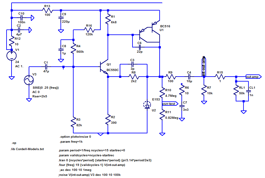

I would rather suggest something more akin to this:
It's inspired in part by the Radford ZD22 and uses the Darlington and CRD from the T2, but towards the output side this time.
Simulation says less than 0.001% of THD @ 1 kHz, 1.5 Vrms with a 10 kOhm load, more like 0.0003% with 50 kOhms. (As usual, keep your salt shaker handy.) Gain ~16.4 dB. Effective input noise will vary a bit depending on whose BC550 you get, the ones Bob Cordell modeled (Rbb' = 170 ohms) would yield about 3.5 nV/√(Hz), the ones as listed in Art of Electronics 3rd ed. (650 ohms) would give closer to 4.5, and the cheap Indian ones maybe 4.8. 3.2-4.5 µV of output noise isn't too bad really. Still lower than when using an NE5532, and good for about 100-130 µV of output noise when followed by 29.5 dB. You could still reduce the gain if this is an issue (while rebiasing the input).
I think I got emitter resistor R1 a bit too high, 3k3 is giving me better results for 10k/20k distortion. Also note no input filtering on this draft, which should be added in real life. Output coupling caps probably are still too big as well.

What is U2 ? LED ?
What is the gain and how to adjust and calculate gain ?
