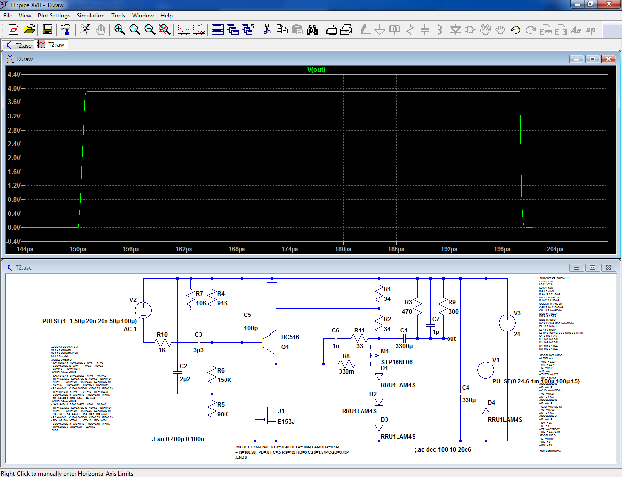

Here is the point I wanted to illustrate: the detrimental effect of the gate-stopper.
These sims have to be taken for what they are worth, that is little in absolute terms, because the darlington does not quite behave like the real thing, but their relative aspect is probably more valuable.
Hoping I didn't mess or forget something this time, here is the response with the original values and a purely resistive load:
attachment.php
Now, the gate-stopper is removed, and the compensation components are adapted to take advantage of the improved phase margin:
attachment.php

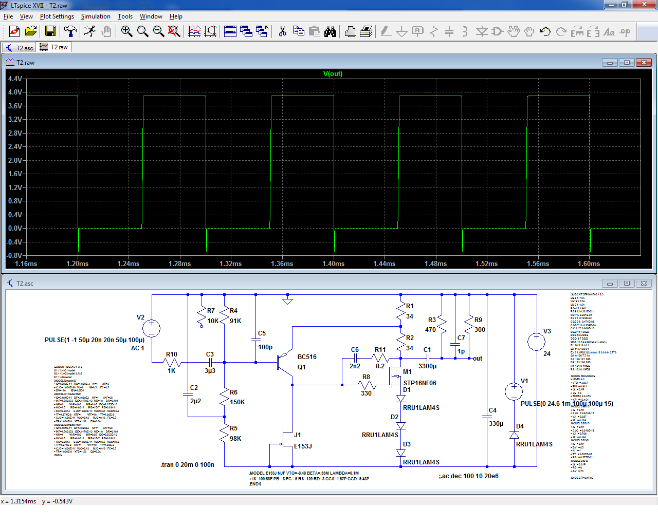

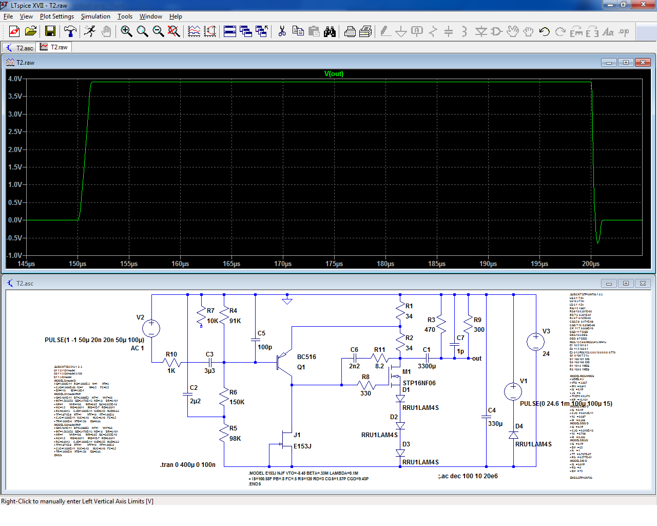

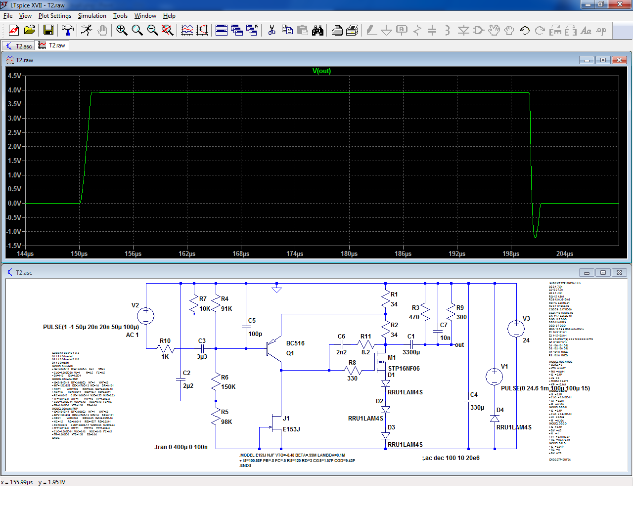

Here is the response of the original with 10nF of capacitive load; no ringing is visible which is an anomaly, but the undershoot has increased:
attachment.php

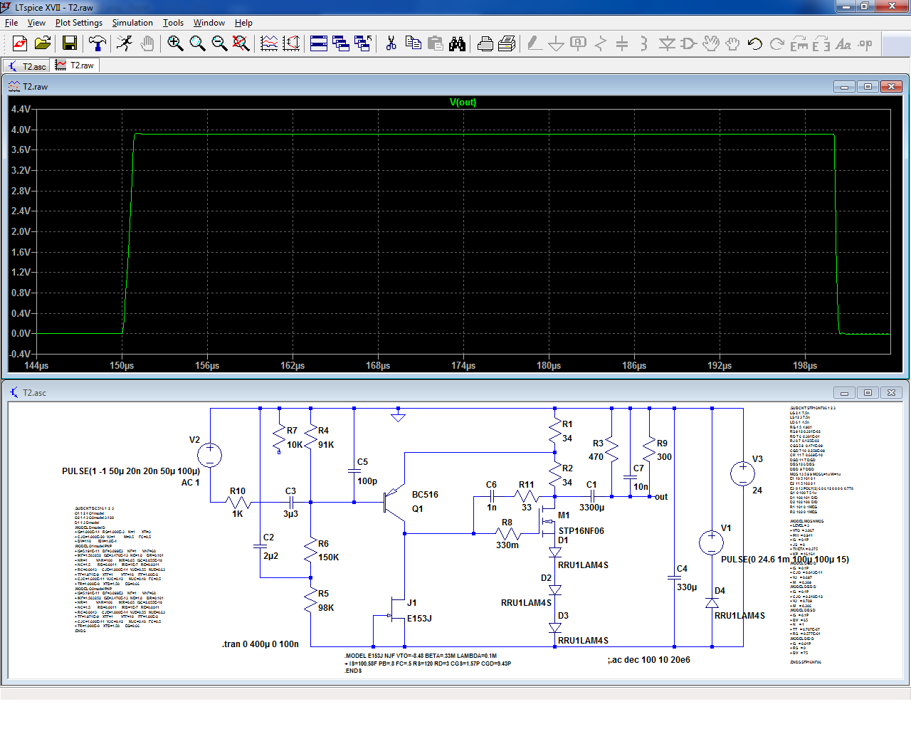

Now the same without the gate-stopper:
attachment.php
I wouldn't rely too much on the exactitude of these results when translated in the real world, but both the AC analysis and the transient response convey the same message: the gate-stopper does harm.
Thus, if it is possible to dispense with it, improvements will be gained.
As I said, I see the ringing as a minor issue unlikely to much cause harm, but if it can be ironed-out easily and cheaply it would be silly to miss the opportunity.
To summarize: in order to address the main issues raised by Tom, the mods to be carried out (by order of importance) are:
-Use a multipole power switch also disconnecting the output
-Increase the bias bypass caps to 47~100µF
-Replace the gate stopper by a 1 ohm resistor, and optionally adapt the compensation network (this has has to be tested in reality to determine the optimal values -the sim cannot be relied upon-)
Note that the effect of the three mods has to be verified in reality: that is particularly true for the gate-stopper, as it could result in unwanted oscillations.
If all goes well, the main identified issues will be eliminated, at a minimal cost and without having to rework the PCB: just some minor component swapping required.

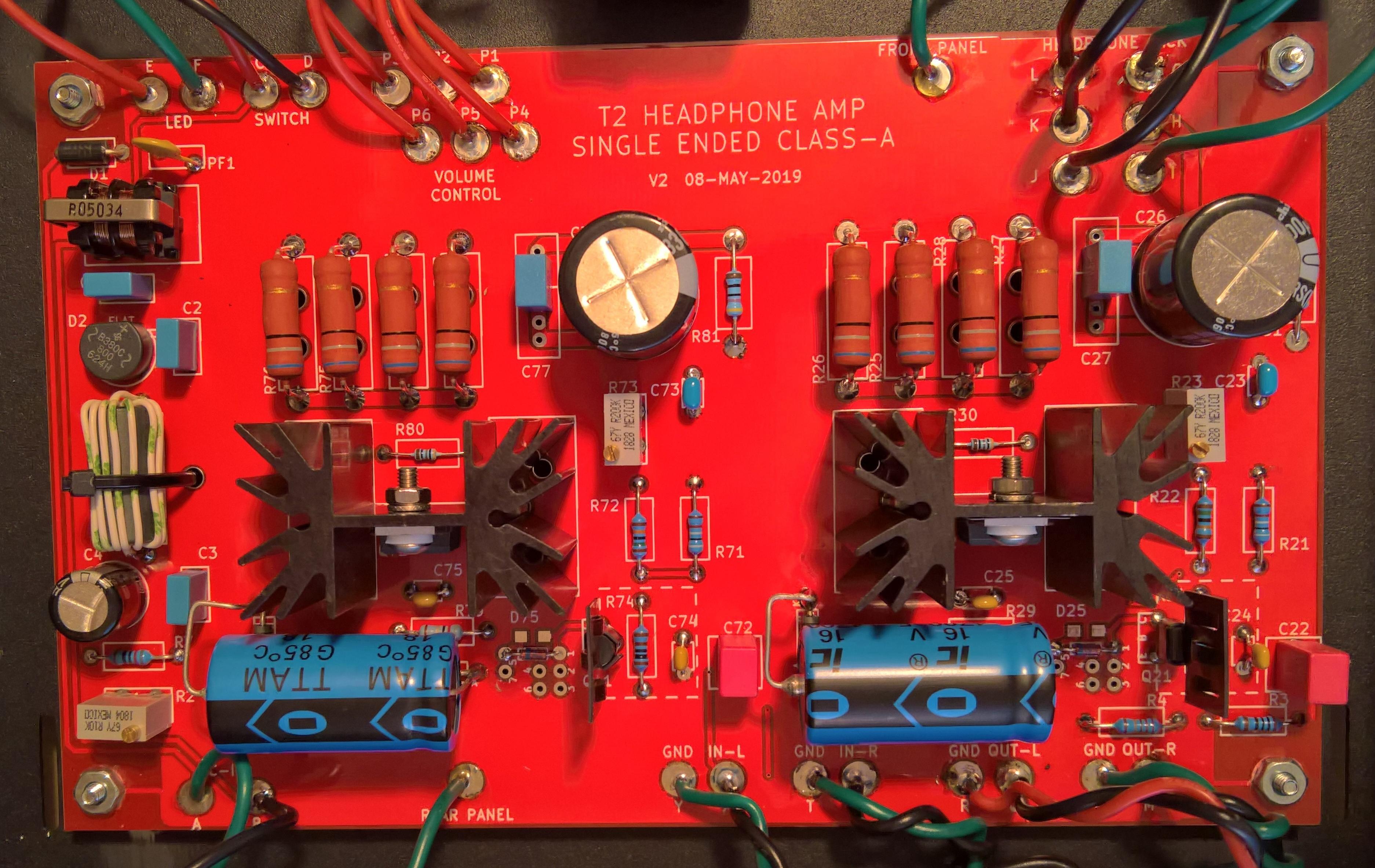

Would someone draw up a new schematic with these (3) solutions incorporated?
It would help me in the translation between the simulation drawings and the actual circuit.
Also possibly updating the 6L6 build guide to include these "improvements" ?
Many Thanks
Alex
Elvee, you may want to resort to the models and symbols posted earlier in this thread (some time in late July, I think). I'm seeing nothing out of the ordinary at 10 nF, and 22 nF is about the limit of stability. It is true, however, that reducing the gate stopper enables better capacitive driving and higher GBW. With the values given it'll get to about 82 nF. Either is fine though.
In real life, there is a fair amount of ringing with 10nF (hidden in sim by the saturation).
As I said earlier, nothing really problematic or catastrophic, but since the gate-stopper seems to play a major role in that, eliminating it (if layout permits) would be a good (and totally free) improvement.

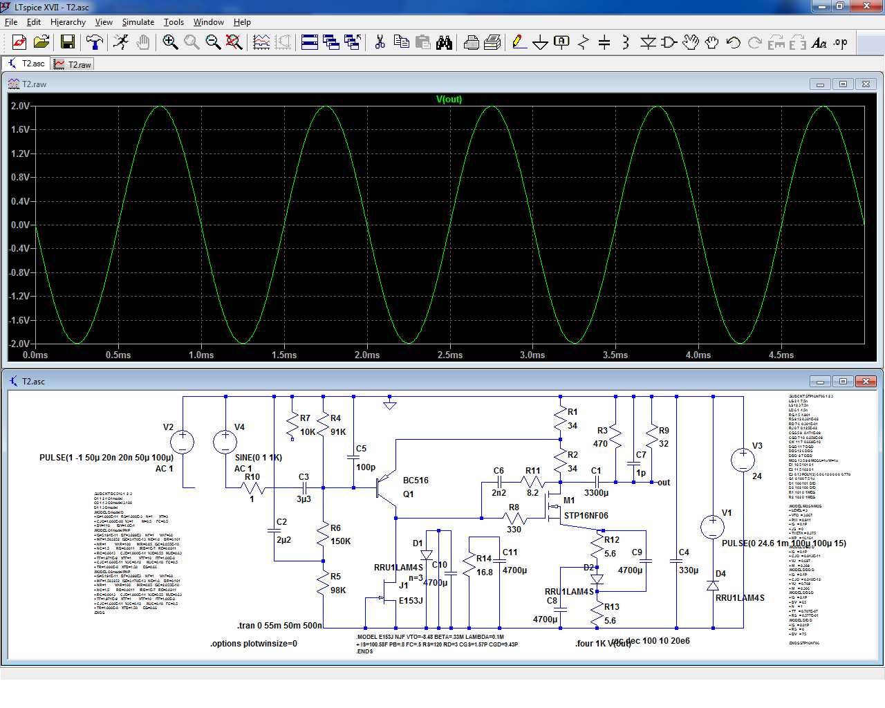

Simulation predicts about 13 dB less distortion due to correspondingly increased loop gain... nothing to sneeze at IMHO, especially for just one extra component. Of course that's assuming that actual dynamic impedance is close to what the 1N4004 model says it is, but I mean, assuming you bothered to model a diode, getting Vf(I) about right would be among the most basic things to do, don't you think?
Very smart observation indeed: I get practically 20dB improvement!
I had analyzed the circuit at a glance, making simple mental calculations and had (wrongly) concluded that with a dynamic resistance of ~26/150=0.17, the effect was going to be marginal, but actual diodes have a somewhat larger resistance at high currents, and they also add non-linearities of their own, so the cap is in fact very useful, and pushes the amplifier into a different league!
Is there any consensus as to what size capacitor we should look to bias the diodes with?
(Single ended class-A headphone amp using two transistors: T2)
It looks like Alex used 4700uF 16v there, but I used 3300uF 10v and was warned to carefully select the value or it will affect the LF response.
If you're not careful when choosing the capacitor value, you can accidentally put the corner frequency in the (audible) high bass region. Which will ruin the response in the low bass. Draw it up on the chalkboard and write some equations.
With the bypass cap, the diode string is not necessary anymore: it can be replaced by a single ~17 ohm resistor.
Incidentally, it will also improve the DC stability.
One could go overboard and replace the whole string with an error-correcting one:
attachment.php
It brings another three-fold THD reduction on top of the ~20dB already packed!

OBTW...I did use a 4700uf cap to bypass the diodes and dont hear any real bass reduction?
Still would like an opinion on using a non polorized electrolytic for the bypass "remove" the turn on thump solution?
Also with the bypass caps in place the turn on and turn off thump is still there in spades!
The switch works nicely for the tunr off and I used the one Mark linked to in the thread...thanks Mark, for some reason I looked and looked
and did not see the 3T switches (duh!)...
Alex
