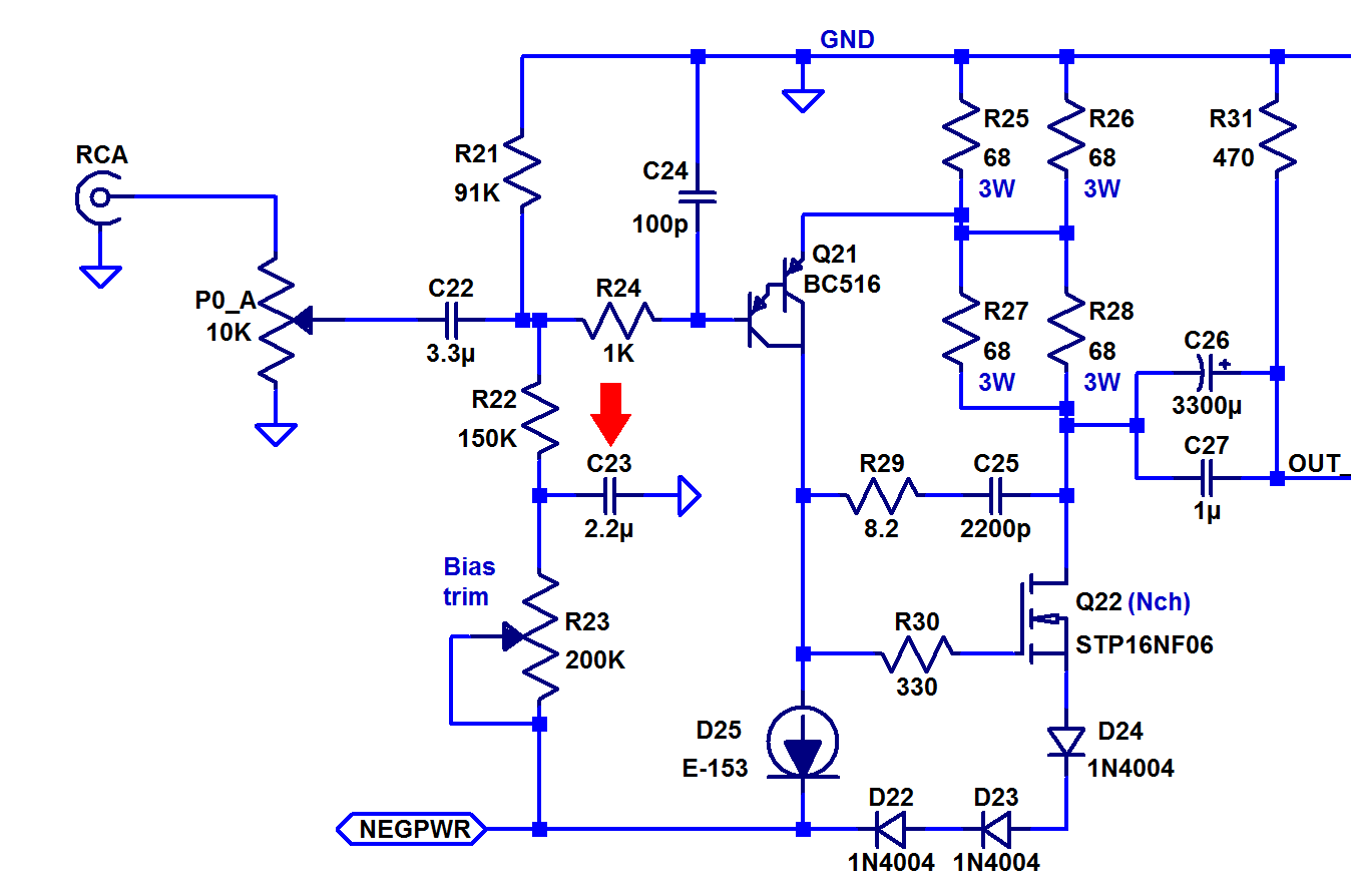

I believe someone posted a proposal which, they said, completely eliminates the turn-on thump in simulation. But does nothing about turn-off. If I remember correctly it was a change to a component value, i.e., unsolder one component in each channel, and solder a replacement back into the same holes. No drilling, no cutting of traces, no jumper wires, no additional PCBs.
Back in post 331 Elvee stated the value of C2 in his simulation if increased to 68uf would kill the turn on thump.
This is C23, C73 in Marks schematic. These are 2.2 uf caps.
I found this 68Uf at Mouser:
But its only 6.3 v rated. Would this work?
Its a MLCC Leaded, the existing ones are Murata at 50v.
Two of these would be only approx $2 + shipping throw in the $5.00 switch...
Alex

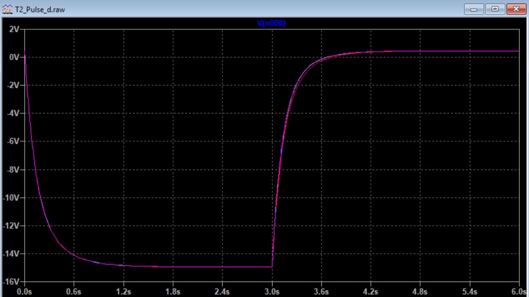

My sim shows that cap exposed to around -15v
attachment.php
This is assuming a mid-point value of R73.
Basically it is a 3 resistor potential divider formed by R71 (91k), R72 (150K) and R73 (0-200k). It will be between -22 and -12v depending on the setting of R73.

[the voltage across capacitor C73] is a 3 resistor potential divider formed by R71 (91k), R72 (150K) and R73 (0-200k). It will be between -22 and -12v depending on the setting of R73.
Nicely done!
If you wanted to, you could set R73 to whatever numerical value is required in simulation, to get a voltage drop of 5.10 volts across R77. I.e. perform the biasing procedure in simulation.

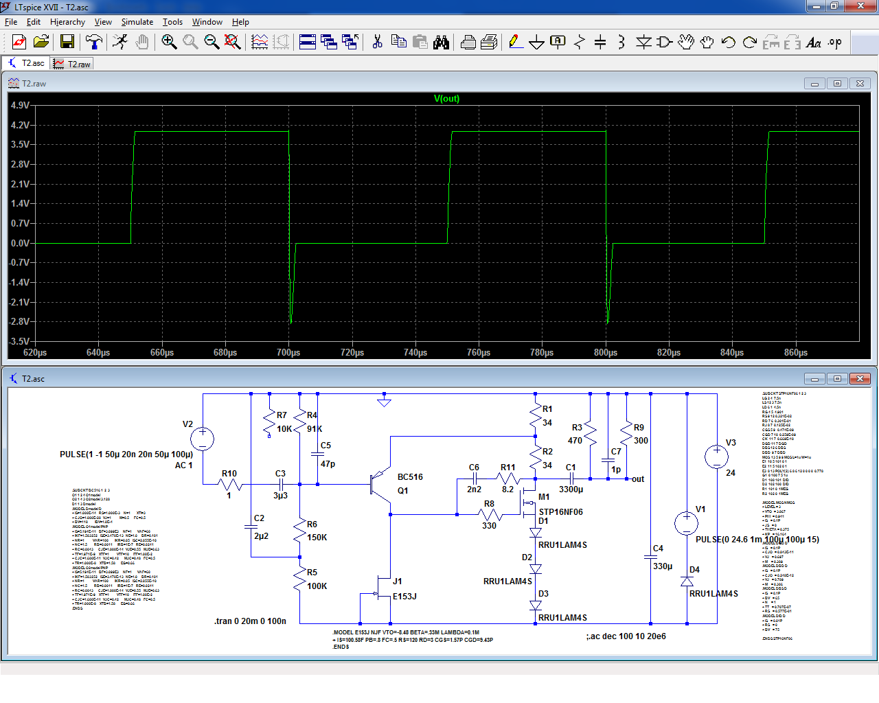

  • T2.asc
    T2.asc

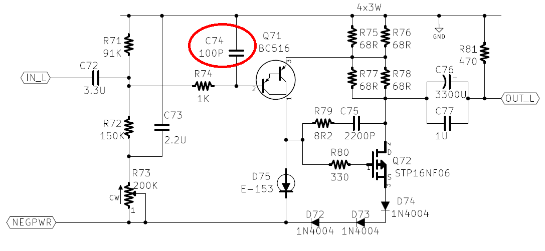

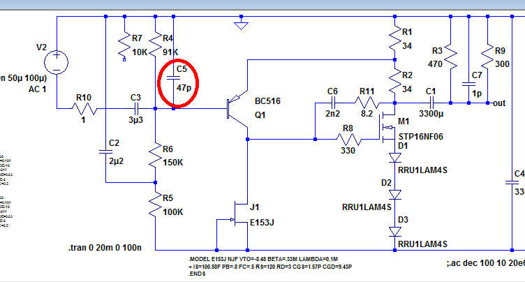

I thought you were going to increase the capacitance from BJT-base to the positive supply rail (GND)? Instead it has decreased .. ?? And the 1K series resistor has disappeared .. ??
You might want to check and verify that the static bias current Ids of the MOSFET is 150 milliamps. That's what the builder does when s/he adjusts the 25 turn trimmer potentiometer.
