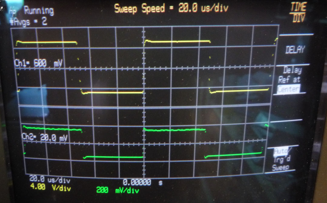

Yes the 10nf cap and 560 ohm resistor are still in place. I figured without the 100pf cap the resistor isn't forming any sort of filter, ( it is did drive the bais voltage up about 100mv) so, probably isn't having any effect. I'll pull it out and then the 10nf and see what happens.
Regarding the 1837/4793 I believe MJL used them in his Patchwork amp driving Onsemi's maybe not, tough to look this stuff up while writing...

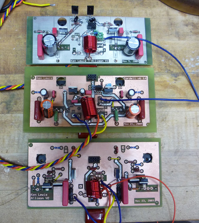

Now I have three working outputs driven by the LME49811. Which one to choose? I played the Allison Class A/B (Paul's scheme) all day today, the sound is very nice! (and it doesn't need the window fan blowing on it to keep things cool.
Ken L
You're right, the 560 ohm resistors shouldn't have much of an affect and most engineers probably wouldn't bother messing with them. I don't have much experience so in my mind there is no due process and they're guilty until proven innocent... (the difference is whether Cob has an ESR of 0 ohm or 560 ohms)
The fast drivers might not have an affect in all situations. In the Allison, however, they are put inside an ultrafast high-OLG feedback loop.
Which one you choose is up to you... Follow your ears, I presume? The class A Allison should have the least distortion but if you can't tell the difference, why not go green with the Schottkey AB mod? I await your decision, and if possible could you describe the differences in sound?

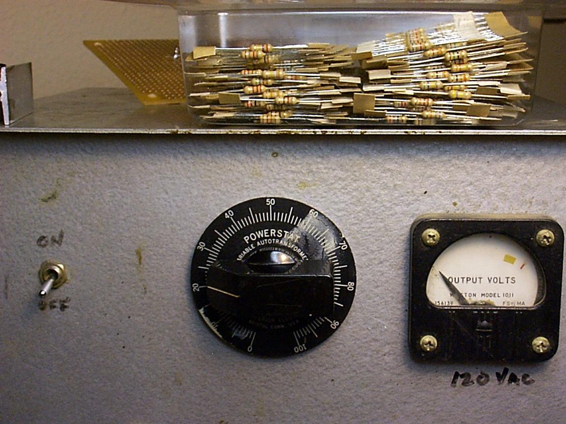

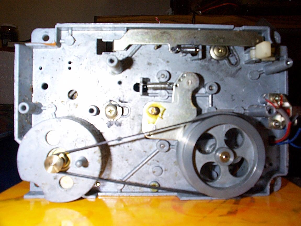

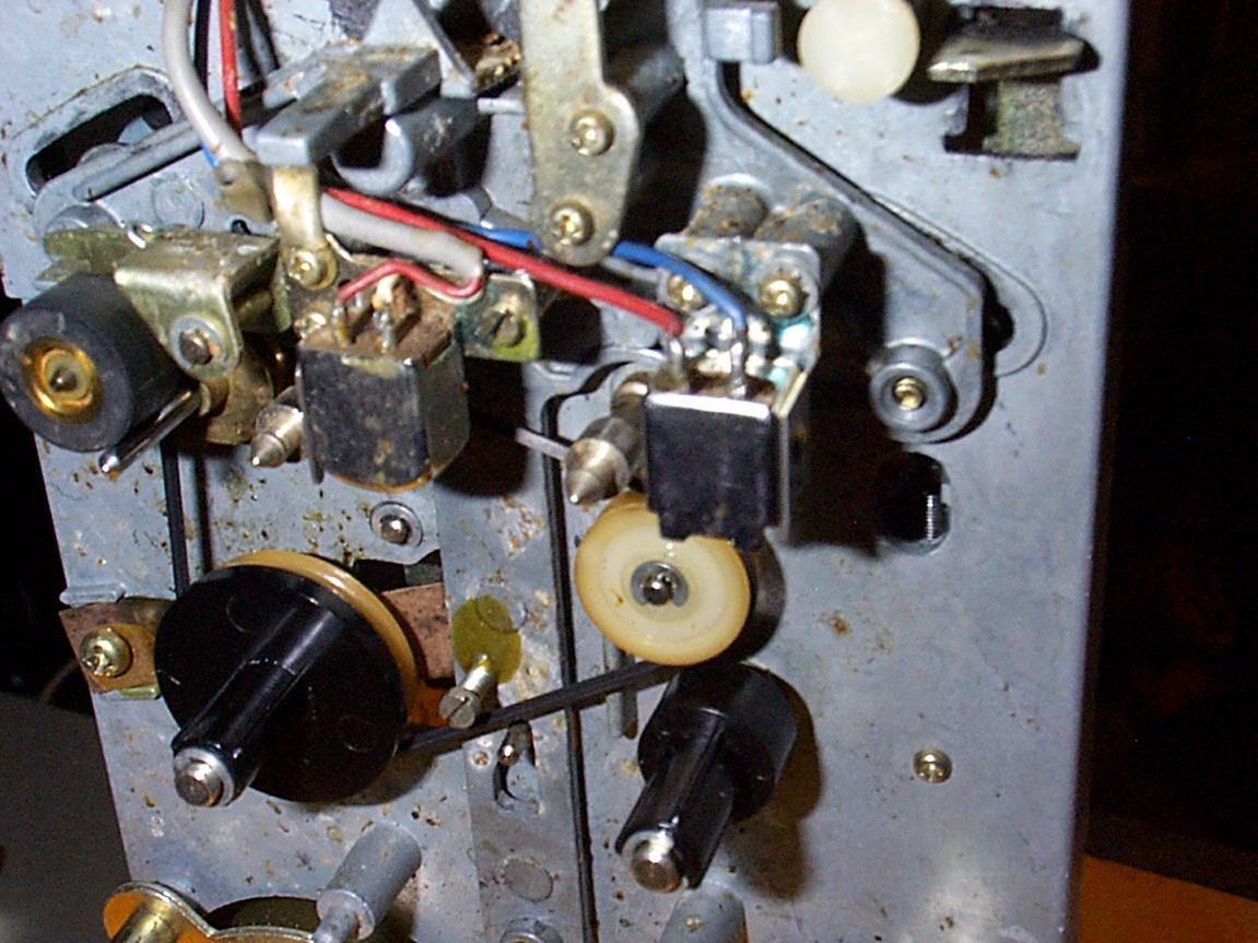

Oh, and I have a new addition to my bench... Found it lonely and dejected a WWII antique store no less (don't know if it's really that old though)! It had some bad contact areas on the coil, and I worried there may be some shorts but I went around the contact area with sandpaper and oil, and after several times it's smooth from start to finish. Nothing wrong with it in the first place apparently. The seller mentioned having used it himself.
My grandma threw out the cassette player which apparently didn't work. It's built like a tank, and in fact uses oddly packaged transistors, germanium possibly. Old but the belt is fine. I figure I can make my own cassette player, and I want to see how good cassettes can sound. I've oiled all the bushings and bearings, including oiling somethings which I later discovered should not be oiled! When the day was done, I played some tapes through my oscilloscope's "signal out" jack, not the best source but hey...
Just because I KNOW everyone LOVES pictures, they must when staring at this bleak wall of text and lines all day...

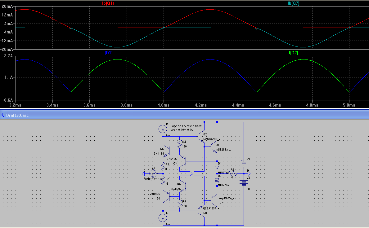

Okay, some topical information...

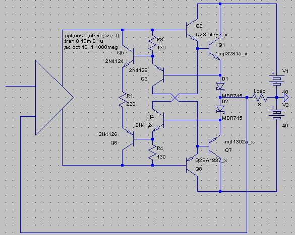

Klewis, if you want to take it one step further, might I suggest you try something like this...
I don't think the Allison can be any more class B than this! I don't think there are any benefits distortion-wise though. One possibility is that you have complete control of the bias current, so you can attach a knob to change it from class A to class B...
Complete control of the bias is done by the emitter resistor(s) of Q5 and Q6.
However, is there really a point to a class B or AB Allison? Does it perform any better than a simple Vbe multiplier with schottkeys on the emitters?
- keantoken

Well, what you can do with the circuit I gave is "turn it up" into class A any time you want, although it will still have distortion because of the diodes. Heck, you could even give it a "temperature" knob attached to a thermostat controlling the bias... You could impress your friends by "going green" with the push of a button!
- keantoken
- keantoken
R1 (in the second schematic) should not go below 100 ohms, or below the point where it is completely class B at least, because too low a value could cause the bias voltage to become negative dependeing on the Allison Vbe's, which is really a problem.
The 560/100pF compensation should be applied the same way to this version, on the bases of Q3 and Q4. I breadboarded this version once, I think it is actually more stable than the normal Allison... I wonder what your results will be, and thanks for trying it out.

In Paul's scheme he has emitter resistors in series with the Schotki (.1 ohm).
Ken
I meant the second schematic in post 386. But by putting the ground end there aren't you effectively shorting the circuit to ground?
I don't think the .1 ohm resistors are necessary in my scheme. They were necessary in Paul's to lower the bias current down to a reasonable level when there was no fixed bias voltage.

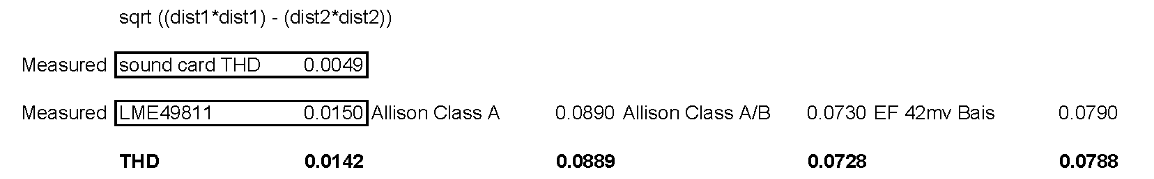

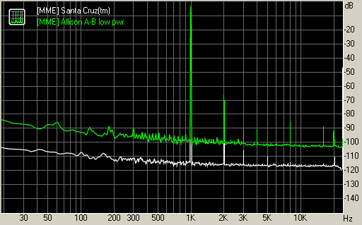

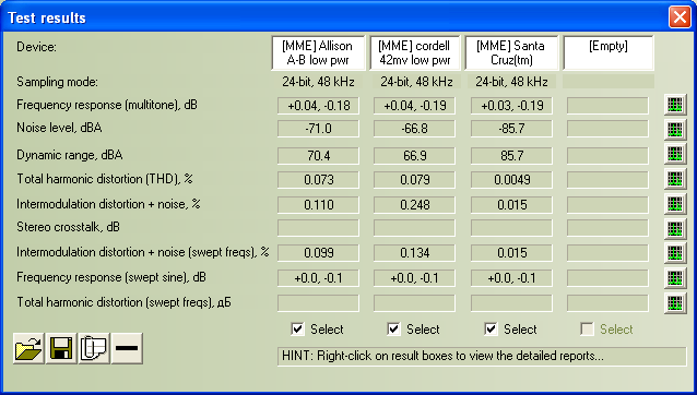

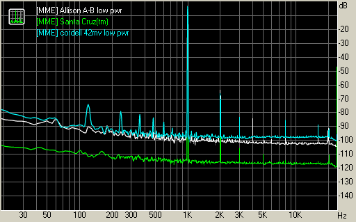

So things are quite so bad 🙂. I was using aligator clips as a part of the measurement aparatus, things started getting weird, so, I measure the resistance of the clip/wire combo - off the charts. Don't know why they degraded, but, I fixed them up with some trimming and solder. New measurements attached. The calcualtion sheet discounts the sound card.
Note: the "Allison A-B" scheme still has the compensation capacitors in place, the "Allison" has the compensation capacitors/resistors (100pf/560ohm) removed.
Lots of graphs and numbers to follow.

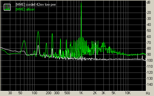

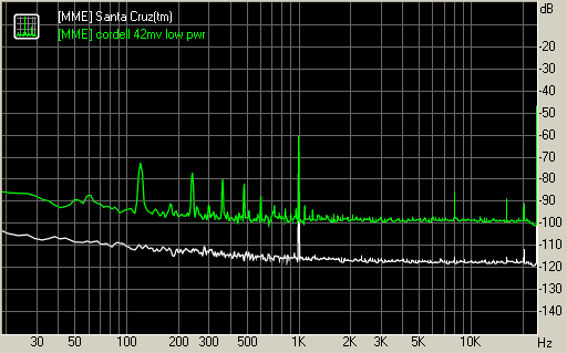

For comparison here's the EF output compared to the allison A/B scheme also the allison class A scheme, remember, with compensation removed.
Ken L
Ken L
Can you subtract the soundcard spectrum from the Allison spectrum so we can see the specific harmonics? Whether they are mainly 2nd or 3rd order would help us determine which mechanisms of distortion were in play... Oddly enough, it seems the Allison is creating dominant even harmonics, which is odd and would indicate something strange.
And at what power output is this?
And, the class A Allison's spectrum is simply too odd... Why not put compensation back in and see if it reads the same? The 60Hz harmonics also suggest a grounding error or EMI of some kind. (or, perhaps, there was resampling or some soundcard goof?)
Also, why is the Cordell measured at only -60db? This makes it not comparable, because it will certainly perform better at lower volumes.
Or maybe a Wizard will come along and shed some understanding on me... I haven't made any measurements with RMAA so I can't tell exactly what's happening.

Can you subtract the soundcard spectrum from the Allison spectrum so we can see the specific harmonics?I don't think so, haven't seen anyone else do this either - a couple of things, the spike at 1kHz is an artifact of the RMAA and to be ignored, other wise, I visually compare the sound card to DUT. Whether they are mainly 2nd or 3rd order would help us determine which mechanisms of distortion were in play... Oddly enough, it seems the Allison is creating dominant even harmonics, which is odd and would indicate something strange.
And at what power output is this? I have no idea 😱 I guess I could put a voltage meter on the sound card output, but, it seems to cycle through a bunch of measurements, so, I don't know if I would be measuring the voltage at the time of the THD analysis. As you said, maybe a sage with come along and help.
Also, why is the Cordell measured at only -60db? I take some of these numbers with a grain of salt - view them as relative to one another. Also, my measurement set up isn't very clean, I need to put some effort into getting it in order, hopefully will bring the DUT numbers down across the board.This makes it not comparable, because it will certainly perform better at lower volumes.

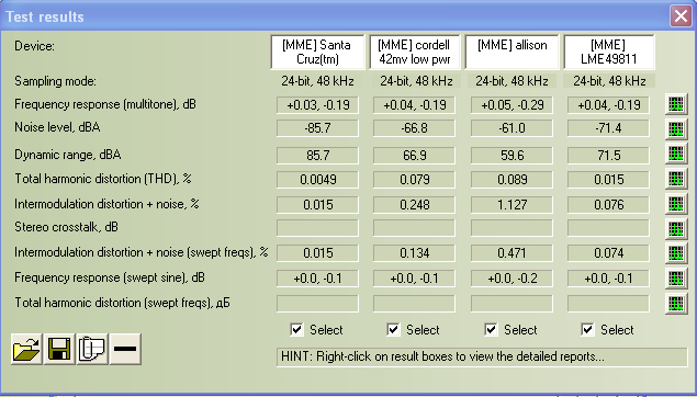

The RMAA measurements for the three amps were all at the same level, the sound card test was at a different level. The amp doesn't have a volume control. Only way to set the volume is via the sound card line in and line out controls. You need to set the volume or line in until the meter show approx. -2db. When doing this, it give you a preview. I mess with the line in and line out to minimize the noise floor, then save it as my test level for all these amp tests. I guess I could run the card test through my preamp to bring it's volume up to better normalize the test - the pre amp tested at the noise floor of my prior sound card which was .00019 (may it rest in peace). You can download RMAA for free at Right Mark Audio Analyzer. The only trick is under the sound card, put a check mark in the mono mode.
To Paul,
If you are still following along, I still haven't measured the voltage climb across the diodes, but, note that the diodes never even get warm, I check them after testing into 8ohm load.

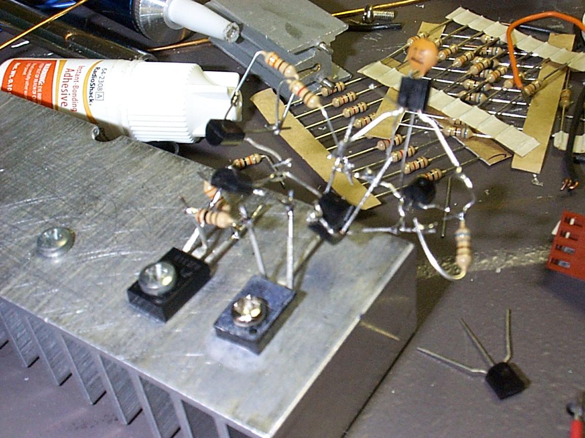

I'm working on a new LME49811 output board that will have jumper to try out the different combinations of compensation you suggested.
Then onto Keantoken's Class A/B scheme.

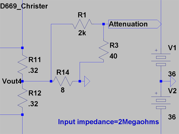

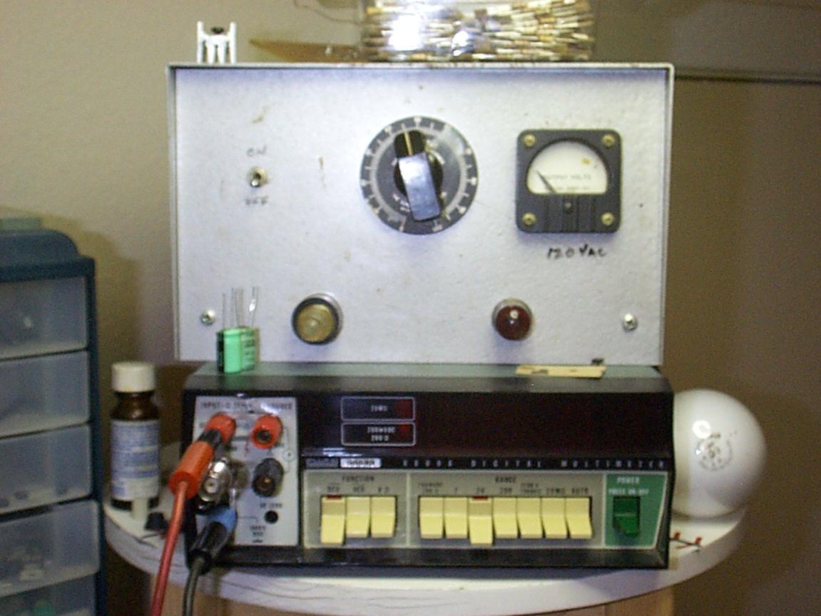

One last question, for full power test of the amp without cooking the sound card I'm planning on an attenuation scheme of line out to 2k with 40r to ground. I've simulated this and it seems to give plenty of attenuation. Does this make sense? I'm planning on using 5 10k 1watt || for the 2k and 5 200r 1watt || for the 40 ohm. Using CMF60 to keep the noise down.
