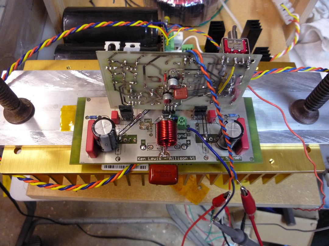

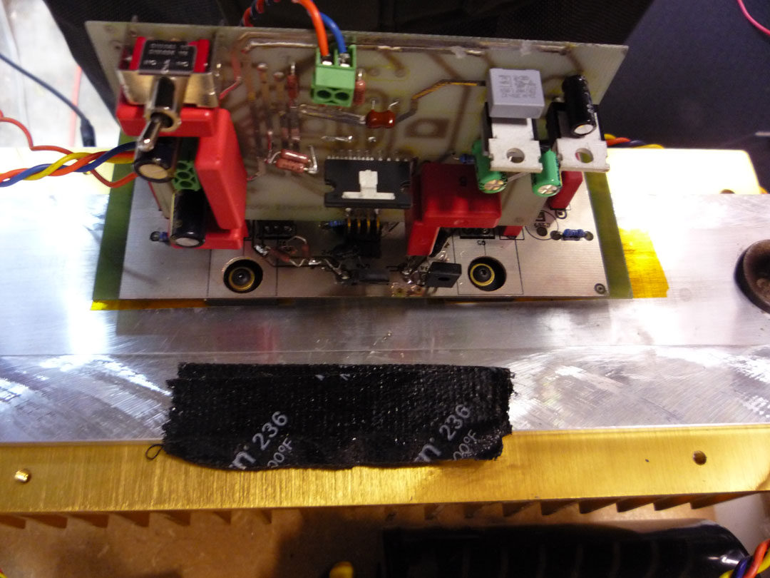

So, before seeing this and following part of Paul's suggestion, I moved the chip's feed back connection to point x on Paul's scheme and it seems to work well. I didn't move the chip's compensation cap. I'll post pictures tomorrow, all the waves looked good. I can start trying to reduce the compensation caps until oscillation sets in and then back off. Maybe this feedback strategy will allow me to remove the compensation...
I also hooked it up to the speakers and the excess brightness is gone, it sounds fantastic.
I cooked my sound card, so, no THD numbers for the moment, but, maybe in a week or two.

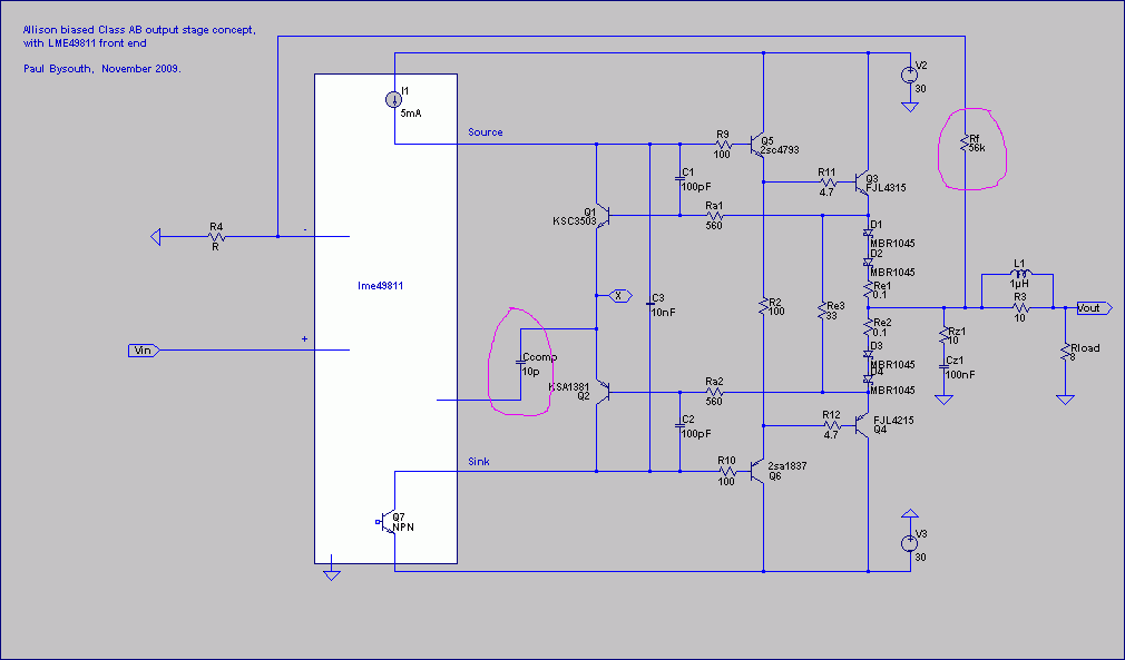

Klewis,
If you want to modify the Allison output stage to be a Class AB amplifier, then the attached circuit shows how. Adding two schottky diodes and reducing Re to 0.1 ohms will give a bias current of 360mA (it will start at 260mA with cold diodes). The OnSemi model for the mbr1045 and LTspice will indicate a bias current of 460mA, but it is actually 360mA.
Note the following:
- Two schottky diodes (mbr1045 or mbr745 would be good choices) and added to each Re emitter resistor. This (and Re3) is a modification to one of Kenpeters designs of some time ago.
- Re3 (33ohm) is used as a `keep alive' current to keep the output transistors, drivers and Allison bias transistors always on (and this is a good thing).
- Rf is moved to provide overall feedback, as the Schottky diodes increase the distortion such that some feedback will be required to reduce it.
- Ccomp stays on point X.
The two schottky diodes give a very smooth transition from conducting to non conducting, and hence produce less high order harmonics than normal (another good thing). If you want to model this, the OnSemi mbr1045 spice model is the closest that I could find to actual devices.
The Allison bias transistors should be thermally bonded to schottky diodes D1 and D4. Ksc3503 and Ksa1381 To126 transistors are good choices for these. Keep these diodes and Allison bias transistors away from the output device heatsinks, and ventilate well. Try to keep them at a constant temperature.
The bias current of 360mA will give Class A operation up to about 4 Watts into 4 ohms with quite low distortion. Most music is below 4 watts.
I suggest you try to get the Class A version working first, then add the Schottky diodes and Re3.
I hope this is of interest.
Paul Bysouth, Nov 2009

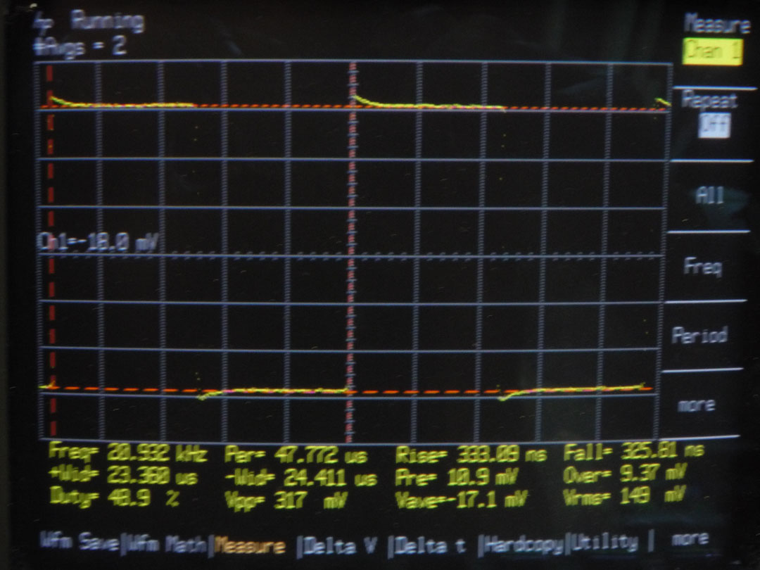

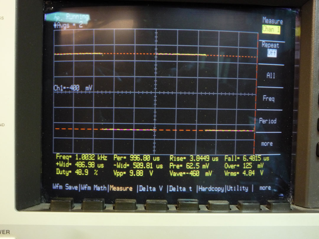

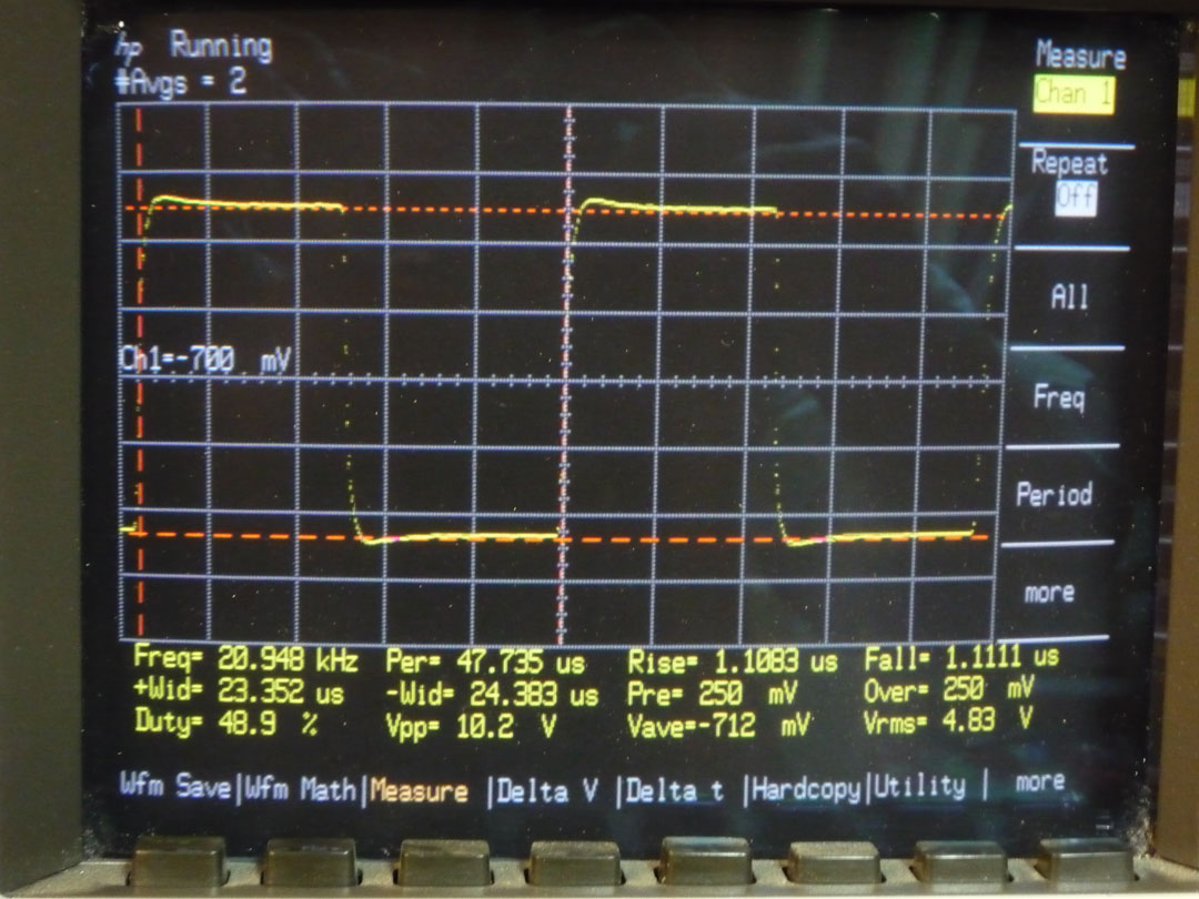

photos of square waves - I've included as the first pic the square wave output of my signal generator, you can see it has a similar shape and magnitude of overshoot to the amplified signal.
Ken L

The Allison bias transistors should be thermally bonded to schottky diodes D1 and D4. Keep these diodes and Allison bias transistors away from the output device
Agreed! I've already figured on my own keeping AB diodes away from outputs.
But hadn't occoured to me that bonding them to the Allison comparators might
actually be a thermal compensation worth trying!?! *Smacks forehead*
Not entirely convinced yet that cold diodes isn't the safer bet than bonded?
But certainly no harm bonding those diodes to each other if nothing else...
Unless tabs also happen to be cathodes... Then you might need a mica.
They are gonna dissipate far less than 1 Watt apiece in AB, and TO220 tabbed
Schottkys are certainly overbuilt to handle more than our application demands.
I just don't see bias runaway becoming a problem, long as they are well away
from other sources of heat...

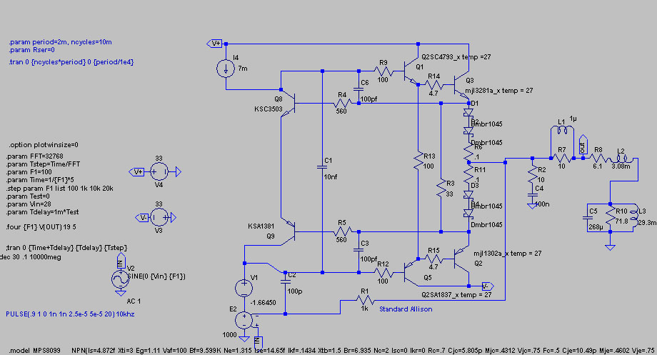

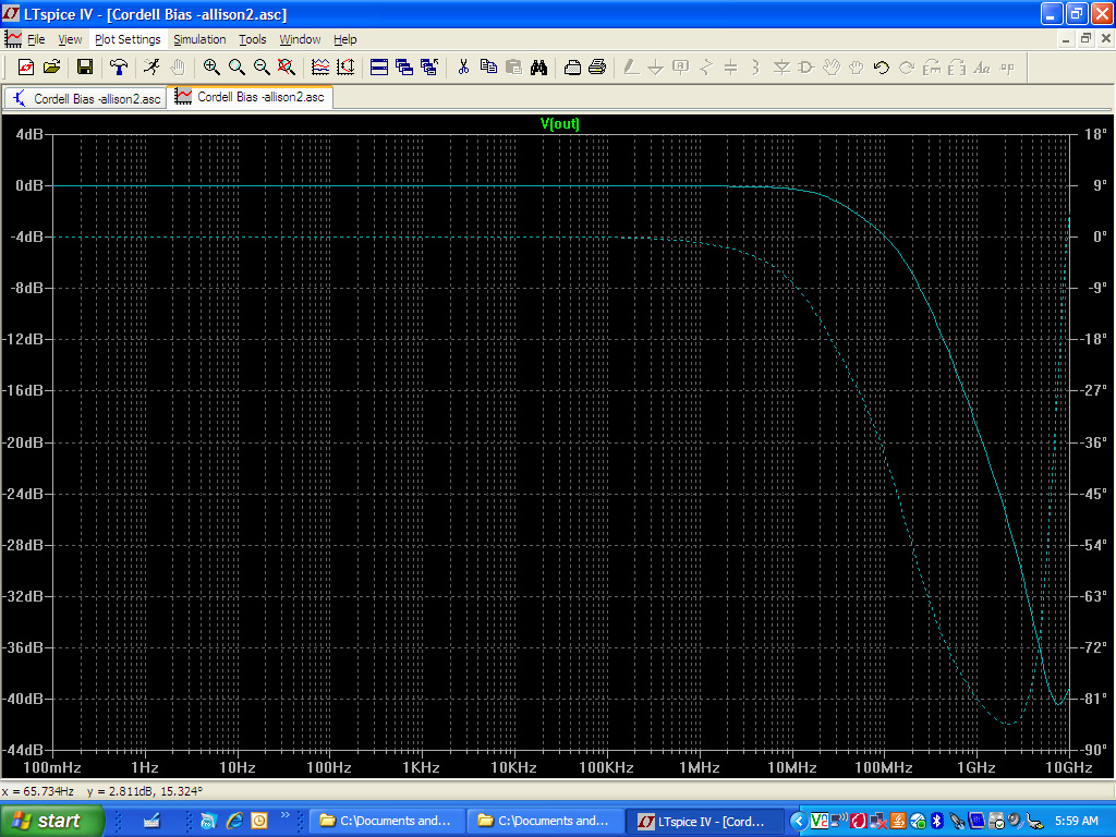

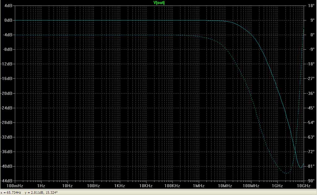

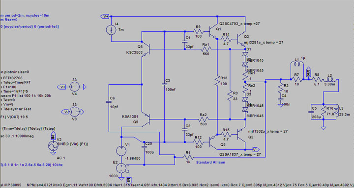

I've tried two things in simulation, first is using my original schematic without Paul's compensation of 100pf/560 ohm, but 100nf between the bases of the allison pair I get the first graph. Then with the schematic as shown, I get the second graph. Both simulate well in the four furrier analysis.
1. Is my spice schematic workable? would you change anything?
2. I was lead to believe that a phase shift over approx. 70deg was a sign of instablility. Is this correct? If so, what about the second plot?
Ken L

Ken,
Looking at your schematic, I think the capacitors C3 and C6 should be moved to the other side of R4, R5 - ie C6 is connected across the collector/base pins of Q8, and similarly for C3,Q9. The values of 560/100p was just a guess, so I'd try reducing the capacitor value and see how it goes.
Also try connecting one end of C2 to between the emitters of Q8,Q9 with the other end connected to R1.
Paul Bysouth

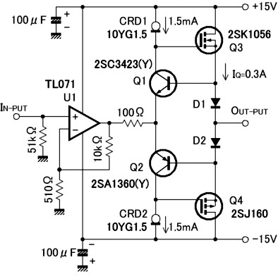

Yeah, but near the bottom of the page, he's finally figured out that
smooth AB don't need to be complicated. Schematic look familiar???
MOSFETs as shaping diodes IS better square law than Schottky,
but is this nuance really worth the wasted forward voltage???
And then you still gotta match them...
Wow, that never even registered. Interesting he uses MOSFETs shorted G-D for the diodes...
BUT, true non-switching would be where neither OP turns completely off (or say, doesn't go below 5mA of output current). (looking at Q9, 10, 11 and 12, it looks like this is accomplished) (what if we replace Q11 and Q12 with schottkeys...?)
- keantoken

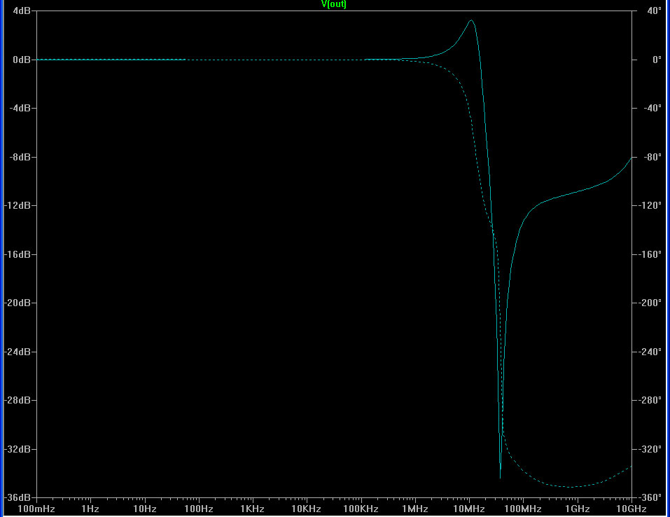

All,
I've updated the spice schematic and messed with the values. This is the best ac analysis I'm able to get. My questions are:
Does this suggest instablity? With the exception of the diodes, it's basically the same circuit as the physical test prior to moving Rf to point x (allison emitter point) if you remember that test showed some fuzzyness at the top of the sine waves.
Is there anything else I can try?
