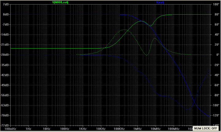

Yes, in simulation, AC analysis.
Click and drag from Q8's emitter to the output node. This measures the difference between those two signals, just like a differential scope plugin. The correct probe equation will automatically be entered.
- keantoken
- keantoken
Here it is.
Wow, that is odd looking...
Well it doesn't oscillate in the .tran analysis so it can't be bad, perhaps the weirdness is just a result of it being used oddly (the response peaking is worrisome though - why would it resonate at 50Hz, then 10KHz, then 1.5MHz?). I'm not sure but I wouldn't expect it to behave this way in the real world.

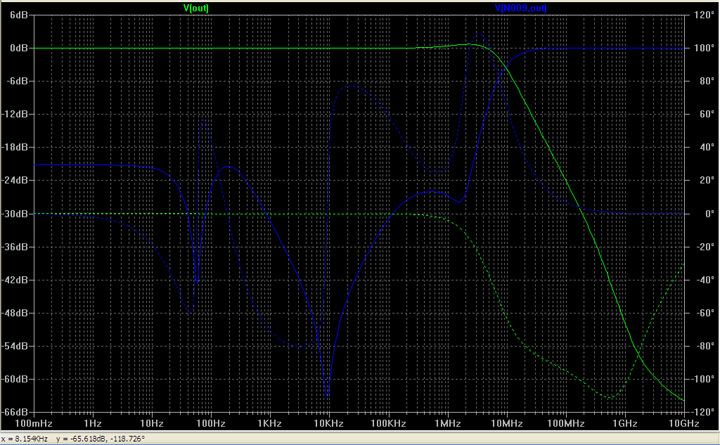

On that note, I just realized why it was so weird - it is in fact acting completely as expected. Your reactive speaker model is what's causing the response strangeness.
Nothing to worry about at all, it is expected.
Good luck and I'm glad it sounds good. 🙂
- keantoken

Simulation into a simple 8 ohm load.

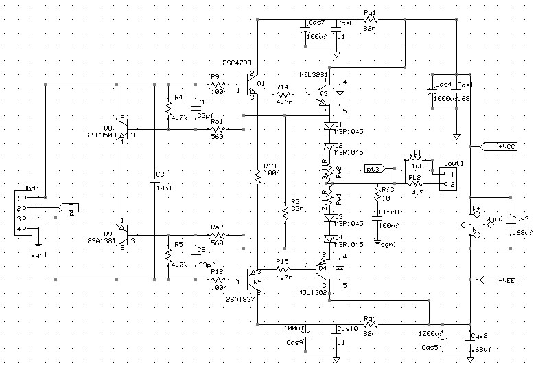

So, it's built and running. The attached is the schematic. Measured 1.140v Emitter to Emitter at output transistors - it was cold out (well for Southern California). This voltage was rising at about 1mv per 5 seconds. The simulation shows 1.17v for this. Sine wave looked smooth, but, the 1khz square wave had a fair amount of overshoot and the 10khz square wave had an overshoot almost equal the height of the wave. The measurements were taken with an 8 ohm load attached. I also tried reducing the signal generator input voltage to 5 mv to try to simulate sub 4 watt class operation (no math attempted just a guess on input voltage) but, no change.
I'll take photos of the scope tomorrow night.
On the positive side the heat sink wasn't even starting to heat up.
Any thoughts on how to kill the overshoot?
Ken L
The traditional way of killing overshoot would be to increase compensation somewhere...
The overshoot is either coming from the LME or from the Allison, I'm thinking the LME. Try increasing the 33pF caps on the Allison and if that doesn't help, increase compensation for the LME.
- keantoken

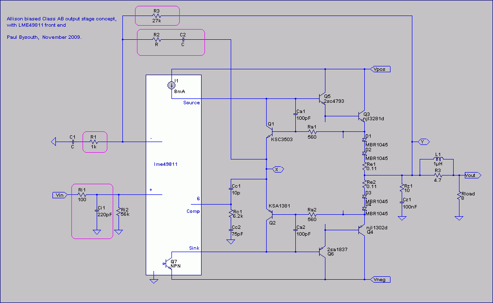

Klewis,
I have some suggestions for you to try:
1. The lme49811 data sheet has buried in it a specification for a minimum closed loop gain of 26dB (ie 20), and you have a gain of 19.1 To start I suggest you change the gain resistors to 1k and 27k giving you a gain of 28, which is very close to the THX standard of 28.2 (ie 29dB). Gains less than 20 "may cause instability"!
2. Referring to my attached diagram, I'd add resistor R2 and C2 which will have the effect of reducing the demanded gain at high frequencies and hence limiting the high frequency effect of the phase shift in the Allison output buffer. I'd start with `10pF < C2 < 100pF' and `0 < R2 < 1k'.
3. I also suspect that Ca1 and Ca2 (on my diagram) should be more like 100pF. 33pF seems a little low.
4. I'd start by connecting R3 (on my diagram) to point X (on my diagram) which will place the output buffer outside the feedback loop. Convince yourself that the lme49811 is properly compensated and that square waves don't have too much overshoot (monitor point X). Check that the Allison buffer is also handling square waves properly by monitoring point Y. Mixing square waves and a higher frequency sine wave, and mixing a triangle wave with a higher frequency sine wave are also good test methods (particularly for overload testing). Once all is well, then move R3 back to point Y.
5. I'd also add an input buffer (ie Ri1 and Ci1) to prevent high frequencies getting into the amplifier. Don't forget to allow for the preamplifier output impedance which will add to Ri1.
Could you also measure the bias current (with no load) through the Re1 and Re2 resistors please, both when cold and after operating for a while. Also how hot do the Schottky diodes get when in operation for a while?
Note on the attached diagram I've removed all the components that don't effect this discussion, but you'll still need them.
Please keep us updated with progress.
Paul Bysouth, Nov 2009

Paul,
Thanks for suggestion. I will give them a try. Question on the output impedance of the pre-amp; I presume that it's value is set by the resistor at the output of the pre-amp, which as I recall is 100 ohms. I would therefore use 200 ohms (100+100) in the calculation to come up with Ci1. Or, is there a way to measure output impedance?
Ken

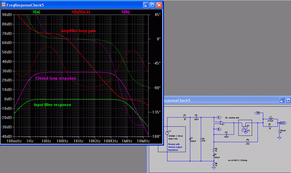

Klewis,
Yes the preamp output impedance just adds to Ri1 (ie 100+100). However I nomally just use LTspice with a simplified circuit to check that all the responses will be what I want. See the attached diagram. Note the effect the 15pF capacitor has on the loop gain at around 200KHz.
In your case, Ri1=1K and Ci1=220pF would produce a suitable filter assumming that the source impedance is 100ohm.
Paul Bysouth.
