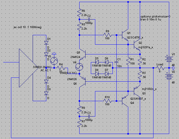

Simulation Analysis of several unique Allison-based output stages.
Keantoken,
I like your `Allison-Keane' variation to the standard Allison circuit, which overcomes the need to use large emitter resistors. However quite a bit of LTspice simulation leads be to believe that your design, and a very similar variation that I came up with, will both suffer from two problems:
- Temperature changes in the Allison bias transistors effect the output bias currents considerably and this is made worse by the small emitter resistors of the output transistors. Your design would probably benefit in using one of the THAT packages that contain 2 NPN and 2 PNP transistors. My variation was even worse.
- The transition from Class A to Class B is very abrupt, and hence will almost certainly produce high order harmonics.
Inspired by your `Allison-Keane' design I tried to come up with a design that would allow small emitter resistors but give a gradual transition into Class B.
The attached design uses large resistors (R3, R4) to set the bias current, and then bypasses these with diodes to allow high currents without the large voltage drop across R3, R4. The diodes cause a very gradual transition into Class B, with gradual turn off, but not `Non Switching Class B style (but almost). Note that Q3,Q4 will need to be thermally bonded to D1,D2.
So far this design appears to be promising, and I hope to build and test it some time next month (my day job is getting in the way at the moment). I fear that I may have swapped one set of problems for another, namely diode switching harmonics destroying the THD figures.
I have some questions that maybe someone can answer ...
- Has anyone tried putting diodes across emitter resistors like this before, and if so, do they generate unacceptable switching harmonics?
- Is a MUR820 the best choice for the diode in this application?
Paul Bysouth, March 2009.
ps - Sorry about the delay in posting this, however my Internet router power supply decided to break just before I pressed the submit key, and as it was midnight I went to bed. I've spent this morning fixing it. I hope my cut and paste above works.
pb.

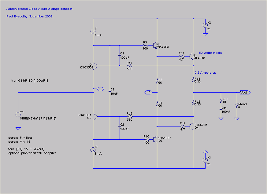

Ken,
I suggest that as you currently have a Class A amplifier (and the standard Allison circuit doesn't work as an AB amplifier), that you split the amplifier into the lme49811 driver stage (with feedback), and the Allison biased Class A output stage acting as a unity gain output buffer. Don't use overall feedback! The Allison biased Class A output stage will have low enough distortion that you don't need overall feedback. This will allow you to get each half working properly, and then you can consider using overall feedback it you want to.
At the moment you have a feedback loop inside another feedback loop, and these are always difficult to track down faults. Using the `no overall feedback' scheme will help considerably
Referring to my attached output stage concept drawing, some suggestions:
1. I have looked a several loop gain control schemes, but I think the Ra1/C1 and Ra2/C2 scheme is probably the safest.
2. The resistors Ra1, Ra2 have two important functions, namely controlling the loop gain of the Allison bias circuit (in conjunction with C1, C2), and limiting excess current into the Allison bias transistors. If the output is heavily biased into Class B operation, then the voltage across the two bias transistors (Q1, Q2) will exceed 1.5 volts and so a large current will flow through Q1, Q2. These will then fail, the drivers Q5,Q6 will be pulled to the rails and Q3,Q4 will dump a large current into your speakers which will continue until either the output transistors or the voice coil fails.
3. You should have a fuse (7 Amp would be suitable) between the power supply and the output transistors, and then a capacitor from the output transistor collector to ground (eg: 1000uF plus 100nF).
4. The lme49811 has a loop gain control capacitor (C1 in your drawing I think), which is normally connected to the lme49811 sink pin. You could try moving this to point marked X on my diagram. You could also try point Y, but I think X would be better. You should also experiment with different values either side of the 10pF.
5. The feedback resistor (56 Kohm) for the lme49811 should connect to point X on my diagram.
6. If you want to implement a current limiter to stop it going into Class B operation, then 2 or 3 series diodes between point X and Vout will do the job.
I hope all this helps. I'm currently working on an Allison biased Class AB amplifier, so I'd like to see you get this working, as it may well save me some time.

Paul, maybe not realistic to simulate driving into emitter input impedance from 0 Ohm
signal source? If a signal source was really that low impedance, why would we need
an Allison stage??? If you sim from realistic source with 600 or 1K impedance, you find
the difficulty. AC drive signal into Q5 and Q6 bases still must come entirely from V1!
Impedance into MOSFETs works to around 22K at 20KHz. Not entirely sure with BJT
Darlingtons, but I got a sneekin feelin that input Z could appear even lower...
Its a great drawing for topology discussion, but not likely to sim meaningfully in terms
of bandwidth or distortion until this unrealistic signal source is addressed.
I like your Darlington outputs, cause we do need at least 2 emitter drops standing
on collectors Q1 and Q2. I always worried early Sziklai variants, cause there seems
barely .6V dropped across CE! Requiring those transistors flirt with deep saturation
to sustain such levels of conductivity. Can they be fast when flooded with so many
carriers? Darlington and/or enhancement MOSFET here neatly avoids that issue.

Ken,
With the lme49811 you are actually current driving the Allison bias transistors through their collectors. I should have cut the V1 voltage source off the drawing as it is obviously confusing.
The Allison stage can be voltage driven via the emitter juntcions (ie point X on my drawing), and will work very well provided that it is a low output impedance voltage source. The Allison stage can also be current driven via the collectors, and this also works well but probably not quite as well as voltage drive. In any practical amplifier, creating a good low output impedance VAS stage probably isn't worth the trouble, while creating a current drive VAS stage is easier. Using the lme49811 to current drive the Allison bias transistors should work well.
Paul Bysouth

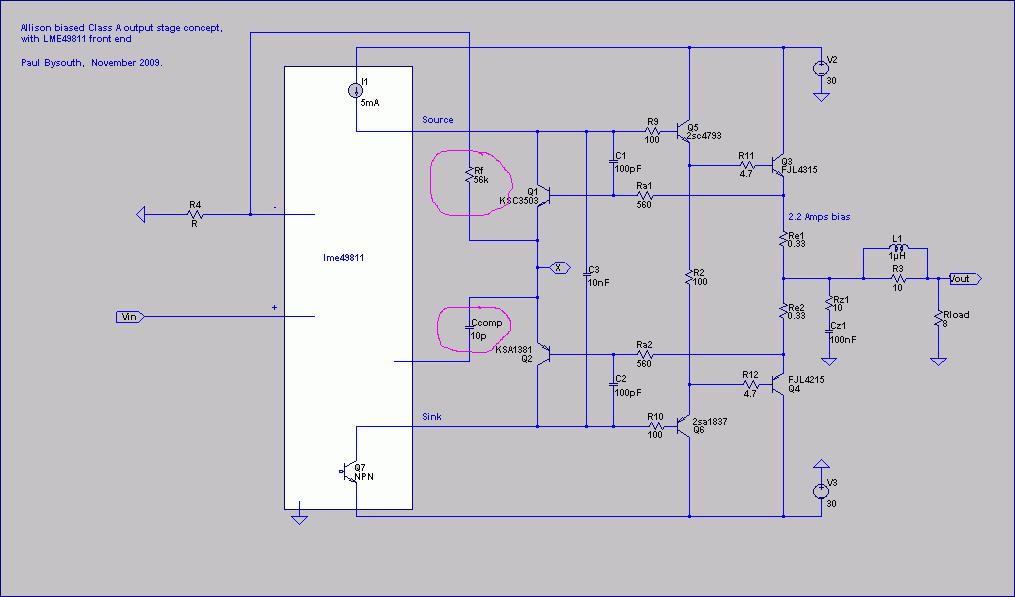

Paul,
I re-read you note for the third time - I'm a bit slow it seems. So, if I connect the Rf and cap you noted to point X and the sink and source at the appropriate current source locations, this will seperate the feedback loops - yes?
I'm less sure about how to reduce the bais to get it into Class B at a lower current - eg less heat generation. (If this makes any sense at all)
Ken

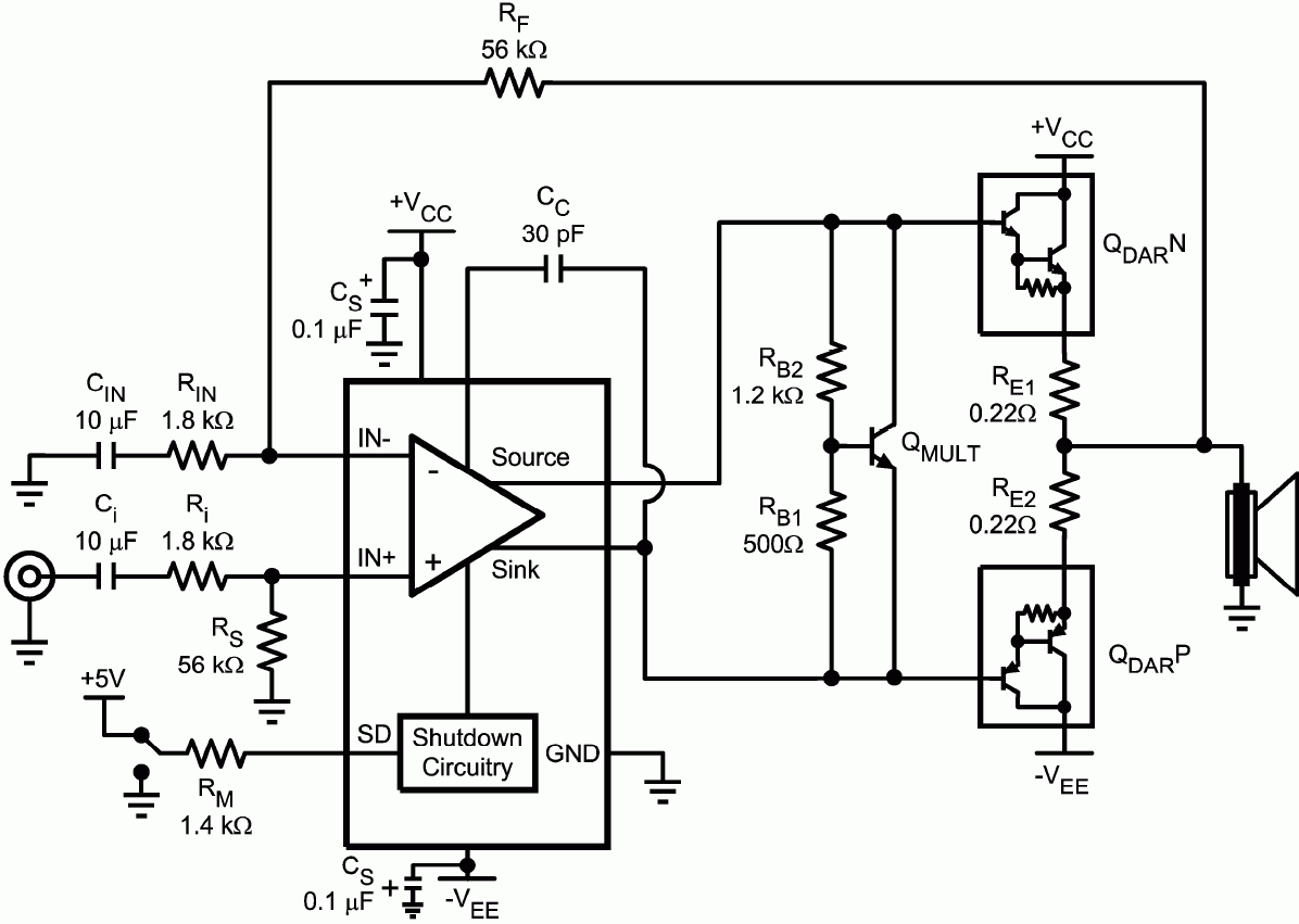

I was just checking the LME49811 to see exactly what kinda op-amp
it is you been trying to use so far. Looks appropriate without having
to do any such stupid abuse as I was thinking...
Allison (sliding bias correction only, no other errors corrected except
by the op-amp) seems a no-brainer. So, whats been the trouble???
Copy and paste National's reference design...
Then the Allison hack...

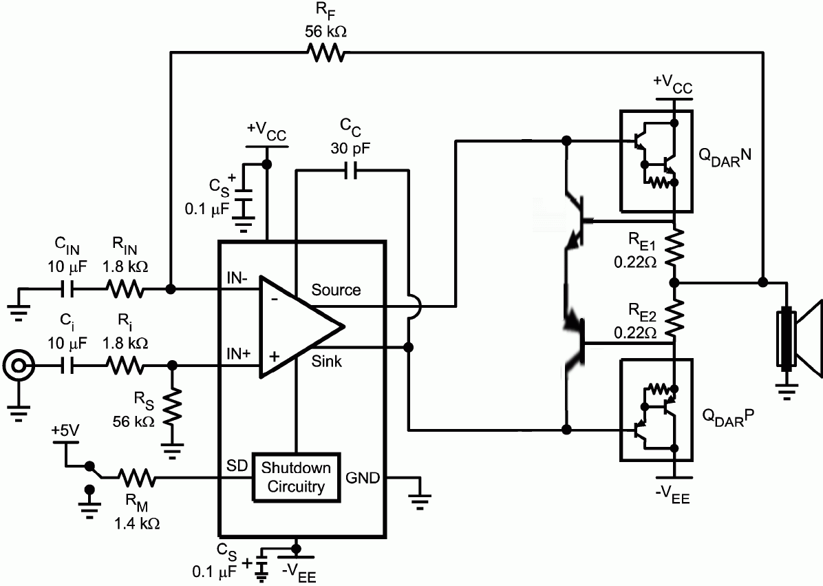

I don't see how Cc (the bootstrap?) in ref design is supposed work
off the current "sink" only, if its really a single ended class A???...
You need to tie that bootstrap to the output of the Allison, where
that end of the cap can be brutally jerked equally in both directions.
Okay, I looked back and didn't find my aforesaid "bootstrap schematic".
So here it is, this is how it's done. This works better than taking bootstrap reference straight from the output.

Klewis,
I seem to have confused you. I meant that you could try the scheme as in the attachment below. By connecting Ccomp and Rf to point X, it splits the amplifier into a front end with gain (the lme49811) and a unity gain class A output buffer. The Lme49811 provides the current source for the Allison bias and driver base currents. The Allison Class A stage has sufficiently low THD that it doesn't need overall feedback.
I have now idea what compensation the lme49811 will need, you'll have to experiment until you find the right values. The suggested values for the Allison bias are suggested starting points. 560ohm/100pF should be a reasonable starting point. Note I haven't added all the lme49811 detail, see Kenpeter's post #333 for that.
Note that this design is only suitable for a Class A amp with lots of bias current (2+ Amps).
If you want a Class AB, then a different cicruit is needed.
Paul Bysouth, Nov 2009.
