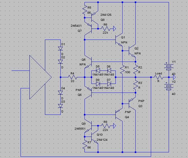

1: Try the diode protection scheme in the schematic. This will protect the Allison from overdrive.
2: With Klewis' schematic, the outputs are each drawing 2A of current. This is pretty hot.
3: Please post (or at least describe) the current schematic that matches your real-world layout.
4: To protect the Allison when prototyping, bypass D6 and D7. This will limit the power ability of the Allison so you can't possibly overdrive it.
5: In the Allison, the transistors most prone to problems are Q5 and Q6. Please check to see that they are still working.

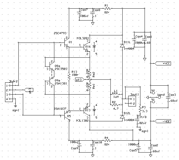

I learned much over the course of the Patchwork amp but still have a lot more to learn.
One of the signs of oscillation is the devices getting hotter than they should. Checking the output with an oscope will confirm this.
When I use schematic from post 266, I get 1.301v when measuring from emmitter to emitter of the output transistors. But, it oscillates...10.204MHz. Interestingly, it sounds quite nice...
When I use schematic from post 270 it makes decent sine and square waves but doesn't generate any bias voltage. I think it's missing the current sources that feed the driver tranistors.
I'll post a working schematic for 270 for comment.

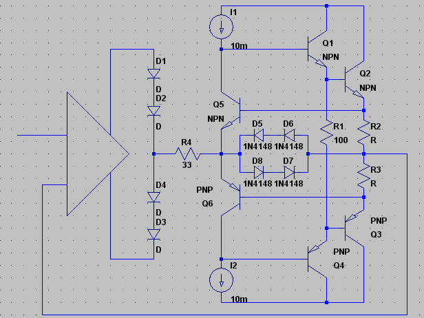

I see it now. I'm glad the first version worked, this means the Allison is practical.
1.3V is good. Watch it if you get anything 1.4V and over.
Without the current generators, it won't work. Here's how I do it:
- keantoken
I thought so too. The Allison may be one of those circuits that isn't affected badly when it oscillates. (Someone also commented in one of my threads that a HF AC signal through a speaker will improve the speaker's operation, though they did not post a source)
If you can't cure this oscillation any other way, try inserting a 1n cap between the bases of Q1 and Q4, then increase or decrease until the optimal value is found (lower is better).
- keantoken
Oscillation rarely affects the sound quality but will destroy the output devices fairly quickly. What is the value of the emitter resistors? It's not posted on the schematic.

Klewis' earlier schematic shows .32 ohm resistors.
Note: With the Allison most of the oscillation is common-mode or vertical through the outputs, so very little of the total oscillation power actually goes to the speaker (and there are often lots of harmonics, we may even see more 2nd harmonics than fundamental).
I'm glad you're not uncomfortable ginnea-pigging the design, because getting this to work will increase the possibility of others being interested in the Allison. All my suggestions should work with the 266 version (and switching to 270 may not increase sound quality).

If so, that's 2 amps per output (1.3V/2=.65/.32=2) and at a rail voltage of 40V, that's 80 watts dissipated at idle per device. They need to be pretty darn good devices on a pretty darn good heatsink to last long.

Alright, schematic 1 needs the current sources I added to post 283. Without these it won't work (work well, at least...).

so the output resistors are .22, supply voltage is 31v
Don't laugh, but, I steam my latte milk to 160deg F and know how hot the pitcher gets, the heat sink was hotter than 160.😎
Oscillation is a sign of instability and is not acceptable. Period.
According to Klewis' schematic, the emitter resistors are .22. That's nearly 3 amps through each output - WAY to much! Need to get that voltage down or kiss those babies goodbye.

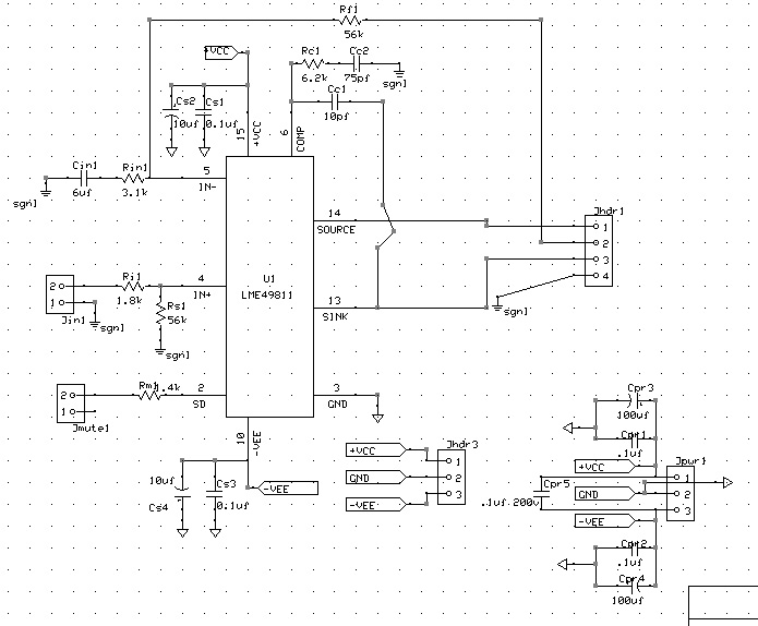

keantoken the 49811 provides the current through pins 1 and 3 Jhdr2. This configuration is the one that produces 1.3v across the Re's and occilates at 10Mhz. I'm going to try putting a 1uf cap across the bases of Q1 and Q4(my Q5).
ken
Klewis, how much power output do you need and what is your load? As per MJL, it is advisable to lower your bias resistors.
And yes you are right, I forgot that the 49811 provides bias current for your schematic.
(large caps like 1uF might have too much series inductance, and might actually cause instability. So if it doesn't work, you might try say 100n just in case)

Tried .01uf poly cap as shown below. No luck, still oscillates this time at 11Mhz.
Ken
Okay, it may be the 49811 that's oscillating, can you tell? Try putting a 33p cap across Ril, if increasing the compensation caps does not help.
EDIT: the cap should go across Rfi (56k feedback resistor), it's hard to read the resistor values so I may be wrong.
