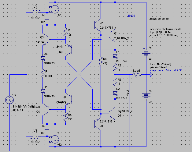

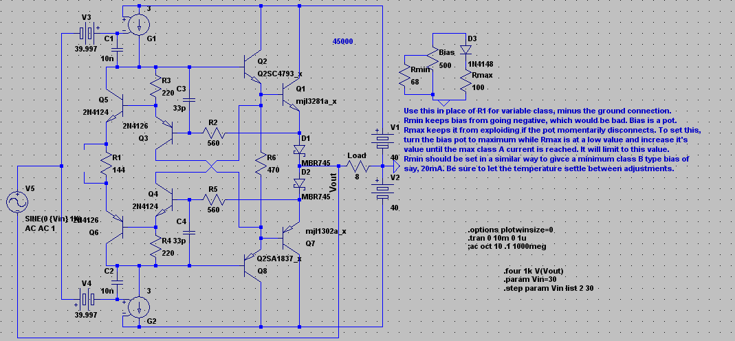

Okay, more improvements to the Variable Class Allison.
These improvements should have been obvious to me, I need to work on that...
Firstly, the 470 ohm resistor increases bias current in the drivers. I had hoped that bias current was enough anyways but it can't hurt.
I also decreased bias current through Q4 and Q3; I had made the mistaken assumption that the current through Q4/Q3 and Q5/Q6 should be equal, but this is simply not true and not necessary for optimal performance. Increasing R3 and R4 decreased aforesaid bias current but it also decreased the current swing through those transistors, decreasing distortion (they were even turning on and off before this).
- keantoken

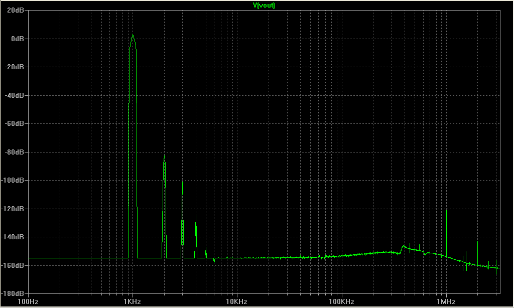

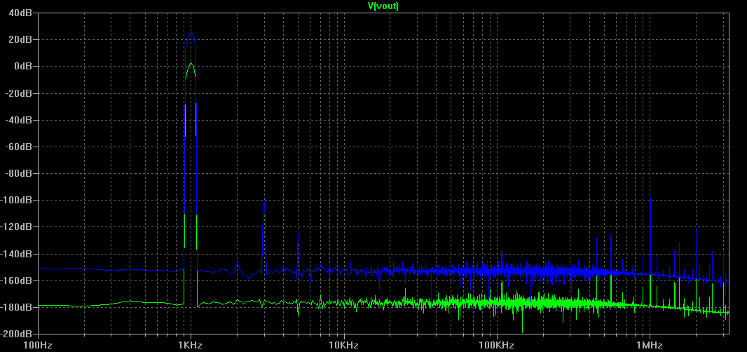

Instead of posting the THD numbers, I'll post the spectrums in class A and AB.
Results were taken at 2V and 30V output into 8 ohms. 93db loop gain. These results are very optimistic since the NFB mechanism is perfect (this is why simple THD numbers would not be very useful).
The first attachment is class AB at 100mA and the second is class A at 2A. (maybe you can guess why class A sounds better!)
- keantoken

Keantoken,
The graphs look quite similar to my measurements with the A/B version having the very similar spikes and the A version without the spikes except at 2k. How do you make those? Is it the 1k four analysis you show?

To clarify, the circuit produces very little 2nd order harmonics which is no surprise. In fact a total absence of even harmonics is not unbelievable and would possibly indicate that the circuit is functioning exactly as intended.
- keantoken
keantoken,
I understand the differences in the noise floor. I guess I didn't make a good explaintion. The Allison A/B scheme has a very similar graph in measurement, but with the noise floor moved up from -180 to -110. The spikes (which I believe are harmonics - correct me if I wrong) that start a 2k and diminish in amplituted are very consistent with your model's behavior. They are just moved up by 70db or so.

One last thought and a question;
I don't think I will build the variable bias with a pot, at least not as a final version. I would like the amp to run in class A up just up to the point of swamping my heat sink. My speakers are reasonably efficient so I should be able to have my general listening take place in Class A with occasional excursions into class B. Avoiding the pot and the chance of it opening up along with the noise it will introduce and a lower part count are all good things.
In Paul's A/B scheme he had me thermally couple the diodes to Allison pair. Should I do the same here? Would it be the two at the far left of the schematic (sorry, don't have a print out of the schematic in front of me). Q5/Q6?

What spice comands do you use to get this output. It's quite helpful for comparing simulation to actual measurements.
To get the FFT graphs, I used the right-click menu on the trace and went to View->FFT.
Any spike that is a multiple of the test frequency is a harmonic. 2k, 4k, 6k, etc are even harmonics and 3k, 5k, 7k, are odd. This distinction is important because 2nd harmonics distort the wave asymmetrically while 3rd harmonics are symmetrical.

How about this? Little danger of negative diode bias, and almost fully temperature compensated. (duh, never thought of putting diodes there!)
Coefficient is .2ma per degree Celsius. All schottkeys should be thermally coupled.
- keantoken

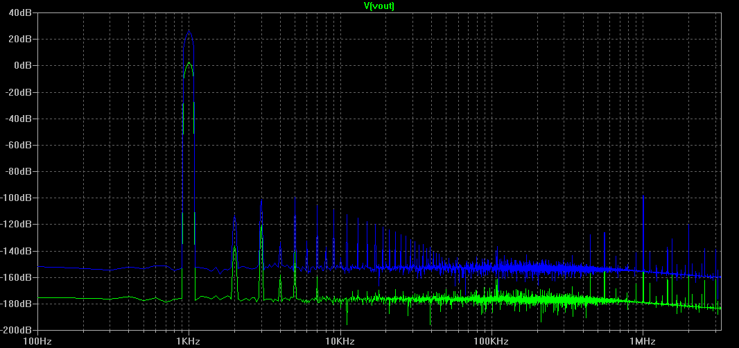

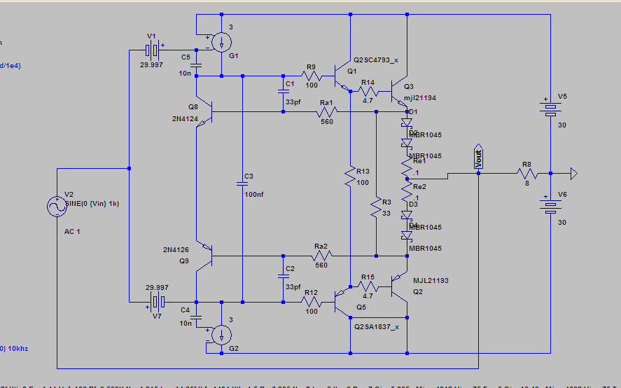

keantoken
Using you simulation technique I revised my model of Paul's Class A/B Allison. The schematic is attached. The simulation harmonics seem consistent with the measured harmonics. What is inconsistent is the measurement across the emitters of my Q3/Q2 - I get approx. 1.2v, the model says 8.5v.
The other thing is that your spectrum plots seem to have more resolution. Is that a result of a setting or just the nature of the specific design.

Sorry Klewis, I got distracted.
For my FFT I didn't use the "enhanced" timestep commands, I just used 10mS 1u timestep because it's quick and easy. The FFT was set to 65536 which explains the extra resolution.
In your model, the negative end of V7 is on the wrong wire. It should be attached to the + node of G2. That should fix it.
