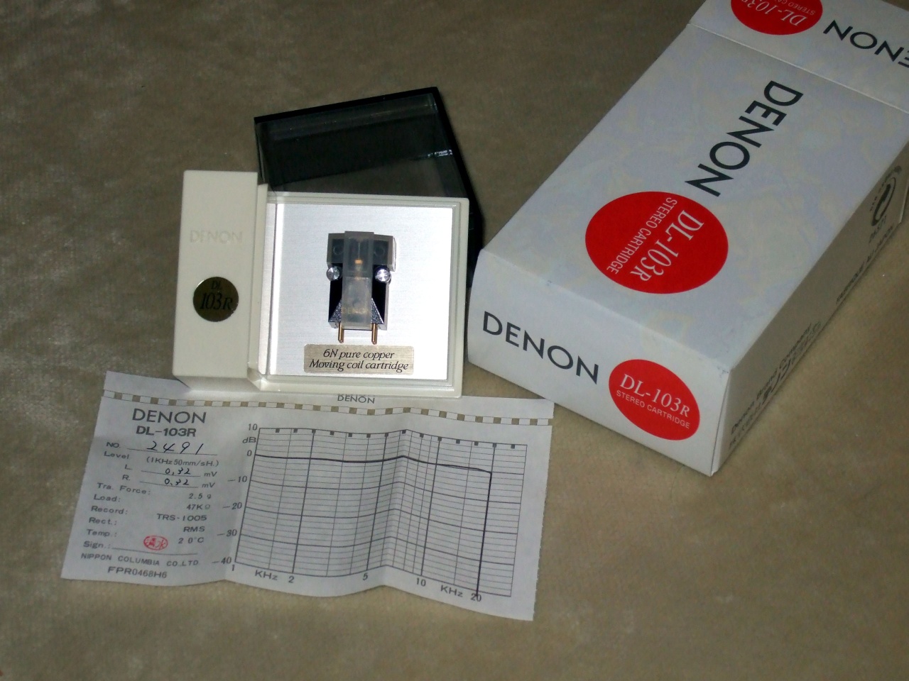

🙂 Got a DL 103R. Fortunately says 0.32mV on its individual spec sheet. Not 0.25mV as advertised. Even better. That is for 47k though. Does any body know where the audiophiles tend to usually load it? I would think that 150 Ohm is the minimum since it has 14 Ohm coils.
