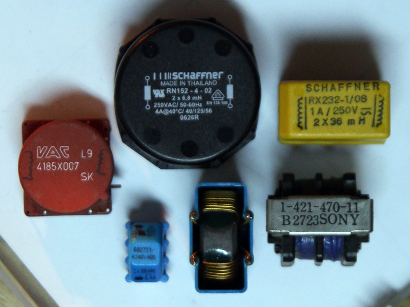

Sorry, can't help you with that. See attached picture for examples. The more milli Henry you use, the lower the filter frequency will be. Anything from 10 to hundreds mH helps, mind the suitability for at least 500mA of current passing. Connection to ground at the last capacitor. Besides, you can roll one of your own.
