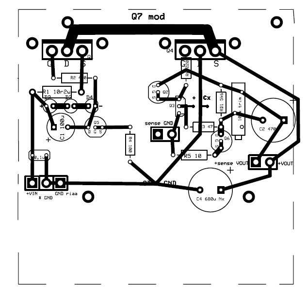

Massimo,
Maybe you should drop the traces for R2 and R6 connecting to the mosfet. These resistors can be soldered straight on the gate pins. The position of R7 prohibits the use of a 'fat finger' heatsink on Q1.

Thank you for comments Disco.
Yes, the 4 "grid stoppers" might have shorter tracks, but, as you can see, my goal is to have two exactely mirrored circuit, one for L ch, one for R. I like all the components in the same position and thus I have to place the resistors in the middle of the TO247 and rotate the tracks toward the gates. In this way, even if a bit longer, they all are of the same lengths. I can try to further shorter them by a couple of mm anyway. The pcb is still in the debugging stage.....
R7 is not a big problem for me as I'm gonna use a flat heatsink. It can be replaced by a jumper underneath anyaway. As you probably noticed, I arranged some other pads in series for the trimpot and for some fixed resistors in // if you want to replace it once the right value has been found.
The reason why I designed the mirrored pcbs is that I would like to place the Riaa pcbs aside of each regs in order to reduce the lentgh of the V+ & Gnd cables to 4 , maximum 5 cm.
I'll show you my complete design as soon as it will be ready for etching.....
Is Q7 heading the wrong way on your pdf? Unless we do view the under side. Also the distance to the stopper and the stopper's to the gate is long. I am afraid you gonna hear the whistle blow. On the other hand you can always jumper it back to V1.
Yup! Thank you for spotting.
I'll try to fix, but it will be difficult do miracles..... 😀
Sorry Salas δεν καταλαβαινω 😕
In the meantime I rotated Q2 and Q7 getting a better arrangement. I've also read what Ricardo and you reported.
If this new layout won't work, the only solution, without etching a double sided board, will be to place the gate resistors under the board with one leg as close as possible to TO247s, directly on the gate pads.

Surely I like the idea of stopper underneath board. Use carbon stoppers. Don't know about a bead, because I never used it. If it proves handy in some builds you are to judge. Better move Q7's emitter very close to that resistor too. Its important. About Q3 I was wondering if it is oriented wrong as Q7. BC550 is CBE as we face its front, from left to right. Just check again, maybe I got it wrong by looking fast. I assume I view your PDF from components side BTW.
Years ago I saw a Counterpoint SA12 (Hybrid tube + mosfet pw amp) where the gate stoppers were mounted P2P on the TO3 legs in that way.
Ok, now I understood. Honestly speaking I didn't pay too much attention to the face orientation of the small TO92s at that stage.
Tomorrow I'll start a new layout and see what can I do with some small 1/4 W (why not a 1/8 W then?) carbon resistors underneath.
