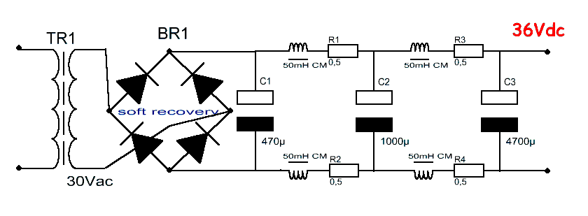

Now regarding the resistors to create a voltage drop from 40v plus to 36v... can I use these between the rectification and the smoothing caps ? (I just got two jensen 4 poles and would like to connect them directly to the shunts )

Here go two PSU Designer files. Notice the difference between shape and size of the ripple voltages. Chokes used are 50mH (0.2 ohm) common mode type. The small resistors are used to drop some voltage, secondary Rdc is guessed. Enjoy.
Without sophisticated test equipment it's a rather theoretical matter but on tube amplifiers the difference can be heard.
The Simplistic Regulator is very good. This little help might get your results a little further, as we are amplifying small signals with SE stages. I haven't listened without the CM filter but I can imagine it removes to a small extent the artifacts from the reproduction.

Ricardo, at this point I no longer need a 30 + 30 V AC Xfrm, but an higher one to get the desired 42 V DC for the hi gain riaa. More trouble..... 🙄

I would like to build the high gain Riaa (pcbs will follows), thus Vout must be 35V, but if I implement the filter suggested by Disco, I need a 35 + 35 VAC Xfrm. That means I must have it done on special order.
