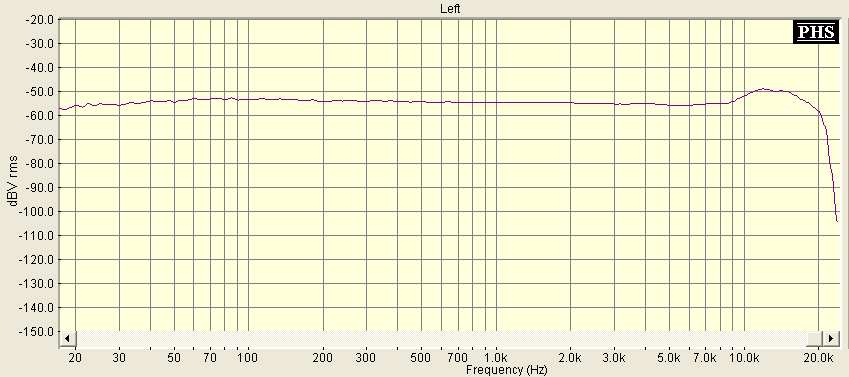

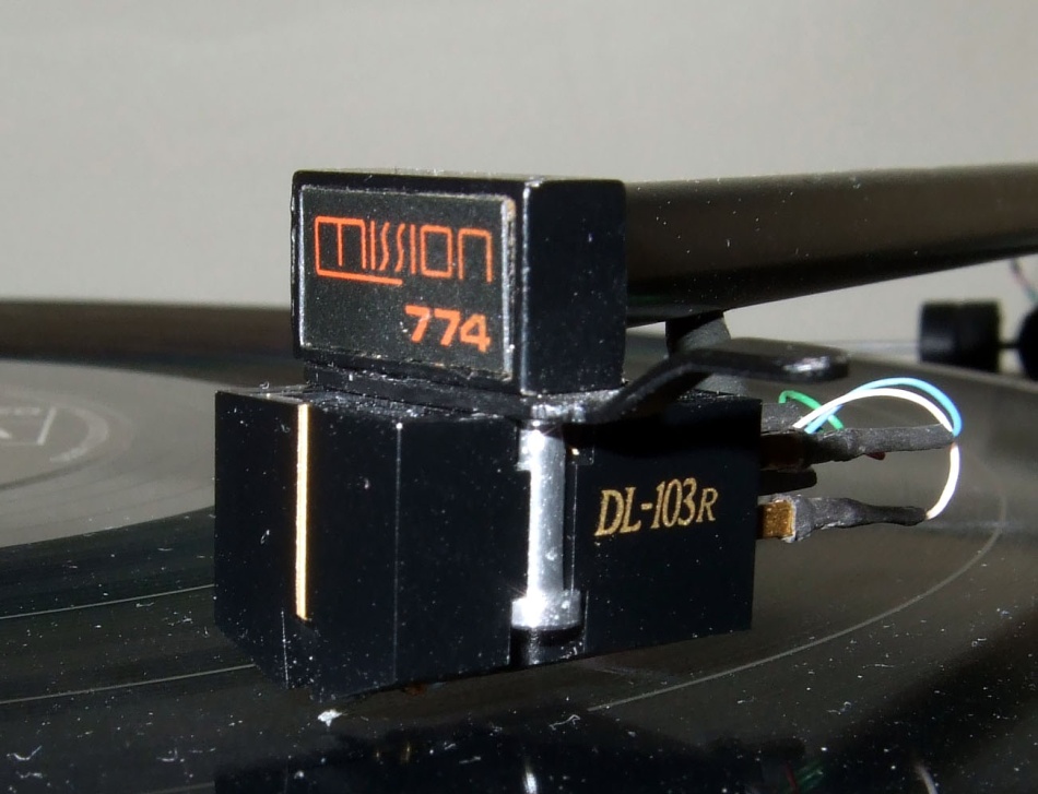

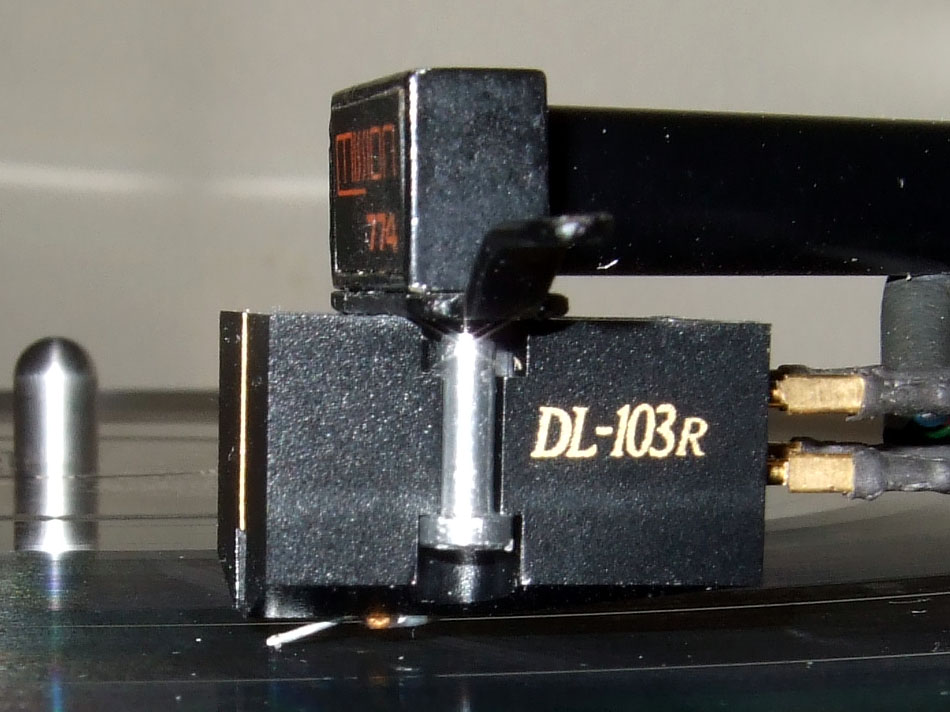

For the time being I set it up a bit roughly late today so to find its buttons and let it run a bit. Interestingly the Mission 774 gave 8.5Hz Fs on test disc monitored on FFT with it. Tracks very well. I bypassed the 1st stage source degeneration resistor of the normal 0.5mV MC version Simplistic with Chemicon 1000uF 25V KY type (gel jokes OK:D) and got beautiful gain and tone. Hiss is naturally somewhat more but not what you can call obvious even on my 95dB speakers. I have in mind a 4 parallel 2SK170 45V B+ first cascode stage revision at a point for low MC so we can avoid cap bypass. On the other hand, this thing went so smoothly with bandaid gain solution and same basic from the previous DL-160 set up geometry from the very first minute, that it is a blessing. Don't be afraid to bypass the 56dB, the tone is golden. It can go back normal MC fast if you change cart, so its a good Low and normal MC solution in one package. I found that 260-280R loading sounds good for now. Its an obviously high quality, much musical, gentle cart. Excellent piano, things are happening much more with jazz bass players, satin mids n' highs, no stress nowhere, natural stage and depth. Reminds me of a Supex but with little more natural freshness. Here is its initial response on the 774 at 2.5G VTF and 265R load. No VTA experiments yet. 30 mins run in time. :) OK I listened to it more, something like two hours, but the graph has been taken early.
