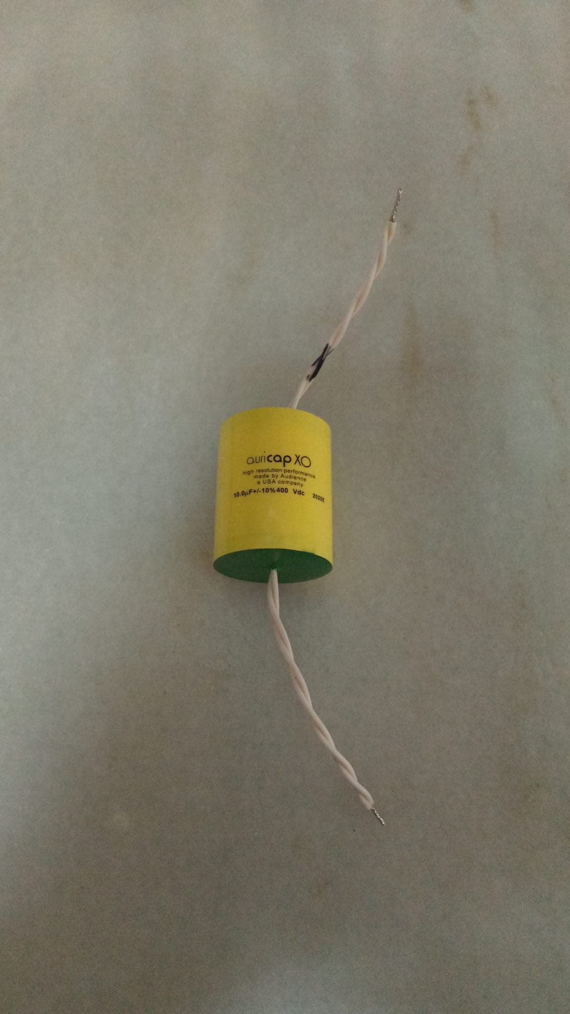

Salas yesterday arrived C2 upgrade.
Reactions: Salas
