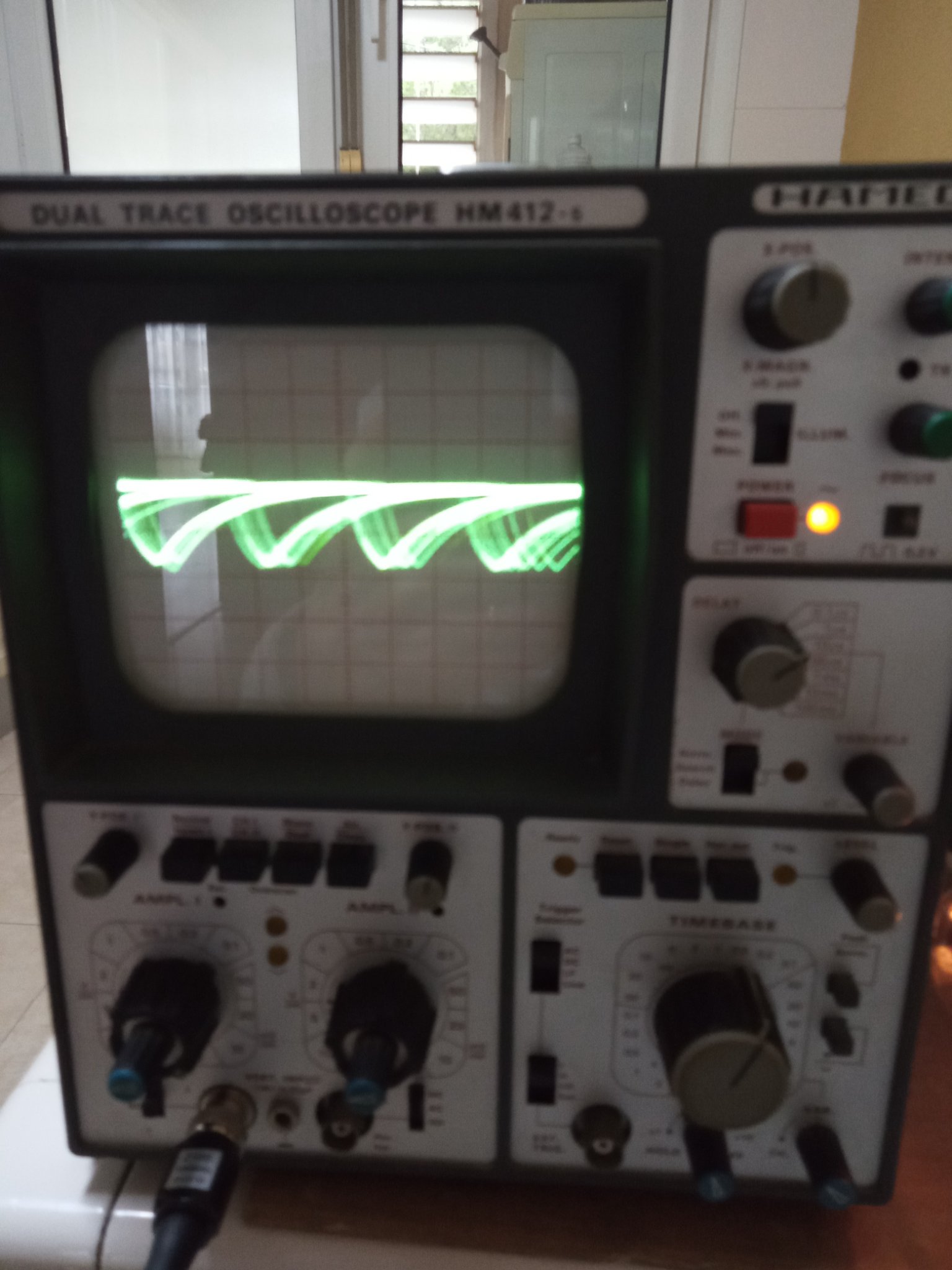

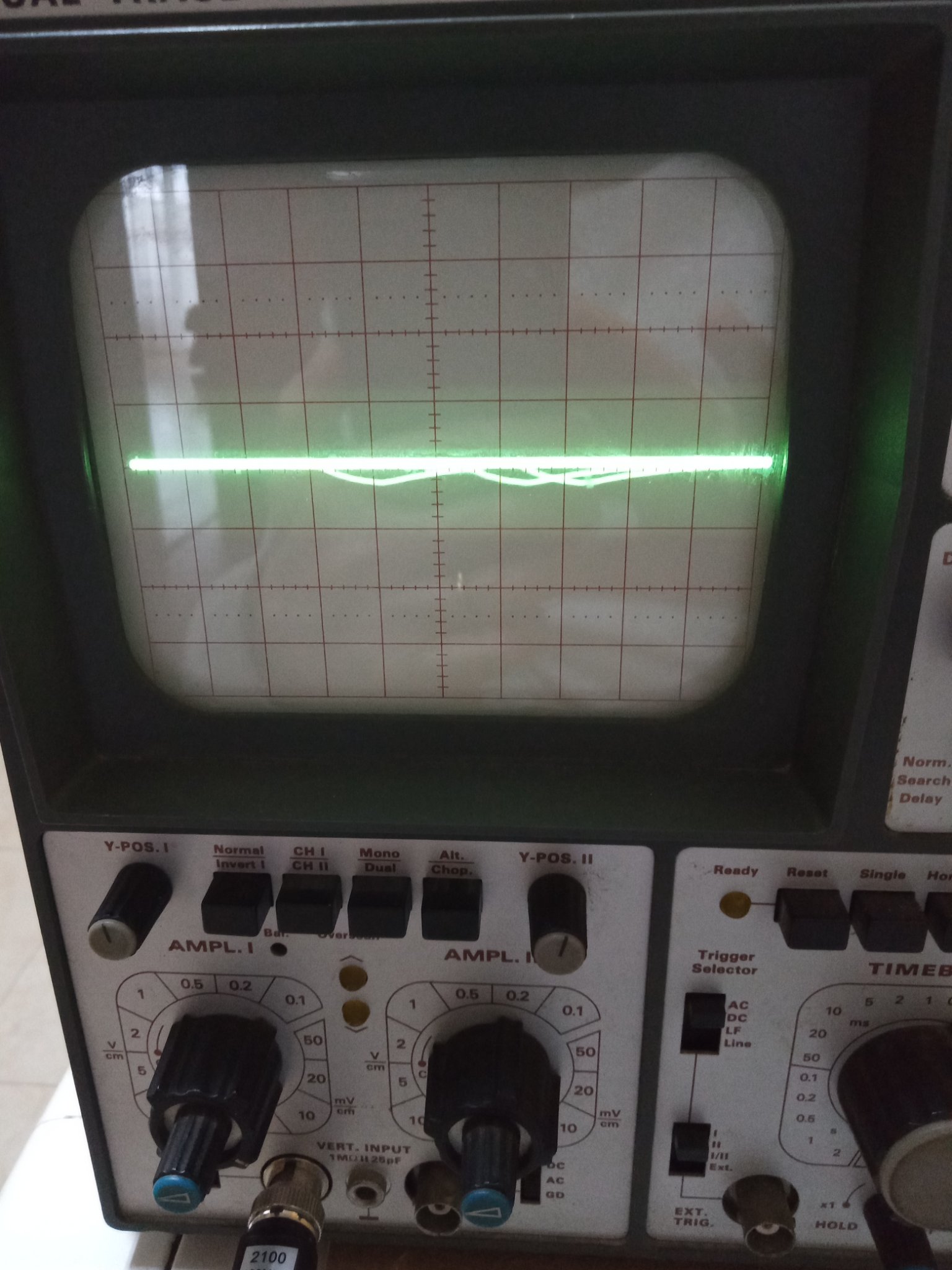

10mV 0.2ms 10x probe
Measured taken between SSHV2 and cascode CCS probe + and probe - to GND, right pic without probe - to GND

On first look the system seems oscillating. It could also be about interference.
It can be doing it with the particular CCS load but if measuring SSHV2 alone with just dummy load, not doing it.
In any case repeat with short gnd spring accessory to make sure its not interference on the probe's gnd crock wire.
Definitely there is something no good using togheter SSHV2 and cascode CCS or Ale's Moglia aka Bartola hybrid mu-follower (gyrator) so active load reacts very bad with SSHV2 so if I want to use SSHV2 only with anode resistor load, I guess no problem SSHV2 with anode choke load or line output transformer.

Maybe it's a type of hall-of-mirror between the the two CCS in series. Don't know if it's the right way to call an oscillaition like this.
For all intents an purposes the SSHV2 has already all the PSSR you will ever want.
